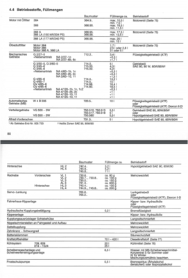

Verfasst: 2018-08-27 8:54:58
von siegerland
This ist the official site of Mercedes-Benz on operating supplies:
general oversight --> https://bevo.mercedes-benz.com/bevolist ... sort1.html
coolant specification 310.1 --> https://bevo.mercedes-benz.com/d/d/en/Spec_310_1.pdf
just in case of additional infomation needs I would recommend to have a glance @ your truck operating manual if on board
operating liquids LN2
sorry no english/french version at hand
