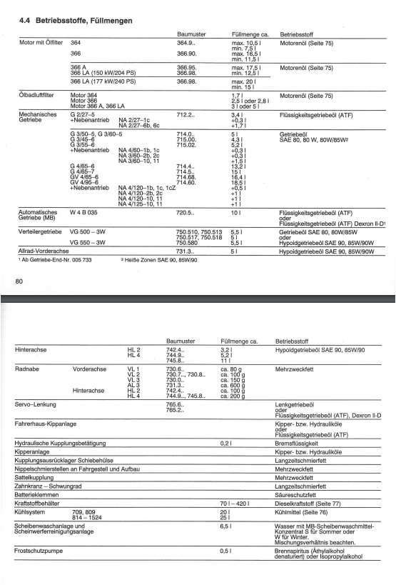

approx.25litres pour le moteur OM 366
Salutations John

just in case of additional infomation needs I would recommend to have a glance @ your truck operating manual if on board
operating liquids LN2
sorry no english/french version at hand
