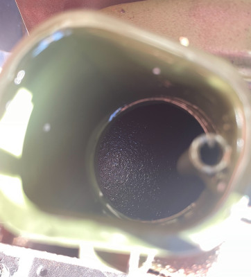

Hello Friends. For the first time in our six year overland trip we have gone HIGH and COLD. Typically >4000m and < 12°c overnight.
Problem: I'm having to wait until midday (5°c) before my engine will start.
Question: My engine has Flame Start. The Flame Start does not behave as per manual (Pre Glow check lamp, then after short delay, Start Engine message). I have no indications. What temperature does flame start activate please?
In the meantime, I am looking for a diesel additive to help diesel flow.
Thank you

Thank you Felix. I have now started engine. After weather warmed up.
But we will go to Bolivia next. HIGHER and COLDER. So I wil buy additive in preparation.
I would like to know what temperature my Flame Start should activate. I don't know if I have a technical fault or the temperature must be lower than what I have experienced (-12°c).
David

My dashboard does not indicate that it has initiated flame start.
What I'm really trying to find out is:
For a TGM 13.290, what temperatures / altitudes is flame start initiated?
There is no point me fault finding until I know there is a fault. Perhaps the ECU does not command flame start until -20°C.
Dave

Re flame start - I checked fuse (ok) and I removed and checked relay (ok). The ambient temperature display on the dashboard shows correct temp. I will next put my finger on the relay and see if I can feel it operate in a cold temperature. I will measure glowplug resistance. I will measure fuel solenoid resistance.
I guess I have time to kill... I'm not going anywhere anytime soon.
David
