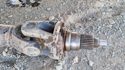

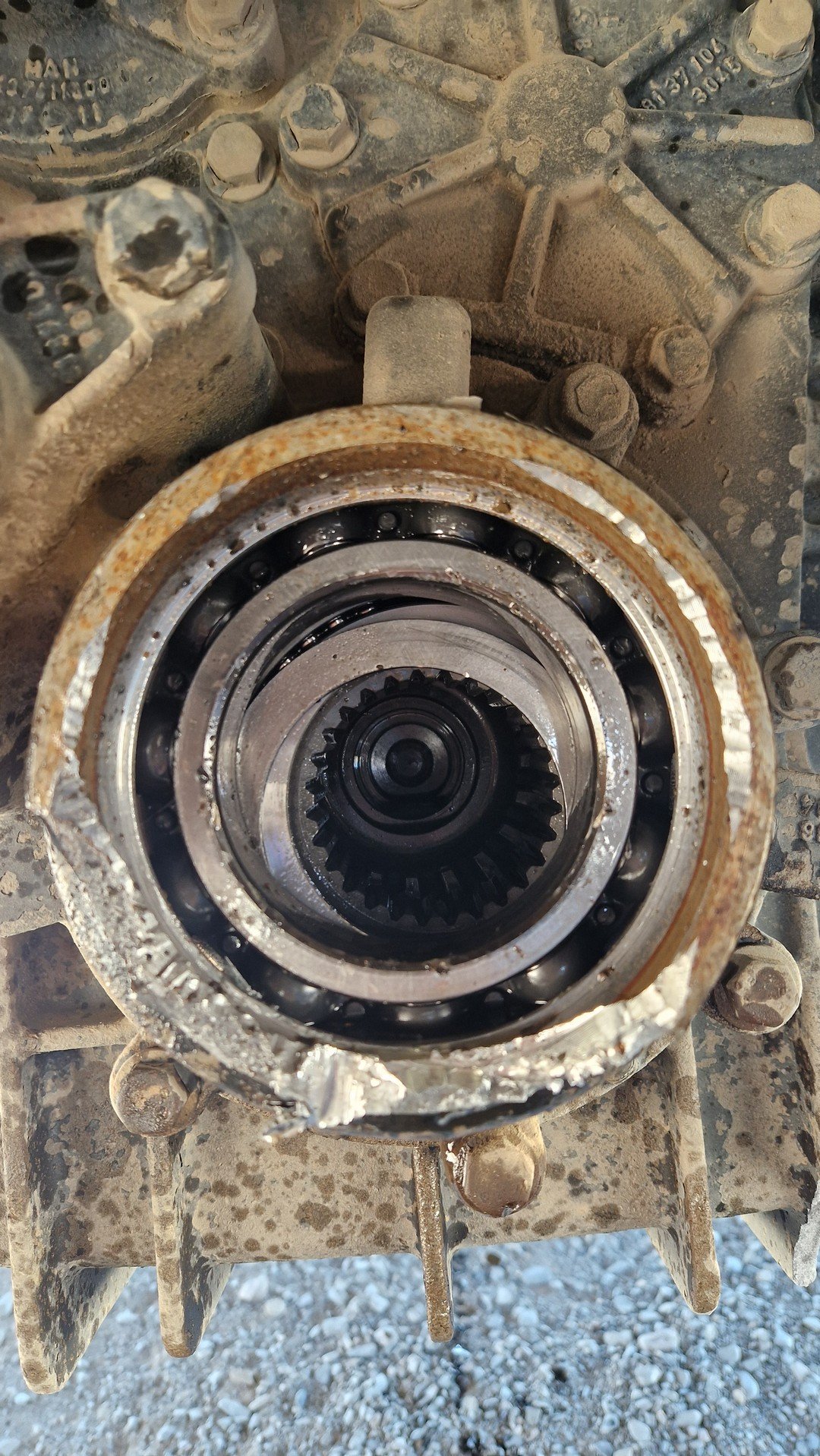

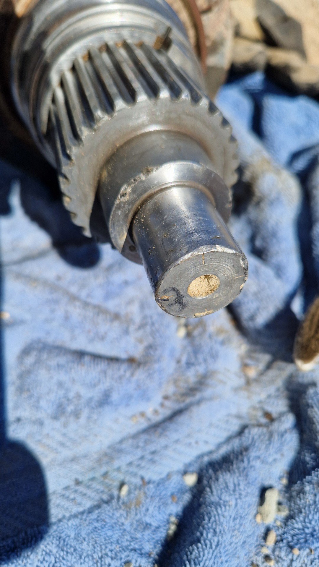

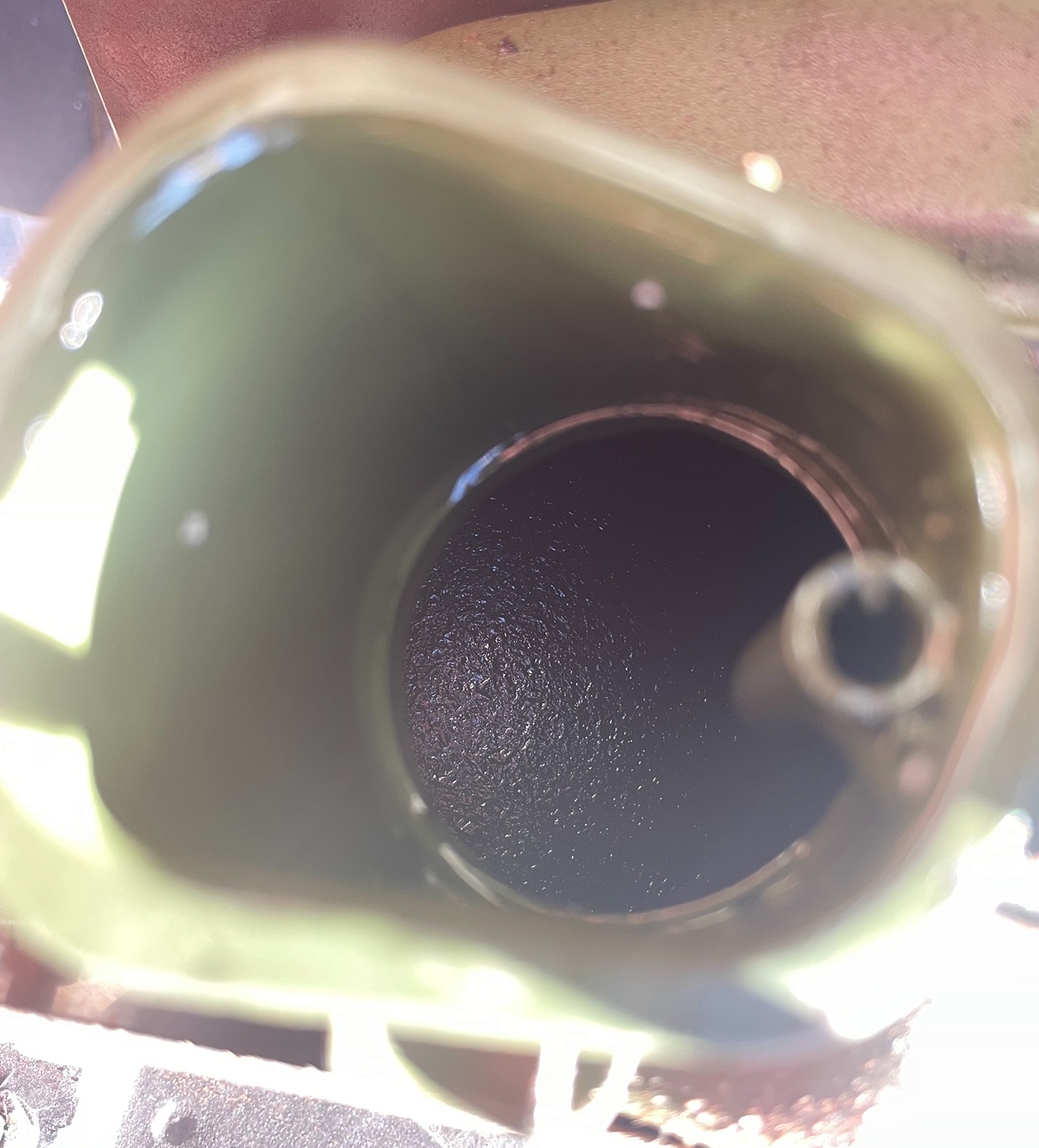

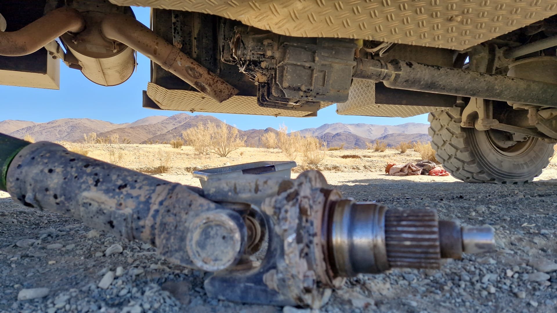

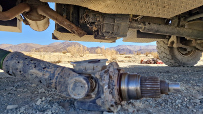

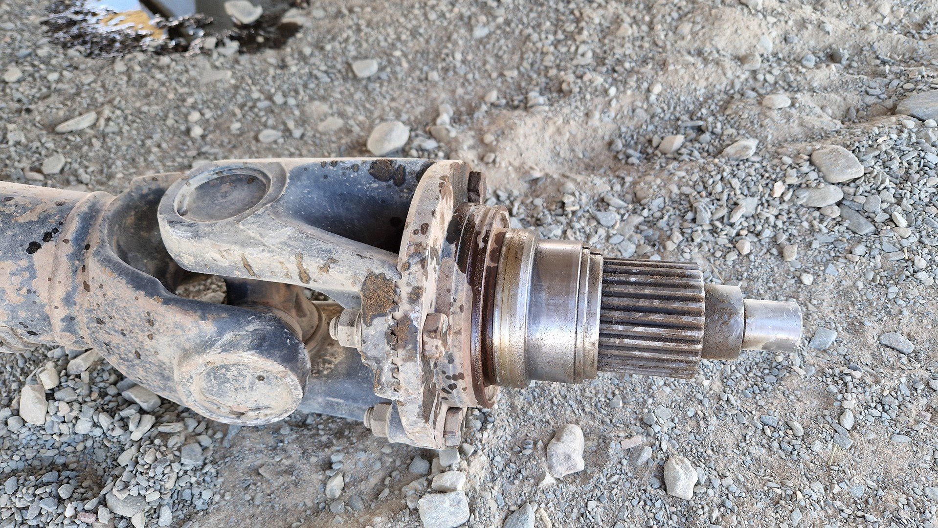

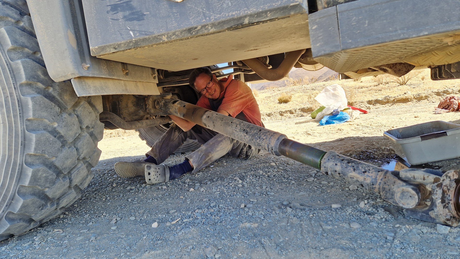

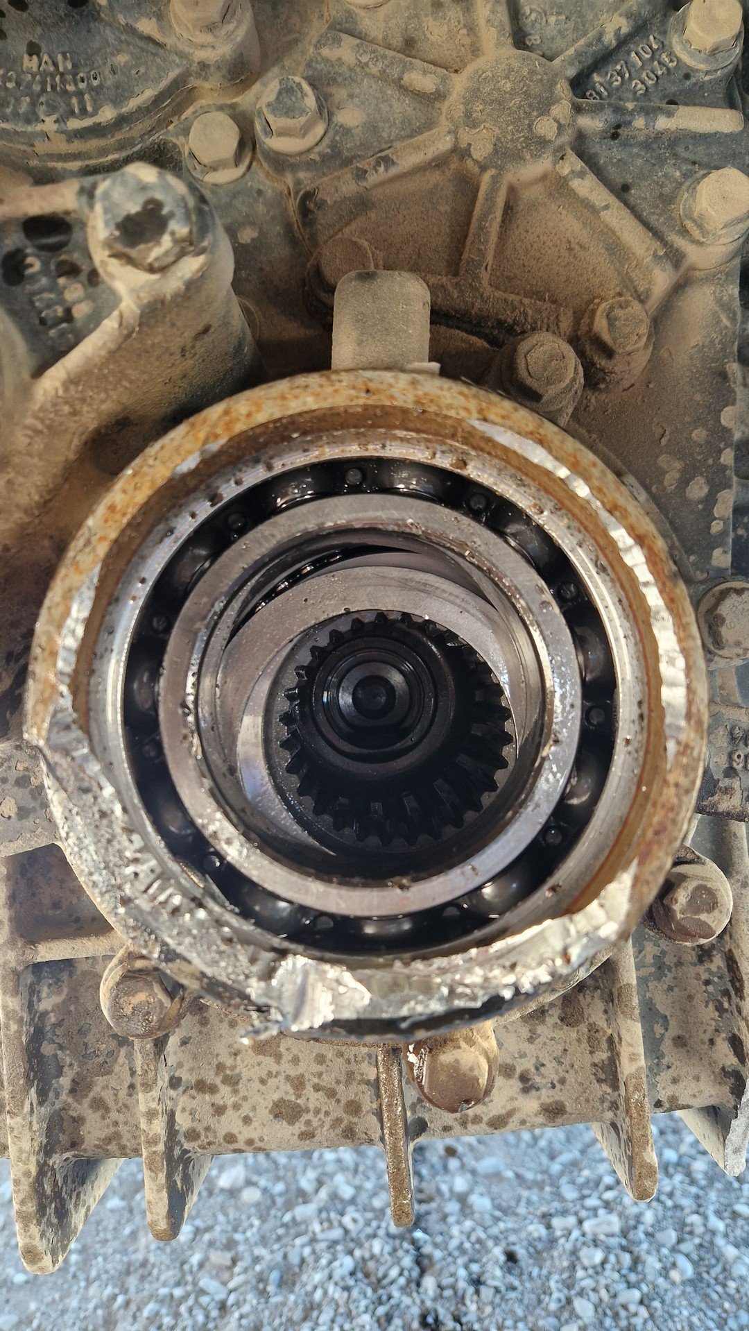

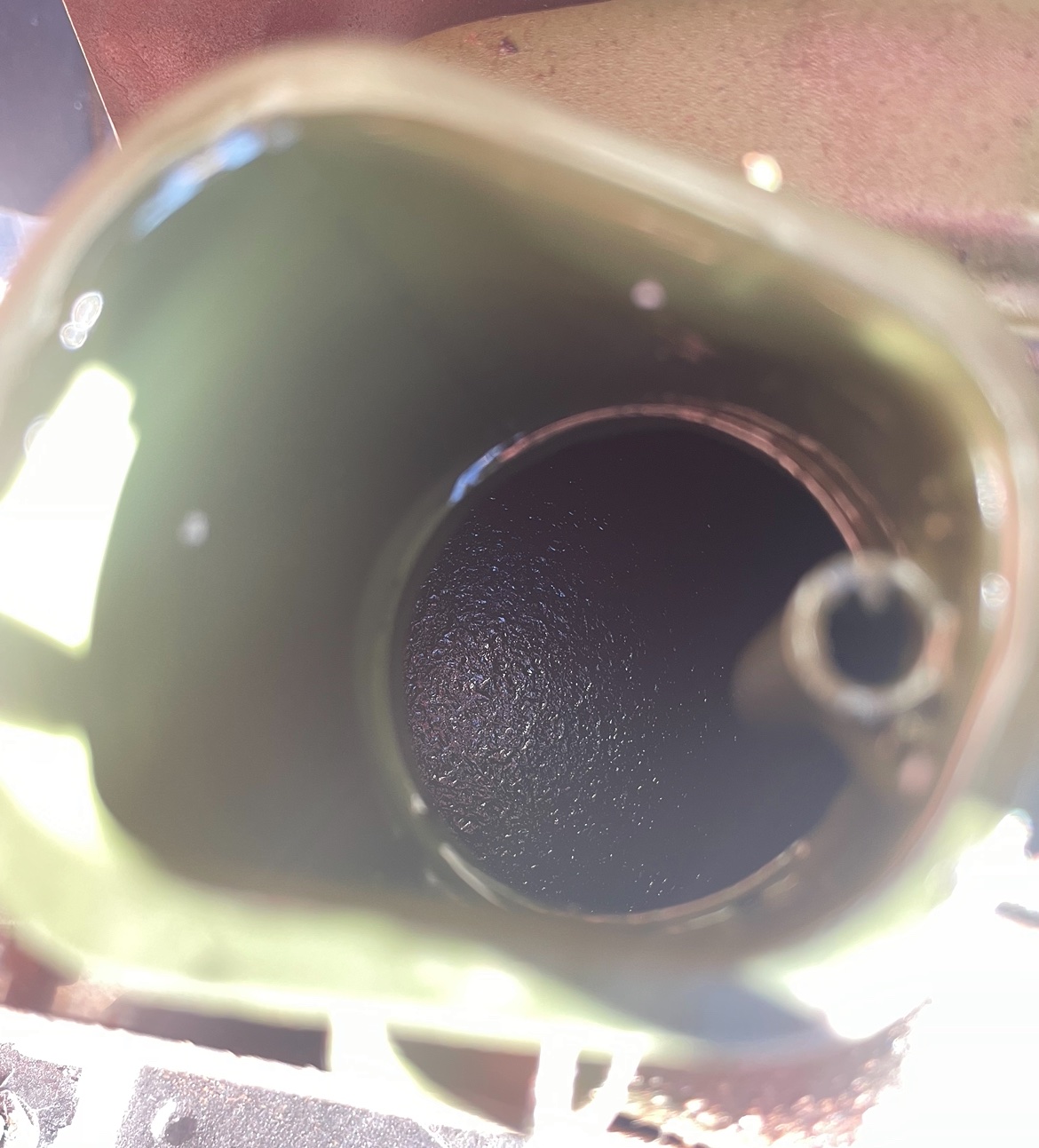

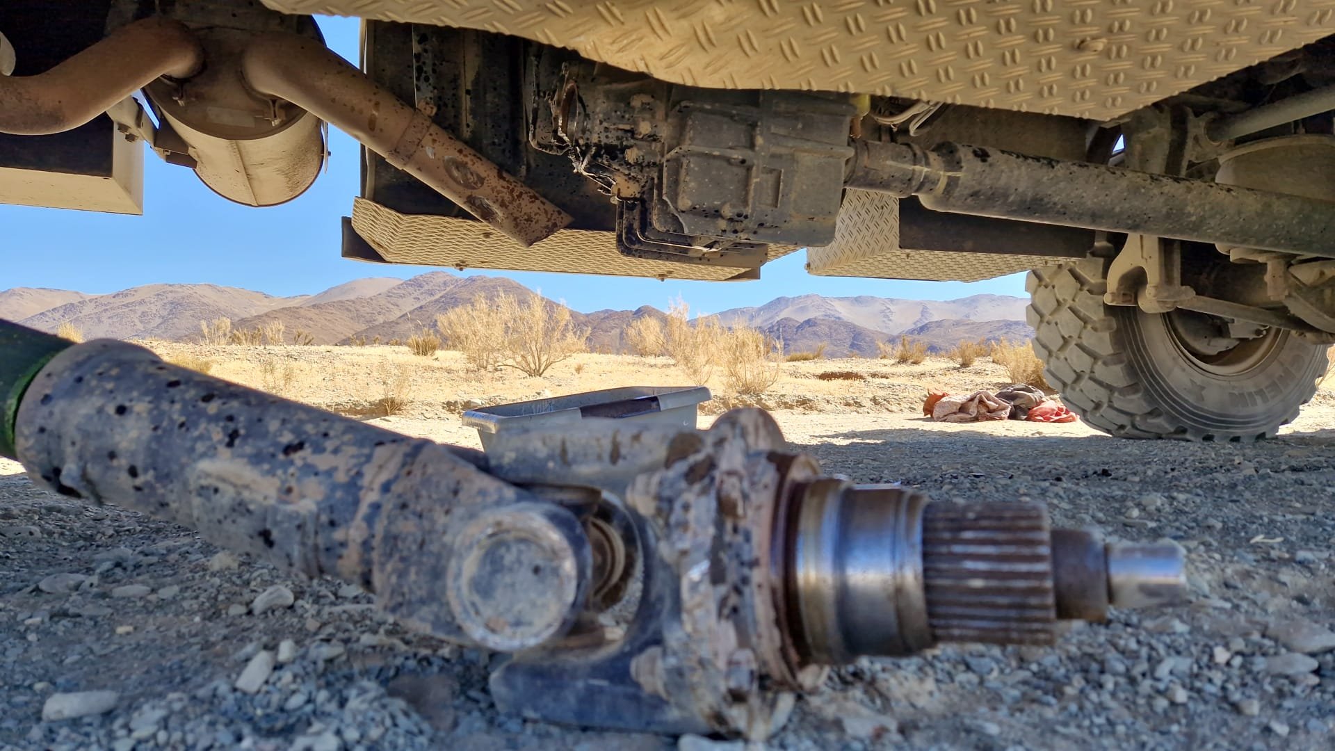

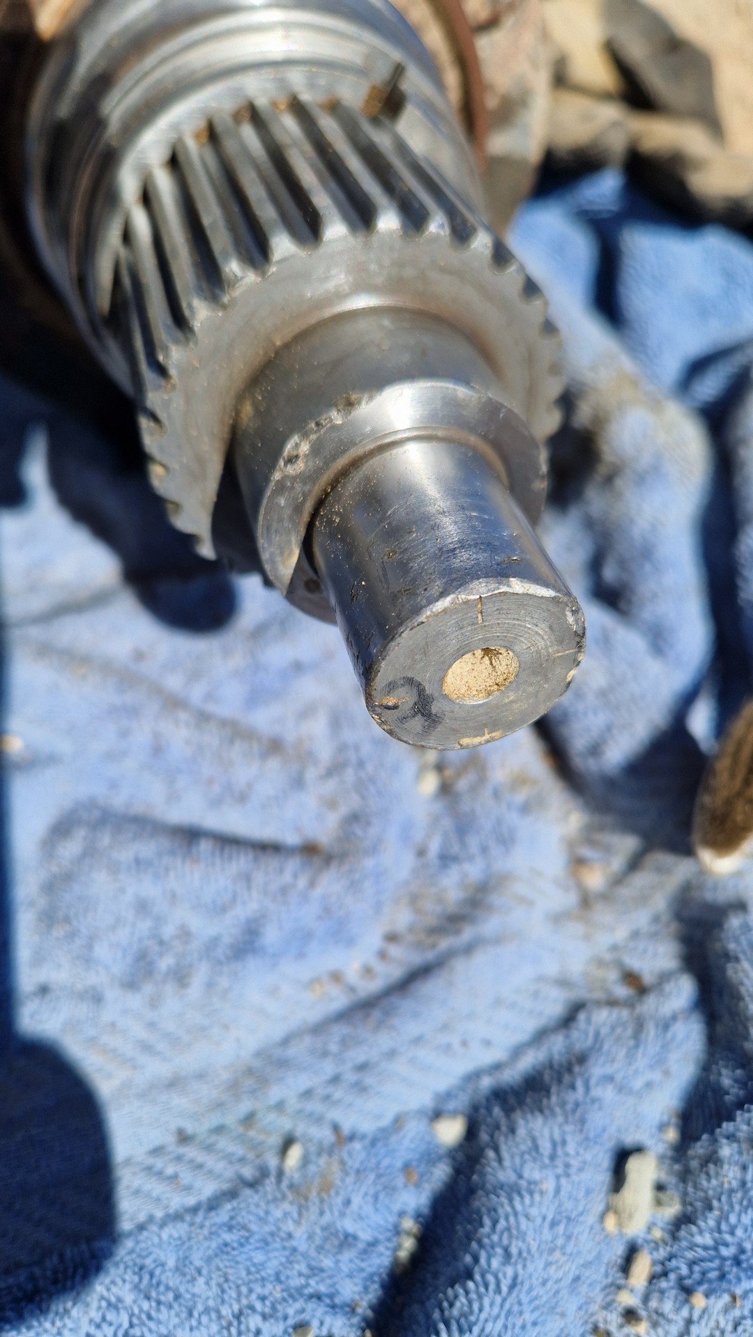

Unfortunately I now have a much bigger problem. My transfer case failed yesterday in the middle of nowhere. I disconnected the propshafts and the police towed us to the nearest town (village) where we are now stranded.
As we say in the UK, when it rains, it pours.

#17 Beitrag von DavidQ » 2024-07-19 18:58:58
Hi lura,
I don't know how it failed (but no, I did not hit a rock!)
Here are some pictures.
Dave
