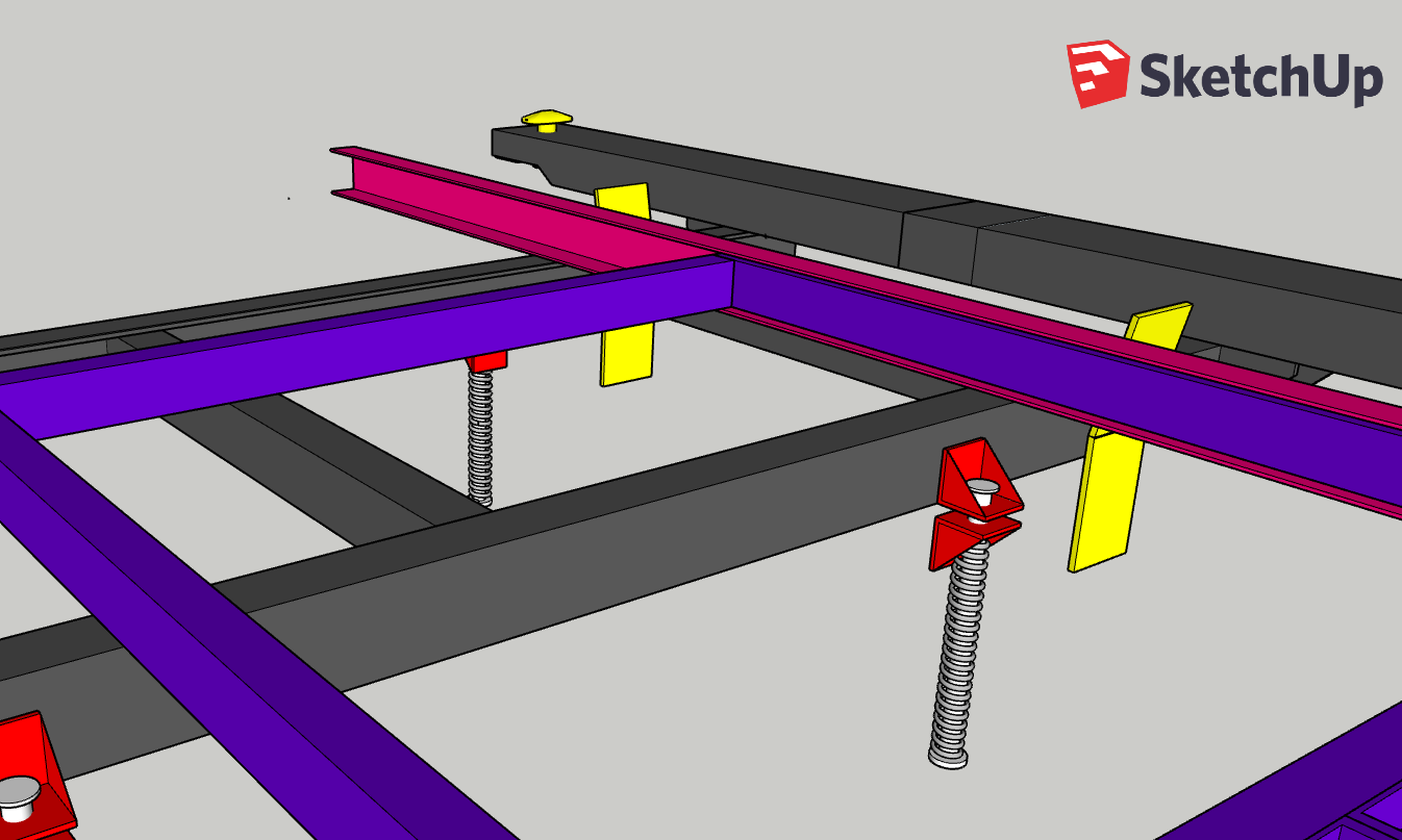

The coil springs (druckfedern) I (maybe) gonna use are D-384 with Sn 132 and Lo 280mm. 132mm is a nice compromise between 50mm and 200mm. 2 or 3 on each side.
Hilfsrahmen und federlagerung Iveco 90-16 DOKA
Ivan de wit
- Beiträge: 74
- Registriert: 2017-06-06 21:19:29
- Wohnort: Eindhoven, Niederlande
Re: Hilfsrahmen und federlagerung Iveco 90-16 DOKA
Double coil springs aint gonna work. Otherwise I have to get rid of the platform (with double springs I can't slide in the platform anymore). I don't want to do that
. Instead, I use single coil springs. Besides that I'm gonna use C-Profile 80x60, 100x60 or 120x60 (depending on wheel height). These C-profiles are recommended by Iveco. Stiffening the subframe with square profiles.
I had contact with Kern Metallbau about the coil springs that they adviced. It's the D-414M-04 with sn of 68mm. We suppose the spring has a "federweg" of 68mm as stated in the datenblatt. But thats not the case says Kern Metallbau. The sn gives the Dauerverwendung der feder, nicht auf Null zusammengedruckt.
Kern states that if you press the spring to zero these springs have a federweg of 120mm.
I looked on some Dutch websites. They also state Ln is the length of the compressed spring. But they say nothing about compressing it to zero. I will contact them tomorrow.
Fur D-414M-04
Nt = n+2
Nt = 14+2 = 16
Lc = Nt * d
Lc = 16 * 9
Lc =144mm
Federweg = Lo -/- Lc
Lo = 230mm
Lc = 144mm
Federweg = 230-144 = 86mm
Nt = n+2
Nt = 14+2 = 16
Lc = Nt * d
Lc = 16 * 9
Lc =144mm
Lo = 230mm
Lc = 144mm

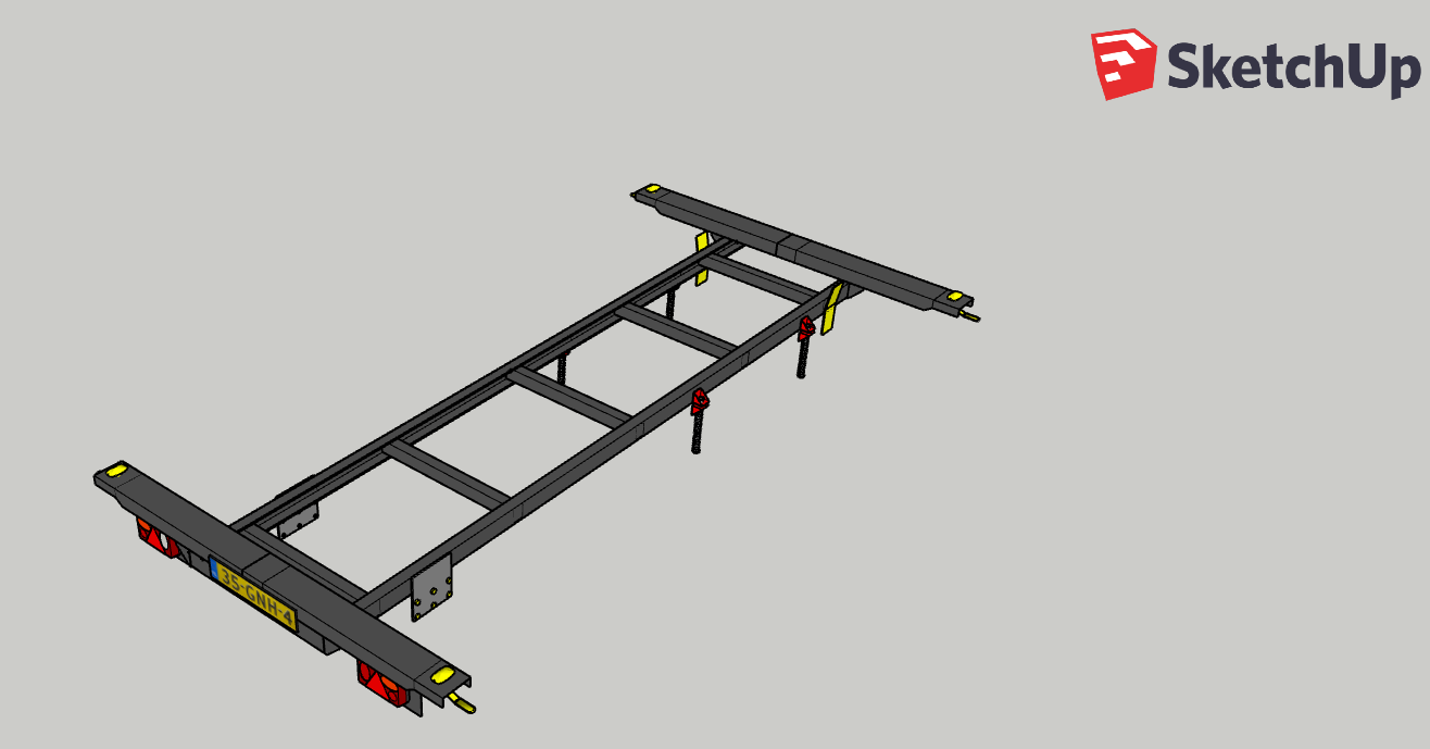

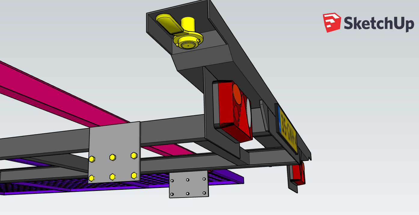

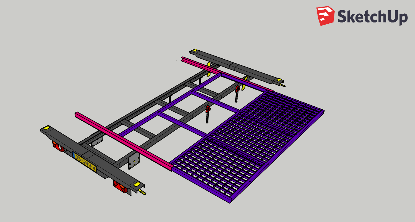

Work in progress

Kreuzaussteifungen X im Rahmen machen den Rahmen deutlich steifer.
Dazu bieten sich auch Quadratrohre oder Rechteckrohre gut an.
Lg Bernd

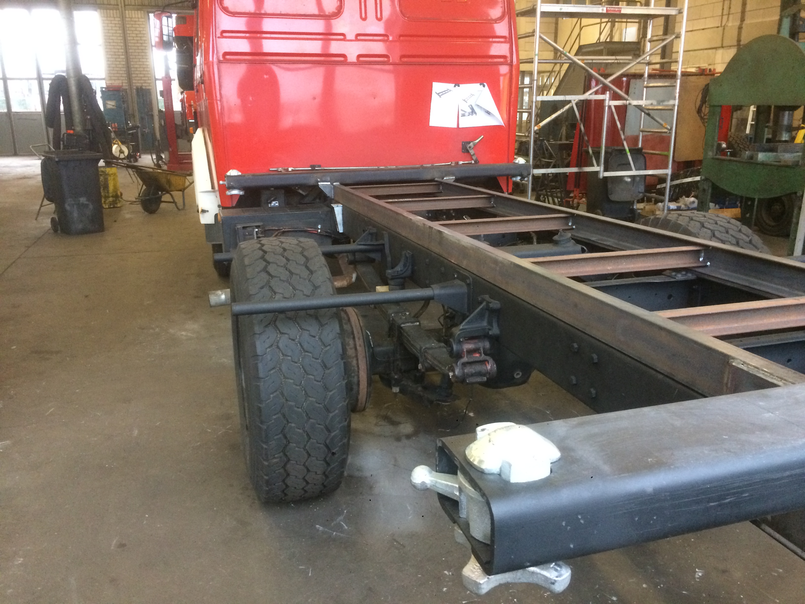

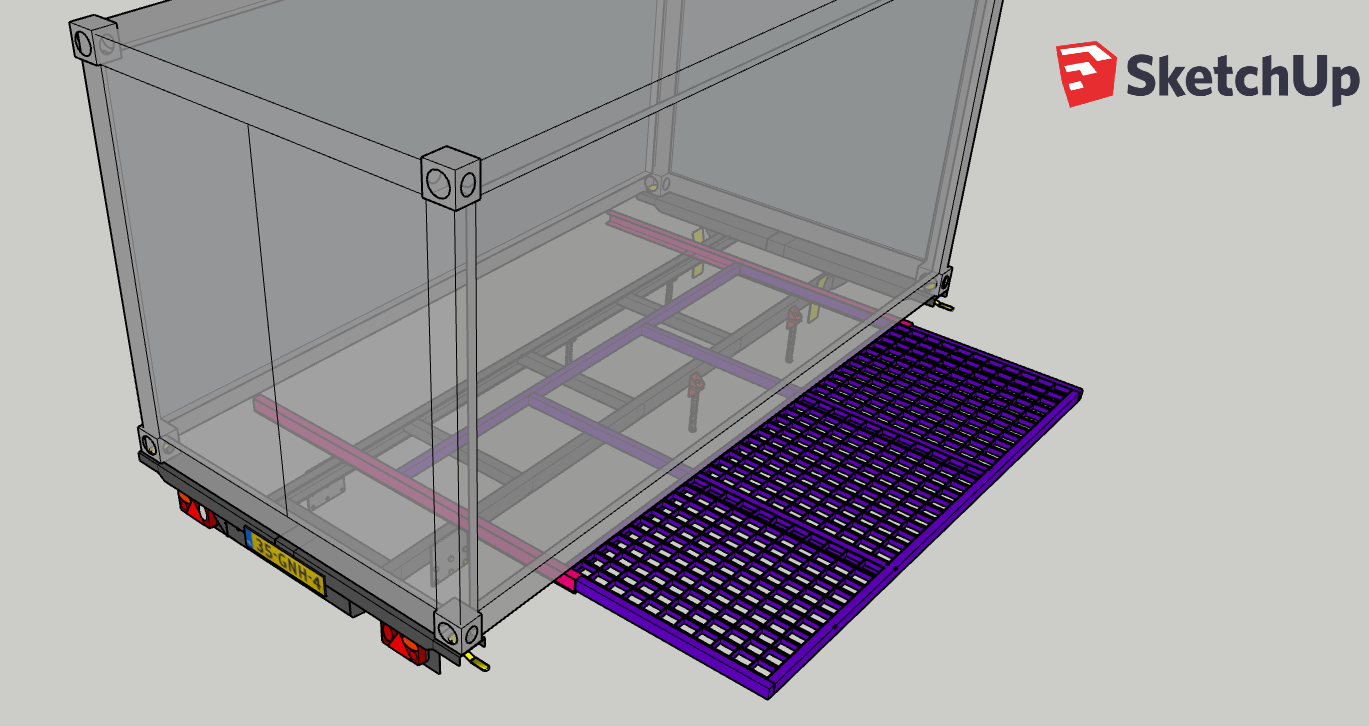

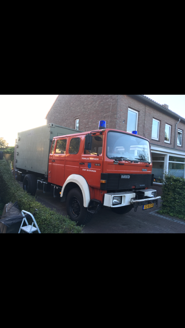

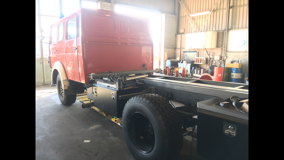

Es geht nicht schnell...
- gefederte zwischen rahmen
- radstand 4.10m
- rahmen hinten langer gemacht
- 2x 200l tank
- body lift 50mm
- einzelbereifung 385/65R22.5
- 3x stauboxen
- batterie nach vornen gesetzt
1x 200l war besser gewesen. Incl original tank war ausreichend. Vielleicht schraube ich 1x 200l wieder ab...

Nur weil der Rahmen am Computer simuliert wurde, heißt das nicht dass er besonders leicht ist oder das in der Praxis keine Probleme hat .Groschengrab hat geschrieben: ↑2017-08-11 9:42:21If you want to save the last kg of steel and an entirely custom made solution which would require a fatigue load simulation
—max
