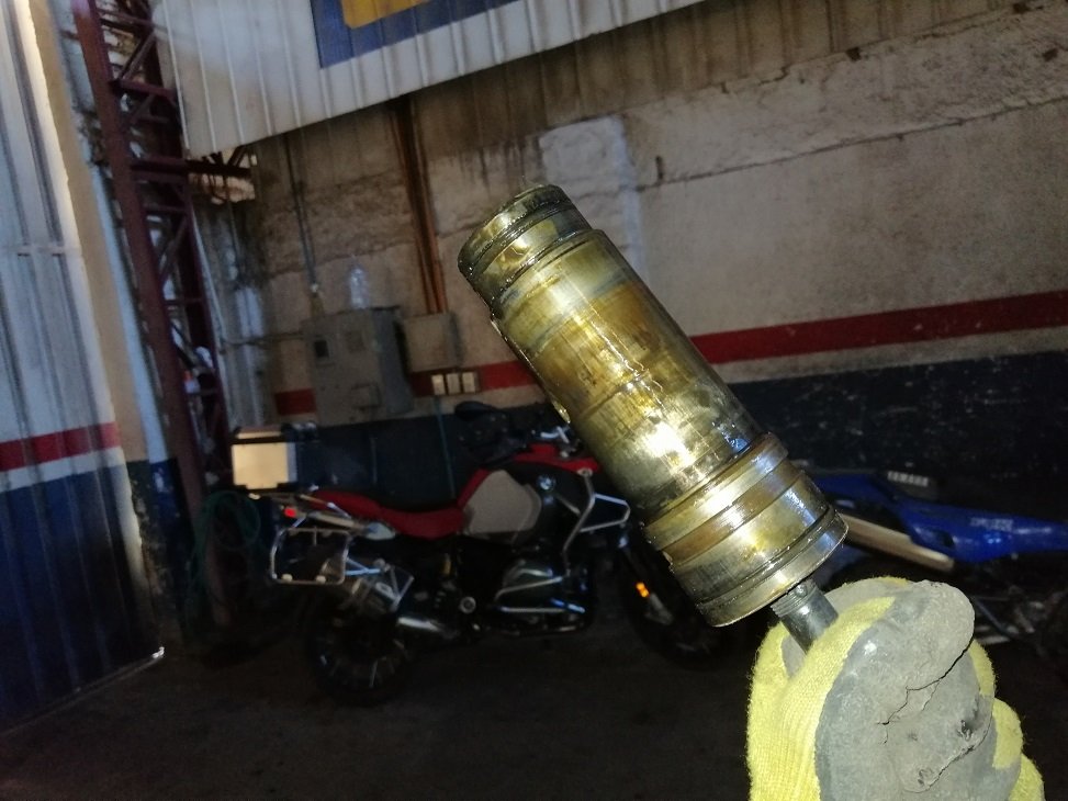

What to do in the meantime? He had given me an advice on what to do to extract the pin of the intermediary gear some days ago after seing the striking method did not work, but I had not given it a chance… until then.
Adapting things a little to follow his idea, I cut the sliding hammer and left the threaded extreme welded to the bolt to use it as a puller shaft. A couple of pieces of discarded and broken bearings served as spacers and the top of the self-made extractor gave stand and grip for the nut. Easy.
And it actually was. Uh.
Began to turn the big wrench clockwise and, after a minimum effort compared with the sliding hammer madness, there was a sudden release and the pin popped out from the surface of the gear housing. Great!
I was thinking on using the heating stuff to take the pin out, but this was far more easy and less destructive. Oh, I really like my brother in law!

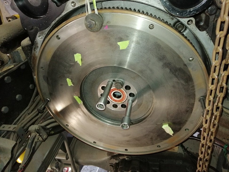

After cleaning all the pieces and surfaces for good, I removed the old retainer, that in fact looked like new, and made sure there was no damage to the housing. If something was wrong it had to be the retainer.
If I inadvertently damaged the retainer, it had to be during the installation of the pressure plate when assembling the engine, some time ago. So, this time I proceeded very carefully and hung the plate from the winch and used two extension bars from the tool sets that fitted perfectly to guide the plate smoothly into place. Easy.
I had to go back in time to look for the torque settings for the bolts that secured the plate to the cranckshaft, but finally found them in an e-mail from 2011.
Then I put the adapter flywheel back on and adjusted the disc position with a steel strut, by eye only, trusting it would be a just one-time maneuver.
And it was. The intermediate shaft went in a perfectly centered clutch disc and the bell housing was secured with the many bloody bolts, with the appropriate torque, of course.
I bolted the engine supports to the bell housing, hung the engine from the winch, just enough to allow removing the wooden pieces from under the exhaust manifold, and then installed the clutch cylinder back on.
And then the oil leak issue of the back of the engine was solved. Now it was a matter of cranking the engine and see how it worked, pretty confidently… with fingers crossed.

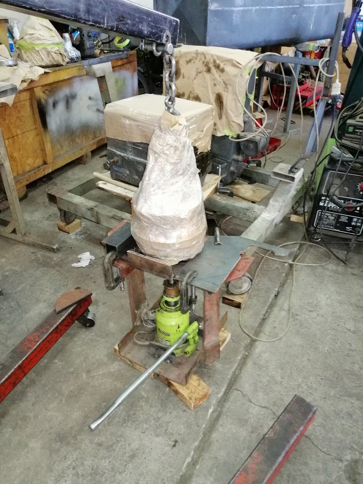

At the shop, next monday, to remove the main shaft and the gears from the box I needed to remove first the big bearing on the back. It was big and stuck like an avalon, as expected. Working carefully with the sledgehammer and a piece of bronze I reached to get it out of the case, milimeter by milimeter, just by using stoneage tech, but there was still a long way to go before removing it from the shaft itself. Hmm…
Eduardo approached and suggested to use hydraulic power instead of Neanderthalis strenght, again. I sighed and looked around and found the once projected support for the jack to push the kingpins on the steering knuckles. The ugly and odd looking thing actually was never used because the pins were put, frozen, by the sole push of the hand. It seemed a good idea at that time, though.
I made some measurements, cut the two pillars according to them and fixed the hydraulic jack pretty simply with a couple of pieces of steel firmly tacked to the base.
The gear box was a pretty heavy bastard, though I managed to accommodate it to have it resting on the side without taking it out from the winch. That way the main shaft was exposed upwards, ready to be taken out. Ready?
Soon after putting the gear box on a stable platform on the same trolley, I heard Carmen shouting it was time to go. Another week had passed and the progresses were quite slow, though at least there were progresses. I was happy.
Covered it all and made order. I had been not working in the Merkabah on the weekends as my full attention had shifted to the new house, still in the building process, with the classic delays and problems related to the building itself and the contingency due to the bloody viruzzz.
The same contingency almost left my father with no job, as his clients requested a pilot less than 60 years old because of the risk of the covid 19. Fortunately, experience and common sense prevailed and he went to work far north.
I put a really beautiful picture of the helo taken by one of his passengers with a serious camera while passing by, with the massive and gorgeous northern Andes as framing.

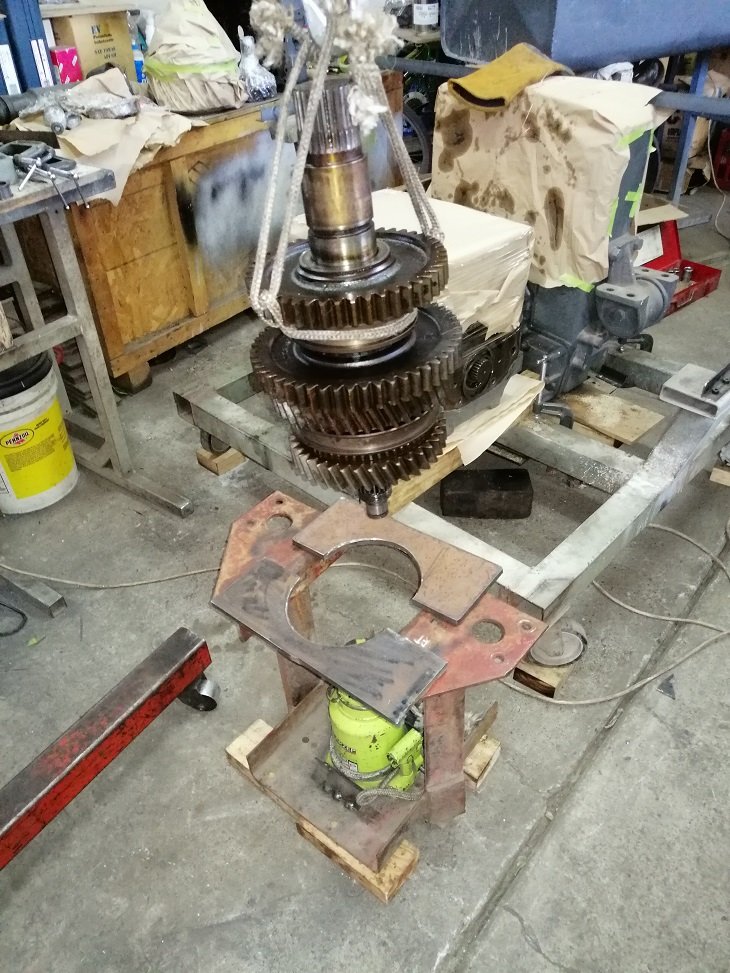

Then, drilled a couple of holes on the plates that served as stabilizers to match the bores on the cage to have a cleaner and tougher grip, and hung the jack to finally weld the pillars perpendicular to the holding plates with a pretty thick welding. And that was it: another Pairoa’s port-o-power.
But, always the big BUT, the jack did not work horizontally, as you probably all knew. Well, I didn’t. So, I had to hang the whole bunch of kilos of metal from the winch and put it vertically, or almost vertically to make the jack work.
It was then just a matter of applying a little pressure on the shaft, only the six millimeters allowed by the play between the gears, change progressively the thickness of the retainers, and eventually the bearing fell soundly on the jack. Took some time, but it worked. Thanks again, brother.
I got the neo-extractor free from the gear box and put the later back on the trolley to keep on with the disassembling.
Removing the shaft with all the gears from the box was relatively easy thanks to the winch and the ropes. Christ, how heavy they are!
Once on the working tray, I made a vain try to take the front bearing out using the extractor. No way, and I knew it. Grabbed the powergrinder and the screwdriver and destroyed the outer bronze cage and took the rollers out with no mercy. I then grinded the inner raceway until it was so thin that a couple of strikes broke it loose. I was pretty afraid of damaging the shaft so it took me quite a while to get to that point.
Once the bearing was out, the locking nut was exposed, another big task in itself. It was pretty clear, again, that the sliding sleeve was freely moving over the synchronizer’s hub as there were no end pieces nor springs at sight.
I will save you from the carnage of the removal of the locking nut, just tell that I finally asked Eduardo to help me to take it out as I was not able to do it without suffering. The chisel work is definitely not for me.
The following was a surprise: I removed the synchronizer hub and found that the cone on the side of the 3rd gear was also broken, in many pieces. I had seen before one of the little broken pieces when first opening the lateral cover of the the gear case, but I thought it was a piece of the broken 4th gear synchronizer cone.

This is indeed quite tricky, if the disc is not exactly lined up, you'll end up with the gearbox not fitting.pairospam hat geschrieben: ↑2020-05-14 3:17:45Then I put the adapter flywheel back on and adjusted the disc position with a steel strut, by eye only, trusting it would be a just one-time maneuver.
When we had the gearbox of my LP out for clutch replacement we had nothing as a reference and we had the primary drive taken out for line up. Since the gearbox was also disassembled is was easy to do and once the clutch plate was lined up we placed the primary shaft back in the gearbox. Assembly was easy.
Mein blogs: http://rundhauber.eu/ und http://lp2223.com
Re: Mercedes 2626 AK 6x6
a90:
Hello and yes, I remembered pretty well how tricky it was the first time, ending up in steel porno, but I definitely wanted not to disassemble any more of the bell housing or whatever.
Life, God, the engine... everything seemed to be cooperating this time. Why should it be so difficult? Just went on, with trust.

Trying to take out the 3rd gear from the shaft using the big extractor was a waste of time and a dangerous exercise. I could not use the hydraulic press of the workshop because it was blocked far away surrounded by cars and the shaft was heavy as hell, no way to take it there without the portable winch.
So, I got some pieces of scrapped steel plates from Verardo’s machineshop, cut and adapted them to go in between the gears and thus allow the compact neo-press to apply pressure properly without damaging the components.
I welded lateral reinforcements to strengthen the plates though I was terrified by the idea of some incandescent piece of molten steel going directly in between the gears and the bearings, no matter how far the shaft was from the welding place. So, I wrapped the shaft in a thick cocoon of paper and plastic. Too much?
Anyway, it worked, the press. The 3rd gear went out with not much pain and the synchronizer hub for the 1st and 2nd gears was exposed. Good.

The big challenge of the last weeks had been, of course, the disassembling of the Zahnradfabrik Friedrichshafen 5 S-110 GPA bloody gearbox which resulted in the PITA everyone, except me, expected.
Next, the borrowed extractor was the best tool for removing the hub in this case and then the synchronizer ring and the 1st gear could be easily removed on their turn.

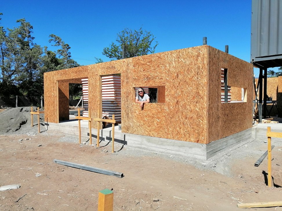

Hope you don’t mind, but I will show a few pictures of the build now that it is almost complete.
We built a very simple house with big open spaces, connected to a big maritime container that served as warehouse for the building materials and became a quite big closet and at the same time the roof of the parking, connected on its turn to the shed/garage/workshop.
It all began with the building of the front gate. It was the test for the contractor as to see how he performed and delivered. He was okay so we went on with the rest of the building.
I hired another guy who built the bridge to pass the irrigation ditch, and I asked him to build it bulletproof, thinking on the Merkabah and any gigantic wohnmobile that at some moment could ask for a place to rest in a near future. He also built the perimetral fence. In my country, as in many others all around, you have to begin with the closing of the perimeter or you may not find the building materials the next day. Sad but true.
The truck that brang the container in seriously put the bridge at test and barely made it through the gate, missing the pilars by just 3 cm. It was a close call though my guessings when dimensioning the gate were not so wrong.

The container was the first structure readily visible, so the build got a lot of eyebrows up and disconnected comments, and no one in the neighborhood was able to figure out what the finished house would look like. We laughed a lot with it.
Unfortunately, the container itself was criticized for it was dirty and had lots of bruises, testimonal of countless port struggles and bumps during a life crossing the seas around the globe.
Eduardo convinced me to get better and bigger containers, another one for himself, and leave the blue one to make up a warehouse and shelter for agricultural machinery nearby. Carmen added a little pressure and, finally, a second truck came in twice more with two better looking and taller containers. The truck was not cabover, and it was way longer than the first one. It missed just by 1 cm both the pilars of the front gate, me shouting and sweating trying to save them from being smashed by many tons of steel, twice.
To save money, the company sent the driver alone to do all the manoevers so, guess who, for the sake of time and safety, ended up making all the work of hooking up and unhooking the three containers? Yes.
The building went on and once the foundations and the radiére were ready the panels for the walls and the roof came in. The layout of the passive AC system was also displayed and it all looked pretty good.
Once they started to erect the walls it all went pretty fast and Carmen and I were quite happy and excited. They also began to set the foundations for the garage/shed.
In short time, the i-joists to support the roof were mounted and the house and all began to take shape.
A good guy with his noisy machine made a huge hole to bury the piping for the AC and the contractor carefully placed the pieces in and then covered it all with a thick layer of sand.
The good guy then put the earth back on and compacted it as good as he could but, unfortunately, a huge amout of rocky soil was left out and piled as a little mountain range right where the road for the vehicles was planned to be. Hmm…
The roof and the second floor took shape too as the build carried on. The container was slowly engulfed by the house as the bypassers and relatives began to understand what the design was about.

When I could, I prepared the main shaft for assembling, enjoying the sensation of having finally all the pieces needed.
Started with cleaning it all with a big amount of diesel fuel and very fine grinding with 1500 sand paper following Eduardo’s instructions.
The damn intermediate pin was also treated and cleaned for good. Then, one by one, every gear and component was re-inspected, cleaned and prepared for assembly.
There were some gears that had rusted superficially but notably, so I got rid of the rust with powerbrushing.
After what it seemed an eternity, the pieces were individually wrapped in plastic film to make sure they did not get dirty again, as there was a lot of wind those days and the dust settled at plain sight on every object around.

The big gear cluster received also the proper beauty treatment to make sure there were no dust or impurities inside after all these months of waiting.

Last time I went to the shop I tried to use only a bit amount of heat and gentle push with the rubber maze to assemble the rear synchro hub, with no success.
Eduardo prevented me in advance that, no matter what, I would probably need to use the vertical press to assemble the gearbox and, as always, he was right.
I then searched for the right strut to make sure the pressing force would be evenly distributed and ended up with a cylinder sleeve perfectly fitted for the job, but I needed a longer tube to reach out and apply correctly the press.
So, I went to the used-steel shop and waited for a long row of people to be served before me and then begged the owner to cut just the little piece of tube I needed. Fortunately, the worker recognized me from a previous meeting and made me that little favor himself. Good.
When I got back to the shop, though, it was already late in the evening. Before going home I cut straight the extremes of the tube and left everything ready to weld the sleeve and the tube the next time.
