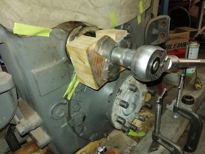

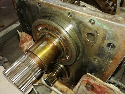

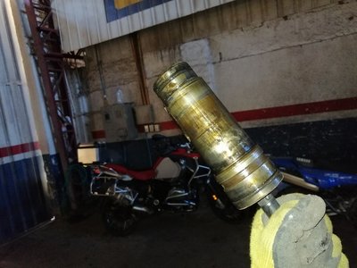

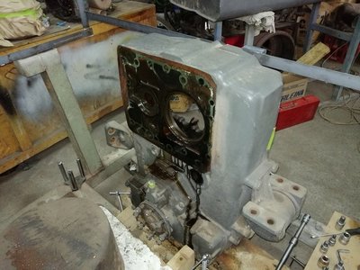

The next day, I easily removed the pressure plate with the aid of the winch and then carefully removed the flywheel. At inspection, the race was nice and evenly polished, as it should be, but there were clear traces of oil leaking from the retainer that, on its turn, looked pretty healthy too. Hmm…
Eduardo had to go to Valparaíso himself to pick some spares so he offered himself fully hearted (!?) to get a new retainer for me profiting of the trip.

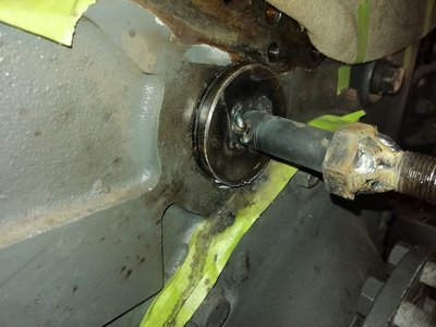

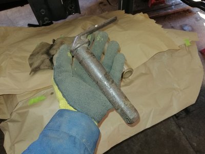

What to do in the meantime? He had given me an advice on what to do to extract the pin of the intermediary gear some days ago after seing the striking method did not work, but I had not given it a chance… until then.
Adapting things a little to follow his idea, I cut the sliding hammer and left the threaded extreme welded to the bolt to use it as a puller shaft. A couple of pieces of discarded and broken bearings served as spacers and the top of the self-made extractor gave stand and grip for the nut. Easy.
And it actually was. Uh.
Began to turn the big wrench clockwise and, after a minimum effort compared with the sliding hammer madness, there was a sudden release and the pin popped out from the surface of the gear housing. Great!
I was thinking on using the heating stuff to take the pin out, but this was far more easy and less destructive. Oh, I really like my brother in law!
Actually, it was only the beginning of the extraction that required a lot of other maneuvers and improvised spacers and patience, though, after a little while, the bloody pin was finally out in my hands and the way was free to access to all the bolts that kept the gear box fixed to the gear housing. Good.

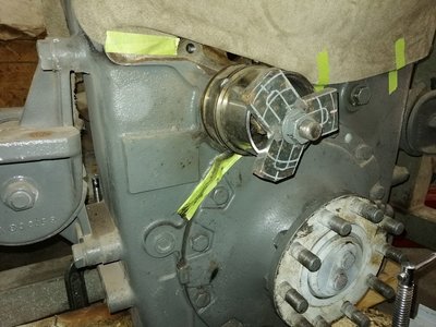

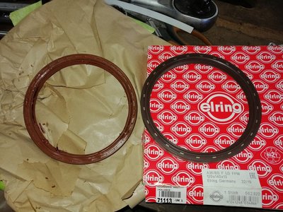

Eduardo, my brother-in-law, brang the new retainer for the pressure plate profiting of one of his trips to get spares to keep on with his business. The retainer was the same brand but looked more robust.

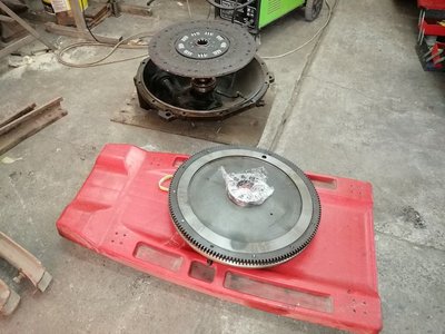

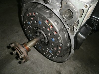

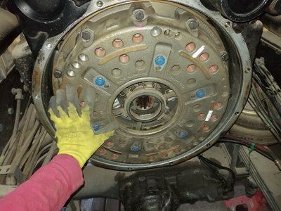

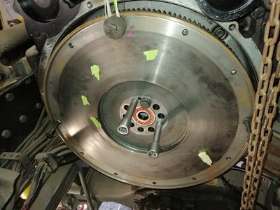

After cleaning all the pieces and surfaces for good, I removed the old retainer, that in fact looked like new, and made sure there was no damage to the housing. If something was wrong it had to be the retainer.
If I inadvertently damaged the retainer, it had to be during the installation of the pressure plate when assembling the engine, some time ago. So, this time I proceeded very carefully and hung the plate from the winch and used two extension bars from the tool sets that fitted perfectly to guide the plate smoothly into place. Easy.
I had to go back in time to look for the torque settings for the bolts that secured the plate to the cranckshaft, but finally found them in an e-mail from 2011.

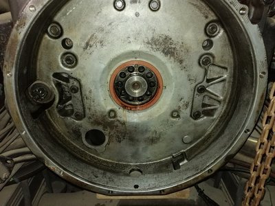

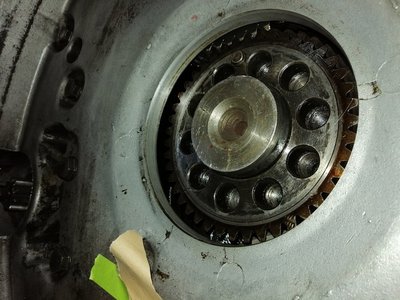

Then I put the adapter flywheel back on and adjusted the disc position with a steel strut, by eye only, trusting it would be a just one-time maneuver.
And it was. The intermediate shaft went in a perfectly centered clutch disc and the bell housing was secured with the many bloody bolts, with the appropriate torque, of course.

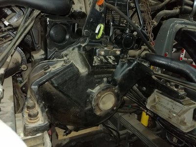

I bolted the engine supports to the bell housing, hung the engine from the winch, just enough to allow removing the wooden pieces from under the exhaust manifold, and then installed the clutch cylinder back on.
And then the oil leak issue of the back of the engine was solved. Now it was a matter of cranking the engine and see how it worked, pretty confidently… with fingers crossed.

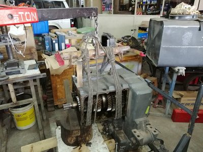

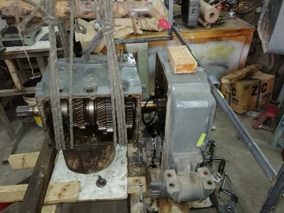

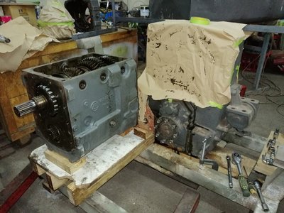

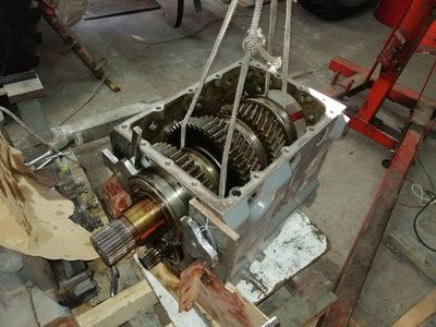

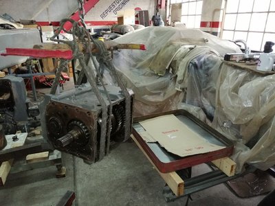

The gearbox, oh yes. Well, I got the portable winch near and rescued the chains from a forgotten box in the corner of the shop. The chains were more robust than the ropes and I wanted to use them to hang the gear box while separating it from the gear housing, but it was soon clear that they would damage the pretty sharp metallic edges, no matter what kind of arrangement I made with wood pieces. So, I got some ropes and hung the heavy box with them prior of taking the last bolts that kept both pieces together.
Naturally, there were among them some Allen bolts for which there were no appropriate Allen sockets, so I had to go out to buy some.
Then, after removing the bolts and with the aid of some precisely aimed strikes, the big parts separated nice and quietly.

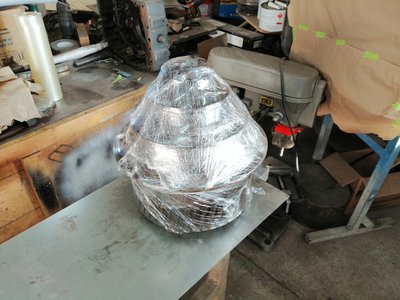

Some of the built-in circuits for the lubrication were clogged by the filthy gelly oddity found everywhere in the gearbox. Better for the future of the gears having disassembled it.

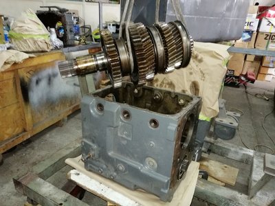

The gear box was a pretty heavy bastard, though I managed to accommodate it to have it resting on the side without taking it out from the winch. That way the main shaft was exposed upwards, ready to be taken out. Ready?
Soon after putting the gear box on a stable platform on the same trolley, I heard Carmen shouting it was time to go. Another week had passed and the progresses were quite slow, though at least there were progresses. I was happy.

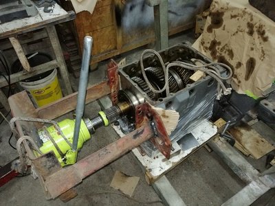

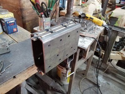

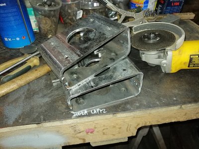

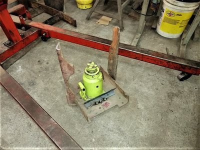

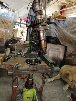

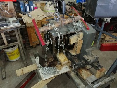

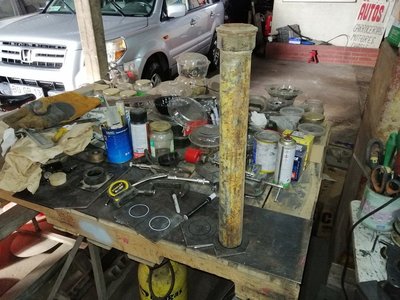

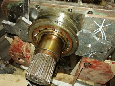

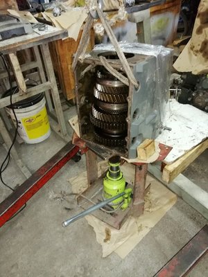

At the shop, next monday, to remove the main shaft and the gears from the box I needed to remove first the big bearing on the back. It was big and stuck like an avalon, as expected. Working carefully with the sledgehammer and a piece of bronze I reached to get it out of the case, milimeter by milimeter, just by using stoneage tech, but there was still a long way to go before removing it from the shaft itself. Hmm…

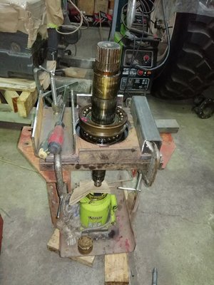

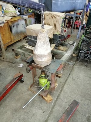

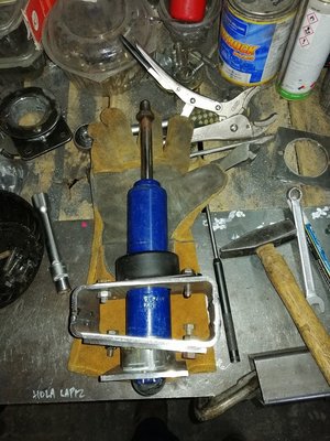

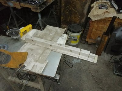

Eduardo approached and suggested to use hydraulic power instead of Neanderthalis strenght, again. I sighed and looked around and found the once projected support for the jack to push the kingpins on the steering knuckles. The ugly and odd looking thing actually was never used because the pins were put, frozen, by the sole push of the hand. It seemed a good idea at that time, though.
I made some measurements, cut the two pillars according to them and fixed the hydraulic jack pretty simply with a couple of pieces of steel firmly tacked to the base.
pairospam
Beiträge: 950
Registriert: 2010-11-22 14:27:25
Re: Mercedes 2626 AK 6x6
#1087 Beitrag von pairospam » 2020-05-14 3:39:10

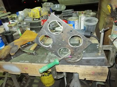

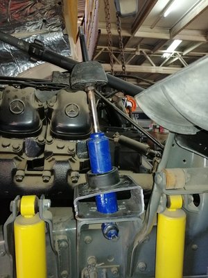

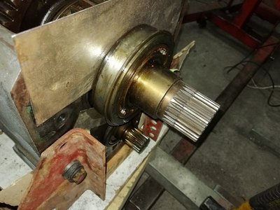

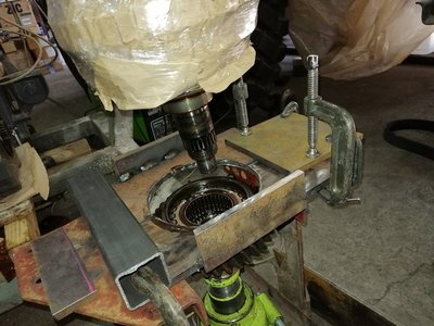

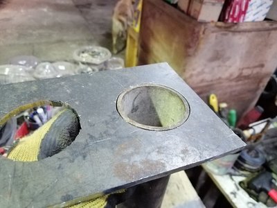

Then, drilled a couple of holes on the plates that served as stabilizers to match the bores on the cage to have a cleaner and tougher grip, and hung the jack to finally weld the pillars perpendicular to the holding plates with a pretty thick welding. And that was it: another Pairoa’s port-o-power.
But, always the big BUT, the jack did not work horizontally, as you probably all knew. Well, I didn’t. So, I had to hang the whole bunch of kilos of metal from the winch and put it vertically, or almost vertically to make the jack work.
It was then just a matter of applying a little pressure on the shaft, only the six millimeters allowed by the play between the gears, change progressively the thickness of the retainers, and eventually the bearing fell soundly on the jack. Took some time, but it worked. Thanks again, brother.
I got the neo-extractor free from the gear box and put the later back on the trolley to keep on with the disassembling.
Removing the shaft with all the gears from the box was relatively easy thanks to the winch and the ropes. Christ, how heavy they are!

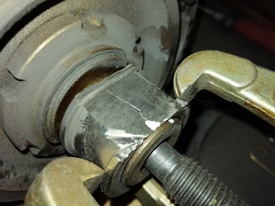

Once on the working tray, I made a vain try to take the front bearing out using the extractor. No way, and I knew it. Grabbed the powergrinder and the screwdriver and destroyed the outer bronze cage and took the rollers out with no mercy. I then grinded the inner raceway until it was so thin that a couple of strikes broke it loose. I was pretty afraid of damaging the shaft so it took me quite a while to get to that point.

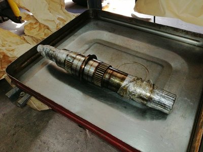

Once the bearing was out, the locking nut was exposed, another big task in itself. It was pretty clear, again, that the sliding sleeve was freely moving over the synchronizer’s hub as there were no end pieces nor springs at sight.
I will save you from the carnage of the removal of the locking nut, just tell that I finally asked Eduardo to help me to take it out as I was not able to do it without suffering. The chisel work is definitely not for me.

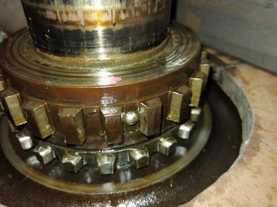

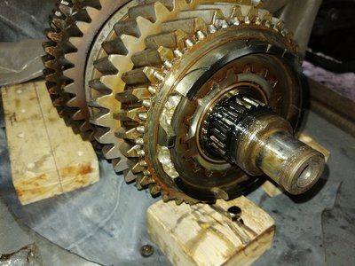

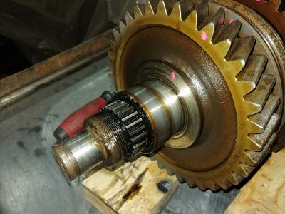

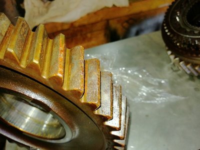

The following was a surprise: I removed the synchronizer hub and found that the cone on the side of the 3rd gear was also broken, in many pieces. I had seen before one of the little broken pieces when first opening the lateral cover of the the gear case, but I thought it was a piece of the broken 4th gear synchronizer cone.
Poor Merkabah. They really hurt her.

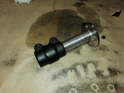

Removed the synchro cone, the 3rd gear and the needle bearing, exposing the underlying race that actually looked not too bad. The definitive opinion would come from Eduardo, but the problem was that it was as stuck to the shaft as every other piece of metal to each other in that pretty pretty gearbox, hmm…
I would have to modify the neo-press-extractor-port-o-power to take out the race and probably the other races still waiting to show up when disassembling the rest of the gear shaft. To do that I needed to go to Verardo’s pile of metal junk and get some steel pieces to play with.
One of the mechanicians approached and took me out of my calculations and mental designing reminding me that the Montero was ready for the final test. After quite a big servicing and the swapping of the transfer case they had it ready to check if the transmission was working properly.

#1088 Beitrag von a90 » 2020-05-14 23:44:13
pairospam hat geschrieben: ↑
2020-05-14 3:17:45
This is indeed quite tricky, if the disc is not exactly lined up, you'll end up with the gearbox not fitting.
When we had the gearbox of my LP out for clutch replacement we had nothing as a reference and we had the primary drive taken out for line up. Since the gearbox was also disassembled is was easy to do and once the clutch plate was lined up we placed the primary shaft back in the gearbox. Assembly was easy.

#1089 Beitrag von pairospam » 2020-05-16 5:38:13
a90:
Hello and yes, I remembered pretty well how tricky it was the first time, ending up in steel porno, but I definitely wanted not to disassemble any more of the bell housing or whatever.
Life, God, the engine... everything seemed to be cooperating this time. Why should it be so difficult? Just went on, with trust.

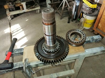

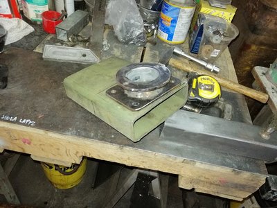

The big challenge of the last weeks had been, of course, the disassembling of the Zahnradfabrik Friedrichshafen 5 S-110 GPA bloody gearbox which resulted in the PITA everyone, except me, expected.

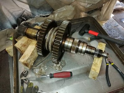

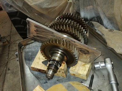

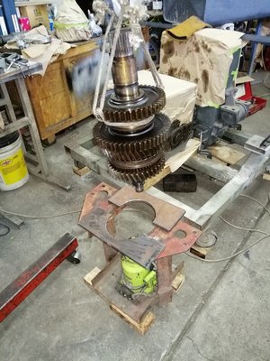

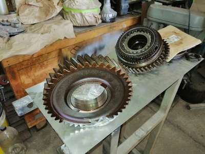

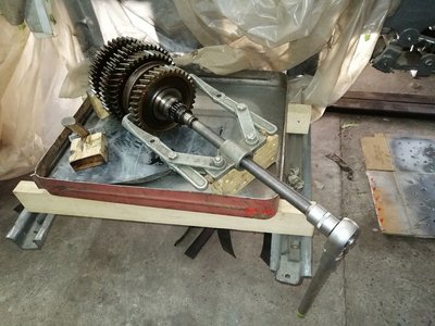

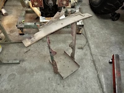

Trying to take out the 3rd gear from the shaft using the big extractor was a waste of time and a dangerous exercise. I could not use the hydraulic press of the workshop because it was blocked far away surrounded by cars and the shaft was heavy as hell, no way to take it there without the portable winch.

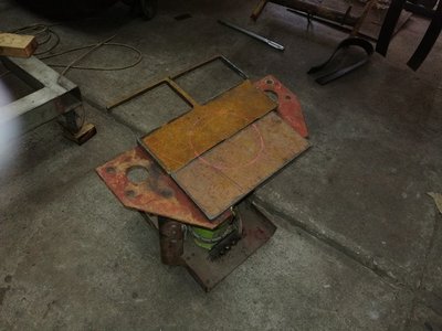

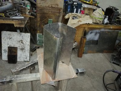

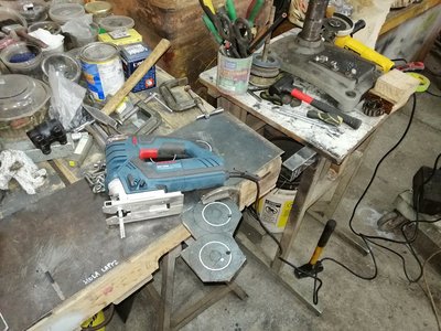

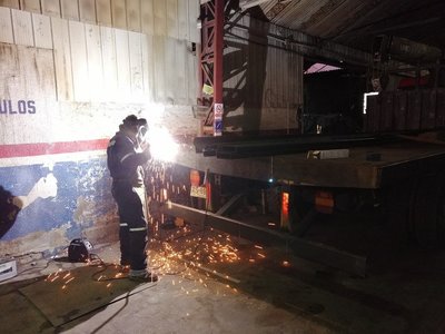

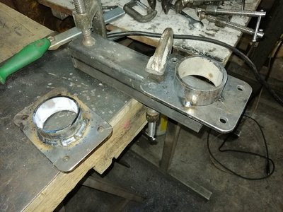

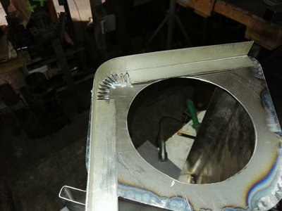

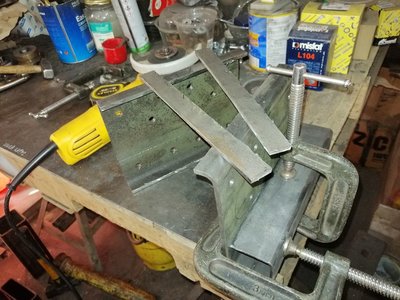

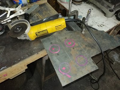

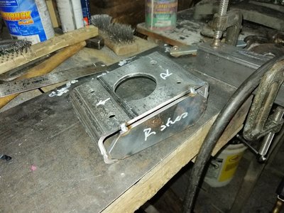

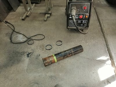

So, I got some pieces of scrapped steel plates from Verardo’s machineshop, cut and adapted them to go in between the gears and thus allow the compact neo-press to apply pressure properly without damaging the components.
I welded lateral reinforcements to strengthen the plates though I was terrified by the idea of some incandescent piece of molten steel going directly in between the gears and the bearings, no matter how far the shaft was from the welding place. So, I wrapped the shaft in a thick cocoon of paper and plastic. Too much?
Anyway, it worked, the press. The 3rd gear went out with not much pain and the synchronizer hub for the 1st and 2nd gears was exposed. Good.

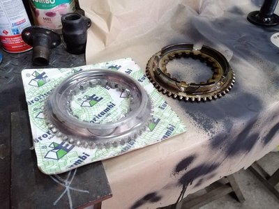

Next, the borrowed extractor was the best tool for removing the hub in this case and then the synchronizer ring and the 1st gear could be easily removed on their turn.
Each time I took a race or a gear out was like winning a little battle, and though it may look easy and fast it was not.

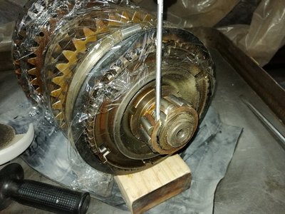

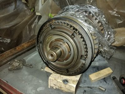

When the only gears remaining were the reverse and the slow 1st ones, it felt pretty releaving. I turned the shaft around and took out the reverse gear along with the synchronizer ring, paying much attention to the tiny steel bearing balls that served as stoppers for the sliding synchronizer ring. If I loosed them I surely would be in trouble.
Made an attempt to remove the big 1st slow gear but it seemed to be a little more difficult than the others. I checked the manual and realized that it had to be taken out from the opposite side of the shaft. It was hard to see at naked eye the edge of the lip on the shaft. Ops. Beware of enthousiasm, Pairoa!
I laughed at myself and I left, leaving the steel pieces and tools as they were. It was late and had been manipulating the shaft, the press and the winch the whole afternoon and my back warned me about keeping up that way. I was happy, though.
Next Sunday morning I went out with the dogs only for a shorter walk, as my back actually needed some rest.
The nice and fresh avenue where we live, full of trees and well kept grass, was being torn apart in the name of progress. It would become a beautiful four lane highway with a nice central array of street lamp posts, with no place for trees. Christ.
I was really happy with the idea of leaving the city soon.

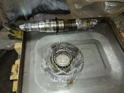

When back at the shop, the shaft was too long for using the neo-press, but there was not problem then for using the traditional hydraulic press, and the shaft was light enough to take it there by hand. Good.
After a few moves, the shaft was finally naked and all the components were ready for inspection, cleaning and, eventually, replacement.

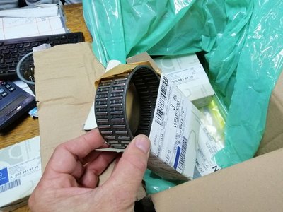

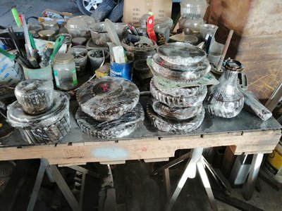

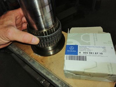

I had already bought all the bearings, some of the sliding synchronizer rings and rings, but I still was waiting for those that had been bought abroad. There was not much to do but to wait for the courier companies and the post to deliver.
I am extremely grateful to all the friends that helped with the search and the delivery of the parts, thank you guys.

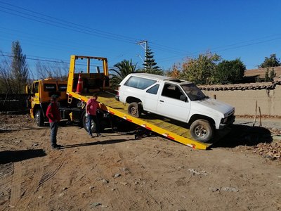

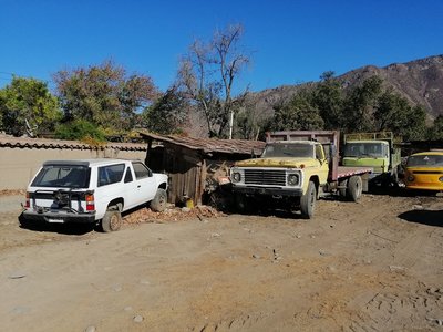

Do you remember the NissanTerrano? I had been not able to get rid of her after all this time. She was parked at home, waiting for a definition that never came, until there was no more option. Now I needed the place for the Navara and the Montero so I had to take her out.
When the towing truck came, even Carmen felt a little sad. We would miss her.

I found the replacement for the other broken synchronizer ring on a store in Santiago, but the rest of the spares for the gearbox was still trying to make its way through the convulsed customs all around so I was not able of making any more progress on that subject so, as usual, I directed my efforts to the pending stuff.

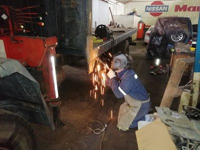

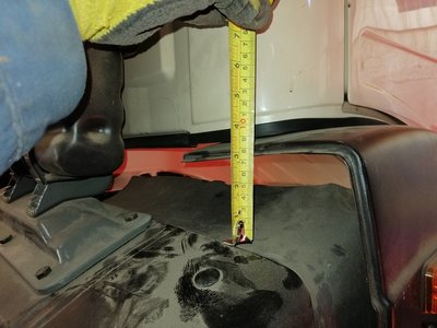

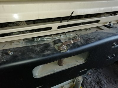

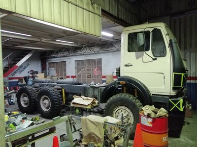

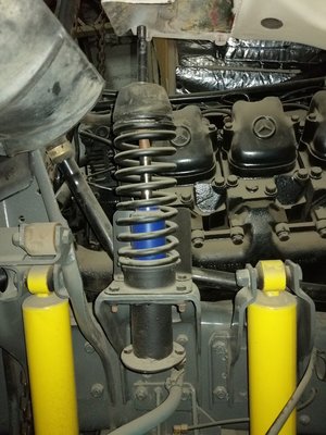

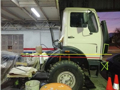

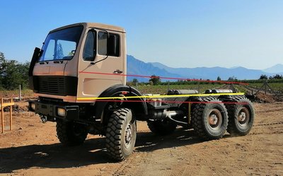

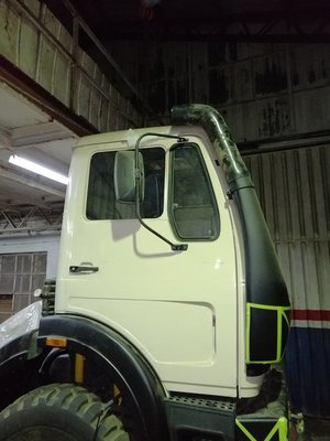

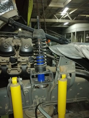

One particular issue that was still on the to-do-list was the backwards tilting of the cabin. When installed the suspension of the cabin of Spare, the front lifted nearly 9 cm compared with the original rigid suspension but the rear kept at the same level, and thus the cabin tilted backwards permanently, making the Merkabah look awkward and the sitting position a little uncomfortable, especially for Carmen as the butt section of the new seats was also tilted backwards a little.
I was also worried for the tilting because the rear of the cabin may be a little too close to the front wall of the Box.
With the addition of the seats, the dashboard, the insulation and all the stuff inside the cabin, the weight made the front lower a couple of centimeters, but it still was very noticeable. Something had to be made about it.
After some considerations and a little thinking, I thought I found the right way to solve the problem by lifting the rear supports.
At first I wanted to shorten the supports for the shock absorbers, especially when inspected and found that they were not original, though I preferred to make new supports and build supples for the support of the support. Right.

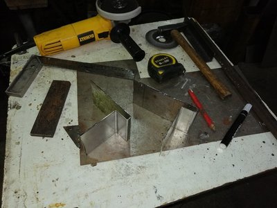

Looked around and gathered some metal scrap pieces to work with. Luckily there still were some.
The goal was to make a couple of shock supports seven centimeters shorter. It was a quite cold afternoon so I put myself to work accompanied by a big cup of almost boiling tea.
I cut the pieces and marked them. I needed to make big holes to allow the shocks go through and fortunately I had at hand the jig saw, the serious one. As the steel was only 5 mm thick it was pretty easy to cut.
The boring phase came next, when using the hand lime to make the rough edges even and to get the circles looking like an actual circle. The result was pretty encouraging but when finished the first one it was already time to go.
pairospam
Beiträge: 950
#1093 Beitrag von pairospam » 2020-06-11 1:29:43
The next day was pretty cold too, so I left on purpose the die grinder at home and kept up with the limes for finishing the pieces. Time was not an issue and a little physical effort was okay for fighting the cold.
While I was working with the lime I repeated myself that it was useless to work so hard to make the holes perfectly round. Who cares? You will weld it, it will be hidden forever, dude. Though, I made my best efforts to get perfect circles in the steel. Yes… I know.
Finished the holes, cut and grinded the flat pieces and then cut a couple of cylindric pieces to complete the supports. Then, I got the MIG welder and assembled it all.
I think it came out pretty well, pretty tough and with the right length to keep the cabin even, or so I hoped.
Next, I got a piece of rectangular steel profile to make the supples for the supports of the coil springs. I needed 7 centimeters to fit so steel strips supples were added as well.
Up to that point, no problems, just a lot of drilling, cutting and grinding with the lime. Then, I tried the new parts in situ. Hmm…
The arc described by the rear of the cabin when tilting made the raised tip of the shock absorber to go out of center, by far, and there was no way that it could work like that, even if there was some little play available. Ops.
Gave it a little thought and decided to tilt a little the supple and see if I could use the tolerance of the mounting to compensate for the inclined plane the shocks would work under the new situation.
Cut out a piece of the recently added supple of the supple, forced it to a carefully optical and mathematically studied angle and made a try. It looked like it could work.
It was really a PITA having to make it all again, particularly the part of cutting and regularize the damn holes, and taking the decision was not as easy as it seems. Anyway, it was not the worst thing that had happened so far so I grabbed the rest of the material I needed and put myself at work, again.
For the sake of easiness in building I changed the round bottom mount for a squared one, and changed the orientation of the lower mounting in order to make the shock pivot, though slightly, in the correct sense.

This time I brang the die grinder to the shop and I worked both with it and with the lime to speed up the process. It was not much faster, though.
Of course, the supples for the supports were both prepared, cut, welded and even flattened out to make them even.
Evolutionary lane.

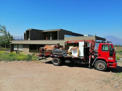

When the new pieces were ready I assembled one of the the mountings and checked if it worked, and it did pretty well. It was quite annoying to assemble the whole thing because of the tiny spaces to put fingers and wrenches on though, all in all, I was happy.
That Saturday morning the reborn red Ford Cargo was ready to go for a serious test ride, and Eduardo and I gathered at the shop early to take it out.
It looked pretty good, especially when remembering its poor state before renovation.
Unfortunately, when Eduardo was taking back into the shop the little Fiorino, recently renewed too, going backwards, the door suddenly got open loose just passing in front of the Merkabah. Ops.
The shiny Italian sportive pickup was no competitor for the big german truck and, steel against steel, there was no doubt about which one sustained more damage. Actually, the roller of the front winch and the bumper of the Merkabah did not even noticed the strike.
Shit happens, and even if there is some feeling behind every car or truck you take care of, it is just steel, plastic and paint. So, we shrugged, took all the cars back into the shop and headed for the countryside in the roaring Ford Cargo.
Surprisingly, it was very quiet comparing with the Merkabah, even if there was still some work to do on thermal and sound proofing. Or was the Merkabah too noisy?
Anyway, we made our way through a heavy traffic despite the restrictive measures and the engine behave pretty good. Eduardo did a very good job, as always.

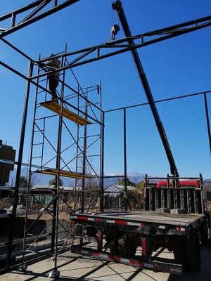

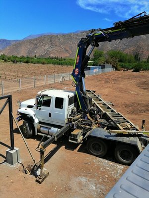

At the construction site in the country, we used the crane to help with the build of the roof of the new barn/garage/shop. Ramón, the builder, was happy with the aid that saved him a lot of time and efforts.
Eduardo maneuvered the crane with growing skills and was on his turn pretty happy with the truck: We have a new toy, Pairoa!

Back at the shop, monday afternoon, I gathered all the pieces, again, gave them a final retouch and reinforced the supples with a lateral vertical plate. It gave excellent resistance but made the assembly even more complicated, though.
As the weather was pretty cold and the painting chamber was occupied with another truck, I decided to assemble the supports and the shocks and leave them on until the conditions were more propitious.
Once both rear supports were in place, I measured the gap that I was waiting to find between the two portions of the mudguard, and it was bigger than expected: 8,5 instead of 7 centimeters. That difference made the cabin tilt frontwards slightly but noticeably, though I was sure that the height would diminish when the truck started to move and the coil springs settled, hopefully the same amount required to make the cabin even with the horizontal (yellow line on the picture).

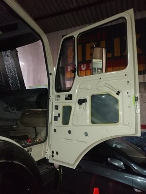

Opened the door of the passenger side to see if moving and jumping inside the cabin would lower the gap, but it was very noisy and the door was stiff. I inspected the sliding piece and realized that the superior hinge was loose. Ops.
I once suspected that I had not tightened the bolts of the hinge, back in time, just after putting the inner lining of the door, and I left the job for later, when the inner sealing gasket was available and had no more option but to take the lining out.
Well… the lining went out, and despite being careful a couple of plastic pins broke and other went loose from the old and desilusioned lining.
I adjusted the door, making it fit better than before, and tightened the hinges. Went out to buy some more plastic pins and applied some glue to try to repair the holes in the wooden panel of the lining. It was late when I finished and so I left the lining and the glue out to dry up.
Next morning the first thing I did was to put the lining back on the door, even before saying hello to the people of the shop. Good. No harm.
Went up into the cabin and moved and jumped inside, with no effect on the rear height. Then I pulled the lever to open the door from the inside but the mechanism was not working. It was perfect before. Plop.

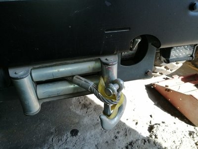

I was at it when I tumbled on a piece that I had left for missing some time ago: the towing pin. It was the original one, bought from a crippy guy, do not remember when.
It was better to do something before loosing it again, so I drilled a hole on the handle and grabbed a piece of chain. I wanted to chain the pin to the frame to avoid it to be stolen, though I found the chain a little bulky, hmm…
Thought about fixing the pin with a cable instead, lighter and quieter, so I searched among the trash of the workshop for discarded clutch cables and found the one I was looking for. It came even with a plastic sheath, perfect.
Eduardo came by and reminded me that anybody with a cheap wire cutter could come and get away with the pin and with my most elegant cable arrangement.
So, chain it was.

Life goes on, corona-damn-virus or not. I see from other threads that there is a lot of people working on their projects and keeping up as they can with their lives and their routines. Good.
Seems that the world had come to a sudden stop, and the parcel with the parts for the gearbox had been returned to the sender at least twice so far, before even reaching the German customs.
In the meantime, I went on around trying to resolve the details that were left for an uncertain tomorrow after.

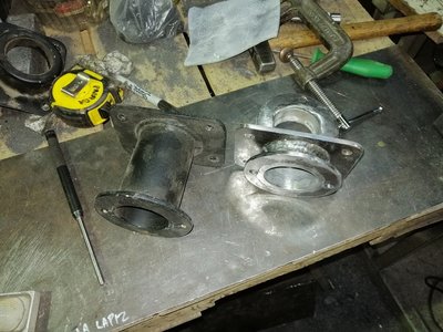

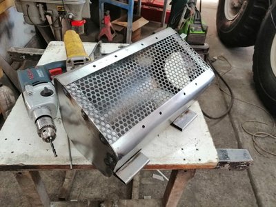

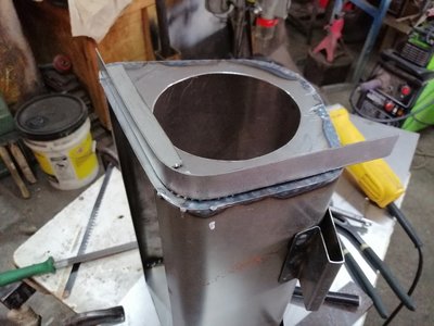

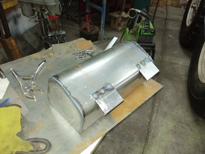

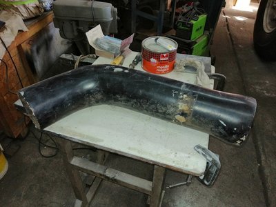

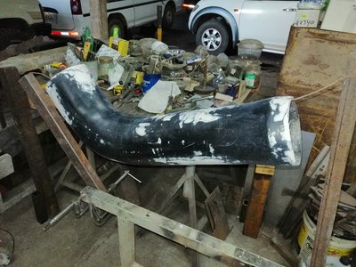

The upper piece of the snorkel was lying still on a couple of dusty boxes since quite a while. Eddie did not touch it and only restored the bigger lower part, so it would be my own job to get the tube back to its purposedly life.
It was a very robust piece and had so far withstand a couple of drops without any major damage. I put it in place and seemed that it all fitted pretty well, even if I could not find the ad hoc bracket.

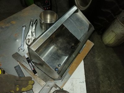

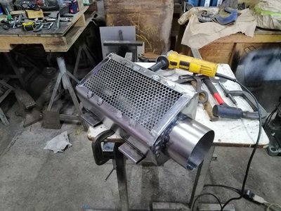

The problem was the prefilter box that went mounted on the waterspout, whose actual name eludes me. It was in a very precarious state, beyond any possible recovery. It came from a scrapped truck from far in the deep south, and of course it was not the original part.
So, having time and plenty of energy to do it, I decided to build a new one myself.

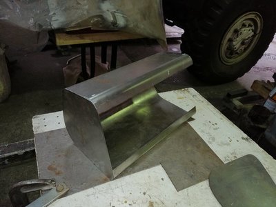

I looked around but there was not a single piece of steel sheet left to work with so I went to Verardo’s workshop and got some more material from the scrap pile.
The difficult part of making round sized objets with steel sheets is, of course, shaping the metal to get the right curves. I actually was not on the mood to think of building some sort of folding device, I just wanted to shape the sheets and weld the thing right away. Patience was a scarse asset at those moments.
Looked for any tubular object in the workshop, and found an appropriate cylinder sleeve and a couple of empty paint cans that I tacked together with the MIG. Then, I aligned them on a trestle and worked by hand the metal sheet until I got the curve I wanted. Good.
Repeated the same exercise a couple of times with different sizes of cylinders following the sketch of the original, or semi-original, prefilter box. Pian piano the shape of something new began to emerge from the metal. The mechanicians made fun of me saying I was fabricating some sort of stove to fight the cold. Hmm…

Verardo offered me a piece of a very appealing inox filter sheet to complete the box/stove, but I had to wait for the moment he will cut it to fabricate whatever he needed to fabricate.
One almost forgotten piece of the rear wall of the cabin of the Merkabah that was cut out when opening the pass-through was the donor of some more thick material to work with. Every piece of scrap, as usual, may become pretty usefull, and you do not know when you might need it.
I went on cutting, curving and welding metal until I had no choice but to wait for the promised inox piece.
There was a clear and present threat that there would probably be a lockdown that included our region, a desperate and counterproductive action necessary to manage stupid people that do not observe minimal directives to watch out for their own health.
Anyway, as I probably would not get too far with the prefilter box of the snorkel I preferred to give a hand to Eduardo. He decided to restore the bed of the Ford and I helped him to replace the side members for some more robust ones and to replace the rusted and ugly dented rear fender as well as to repair and reinforce some spots.
I cut and shaped the metal pieces and prepared them while he was charged of welding them with the arc welder. I was so used to the MIG that working with the electrodes and the arc was not my favourite job.
Those evenings we were given nice views of the sunsets, some of them pretty spectacular. They were there for free but, naturally, not too many appreciated them, prisoners of their own hurries and fears.
We worked until late but did not get to finish the job. Next day, yesterday to be precise, we continued where we left it and I cut a couple of large and heavy pieces of iron sheet for the rear end of the bed and welded them together using the MIG. A different stuff, of course.
Earlier, I firstly had decided to build a mobile bridge crane, like the one I used to borrow, to keep it permanently in the new garage/shed in the countryside, but when aiding to build the roof with the crane of the Ford I got convinced that it was far better to install a medium sized overhead bridge crane instead.
After discussing the idea with the builder and with Verardo, who knows a lot about steel, and do the maths, I ordered some profiles and some pieces to be cut to build the trolley and mount the crane. Verardo ordered the profiles for me, with a little discount, of course.
It was getting late so we tack welded the rear plate of the bed and went to Verardo’s machineshop and loaded the brand new iron profiles along with a couple of steel beams that I had bought a couple of years ago when I had the idea of building a massive rigid overchassis to install the living Box on. They were a little rusted, but they will be worked out so they would become the shiny bridge girder of the crane.
Back at the shop Eduardo got the welder and went on with the welding of the rear plate of the bed, consuming lots and lots of electrodes. I was waiting for him to finish to grind and make the final retouches, but it was already time to go home when he completed the job.
We made order, well… some kind of order, and we all left. It was the last achievement before the complete lockdown.

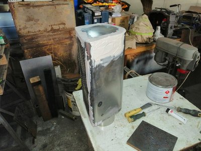

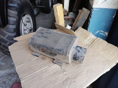

As I wanted to finish the prefilter box or particle separator, whatever its name may be, I got a discarded filter element of some old truck and cut a piece out of it and made the grill up from the metallic sheet. Maybe it was thinner than optimal but I was not keen on wandering out looking for the perfect piece.
With the front grill in place, I was able to weld and close the box. It looked okay, not perfect of course, but it was okay for the times and the mood being. It needed some more work, though, and the restrictions due to the f…ing “pandemic” prevented more people to come to the shop so I decided to do the plaster and the paint job myself. How hard could it be?
And, actually, it was pretty fun. I had not worked with plaster seriously before, leaving it all to Eddie and then to Joaquin, both of whom make a living of it. It was a little piece, of course, and so it was quite easy and pretty useful for perfectioning the technique.
Once the prefilter box was ready I grabbed the upper part of the snorkel and began to prepare it for the same treatment, as Eddie did with the big lower piece some time ago.
After a few sessions of grinding, plastering, grinding and plastering again, and more grinding, I was happy enough to give both pieces a few hands of primer and more fine grinding.

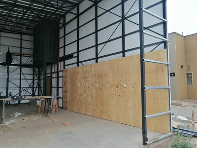

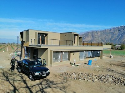

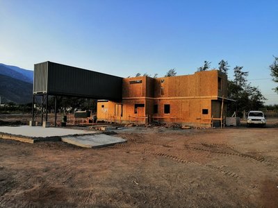

In the meantime, I was trying to have the new garage for the Merkabah ready at the countryside, with not big success so far.
The building of the new house had taken more than a year due to many problems and delays, and it is still not finished as I write this. We moved in just a moth ago and we have arranged things and ourselves to make our new home liveable without the kitchen furniture and a lot of other important items that still have to be built and installed but, all in all, it has been great so far.
The canine crew grew by three, with one new dog rescued from the streets and two other pretty nice and gentle ones that lived in the neighborhood and fell in love with us and viceversa during the building. You can count them by 13.
The cats are now “only” four.
The big difference, though, is that just the oldest and smallest two dogs and the cats are allowed indoors, and the rest of the dogs are kept outside. They have plenty of space and they look and feel pretty happy, all of them.

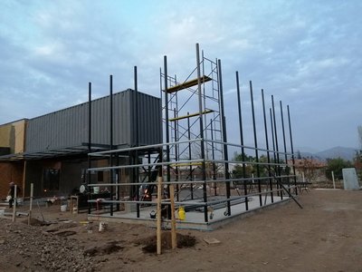

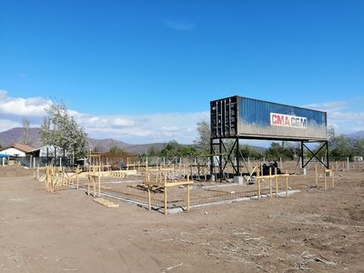

Hope you don’t mind, but I will show a few pictures of the build now that it is almost complete.
We built a very simple house with big open spaces, connected to a big maritime container that served as warehouse for the building materials and became a quite big closet and at the same time the roof of the parking, connected on its turn to the shed/garage/workshop.

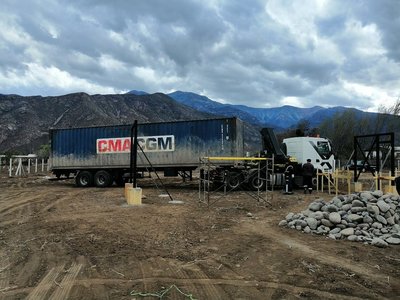

It all began with the building of the front gate. It was the test for the contractor as to see how he performed and delivered. He was okay so we went on with the rest of the building.
I hired another guy who built the bridge to pass the irrigation ditch, and I asked him to build it bulletproof, thinking on the Merkabah and any gigantic wohnmobile that at some moment could ask for a place to rest in a near future. He also built the perimetral fence. In my country, as in many others all around, you have to begin with the closing of the perimeter or you may not find the building materials the next day. Sad but true.
The truck that brang the container in seriously put the bridge at test and barely made it through the gate, missing the pilars by just 3 cm. It was a close call though my guessings when dimensioning the gate were not so wrong.
Zuletzt geändert von pairospam am 2020-11-26 14:29:35, insgesamt 1-mal geändert.
pairospam
Beiträge: 950
#1105 Beitrag von pairospam » 2020-11-26 5:19:32
The container was the first structure readily visible, so the build got a lot of eyebrows up and disconnected comments, and no one in the neighborhood was able to figure out what the finished house would look like. We laughed a lot with it.
Unfortunately, the container itself was criticized for it was dirty and had lots of bruises, testimonal of countless port struggles and bumps during a life crossing the seas around the globe.
Eduardo convinced me to get better and bigger containers, another one for himself, and leave the blue one to make up a warehouse and shelter for agricultural machinery nearby. Carmen added a little pressure and, finally, a second truck came in twice more with two better looking and taller containers. The truck was not cabover, and it was way longer than the first one. It missed just by 1 cm both the pilars of the front gate, me shouting and sweating trying to save them from being smashed by many tons of steel, twice.
To save money, the company sent the driver alone to do all the manoevers so, guess who, for the sake of time and safety, ended up making all the work of hooking up and unhooking the three containers? Yes.

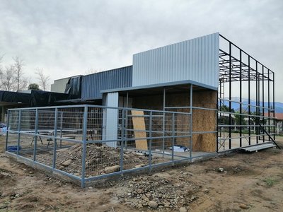

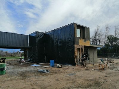

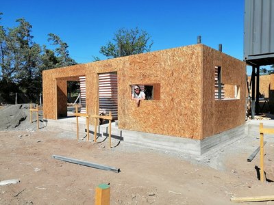

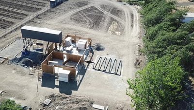

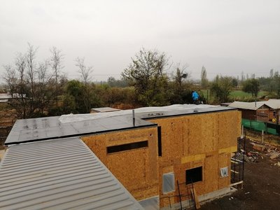

The building went on and once the foundations and the radiére were ready the panels for the walls and the roof came in. The layout of the passive AC system was also displayed and it all looked pretty good.
Once they started to erect the walls it all went pretty fast and Carmen and I were quite happy and excited. They also began to set the foundations for the garage/shed.
In short time, the i-joists to support the roof were mounted and the house and all began to take shape.

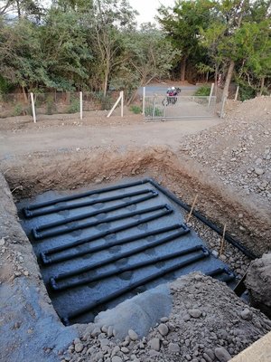

A good guy with his noisy machine made a huge hole to bury the piping for the AC and the contractor carefully placed the pieces in and then covered it all with a thick layer of sand.
The good guy then put the earth back on and compacted it as good as he could but, unfortunately, a huge amout of rocky soil was left out and piled as a little mountain range right where the road for the vehicles was planned to be. Hmm…
The roof and the second floor took shape too as the build carried on. The container was slowly engulfed by the house as the bypassers and relatives began to understand what the design was about.
Zuletzt geändert von pairospam am 2020-11-26 14:34:11, insgesamt 1-mal geändert.
pairospam
Beiträge: 950
#1106 Beitrag von pairospam » 2020-11-26 5:30:36
The interior work was also very encouraging and gave us a clear notion of what we were going to have in the end. I, as expected, changed a lot of features on the fly to make things work better for us and for the building itself, and even if both the architect and the contractor were reluctant at first, they agreed in the end that my ideas worked in a better and simpler way than originally projected by them, like the stairs, made of one removable piece.
Months passed, and things got a little creepy with the advent of the “sudden” political unrest that suspiciously caught my country and the rest of the world, coronated by the more suspicious showing up of the corona f…cking virus hysteria. Building materials became scarse, delivery times became eternal, restrictions for personal displacement and many other problems surged and made the building take a dangerously slower path.
The house was slowly growing, but the rain season was ad portas.

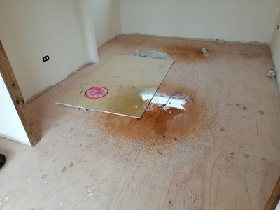

One day, as expected, it rained, quite a lot, and nor the walls nor the roof were fully waterproofed yet. There were some problems between the building personnel so the response was critically delayed and the house suffered the consequences, and so Pairoa.
The water damaged some wooden structures and finishions, and that meant more time for the repairs, time taken from the building time already delayed by a couple of months at least.
It was a hard period, though we got through it and the building went on. There were some days when we wanted to give up but the house slowly and perseverantly continued to grow and looked everytime more like a real home.

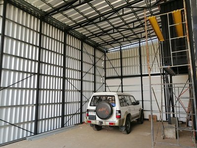

In parallel, Ramón the contractor began with the building of the garage/shed/workshop, high enough to couple with the container and to allow to work and build the Box of the Merkabah. I was happy again.
Another rainy week caught us with the damaged south wall still to be repaired and prone to more water damage, but this time Ramón prevented more trouble (and Pairoa’s anger) covering it with plastic sheets.
It looked horrible and dirt cheap, but it worked. Besides, the house got a higher value as we had a new great view to the lake.

Then, finally came the day when we had all ready to move in the new house. I had been sleeping alone there for a couple of weeks, guarding the fort. I had already made countless trips back and forth in the Navara carrying lots of boxes filled with all our belongings. The container was in fact half full of boxes.
The recently restored Ford Cargo helped to complete the moving by taking all the big stuff from the city to the country.
We got valuable help from friends and family members and it all went pretty smooth and quick. The dogs and the bikes were successfully taken to the new place with the aid of Eduardo and his wife, Alejandro and the rest of the crew. The container got filled to the top. My back stood and nobody got injured. Good.

Unfortunately, though, the regular work had become tougher and tougher because it seems that many guys developed a strange taste for smashing their cars or their heads against other cars or any hard object around, so I had little or no time to spend on the project. Moreover, the restrictions on the private businesses regarding the closing and opening hours played also against the available time to work on the shop, legally, I mean.
When I could, I prepared the main shaft for assembling, enjoying the sensation of having finally all the pieces needed.
Started with cleaning it all with a big amount of diesel fuel and very fine grinding with 1500 sand paper following Eduardo’s instructions.
The damn intermediate pin was also treated and cleaned for good. Then, one by one, every gear and component was re-inspected, cleaned and prepared for assembly.
There were some gears that had rusted superficially but notably, so I got rid of the rust with powerbrushing.
After what it seemed an eternity, the pieces were individually wrapped in plastic film to make sure they did not get dirty again, as there was a lot of wind those days and the dust settled at plain sight on every object around.
Anyway, I had not enough time to continue working for a couple of hours continuously.
The big gear cluster received also the proper beauty treatment to make sure there were no dust or impurities inside after all these months of waiting.

On my way to the scheduled visit to replace the tires, precisely the rear one got flat after a couple dozens of kilometers and it refused to go further. It was definitely dead.
My friend/brother-in-law came to pick me up after a couple of hours and we struggled a little to get the heavy lady on the pickup. 230 kg are not so easy to handle, especially when the rear tire is flat.

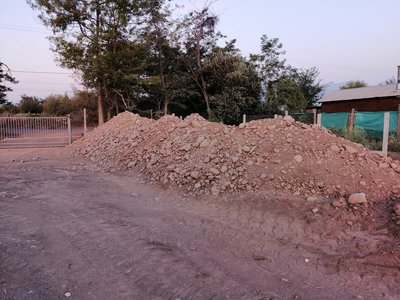

Back at home we profited of the pile of dirt and rocks to help with the unloading and it went, then, pretty easily.
As Ramón resumed the work on the house and on the workshop/garage, he completed the siding of the working place where the powertools and the workbench would stand. I badly wanted to finish it to begin with the rest of the building of the project, but I was pretty aware that it was highly unlikely that the Merkabah could be moved prior assembly of the gearbox, back at Eduardo’s workshop.

Last time I went to the shop I tried to use only a bit amount of heat and gentle push with the rubber maze to assemble the rear synchro hub, with no success.
Eduardo prevented me in advance that, no matter what, I would probably need to use the vertical press to assemble the gearbox and, as always, he was right.
I then searched for the right strut to make sure the pressing force would be evenly distributed and ended up with a cylinder sleeve perfectly fitted for the job, but I needed a longer tube to reach out and apply correctly the press.
So, I went to the used-steel shop and waited for a long row of people to be served before me and then begged the owner to cut just the little piece of tube I needed. Fortunately, the worker recognized me from a previous meeting and made me that little favor himself. Good.
When I got back to the shop, though, it was already late in the evening. Before going home I cut straight the extremes of the tube and left everything ready to weld the sleeve and the tube the next time.
With a twitched grin I made a little order and left. Another day of doing little or nothing at all.
