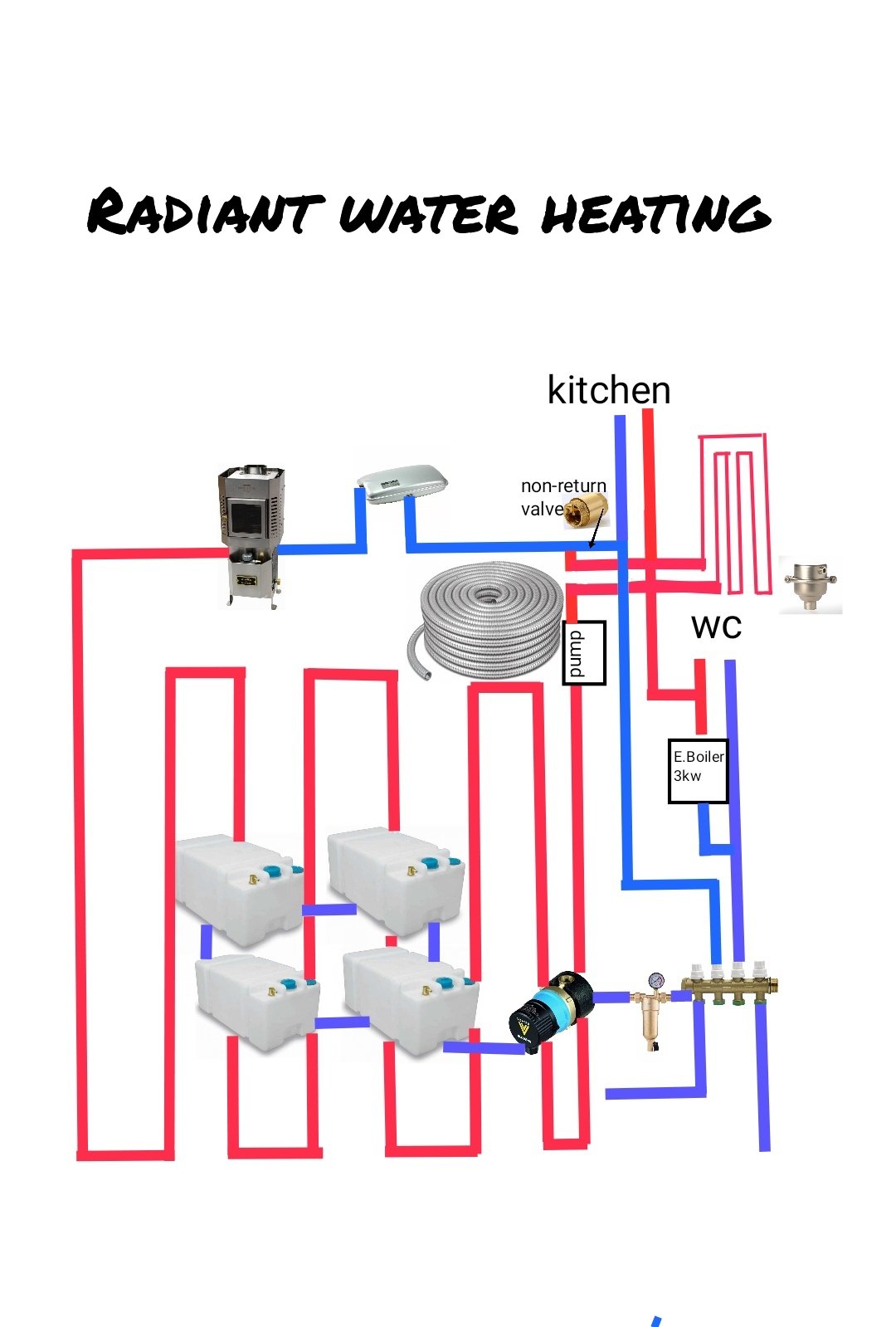

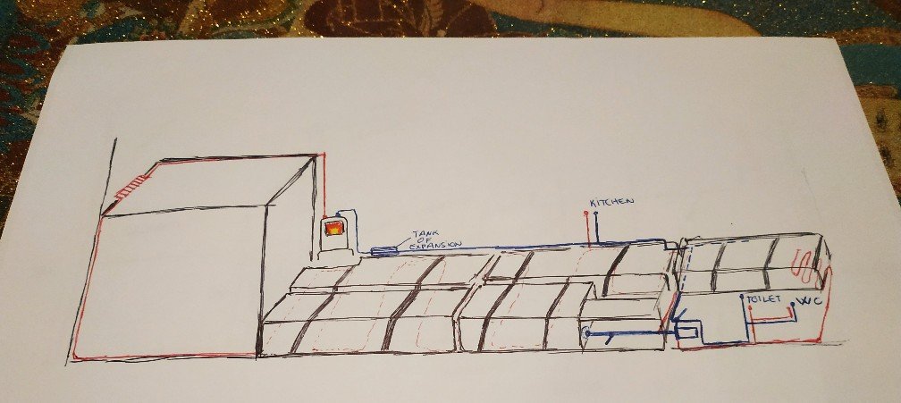

I would like information about a hot water heating system.
In addition to a very good insulation for heat and cold, we have a diesel stove without electricity consumption.
It has a tube turn to heat water, I want to make an endless hot water circuit with pipe. In this way I intend to protect the water tanks against frost and keep us warm. I have calculated 40 meters of hose, from your experience, do you think that a tank (or small boiler) of hot water is necessary to cause the continuous movement of water?
Or maybe with all that long travel and an expansion vessel is enough?
