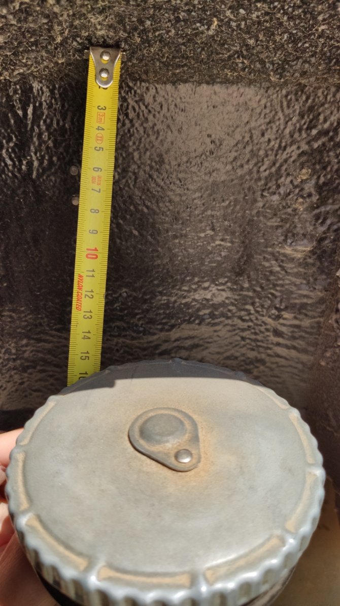

die vom Werk aus maximale Verschränkung findet sich im Abstand von Oberkante des Tankeinfüllstutzen bis zum darüber liegendem Blech der Einhausung des Stutzen. Gemessen sind das 15 cm, genau diese 15 cm habe ich damals auch bei meinem Diesel Zusatztank berücksichtigt. Mag sein daß die Konstrukteure in diesem Maß 3-5 cm Sicherheit berücksichtigt haben.

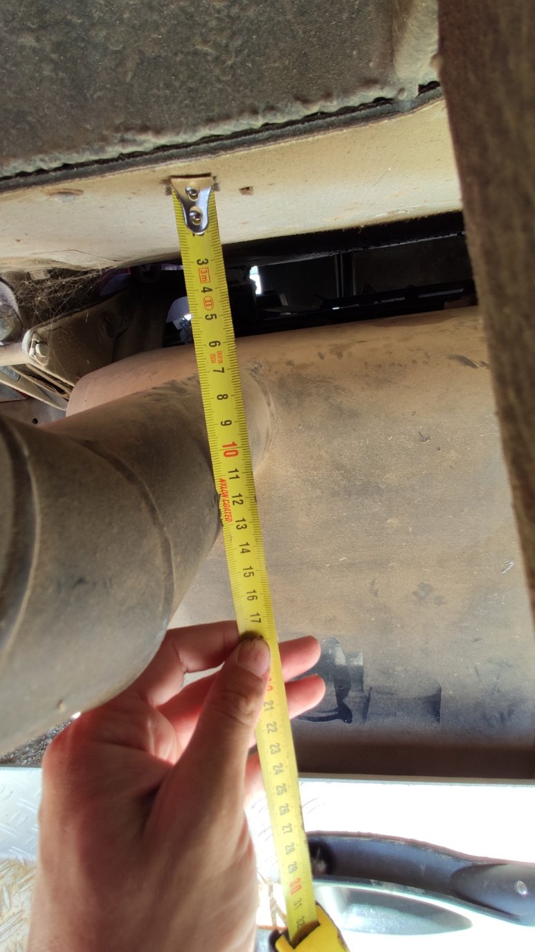

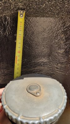

I had a look and indeed the distance is 15 cm from the top of the filler neck to the sheet metal. I noticed however that the rest of the neck is about 7-8 cm from another corner. I have attached two pictures.
Could it be the maximum entanglement is 7-8 cm? Or perhaps the distance is not accurate since the cab moves sideways and not up/down?

Yes exactly. I also measured the height at the neck, there it is 9 cm for me.
The largest up / down movement takes place at the rear outer edge (corner) of the cabin. Therefore I think you will get along with about 12 cm including the safety distance.
This was the easiest way for me to determine the entanglement.
Gruß, Carsten
