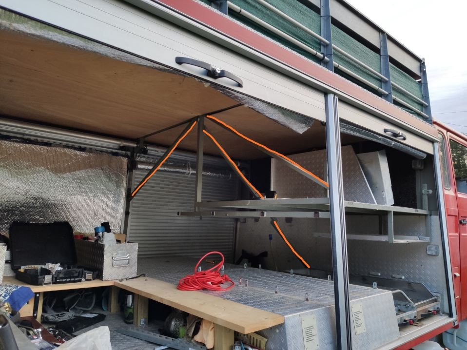

I am currently clearing out the remaining internal steel beams of the Iveco 90-16 box/structure.
Are the triangle support beams important for stability? Or can I safely remove those? I have attached a picture. The question is whether I can remove the 3 beams marked in orange, or not? I believe I have seen photos of completely cleared out 90-1-6 boxes before...

I have removed these 3 and I can easily stand on the roof with one person.
No worries, cut them out....
Someone said that roof is build to take the load of 8people, with the triangles.
Edit: the one strut in driving directions (x-direction) might be a little more critical for braking maneuvers. I have closed the sides of the structure, an all my x-loads from the roof can go there. So it depends on your other structures if you can follow my example.

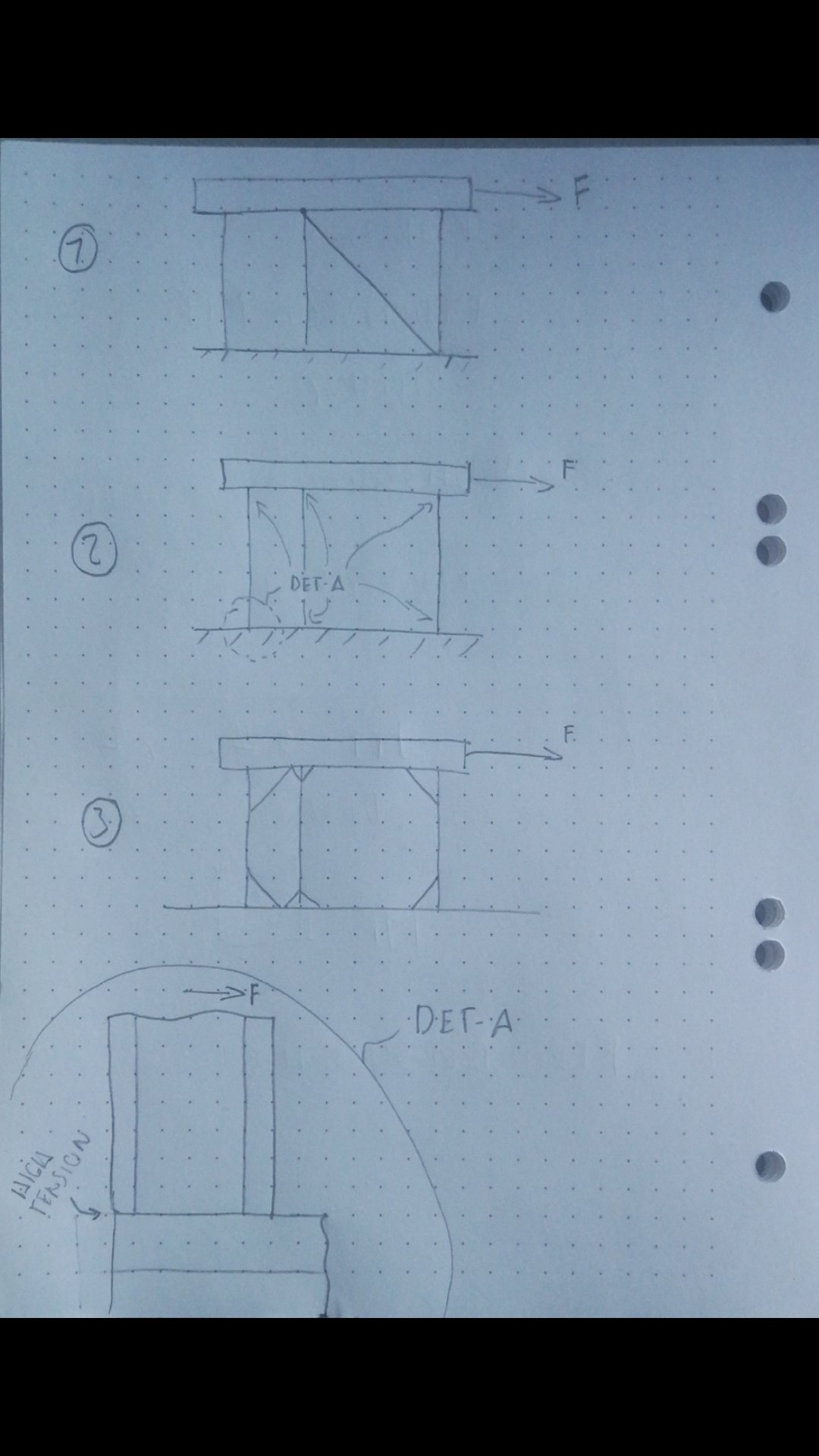

Figure 1 shows the original condition
Figure 2 your cabin with removed strut
Figure 3 shows my proposal
Detail-A shows the high loaded area if you don't reinforce the structure
Kalle12
Beiträge: 198
Registriert: 2018-05-02 22:36:20
Re: Iveco 90-16 Original Structure - remove triangle support beams?
#11 Beitrag von Kalle12 » 2020-04-20 20:48:35
Thanks for a great drawing, I understand your explanation.

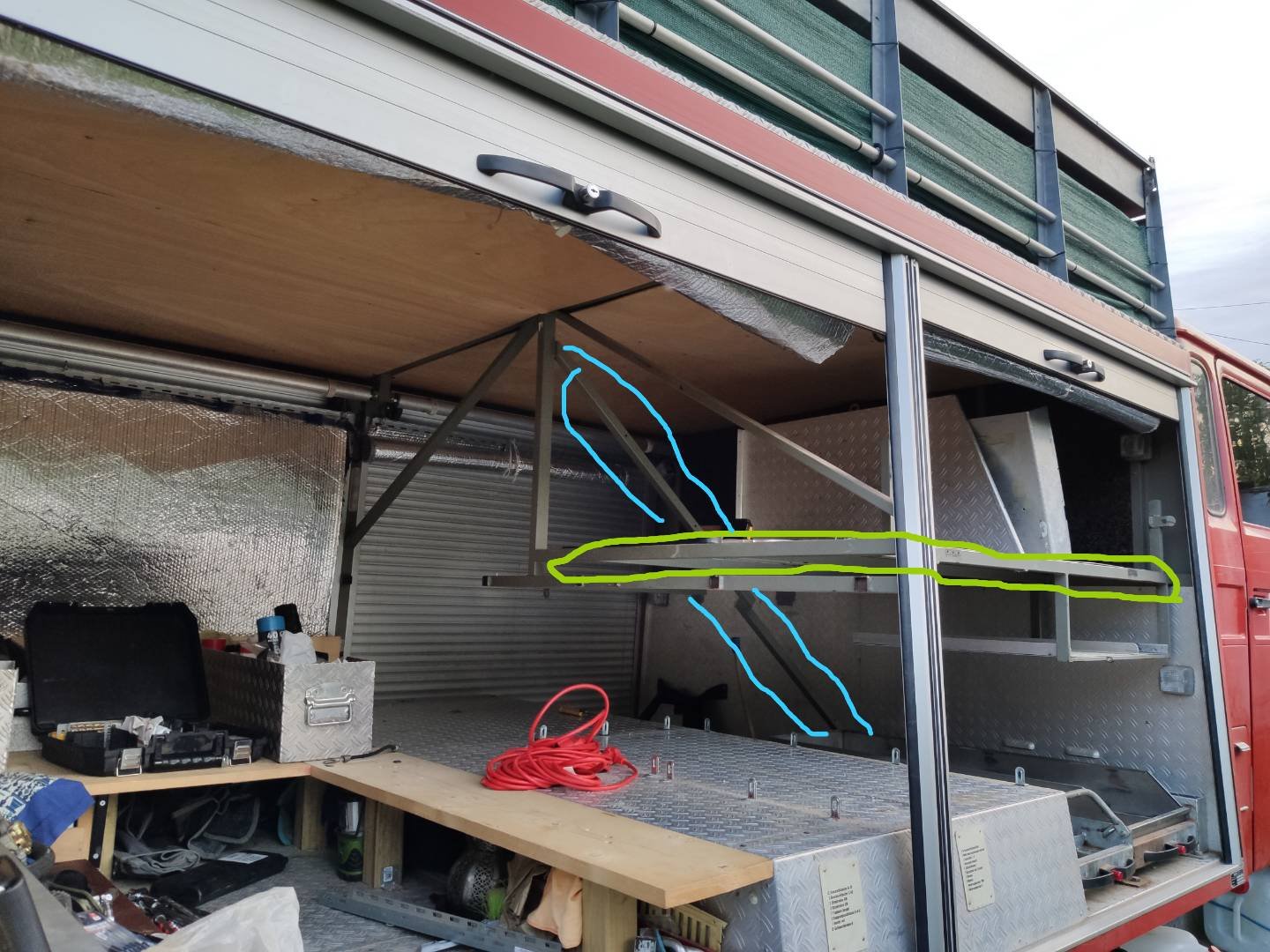

Did reinforcement for x force come from the blue strut, or the blue and green struts together? Perhaps I can safe some of the green struts and the blue strut in that case, and build around them.
hugepanic
Beiträge: 2881
#12 Beitrag von hugepanic » 2020-04-21 6:46:46
If I see this right the green strut has been removed from left to center. The left-to-right part of the green strut (if left intact) reinforces the roof. It builds a triangle like in a house roof structure.
This triangle is now not intact, and can be removed intirely.
For x loads, only the blue strut is necessary.

#13 Beitrag von Kalle12 » 2020-04-21 14:46:16
hugepanic hat geschrieben:
2020-04-21 6:46:46
Yes it's correct, the strut from left to center was removed and broke the bigger triangle. The right part was left intact as this was my old storage area. Now I'm removing the remainder of the green struts.
Regarding the broken large triangle, they still form two smaller triangles in the left and right corner and connecting in the center of the roof. Although weakened, wouldn't these smaller triangles still provide some roof support for z forces?
