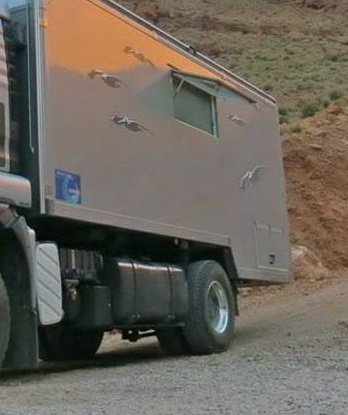

I have sent this image and resolves in part, what do you think of the experts? Regards

von hugepanic
that Z-Bend in the last picture does not look well designed.
The overlap looks pretty small for such a big profile. -->
OR the profile is way oversized... anyhow, it looks weird and that is never good...
Usually you want champfered ends of such profiles to allow a smooth load transition.

Hello, If I do not see it clearly either, that's why I ask for advice if someone knows a job with "Z" chassis and reliable rear garage!? it would be very valuable for our project :spiel:
