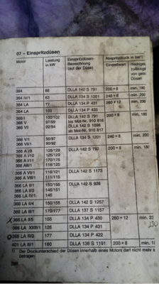

Does anyone know what would separate this one for a 240hp unit or if there is a recommended way of tuning it? Pump needs to be redone and perhaps nozzles are different?
Generally speaking the (O)M366 is listed in the EPC in 16 categories (different truck categories/industry/domestic both an foreign markets/LPG/...) with total 327 ! designs (German: Baumuster).
What separates the 156 HP, the 170 HP from the 211 HP or 240 HP type varies gradually over many designs, and years. I think few people oversee design changes completey since the Merc-Guys have retired or passed away. Of course you know that the mode of functioning of thermal engines means to optimize the engine itself as well as its environmental components. Harvesting more power from one and the same basic engine implicates that additional heat needs to be taken away (to finally ventilate to the air).
The strongest permorming OM366 can have either:
  • a bigger oil pan
    oil pans with different capacity
  • a bigger water cooler or other grid designs
  • another fan wheel with either simply more wings or a different wing design
  • different pistons
  • a different internal set-up of the diesel injection pump
  • different injector nozzles
    injection nozzles applied to OM366
  • different turbo-chargers (geometry of compressor blade wheel / turbine wheel), with or wihout wastegate
or mostly a mixture of it.
The gentleman I had the pleasure to learn from all the above listed contributions told me that novels could be written on this topic. Allegedly there were 300bar EURO-III test version for USA, no idea if that arrived @ production stage
I think some BOSCH-Services know how to tune the injection pumps and pimp the engines. I have no reference. To simply adjust only one feature of the engine-system could mean to have even less power, it is the sum of many and the right measurements which make it work more performing in what direction ever.
