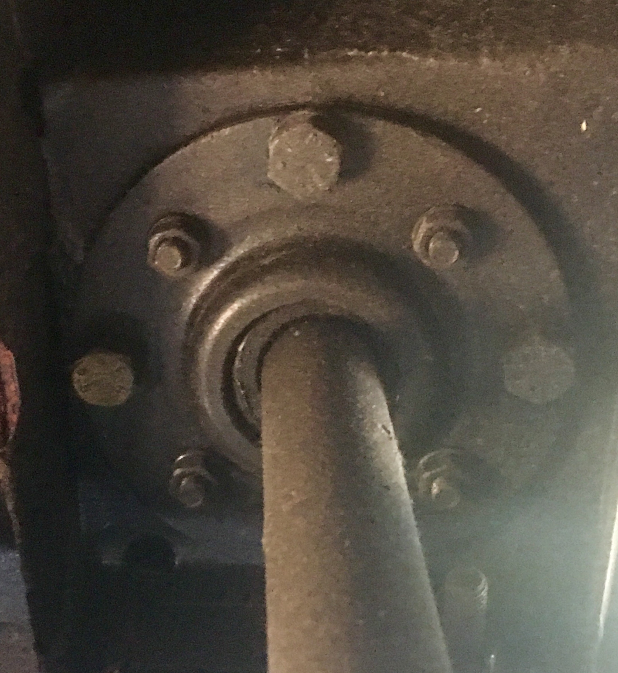

The only issue is that I cannot shift into those 3 gears. Typically this is a mechanical linkage issue with the selector mechanism or gearbox controls. I lifted the cab to review the linkage at the gearbox as well as the connector box below the shifter inside of the cab. I do not see anything that looks out of place or bent.

Good morning,
First step I would recommend to check the cabin mounts because they might broke or moved in offroad. The gearbox is mounted to the frame, the shifting lever to your cabin: A misplaced cabin could influence the setting of your shifting.
Next you can disconnect the shifting rod from the gearbox and try to shift gears with big pliers directly on the gearbox to see if the issue is internal or external.

Felix, Thank younformyour comments. I agree that those are good places to start. When you say "cabin" I assume you mean the cabin side of the linkage as the cabin is locked in place at the rear when driving. That side of the linkage is very difficult to reach even with the cabin tilted. I'll don't have a schematic of what the parts on that side look like or if there are bearing or bushings to replace. Thank you again..felix hat geschrieben:Good morning,
