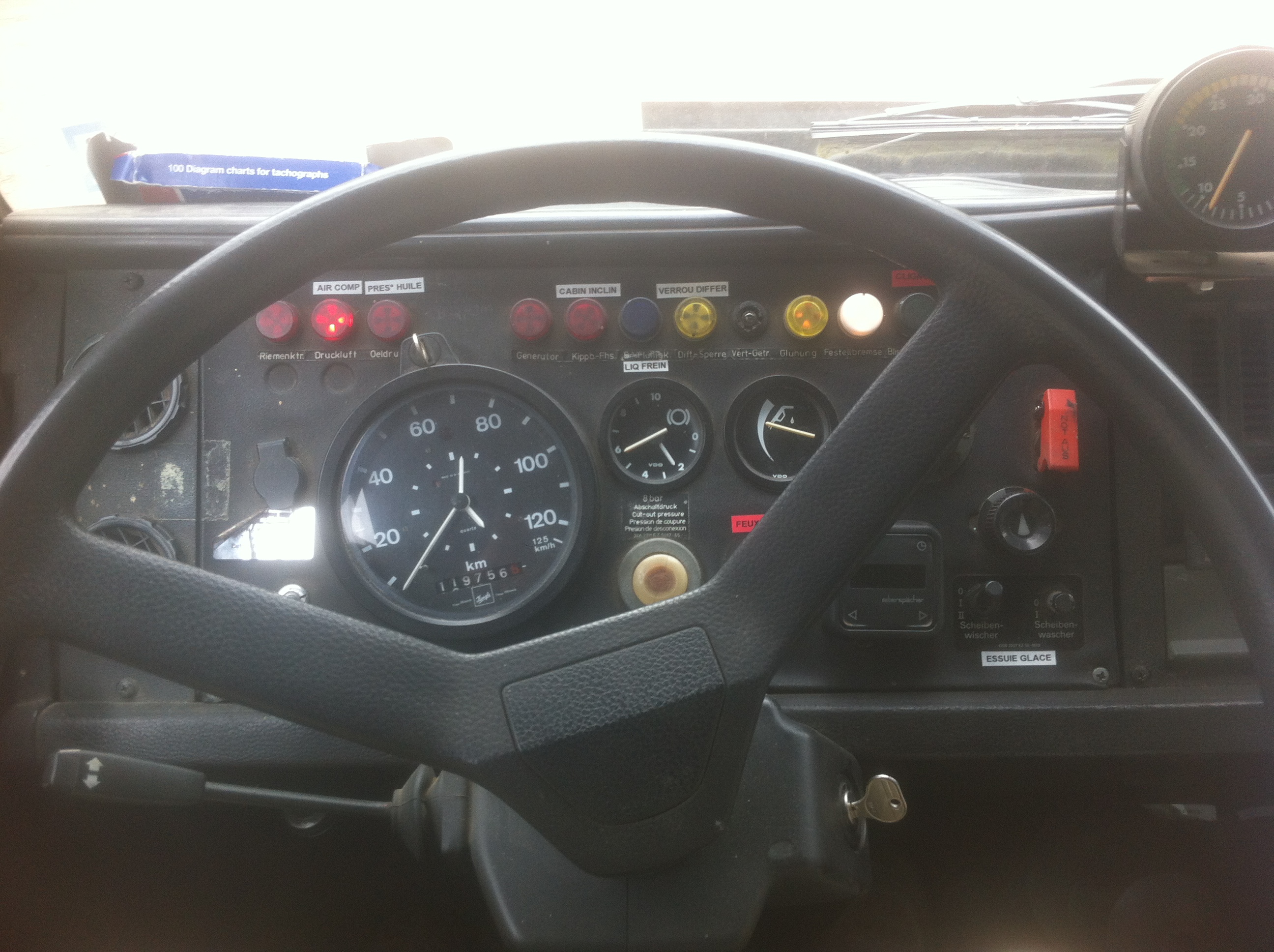

In fact, I broke down 2 times 2 months ago in Germany because a Mercedes mecanic and a Scania mecanic both let the oïl cooler disconected. Upstream of the oïl circuit, they closed the system but didn't bridge/shunt the circuit. Due to this mishandling, the engine fan didn't turn (the 2 systems: oïl cooling and engine fan are linked) and the motor overheated ($$$) !
The problem was that I didn't have any light to alert me about this disfunction (picture attached)!
I am sure that this motor is good but I would be reassured with a temperature sensor installed in the engine and with a specialist check on this subject before I continue the travel to Australia!

Here is my Dashboard
