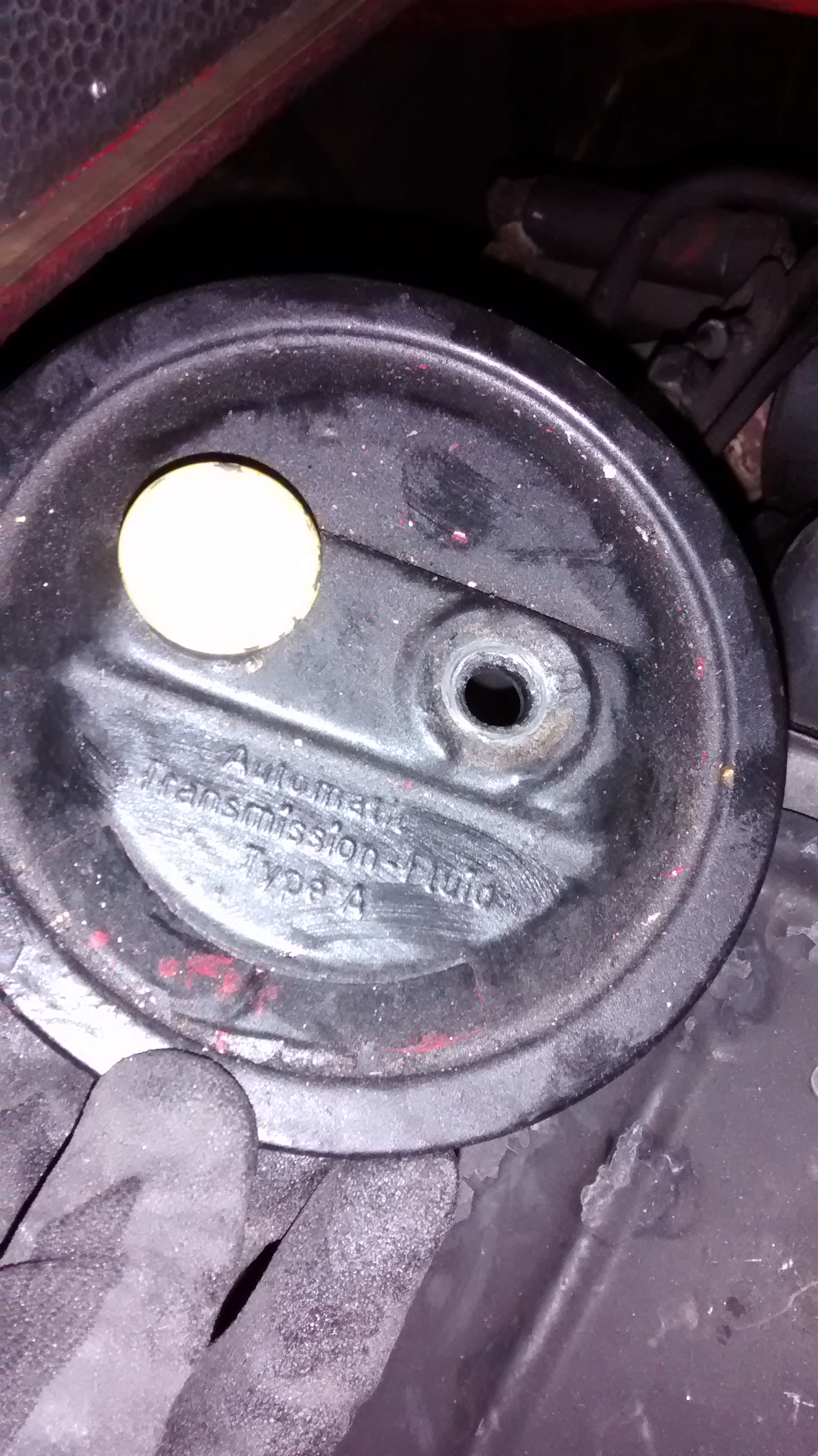

I found this canister with ATF in the engine room. It was full of oil and had a new filter in. Can anyone tell me what it is for?

BTW. The oil seemed quite thick so I cant be certain that it is ATF. The can just says so.

Peterdenmark hat geschrieben:I found this canister with ATF in the engine room. It was full of oil and had a new filter in. Can anyone tell me what it is for?
That is the reservoir for the power steering.
