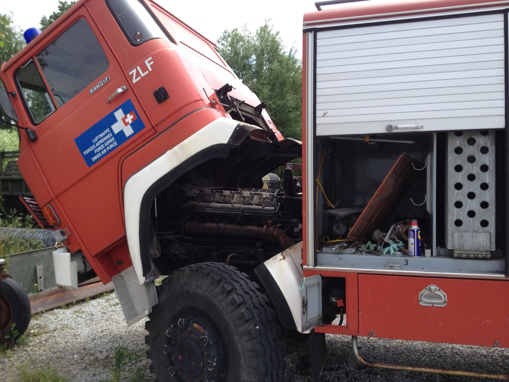

have a 1978 MD 232 D 17 FA 4x4 X Swiss fire truck.
490.0061.090
I am in need of a Repair manual and front spring eye bushings any suggestions
Also the truck is geared for low speed 80KPH.
How can the road speed be increased?
It has a F8L413F and the governor is set to 2300 RPM
truck already has 12.00-20 tires so I probably need to change the gearing.
Is that usually done by by changing the ring and pinions or the planetary gears in the hubs?
Thanks for the help!

tilter

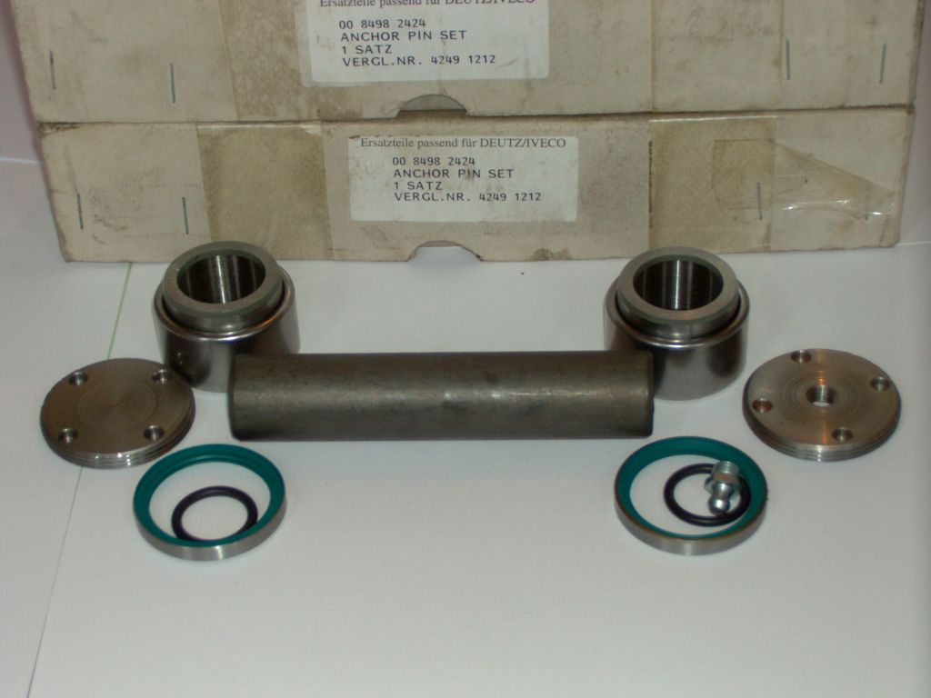

I have attached a picture of the spring eye bushings I have got here. Are you looking for these ones?
Regards, Andreas
