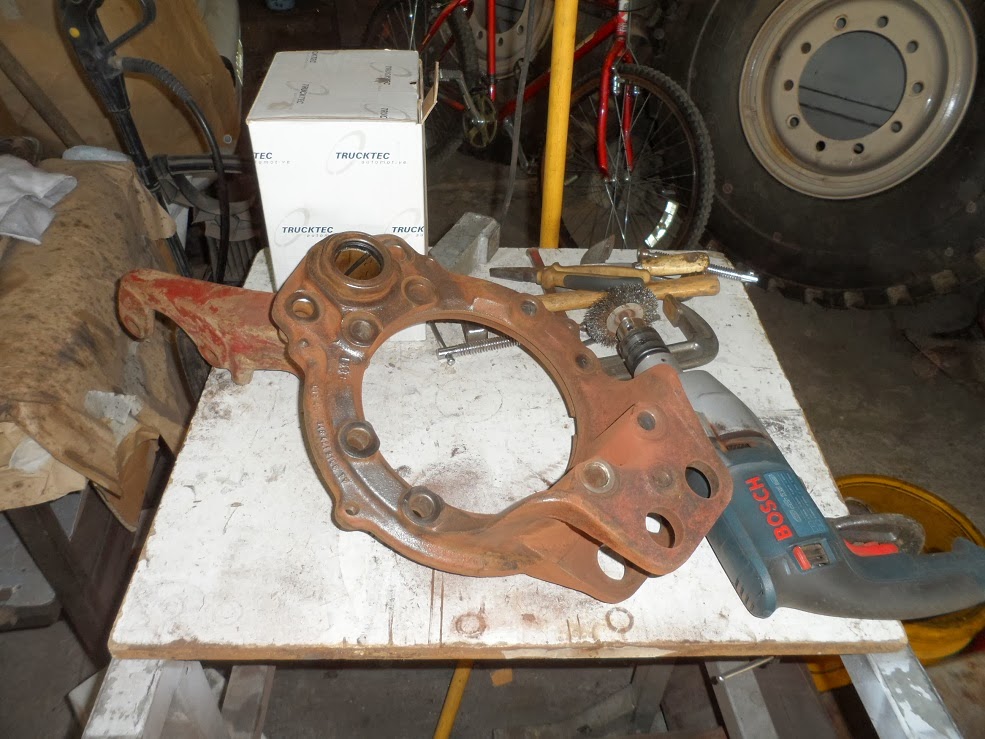

I was pretty excited and happy as I supposed that I would easily remove the steering knucle after removing the upper and bottom kingpins, but I couldn’t make them move and the knuckle remained blocked in place. The EPC did not help in showing a better way to try to remove the pin so I did what is strongly recommended in these situations… drink a cup of tea and leave it for later. Then, I started to disassemble the left side wheel hub.
There was no mercy this time and right after taking out the nuts there was a sledgehammer strike and the hub cover got out at the first try, just to show the filthy state of the oil, black and dense bloody thing. When the hub was drained the oil seemed not to be that bad. Maybe, just like the brake linings seemed to be untouched, it was never changed. The gears were imbebbed in this molasse-like sticky crap and by fortune they were not burned out.
As the surface of the parts of the wheel hub was not protected by oil like on the other side of the axle, there was plenty of rust and it was all stuck, the brake shoes pins firmly in place. The problem was that there was rust also between the wheel hub and the gear hub and there was no way to separate them. I loosened the brake shoes but could not remove them so the disassembling stopped right in this phase. I sprayed generously Würth bolt-loosener, but with no much faith, and then put all back in order and went home.

Another day passed and back at the workshop I made some other tries to separate the hubs without any reward. I then grabbed the sledgehammer and smashed the wheelbolts until they all came out dragging the rust with them. It would be necessary to replace them but I had no options given the circumstances.
With the hub out it was just to take out the big gear, without being covered by oil and avoiding to damage the locking washer, and the knuckle was finally exposed. Good.
Eduardo, my brother-in-law/guru/guide, helped me out and with some precise strikes loosened the drag link. It was time to go home but, as the hard-headed man I am, tried to loosen the superior steering link but, no matter how hard and how many strikes, didn’t work. The one who knows… he knows.

The rest of the day I dedicated a non stop effort to disassemble the rest of the steering knuckle of the left side of the front axle, but first I struck the links until I finally loosened them, ha.
The inferior steering arm showed clearly the careless state in which it had been obliged to work for who knows how long and, after some fine levering maneuvers, the thrill was worse when the interior was exposed; there had been nothing similar to a lubricant in there since probably the year 1982, when the truck was imported to Chile. The kingpin showed its rusted nudity as well.

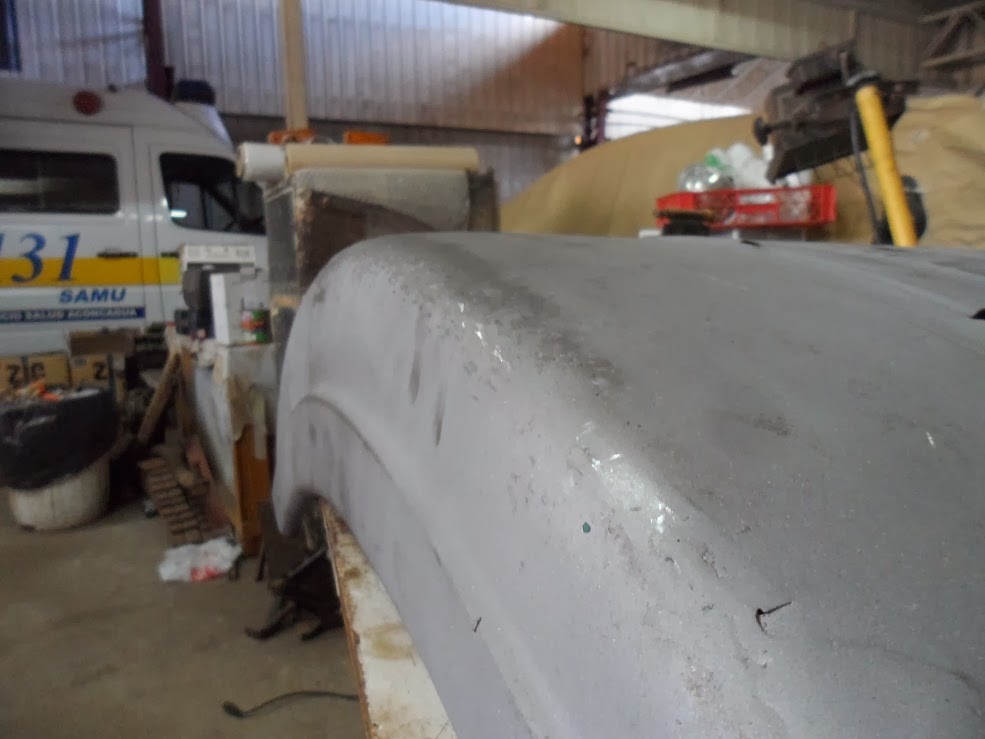

We spent the whole morning preparing the mudguards. I would take them later on for sandblasting to the famous sandblasting shop near San Felipe. Yes, I know… but I had neither time nor the will to do it myself, and the inspectors could show up at any minute. No way.

I took the mudguards and some other pieces to the sand blaster and tried to make a direct deal with the old man, completely covered by its protecting suit, but the noise of the compressor and the whistle of the air jet were so loud that I hardly heard him say okay.
In the next days I devoted myself to the pretty known routine of washing, cleaning, brushing and polishing of the components of the hubs and the brakes of the front axles. As they were in pretty bad shape, in pretty bad shape ended the tools, the brushes and the operator after struggling with the dirt and the rust, as always, Nevertheless, nuts, bolts, springs and one of the brake brackets were very grateful.
After a couple of boring cleaning sessions I went to pick the parts from the sand blaster and, strangely but fortunately, they were ready; not perfect, but ready. But the idiot forgot to take the keys out of the car and the wind closed the door inadvertently and… clic! The automatic door locker made its simple job. I stayed out. To be short: one hour waiting under the cooking sun of San Felipe, with a furious wind that raised clouds of dust and sand, until someone could get out of the traffic blocked by an accident to go home and bring the auxiliary keys. Bad.
While I waited in that inhospitable place I checked the pieces recently blasted and they showed pretty clearly then all the imperfections that had to be corrected. There was still a lot to do with the hammers.

Well, Edison was pretty aware of that so the next Saturday we gathered again at the shop and he, always with a smile on his face, worked hard on the steel sheets while I toiled with the power brushes. I spent the whole morning to clean one of the brake brackets and a couple more pieces and made some repairs and weldings that the mudguards needed. By the force of hammering Edi made the shapes every time look rounder and even.

Meanwhile, Edison gave touches and retouches endlessly to the mudguards, looking for perfection, but his progression was quiet slow. We discussed about speeding up a little bit and agreed about using power tools where required, but he was a little reluctant.
