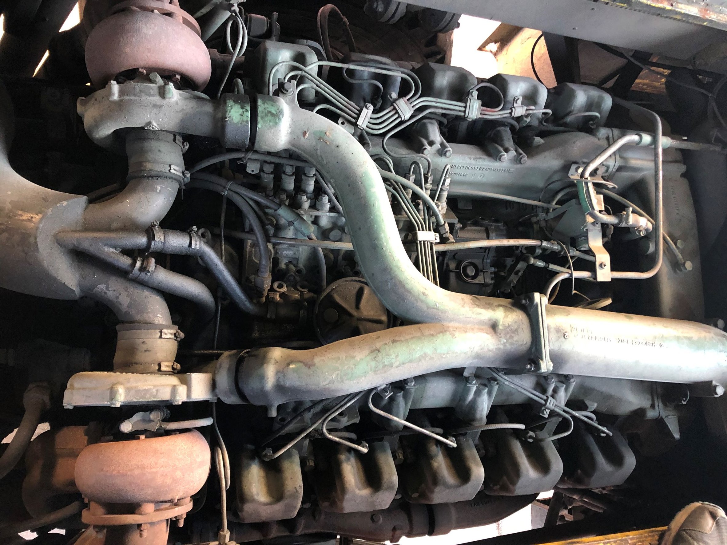

Interessant für uns ist das Fahrgestell mit den schnellen Achsen das Allison Getriebe und der Motor (V10).

Cool picture!
Have you been able to find out which Allison transmission model exactly you got there? I am looking for info about older, Allison gearboxes capable of 500-600HP that has less electronics when compared to the modern 4500-4700 series.
