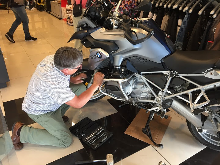

Knowing my tastes and my way of driving I took the GS to get her fitted with protection bars and some other toys to leave her ready to be used as, well… as this kind of bike is meant to be used.
Days were getting warmer and warmer with the approaching summer and Carmen experienced a renewed joy riding the GS so I profited every moment to take her out and make short trips to the coast or to the mountains. Time for working on the Merkabah was more and more scarse but this was more important.

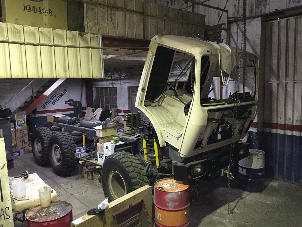

So, what to do next? Of course… put the cabin back on the frame!
The front suspension of the cabin was ready but the rear one, the one original from the old 2626, needed new shocks, and I wanted more powerfull shocks than the stock ones. I ordered then a couple of heavy duty ones that arrived the next day, but the spikes were of a different measure.
Maestro Chaleco was charged with the task of adapting them, and he delivered the next day. He did a very good job with the welding though I had to give the final touch by polishing the shafts very carefully.
I assembled the rear mountings including the new shocks that barelly fitted in and set them ready to receive the cabin. They looked pretty good to me and I was very happy.
As soon as I could I put again the hooking device on the roof hatch and connected it to the floor of the cabin via four chains anchored to secure points to avoid deforming the cabin while lifting it.

The crew of the shop helped me to mount the wheels of the Merkabah, which was incredibly straightforward comparing with me doing it alone, as usual. I put the front wheels insideout because it was easier to do and that way you could work more easily between the tire and the frame.
A new manual winch was ordered just for the occasion, and when it arrived, the next day, I went to the roof and placed a double arrange of thick ropes from one to the other crossbeams to hang the winch from them.
Lifting the cabin was pretty easy and it was quiet an event for those who still were wandering by the shop at that time of the evening. Of course, Eduardo and Alejandro didn’t miss the chance to act like clowns. I really love these guys.
They helped me to push the chassis forward to under the cabin and then to adjust the cabin so to bolt it to the front supports and let it rest on the rear ones.
Do you see the baldy guy in the picture? Well, when I started with this project I had all my hair.
Eduardo was amused by the fact that the cabin was so high placed off the ground and joked about her sister trying to get in. She was not amused at all.
In the end I could not bolt the cabin properly as it turned to be more difficult than I thought, and it was getting late so I desisted and pushed the truck back to its classical position with the aid of the guys and let it stay that way until the next working session.
I secured the cabin with two bolts per each side only and then I made a shooting session, enjoying the moment when the Merkabah went back to look like an actual truck.

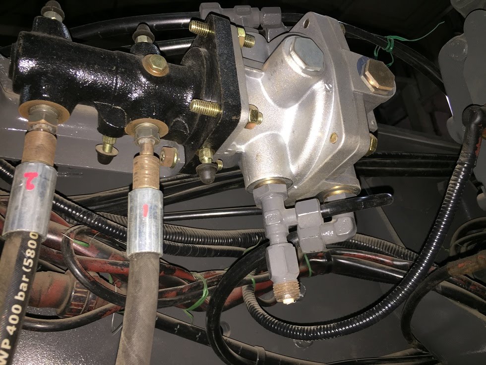

The hot water circuit for the heater was a major issue regarding the front of the cabin, and it had to be addressed before many other components so I got a couple of double angled hoses to replace the long ago worn out hoses of the Merkabah and managed to install them in the narrow space left. This allowed me to bolt the washer-wiper in position.
Then, the water pipes were inspected, cleaned and painted and the whole thing was plugged and screwed in place. I then installed the washer-wiper motor and, slowly, things began to look more and more interesting.

At some point I checked the service brake circuit and the double brake servovalve and found that there also was a mistake regarding the connections. There were no definitive nor tighten up connections there and all the tecalan hoses were purposedly loose so it was all easy to correct.
I was replacing the manual purge valve on the fourth big air tank and suddenly I saw myself with the broken valve on my hands. Not a big deal, honestly, but I had to take the reservoir out to get the thread free, and that was a real pain in the ass.
So, I removed it and, in record time, I took out the stuck piece of valve. I then put the reservoir back on and installed the valve and completed the air-managed purge circuit.

Pulling the cabin with the hoist really bothered me so I picked the hydraulic cylinder that was lying eternally on the bench between the stuff with the sign “Fix this” and cleaned it for the tenth time. The pivoting joint was jammed, hard as hell. I put it in the bench vise and tried to free it but could not make it move a tenth of millimeter. I then applied a little heat Maestro Chaleco’s way with the oxygen torch and only then loose it, but unfortunately the joint moved out a little from its seat in the cylinder and not from the rod. At least it moved and that was enough for me at that time so I made sure it was stable enough to test it once repaired, if it could be finally repaired.
Challenging the stormy forecast, and everybody’s advice, I took the hydraulic cylinder with me on the bike and went to Santiago the next day. Left it in a specialized hydraulic shop and picked it up when returning home. It did not rain a single drop, though it was pretty, pretty cold.
Eduardo checked the cylinder and preached me because they had not done a good job and I did not check it before picking it up, nor asked him before taking it to ”any” shop. Anyway, I shrugged and cleaned properly the valves and the ad hoc components myself. Maybe they were not so incompetent, though, but my brother-in-law know his business.
I looked for the plastic hoses that connected the cylinder to the metallic pipes and could not find them. I was sure they were at hand before taking the cylinder, but I checked many times and wasted a lot of time looking for them, fruitlessly. I gave up and went to the office and had a cup of tea with Carmen. Her advice was simple and clean: Do something else, Pairoa. She was right, so I obeyed… looked for a better and definitive place to put the fog lights... found it... and went home to watch some movies.
pairospam
Beiträge: 927
Registriert: 2010-11-22 14:27:25
Re: Mercedes 2626 AK 6x6
#839 Beitrag von pairospam » 2018-06-20 3:41:56
Next time, one Saturday morning with subzero temperature, the hoses showed up almost by themselves, as expected, and after some reglamentary inspection and cleaning process the hydraulic circuit was closed, the pump was filled up with hydraulic liquid and the initial test was made with satisfactory results. I then installed the cylinder, always in momentary mode, and it worked very good, though the cabin was tilted up and forward with the lever in the “down” position. Ops.
There was another big problem, also, and it was that when the cabin was in the lower position the force of the cylinder was almost directly applied on the leaf spring and stretched it instead of making the cabin to pivot on the hinges. That’s why the suspension system of the cabin comes with a big pivoting lever that I completely neglected when putting the cabin on the frame. Ops.
I looked for the lever at every place in the shop and I could not find it. Double ops. There was surely a good reason why I had done it, but the reasons why I take decisions, especially when taken long ago, usually do not stay in my head forever and I assume that they were good enough to do so. In this case I only remembered that this may happen.
Following my wife’s former advice I left the search for the lever for another occasion and went out to buy a couple of meters of steel wire and made a loop to limit the upward displacement of the cabin and allow the hydraulic force tilt it instead. Of course it worked, but the feeling of making another mistake was not a good feeling.
Surely I had considered that the cabin of the Merkabah was lighter than the cabin of Spare, from which the suspension system was taken, and so it would sit a little higher respect of the original height of the 6x6, which actually happened. Then, I had thought that I would have to limit the upper displacement of the suspension not to brake the shock absorbers and to level the proper height of the cabin to make the front line and the fenders line even. I remembered some of that but it was not clear. That’s why the steel wire loop was a natural answer, but I was not sure.
Anyway, the cabin tilted back and forth only on hydraulics so I could work on it pretty easily. I left the hoist in place as a backup, though. Did not trust the repair of the cylinder.
Looking at the picture, so many hours spent working on electrics, pneumatics and so forth, and it looked exactly the same as many weeks before. Started to feel a little discouraged.
Oh, and there was the issue of the gear change lever also. Of course, the length of the lever was excessive and putting the cabin in driving position made it push forcedly backwards the gear box rods and levers. I tried to compensate it with the regulation mechanism but went out of range. Hmm… I would have to bend the big lever. Not of my taste.
Well, after all, I had a working hydraulic cylinder, the cabin tilted properly, I had a lever to fix, and the Merkabah had new challenges to face prior to see the open road. It was, summarily, the same as before. I made order, took some pictures and left.
The following working session I only dedicated the available time to complete the electric network, checking and rechecking circuits, isolating terminals and making every connection tight and safe, or so I tried.
When I had time for it, a few days later, I got the gear lever out and made myself a vain attempt to bend it. I then took it to Verardo’s machineshop and assisted a very experienced guy who heated up precisely the steel and, at the second attempt, we bent properly the lever so it fitted right and the regulation mechanism was properly set. Did not look pretty good, a little too flattened on the bendings, ruined paint… though it fitted. Good.
