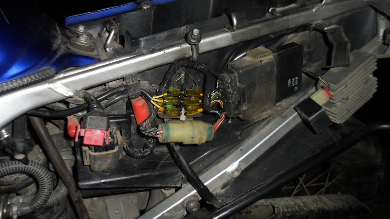

The Africa Twin took place between the frame and the tires of the Merkabah, waiting for my return, and the next day, November 10th, with the Montero loaded to the top, we departed heading south, to as far as we could go.
We took more than 6.000 pictures (half of them failed, of course) and drove 8.500 km arriving to Ushuaia and back to San Felipe. Niiiice trip. You will be able to read more, if you are interested, somewhere in time in the Lagerfeur thread.

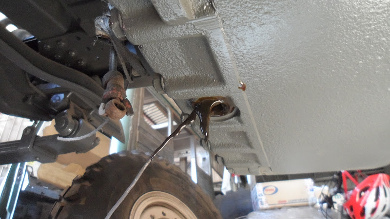

I never expected to do it again the last time I closed the cap. Christ, what an idiot I was! I should have changed it all when I had the chance to do it so long ago. Anyway, ruining is just one of the many methods to learn.
I realized, sadly, that the new gasket of the left side central console was broken in pieces, like if it had dried up, hardened and spontaneously disintegrated. I would have to think on a replacement.
When I was manipulating the spring saddles to clean them from all the oil, I made the classic little mistake and hurt my back, just a little, but enough to stay in moderate pain for a few days. I was extremely cautious from then on.

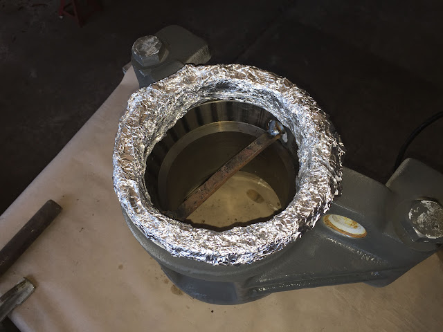

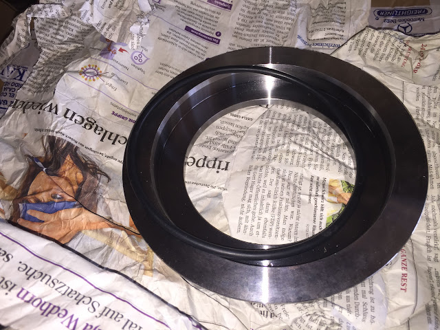

When done, I removed the old and damaged thrust washers, and the left side one was very rusty as you may remember. It was not an easy task, and it was not fast at all, paying attention not to damage the central console or whatever its name is.
After removing the pieces I had to clean it all again from oil and rust. It was long ago that I had worked on the truck as happy as I was then, pushed by the energies I found elsewhere during my holidays, but still the progresses were slower than I wanted.
Needless to say that the roller bearings were also special and pretty expensive, and that the sellers took their time to send them to San Felipe, via the more expensive courier, and, of course, that they sent the wrong outer bearings the first time. I sent them back (with the same courier) and proceeded, waiting for the right ones to arrive at some moment in the near future.
That weekend I convinced Eduardo to go to the beach and neither his wife nor Carmen were keen on accompanying us, so we took the bikes and made the classic macho-partner trip and enjoyed the roads by ourselves. It was a nice journey and we ate a pretty nice fish in the classic restaurant over the fishermen’s cove.
Some days later I went to finish the job and fabricated the seal ring that went on the inner part of the thrust washers, from a stripe of rubber I bought ad hoc. Then I installed the thrust washers and the new inner roller bearings on the central console with the aid of a little heat and the medium sized sledge hammer. The new pieces shone bright in the afternoon glow and I felt very satisfied. Just accomplishing such little tasks made me feel pretty good.
As it was pretty hot and dusty – remember we are in full summer- and each time the wind blew there were many kilos of dust coming through the doors of the shop, I had to cover all with plastic film to keep things clean, especially the bearings.
Next things to do: to remove the races of the discarded tapered roller bearings from the saddles. I welded some pieces of steel to them and made a vain attempt to protect the oil retainers from being damaged by the sparks. No way. I had to order a new set of them and removed the burned retainers, with no use at all. Hmm…
Gently hammering on the steel pieces made the races come out smoothly and I profited of the heating of the saddles to install the races of the new inner roller bearings, but as it was Christmas’ eve we all at the workshop stopped working early and made a little celebration, with the classical barbecue, and then went home.
I would have to wait until the new oil retainers arrived before ending the job, anyway.

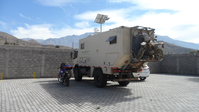

At the parking of René’s hotel, Terral the truck was waiting for the modifications that the couple had been planning during the first part of their trip finished a few weeks before. They wanted to change a lot of things, including stretching the windows, resize the dining room, etc. The truck showed many rust spots here and there but the frame was intact. Remember that it stood in 1 meter of sea water, stuck in a beach in northern Brazil. I thought it would be worse.
I stayed the night at the hotel after a nice barbecue evening at the Larraguibel’s. It was a good evening and the wine and the lamb were fantastic.

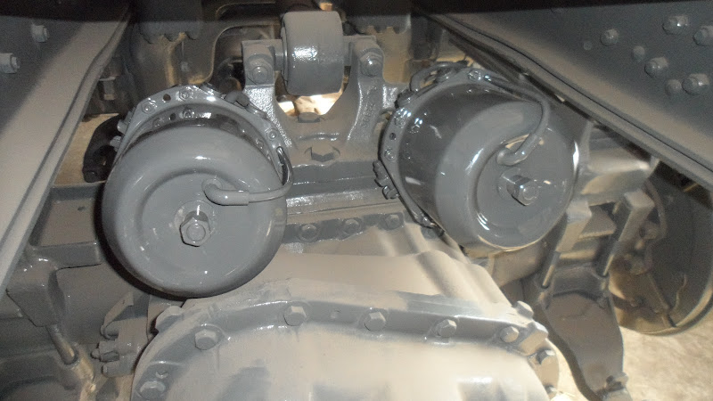

The spare retainers had arrived early in the morning and just after finishing the gaskets I put them on the spring saddles. When the saddles were ready I asked Sebastian, Eduardo’s oldest son, to help me to install them on the console. Usually I would have done it myself with no help at all, but my backache was menacing with future near visits if I did not watch out for it.
I put the external bearings and torqued them with the workshop-made big wrench. A few times I had thought of getting rid of it, ops. Swinging of the spring saddles was smooth and uninterrupted, great feeling. I did not trust the paper gaskets, even if they were the original ones, so I put the covers using silicone gasket instead. Right decision… I hoped. You can’t image how bad I wanted not to have any leaks again.
Soon after, Tito helped me again to put the damn heavy springpacks back on the saddles, pretty difficult maneuver because of the brutal weight and the required movements to fit the springpacks on both axles and the central bolt in its place in the saddle. Anyway, we did it, with a little help from Eduardo.
All in all, it took almost three weeks just to change the washers of the bogie. Pretty much, hmm…

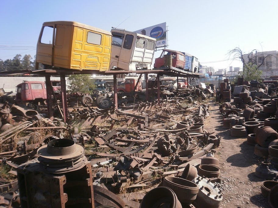

The only truck that I took pieces from and actually was on a regular junk yard was this.
And I have shown quiet a few of the many truck junk yards that I have visited since the beginning of the feast, some very fine (and expensive!), some others better to forget about.

In a few words, the socket plug I replaced two and a half years ago, shortcircuited, melted and caught fire, just the day before I had booked an appointment to test a Yamaha Super Teneré 1200. Hmm… Two days before I had replaced the battery, dead for sure, and the following day Eduardo and I would have checked the whole electrical system to find where the problem was.
I parked the bike and let her stay quiet and inmobile on her centerstand for a couple of days before addressing the problem. Of course, I decided not to insist in buying another motorcycle. She, the old Honda, will die with me… or I will die on her, but bigamy was not allowed.

Following, I took the brake chambers, also covered by dust and packaging oil, and carefully cleaned them with cloths and solvents, taking care not to damage the plastic and rubber parts.
That day I just got to finish three of them and wrapped all with the famous plastic film to keep them clean. Boring, not quiet echological, but necessary.

The paint of the brake chambers was already dry and hard, so I took them from the attic and bolted them to their supports on the frame. They looked pretty well, and all fitted perfectly.

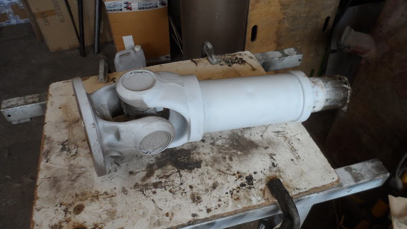

Then I took the cardan tube and aligned it with the splined slip yoke of the rear shaft. It was pretty uncomfortable and difficult to turn a few degrees at a time all the ten nuts, and my back ached a little. Damn bones!
Following, to finish with the shafts, I bolted the front cardan shaft to connect the engine with the gearbox. I realized that one of the bolts of the rear flange was lacking, and another one was not original, so only two of them were the proper ones, and all the torque of the engine depended on them. Hmm… I went out to see if there were replacements all around but couldn’t find them. Only in Santiago, they said, or get them as spares. The Mercedes dealer and some other specialists did not sell them as spares neither. I sighed and started the engine with those three bolts that were left.

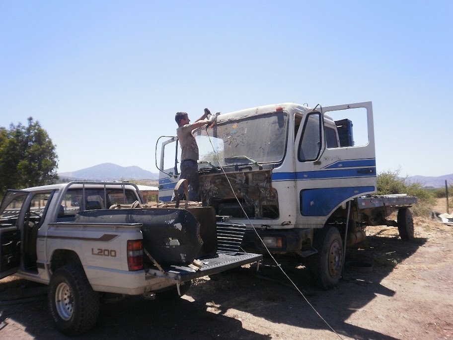

Eduardo called me out and showed me an old Mercedes truck that he had assembled and repaired many, many years ago. The ancient 4x4 still worked, harvesting avocados from the hills, and just by chance parked in front of the workshop.

When I put on the outer bearing I thought: That’s it! But after putting the outer planetary gear carrier I realized that I needed a better and safer method to tighten the grooved nut than simply hitting it with a chisel. Damn… I wanted not to disassemble these things… ever. I needed the special grooved wrench to torque the nuts, and I asked if somebody had one, everywhere, and the answer was no.
A little disappointed I wrapped, again, the incomplete hubs in plastic film to prevent them to collect dust and left, leaving the problem for the next working session.

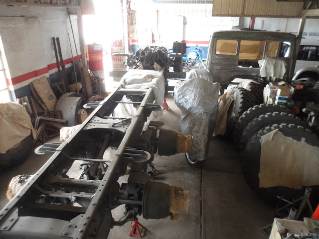

I wanted to know if the wheel hubs oil seal was appropriate before installing the brake drums. I have had a bad feeling when closing both hubs and suspected that the new sealing o’rings were ineffective. I wanted to fill them with oil but I left it for the next session, and obviously I forgot.
Next thing to do then: clean the wheel hubs for painting. Why didn’t you do it before, when they were disassembled? Eduardo asked. Actually… I forgot. On the left hub I could use power tools to remove the majority of the rust and the old paint and only a little sanding was necessary under the lonely wheel mounting bolt. But on the right side I had to clean it all by hand because all the bolts were in; pretty tedious and finger-destroying.
Once the hubs were clean I masked them properly and also covered the rest of the axle and the frame to prevent undesired stains. The dust that covered it all would have trapped all the paint, actually, but better safe than sorry.
I bolted the fuel tank supports to the frame, trying not to ruin the paint on the frame. They needed the stabilizers so I looked for them in the pile of junk on the left side of the working place, where there were still many pieces left for discovering. The ones that looked better came, paradoxically, from the most ruined yellow truck, half buried in the Aconcagua riverbed.
After the beauty session, which included a few strikes to flatten them out, the steel bars looked pretty well and, more important, they fitted perfectly with the supports. With them I completed the quote for priming and/or painting so I took them, along with the blocks, to the attic and hung them all from the roof.
And it was saturday. Alone again, I cleaned and set the new brake drums for painting. At some moment I realized that they needed not to be perforated for new holes, like the rear drums, and I did not know the reason why the previous ones had all those supernumerary holes. Better that way… less trouble for the poor Pairoa.
Started with the washprimer and then primed the pieces that needed the full treatment. It was already planned to give a new hand of grey paint to the whole frame once all the systems were installed and ready, to cover all the imperfections and the damage to the paint that the installation itself could cause, but I decided to paint again the steering arms, damaged by the heat when extracting the king pins. They would be very hard to reach when the brake drum covers were in place. I thought the same about the universal joints as well so, when it came the time for spraying grey, I gave many hands to the brake drums, the diesel tank, the pieces that hung from the roof in the attic, and to the front axle.
I was tired, my back resented the loading of the drums and all the physical effort and it was late, so I left the painting of the wheel hubs for another day. I was happy enough.
pairospam
Beiträge: 927
Registriert: 2010-11-22 14:27:25
Re: Mercedes 2626 AK 6x6
#628 Beitrag von pairospam » 2016-02-28 23:23:07
Sunday morning I felt okay but it was time for lawn mowing. Two weeks late, actually. I worked the whole morning with the lawn edger, and late in the afternoon my back ached more than a little. Monday morning I was late at work, waiting for the pain killers to do their job.
After lunch I felt better, though, and pretty slowly and carefully I set the scenario for painting the front hubs and the the rear hub covers. It was quiet a job, masking and covering it all, considering my backache, but it was worth it. I really did not like the look of the unpainted bolts on the rear wheel hubs.
The original paint bucket was hidden in a box very deeply in a pile of boxes under some toolboxes, and fortunately the paint was intact after all these years. Good.
I sprayed, once again, many hands of the sort-of-pinkish-sand-coloured-polyurethane-paint around, and in the end the hubs looked fantastic, comparing with their previous status. I was so entertained and commited not to hurt my back again that I did not realize that it was one of the hottest days of the summer. Carmen and the people at the shop were almost roasted. I was happy, so happy that I almost forgot to clean the paint gun.
The hubs looked pretty good, and I did not want to ruin the new paint taking out the big central filling plug, but filling them through the draining hole was almost impossible. So I got a 60 cc syringe and very carefully and slowly I poured the new oil through the gears at the bottom of the hole, one charge at a time.
I went home hoping that the seal would stand, but when I arrived the next day to the shop the first I saw was the oil spot under the right side hub. Christ… I knew it! When I wrote that I didn’t want to disassemble the hubs again, right at that moment, I knew that I would have to do it... again.
Short story. Drain the oil, take out the cover - hard because of the silicone gasket -, remove the huge circlip, the other stuff, the sun gear, blah, blah and take the heavy wheel hub back to the bench.
Have you seen this bastard before?
I was right… the o’ring and the grease were not enough. I sanded the surfaces pretty carefully and applied the magic solution: Würth’s oximic silicone gasket. A lot of it. As there were rust and wear signs due to the ageing of the truck I was left with no more options.
After a few minutes I put it all back in place and closed the cover of the hub. I should wait 24 hours before refilling the hub with oil and see if it worked. The inmaculate paint was no more.

Well, disassembling and reassembling the right side wheel hub took the whole afternoon and when I finished I had no more time left for playing around. The plan for that day was to remove and replace the lift blocks, but the truck wanted to make me do the right things before going on. Thinking of that I assumed that the left hub would have leaked the same, sooner or later, so I left a piece of paper on the ground under it. The day after we would see if I was right.
And the next morning… aha… the oil spot was there.
I did the same operation, in less time, with less oil stains everywhere, and more calmly. It took me only a couple of hours, but my back was complaining again. Hmm…
