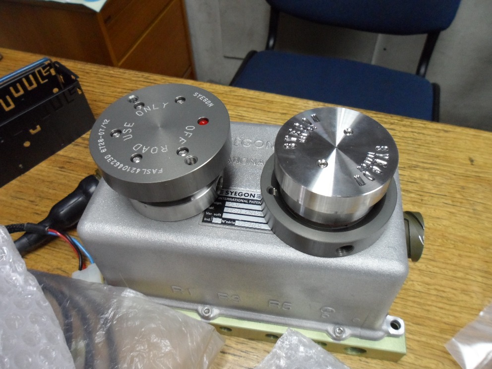

As usual, my job and the events had left me just a few hours to work on the Merkabah the last weeks, and I was a little discouraged for the advances had been not noticeable. I needed a shot of energy or good news to make me smile, and the Boss helped me, like He always does.
The next time I walked into the shop I found out that the package I had been waiting for the past month was arrived. Directement de Tulles Cedex, la campagne française, the central tire inflation system had been finally delivered after been retained for 45 days at customs. The box was very discreet, despite the price of the content, pretty conveniently.
Slowly, as opening a Christmas present, I opened up the box and checked with the waybill; bad feelings are quiet contagious even if you are pretty faithfull. It was all there, fortunately. Actually the system itself was very simple, ready to plug and play, and no aeropacial engineer was needed for the installation. The quality of the materials and finition was quiet impressive; it would be impossible to fabricate myself such a similar system. With a big smile on my face I put the components back in the box and I searched a good place to leave the box until the time came to definitively install the system.

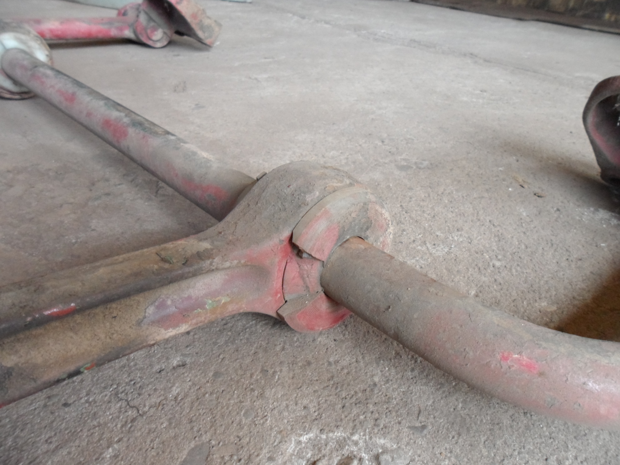

I had ordered the repair kit for the front sway bar taken from Spare that had to be put on the front axle, and it arrived from Santiago one of those days. As I had ordered it from the catalog (see EPC) I had a cloudy suspect that it could be wrong as were the cardan joints, so I took the dusty bar and tried to disassemble it to ascertain that they were the correct parts. Some of the plastic bushings did not look pretty good but they fitted perfectly, with no play. I disassembled all I could and made sure that it was the right repair kit but I could not remove the biggest bushings; they were still in working condition.
I went to the spring workshop to recover the new spring leaf that they had to temper before delivering. At the place there was a couple of trucks, one of them was a 8x4 Volvo from a mining company. It had only six months of use and it was already a mess. The guys had put supplementary spring leaves to over-overload them, and they had crashed the spring packs the same. The red Ford at its side shared a similar story, as did also the Merkabah; if you had paid attention, the spring leaf that broke was not an original leaf, it was also a supplementary one put for loading the truck with a lot of tons over the nominal payload to squeeze the payoff at every trip. Stupids!
I discussed my plan for lessen the stiffness of the suspension of the truck with the technicians of the workshop and, when they finally got the picture with photos, measurements and sketches, they agreed with my calculations and smiled at the idea. I profited that they went to lunch and took a couple of pictures of the shop where they fabricated the spring packs and leaves. They had a lot of work and a lot of experience and it was also reassuring listening to them say that they did not like to put more leaves in the packs because the beasts made the truck burst. They did it, nevertheless, but it is money that talked.
Back at the shop I inspected carefully the new spring leaf for the completion, as you can see on the pictures, were far from perfect despite the experience of the guys. I also found out that the length was not exact so, power grinder on hand, I finished the work Merkabah’s style and cut the surplus centimetres of the leaf. It was pointless to ask the guys from the shop to do so.
Well, let’s see which have been the advances of this little mad project that seems to have no ending.

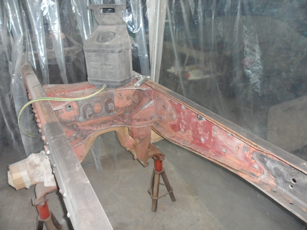

Back in San Felipe, after drinking a freezing but welcome Coca Cola, I bought another polyethylene sleeve because I could not find the bags where I carefully had put the plastic sleeves used before for sandblasting the axles.
What was left of the day I spent to get ready the sandblasting chamber (!?), quiet a boring job, and the time came to go home, to take a pretty long shower.
A couple of days passed before I could wear the white overall and start sandblasting the frame. When I finally did it, I did it seriously and spent three hours throwing little rocks and dust around. The system worked out well enough but the compressor did not stop working all the time, as usual. Every few minutes, though, the gun was jammed by a shity mix of water from the condensation of the air in the compressor and the dust that contaminated the sand.
The progress was slow, very slow, but the end result was worth the effort, especially if it was only the first blasting hand. The corners and places reached by the sand were cleaned easily but there still were some locations where the rust would prevail, so I would have to think about another strategy for priming and painting them. I cleaned only superficially the most accessible areas to leave the rest of the job to the powergrinder. I sandblasted also the rivets for they fracture the most the filaments of the metallic brushes, and any help is welcome when it comes to hold the heavy Makita.
The consumption rate of the gravel was high, though, and I stopped only when the container was empty and all the gravel was on the ground or filling the holes of the frame. I sweeped the floor and recovered the gravel, but it was half gravel and half dust. I had to clean it to be able to recycle it. More bore.
The next weekend I dedicated some hours too to sandblasting and made another little progress. The gun tended to jamm more often than previously, I was really pissed off for that, and one of those times I stood up to disassemble the nozzle to clean it, but I did not realize that I was under the rail. My head struck the steel quiet violently. You can actually see stars circling around your head, it is true. Hard a thing, that piece of steel. It still hurts when I remember.
Slowly, but firmly, the project was going on, as was the layer of dust that escaped from under the plastic sleeves and slowly covered everything parked at the workshop. Ops.
