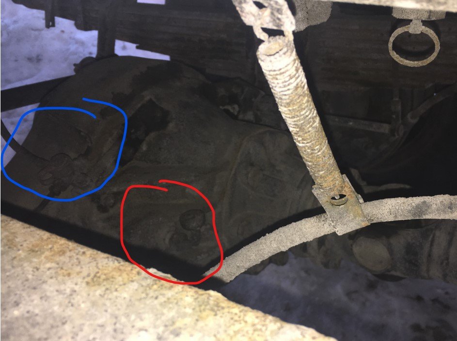

Thanks for the advice, references and information. I’ve got an additional question:
I only have one differential locking pull button in the cab. But... there is an air line going to the transfer case (central differential) plus another airline going to the rear differential. The front differential has no airline leading to it. The truck, although registered as a 1981, was built in 1979.
Knowing this, is it possible my pull knob activates the central and rear locks? I only have, as it turns out, one single indicator light showing the central differential in the cab. I can upload a photo if needed.

Re: Multiple 170D11 questions
Maybe... but the Magirus only had a single previous owner before the person who sold it to me: the fire department.
The seller did not add a locking rear differential.
Here are photos, it’s hard to tell on these but there is an airline going into the differential on the driver side:
https://ibb.co/HT5yw4n
https://ibb.co/54RrvdP
https://ibb.co/WDK3DJ4
https://ibb.co/6PxDLWs
https://ibb.co/wQjVhHK
- Beiträge: 24919
... i see only parts of the brake ...
in the last picture there is in the center of the picture a arcuated vent valve. Nearby that valve ist the diff lock in the axle with an airline to the grid. Like Ulf wrote, there are only brake part in the pictures till now.
Locking Rear Differential Confirmed? Woohoo! (I'm going to make some people here jealous!)
some notes to one of your pcitures. You shoot this picture from rigth side of the truck standing beetween front and rear axcle. Please supply pic from left side eighter.
blue marked: part of the brake (not axcle locker). Distribution of brake fluid towards the 2 braking cylinders at wheel. The hose might end in an valve for modifying the brake pressure in accordance to rear axcle load. Means: if spring says "totally loaded" the full brake pressure will be applied to tht cylinders. If spring says "not much loaded" the pressere will be reduced to avoid slipping on rear axcle.
red marked: air ventilation of the axcle. If this point gets under water, water/dirt will drain inside the axcle and pollute your oil. If you might reach deeper water, you should move the upper part to a higher position.

Thanks for all of the information. I've ordered some new wheels.
Thanks for pointing out the axel vent.
I will be taking a photo from the other side soon. There is a tube that seems to connect to the air system on the other side.

No Diff-Lock, only automatically load-dependent brake valve .BlackHammer hat geschrieben: ↑2019-03-27 19:30:06Thanks. I meant an offset spacer to get my front and rear wheels in the same track. I will be probably using option 3 from the image you linked.
Also, I have uploaded the photos of my differential from the opposite site for a better view of the other hose.
