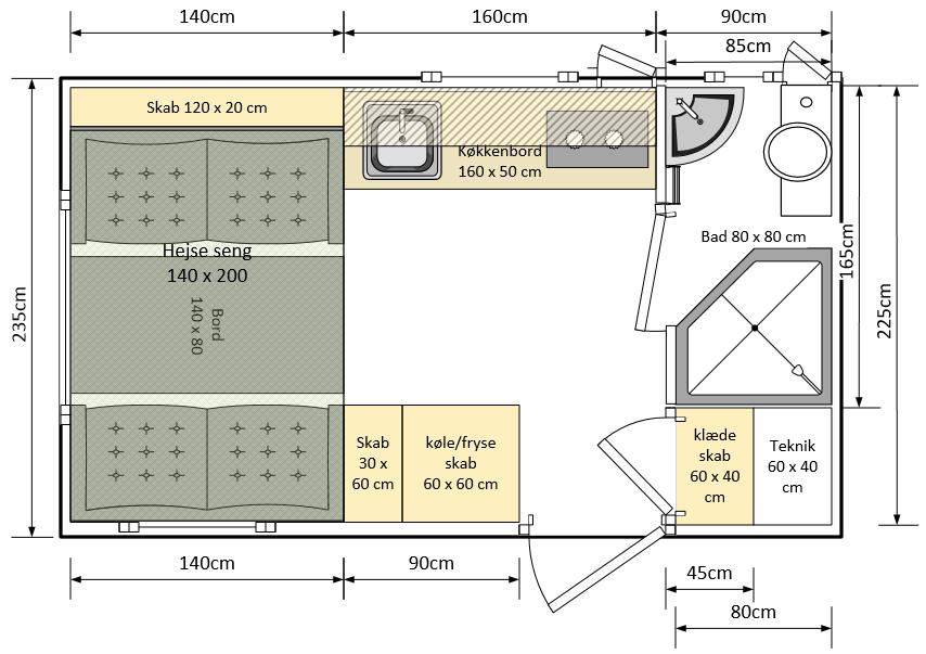

Planes for the box.
The box is manufactured with 50 mm fiberglass sandwich for walls and roof, and 40 mm fiberglass sandwich with 12 mm inside plywood as floor.
The box size is 4000x2350x2150 mm (LxWxH) and the empty weight will be app 450 kg. The box will be mounted on the original truck bed, using two large brackets. One in front of the bed, and one at the end of the bed.
Heating will be done as floor heating (water) like in a house, using a Webasto Diesel water heater.
Main power will be 24V from 2x240 Ah batteries, charged by 600Wp solar cells. 230V will also be available from a 2000W inverter, mostly for the refrigerator.
I hope you like the project, and I will keep you updated when we are doing progress.
Please write your comments below.
This is planned layout for the Box (sorry for the Danish text)

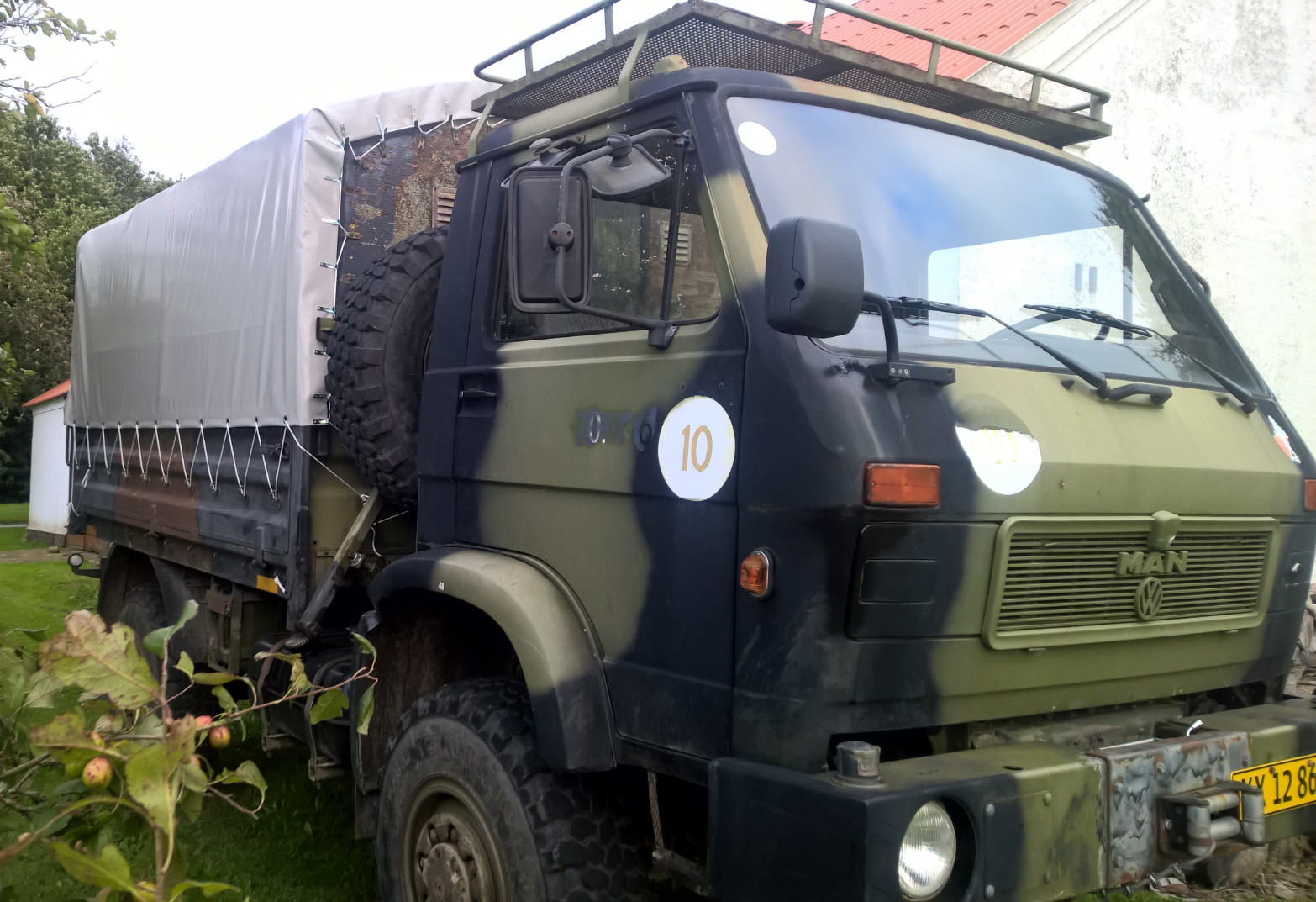

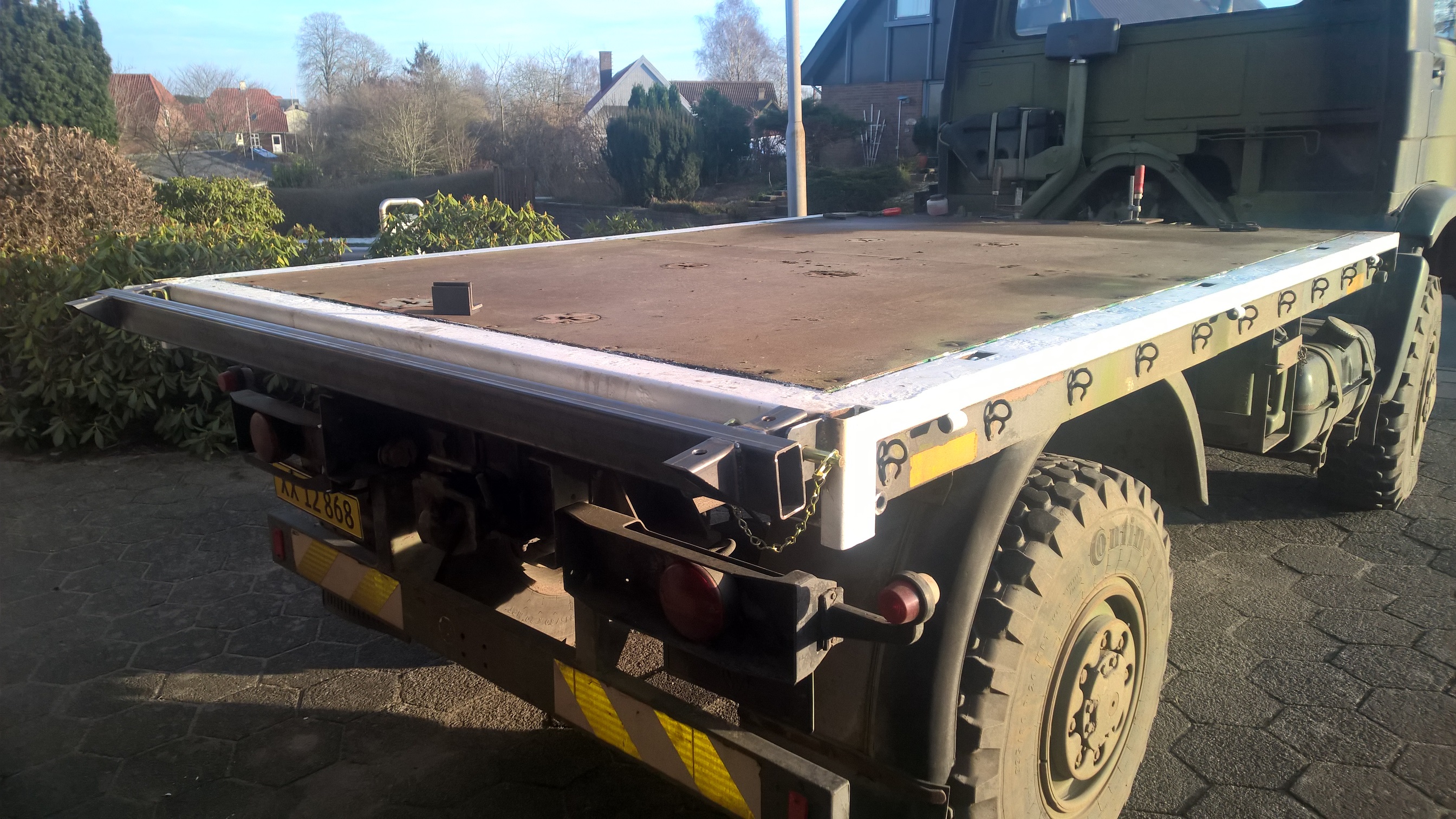

Here is the newly member of our 4x4 family

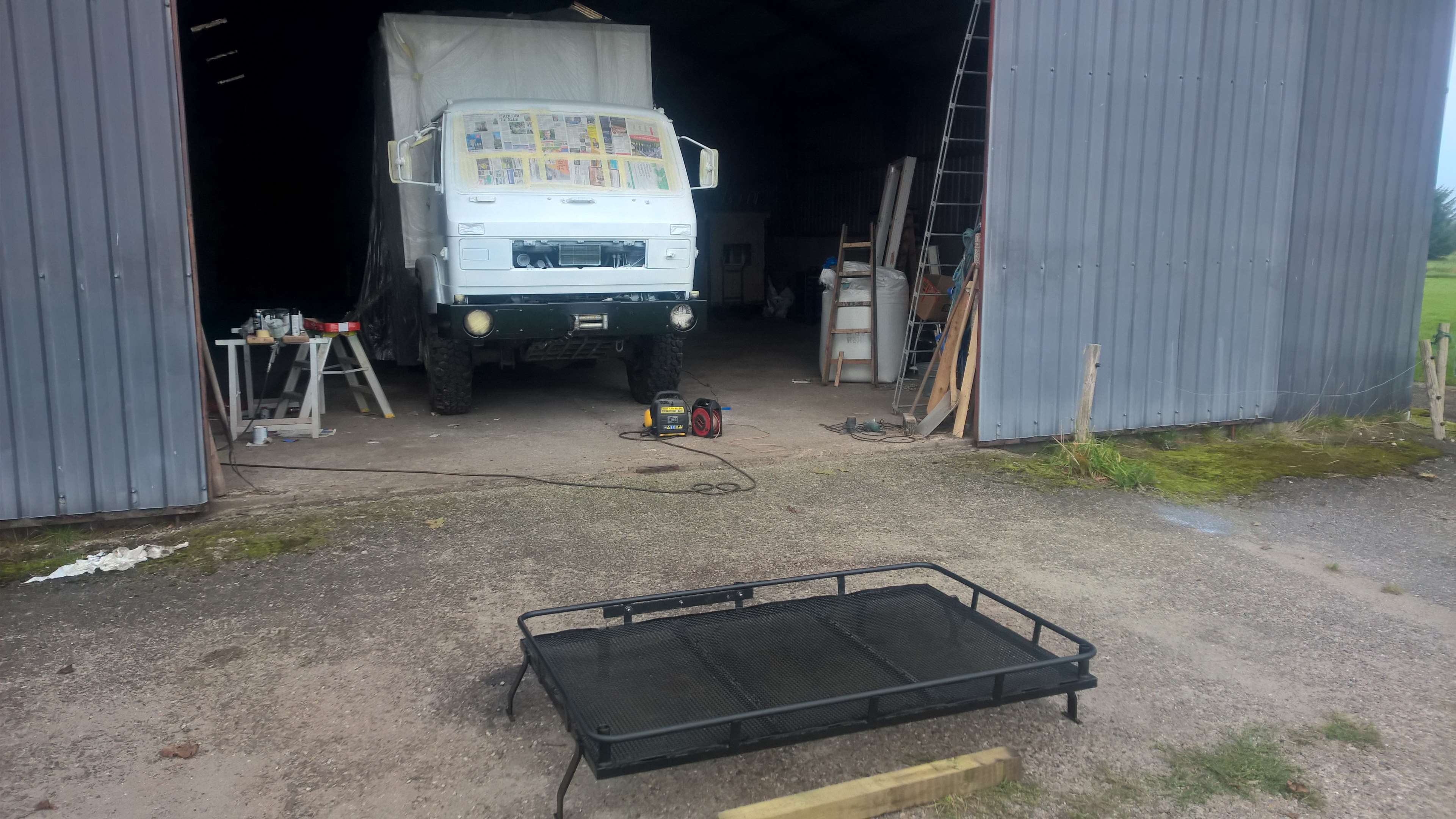

I will carry thy spare wheel on the roof rack, and build a small crane between the drivers cab and the box. The crane will be able rice, lower and swing the boom (manually), and lift using an electrical winch mounted below the bed like the original one for the spare wheel. When not in use, the crane will be lowered to roof height of the drivers cab.
Best regards, Benny

I have doubts if it is a good idea to mount the spare wheel on the roof rack.
1. I don´t think, that the roof rack is made to carry a load exceeding 100kg. I would set the limit to 60 - 70 kg max (Only estimation. But that will limit the load on every foot of the roof rack to app. 15-20kg, the weight of a full 20l jerry can).
2. Such a heavy load mounted so high up woudn´t improve the behaviour of the vehicle in curves and off road.
What would you think of mounting a wheel rack on the front bumper? Enhaces the length of the vehicle a bit, but that seems to be the minor problem to me.
Nevertheless you should shift the construction of the crane a bit till some more ideas had been suggested.
Btw, I did it the same way as you did: I bought the car and an empty cabin, only equipped with a door. And then I did as much as I could by myself.
But my cabin is only 3,50m long, so I could mount the spare wheel on the end of the cabin.

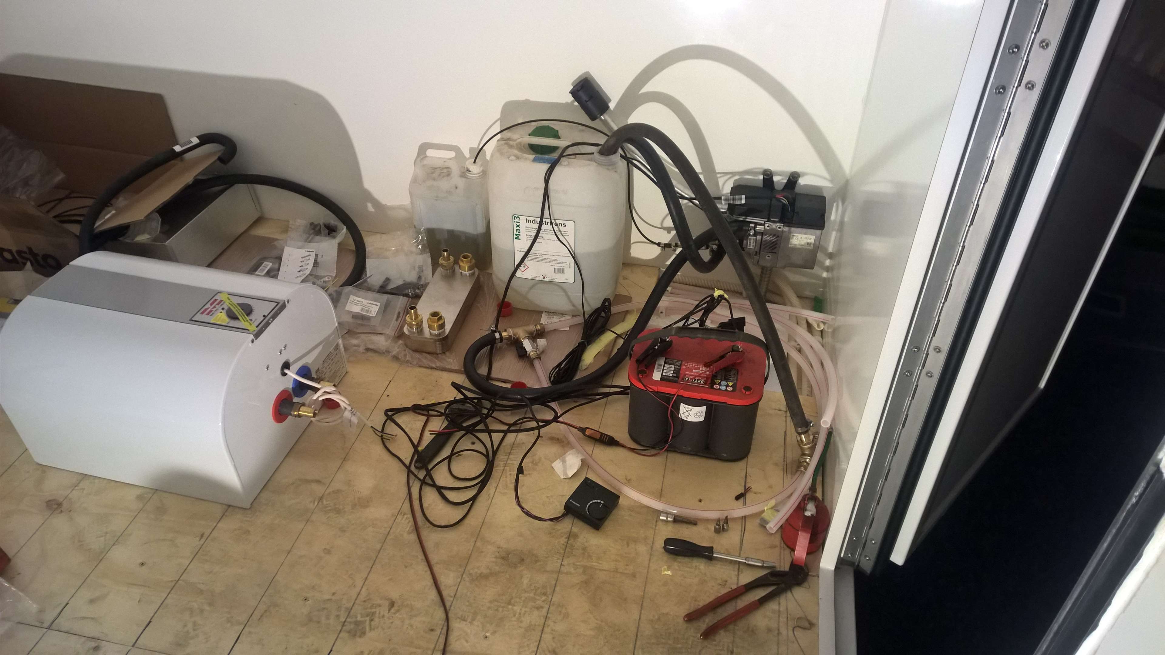

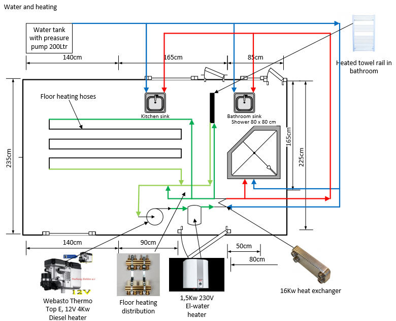

Some more details for our building project. This is how I expect to install water and heating.
The water will be with constant pressure using a pump and expansion tank for the purpose. This will give the possibility to use standard (and cheaper) pluming equipment. Cold water will be supplied to all taps, directly, and warm water will be supplied using a standard and cheap (160 Eur) heat exchanger, large enough to give constant hot water.
Heating can be given in two ways, off grid or connected to 230V.
When off grid, the heating is given from a Webasto Thermo Top E (4Kw) diesel heater. I have been in dialog with the distributor for Webasto and Eberspächer, asking for diesel burners able to be used continuously, and the recommendation was that Thermo Top is the only series that can be guaranteed for that purpose.
The Webasto will be installed with the possibility to run the water pump, without running the burner itself. Hot water from the pump, will continue to the El-water heater and use the 30Ltr as a heating buffer before entering the heat exchanger for hot water. After here the thermostats will control the heating and returning cold water to the Webasto.
When connected to 230V "land power", the electrical water heater can in most situations supply the needed heating. The circulation will be the same, but the Webasto water pump will be running without the burner is running.
When doing the pluming like this, using standard components, the only expensive part will be the Webasto.
Water and heating layout and components.

Pretty comfortable. I have to admit, that this is much too comfortable for me. ;) . Can´t make any comments / suggestions with that.
But good luck with your project.
I have read a lot about other travellers esp offroad and long term travellers. One of the points which struck me most, is that the majority of technical problems while traveling comes from the 'comfortable' water supply. Leaks, failing pumps or valves, broken sealings, broken pipes due to vibration, contamination with algaes or other 'warm-water-flora', etc.
This made me think twice and I came to the conclusion, that water from jerry cans and a pressureless watersupply might be less comfortable, but much more durable and also cheaper in production, maintenance and repair.
If I want hotel like standards in my living quarters, I take a nice hotel. :p
But everybody is different - which is good!

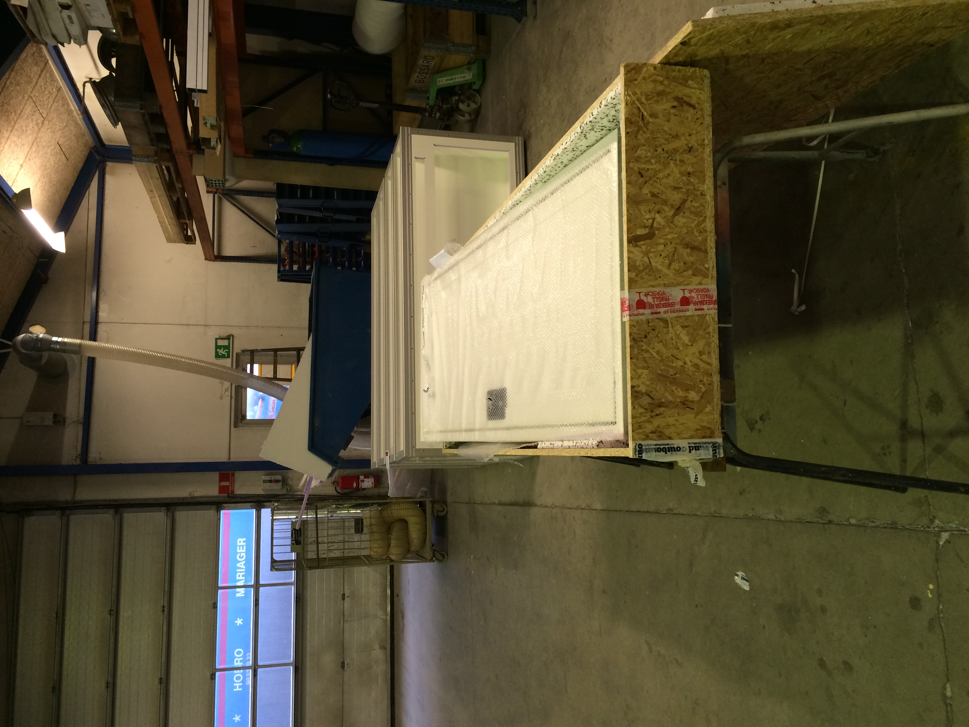

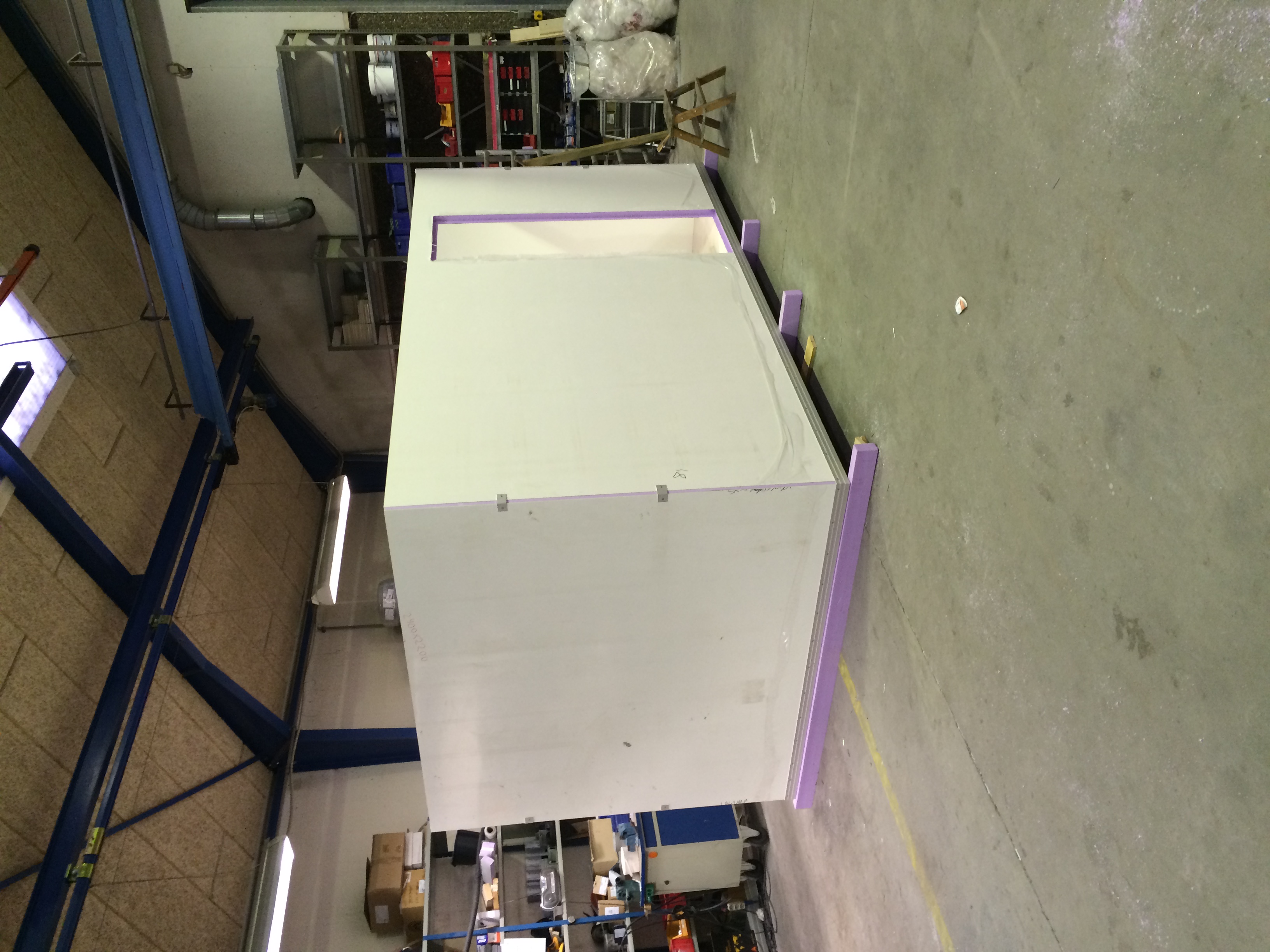

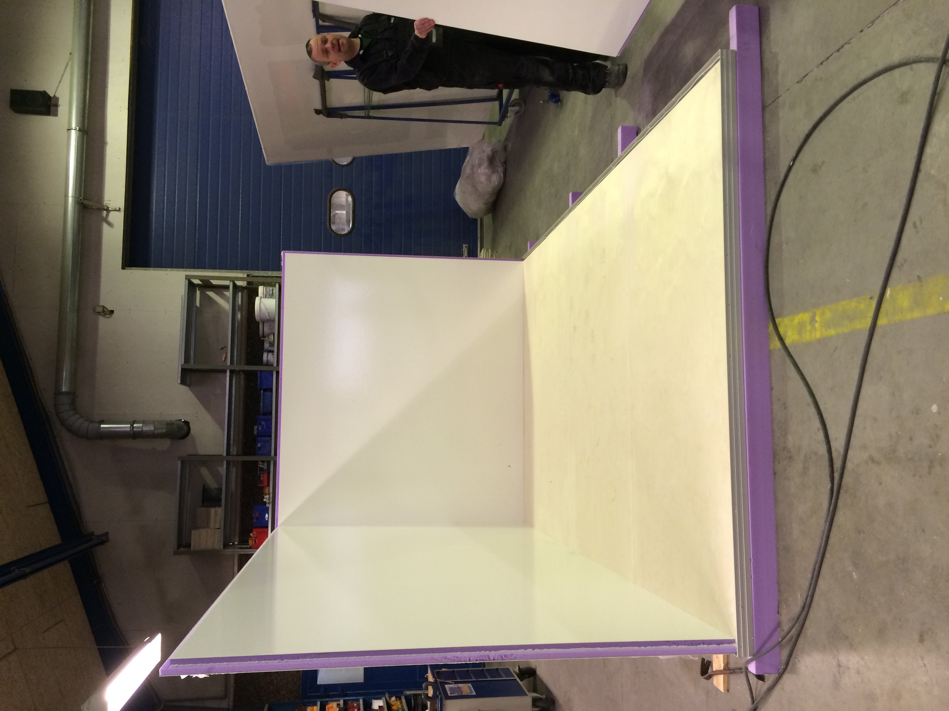

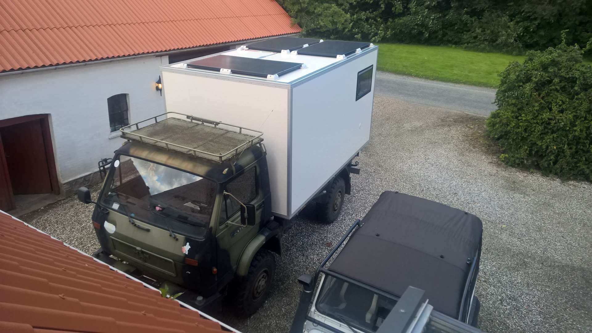

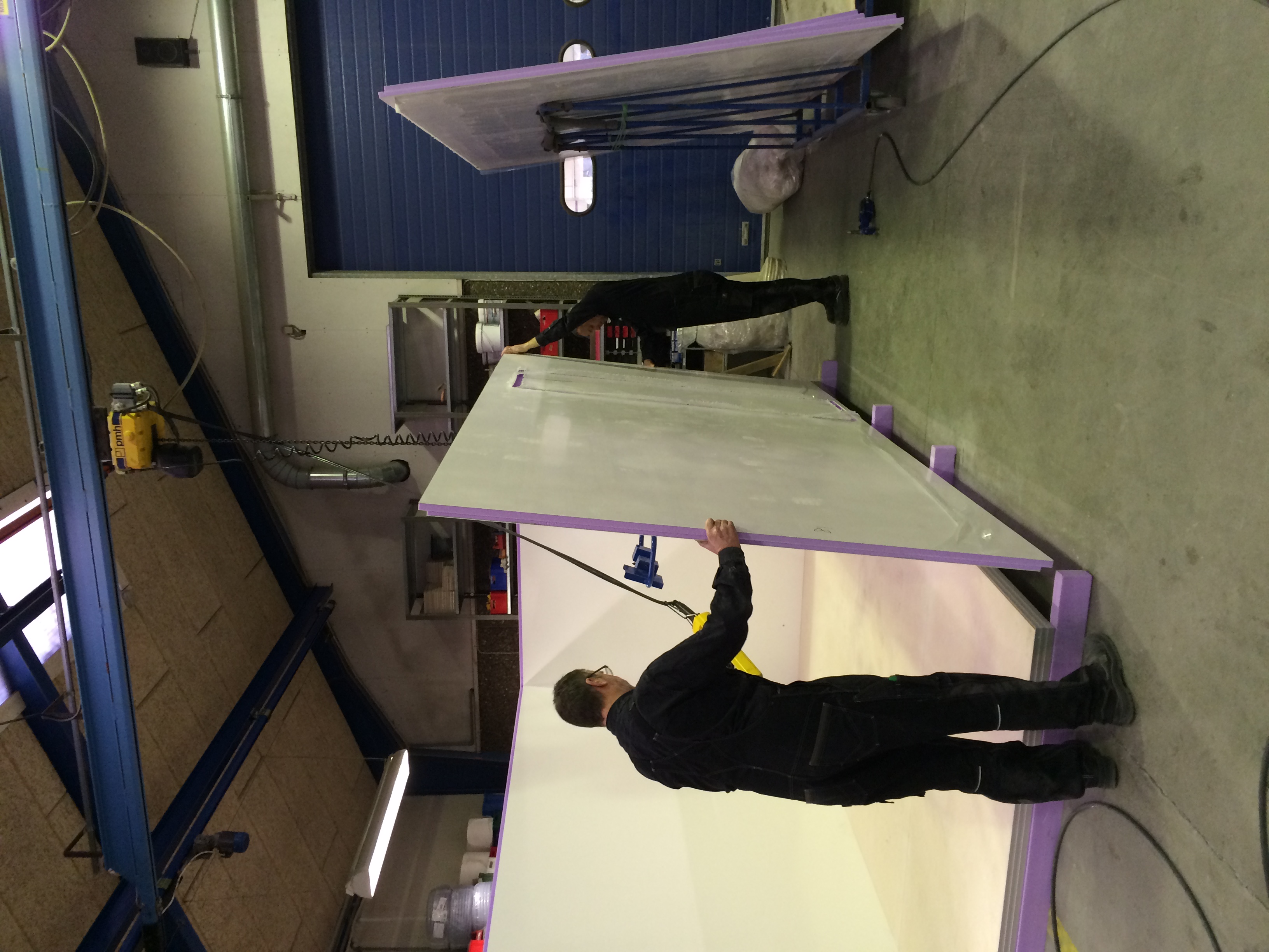

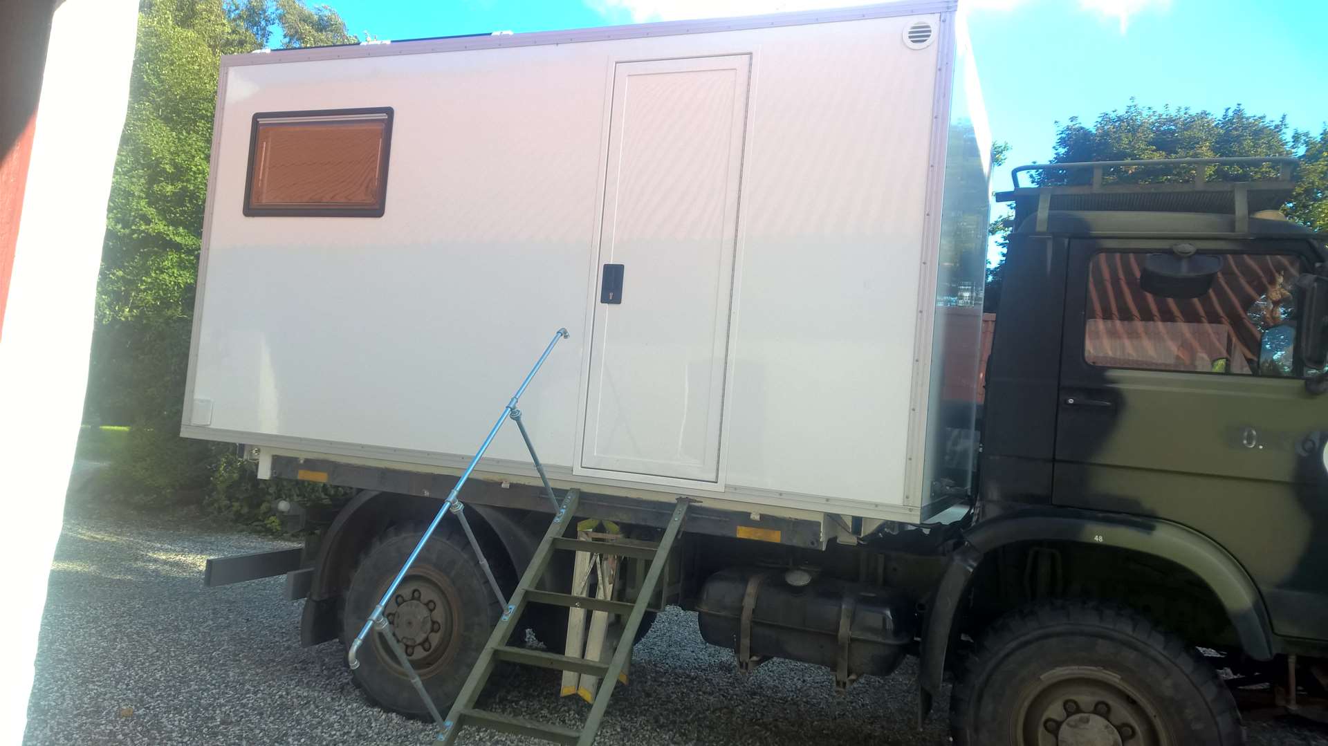

Now the new box is starting to take shape.
The panels are being assembled and the Outbound door are ready for mounting.
Soon we are ready to mount the new box to the car.
Best regards,
Benny
Outbound door
Almost finished
Door side ready
On the way

Pretty nice heating construction plan. I would add a water to air heat exchange (don't know the right word in English)
like this. The advantage is, to get a comfortable temprature within minutes and with air tubes behind or under the furniture you willget less problems with condensation and moisture. I think with your floor heating, which is really comfortable as well, it takes minimum 5-10 times longer to bring the cabin up to 20 degrees in winter. You can install the blower like a radiator and aktivate it with a thermostat or switch.
Post more pictures :eek: we all like to see your progress.
regards

For your water system I've a question:
You are planing a 200 Liter Watertank, so I guess you have to take care for your waterquality.
Do you want to disinfect your tank ervery time or are you planing to install a waterfilter??
These filters have the property to reduce your volumeflow drasticaly when using a ordinary pump (for example Schurflo)
If you want to have a accetable volumeflow to have shower with filtered water. You have some options.
a) Use more the one filters parallel.
b) Use a pressure tank behind the filter. But then you have just the volume of the filter with a high flow.
c) take a high pressure pumpe with a reducing valve behind the filter.
d) adjust two water taps in each sink filtered and not. For the shower: Dont drink the shower water :D
e) ... there are certainly more options ...

I have not yet decided how to ensure the water quality. I don’t like using chemicals, so I have considered using UV light. One possibility could be like this or similar:
http://www.ebay.com/itm/UV-Sterilizer-D ... 1545155058

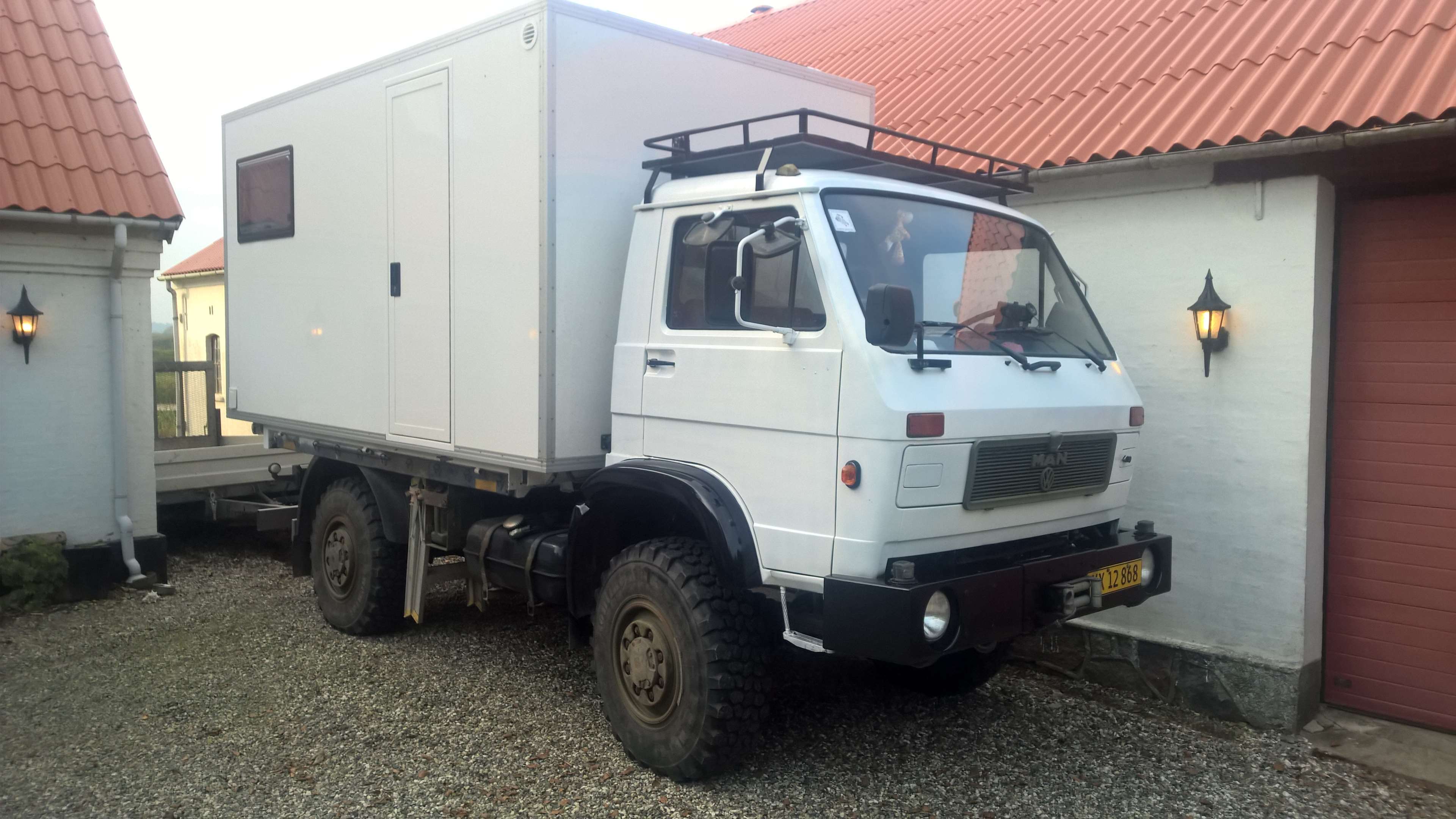

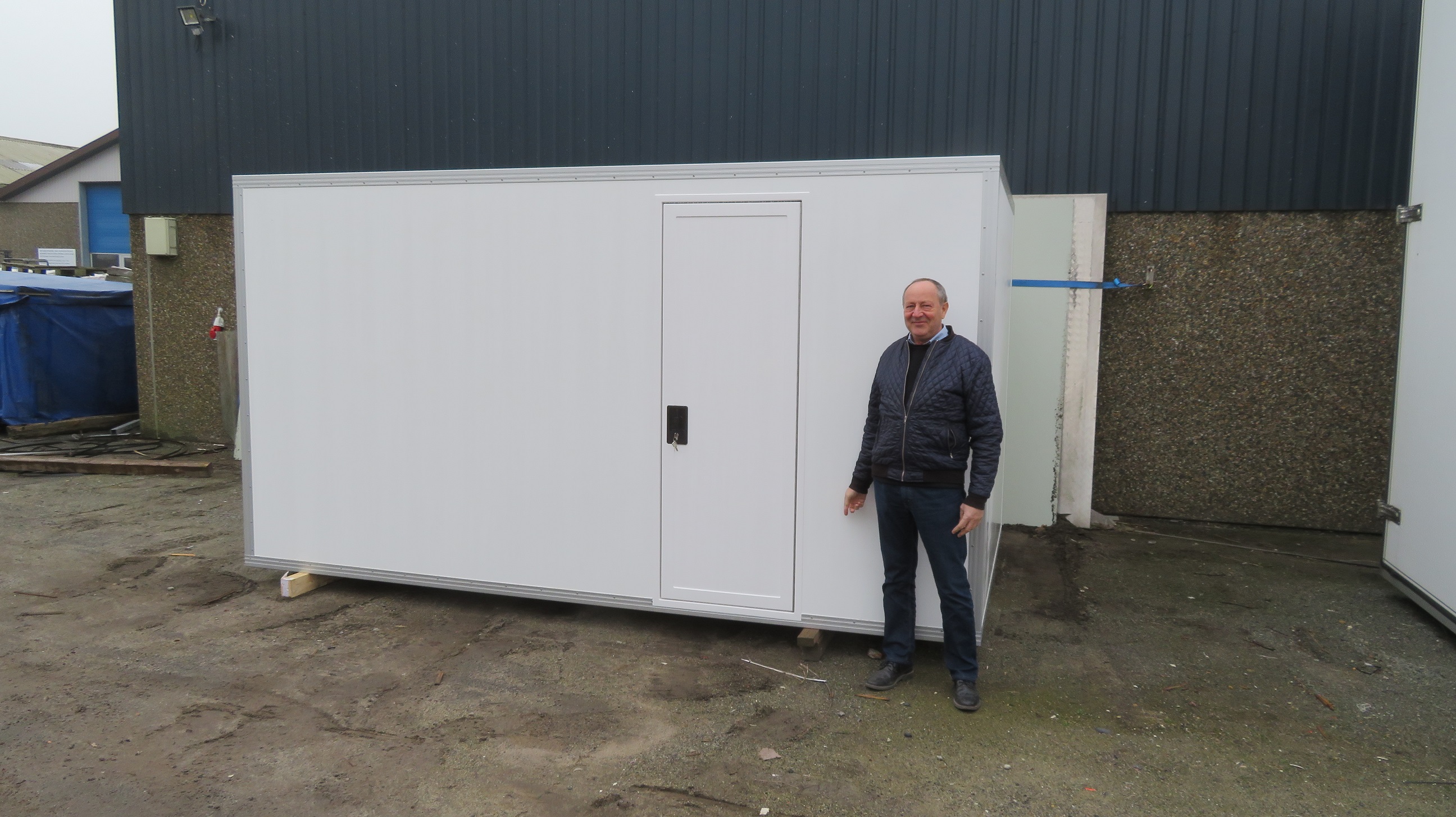

Now the new box are ready, and we have to finalize bracket and other stuff needed to prepare the box to be mounted and demounted when needed. It has been a busy Saturday, and tomorrow new painting will be done the places that will be hidden by the box.
Monday I will pick up the new box, and the real fun can start up :D
BennyDK
Beiträge: 38
Registriert: 2016-10-19 15:23:26
Wohnort: Fredericia - Dânemark
Re: Building new box for MAN 8.136
#14 Beitrag von BennyDK » 2017-01-30 20:15:29

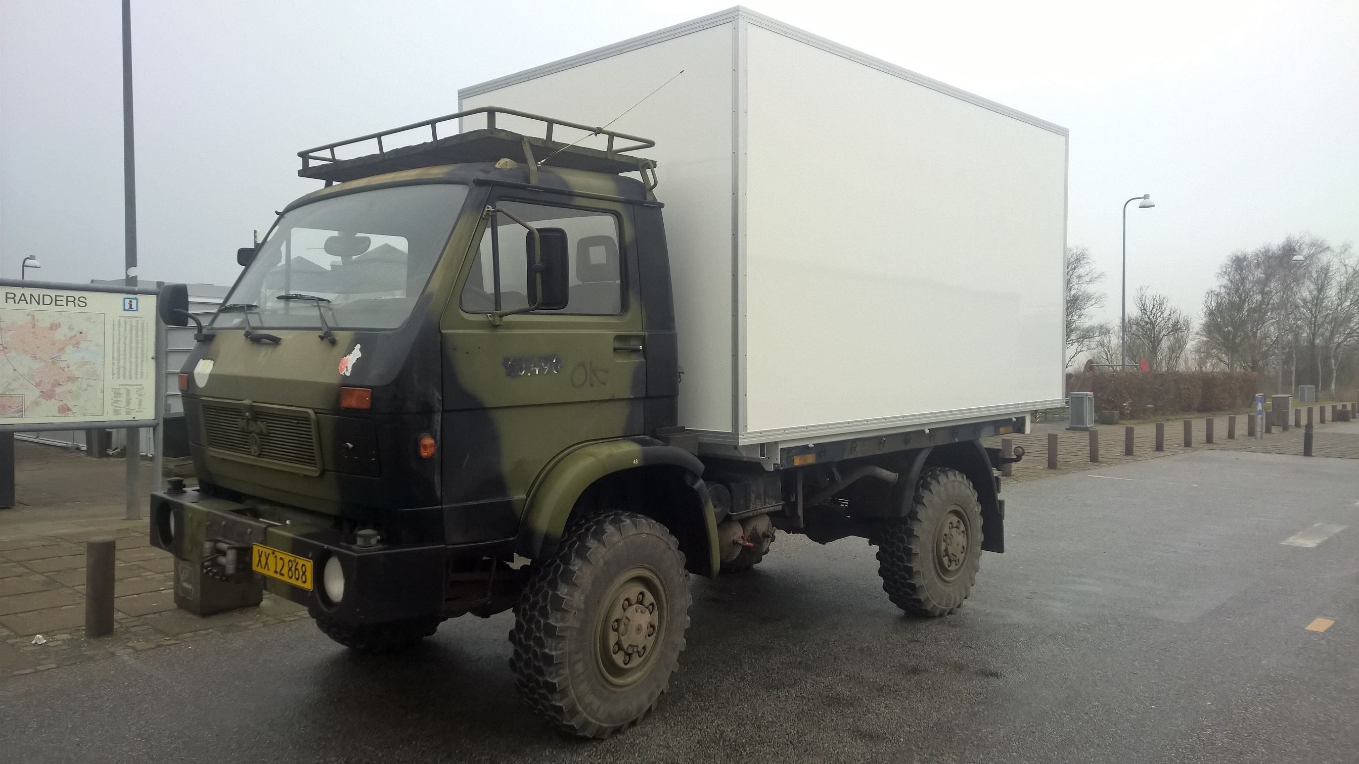

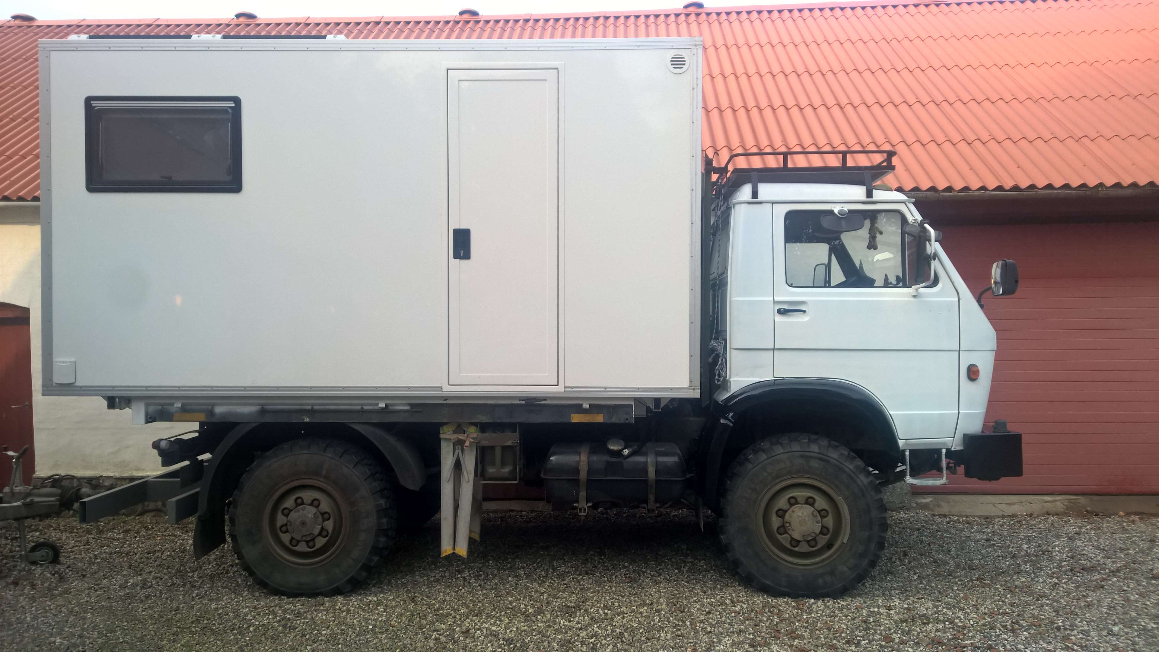

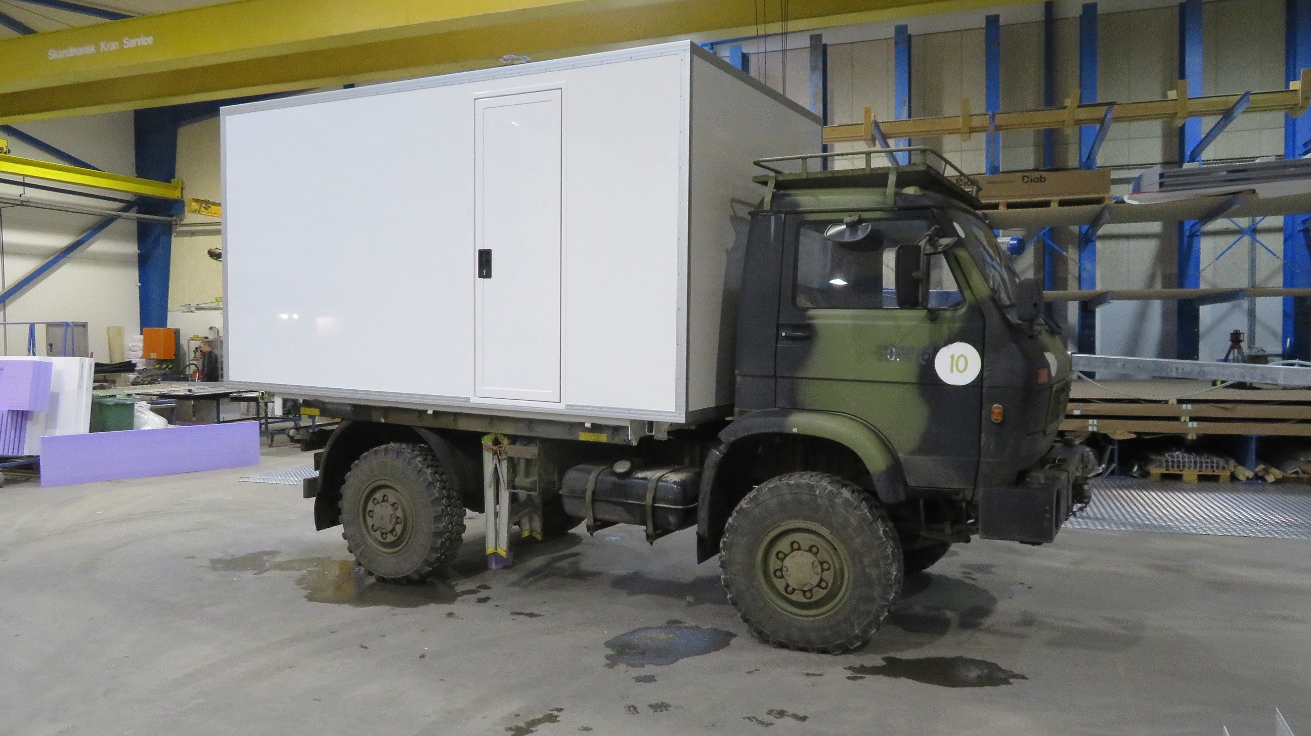

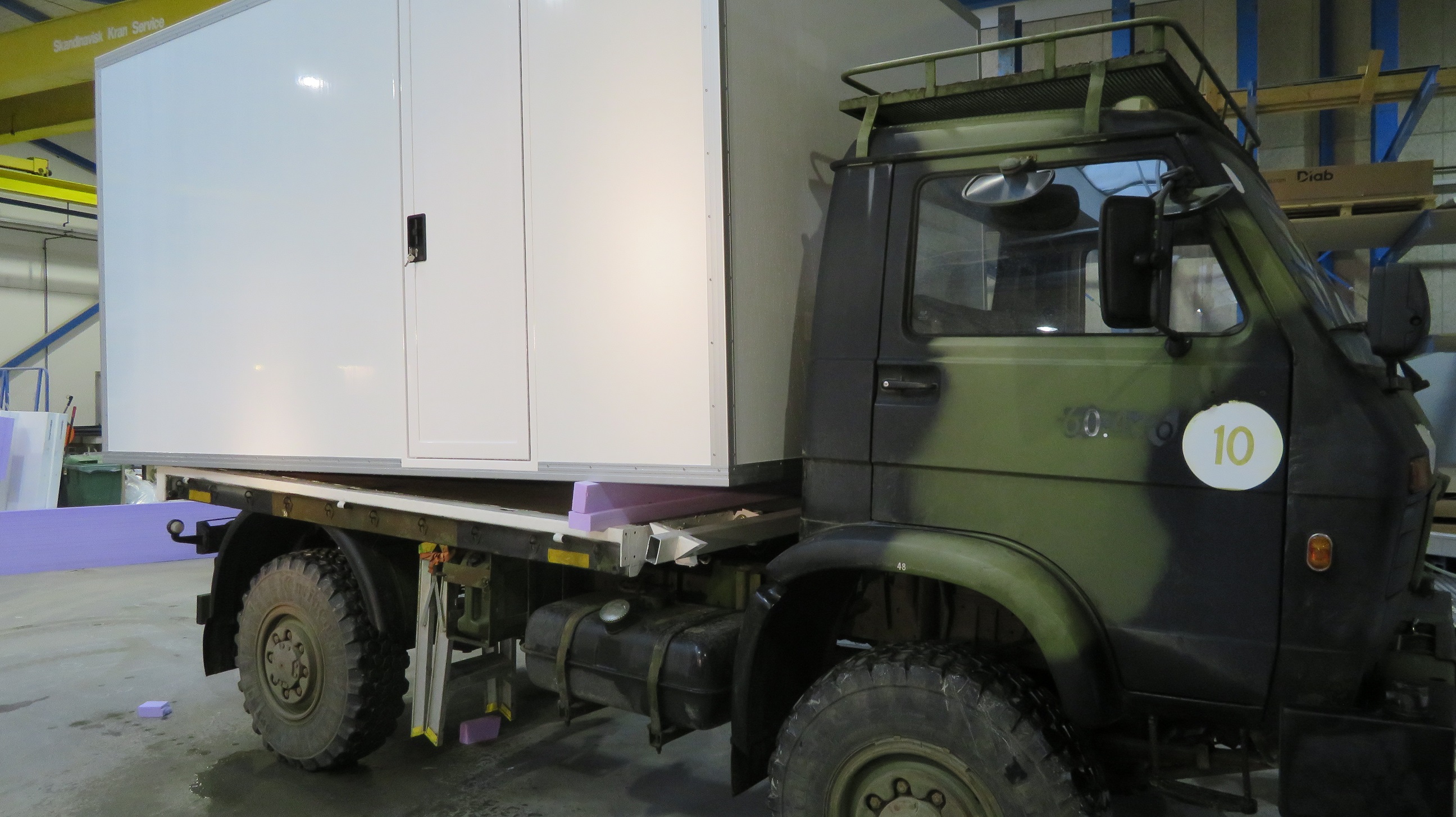

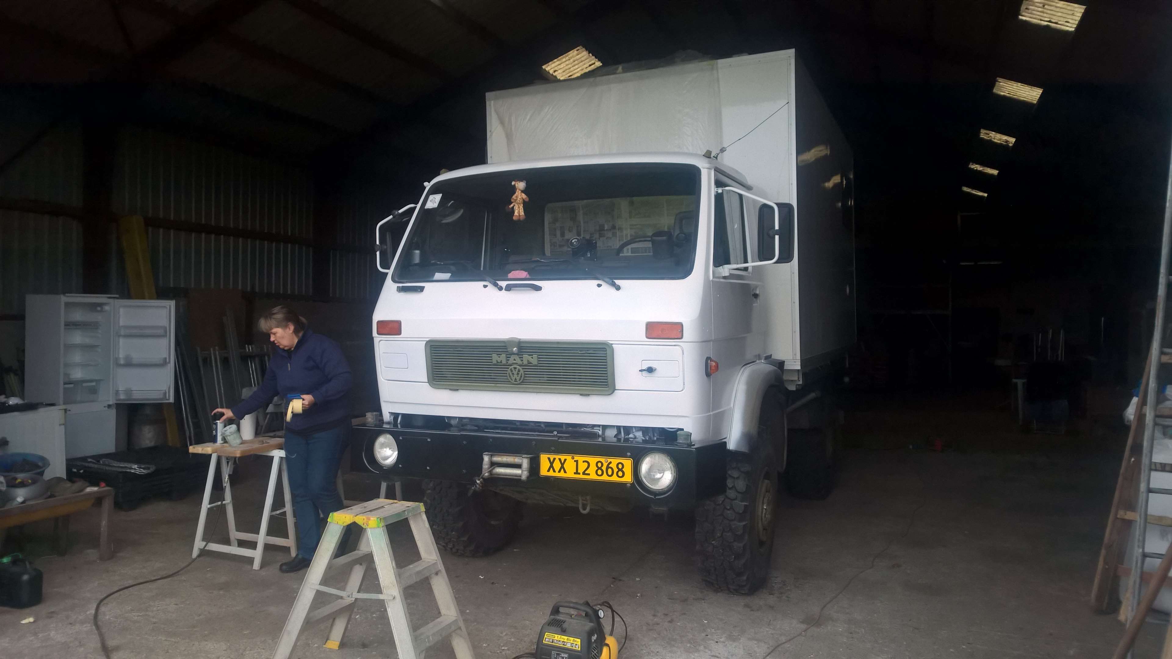

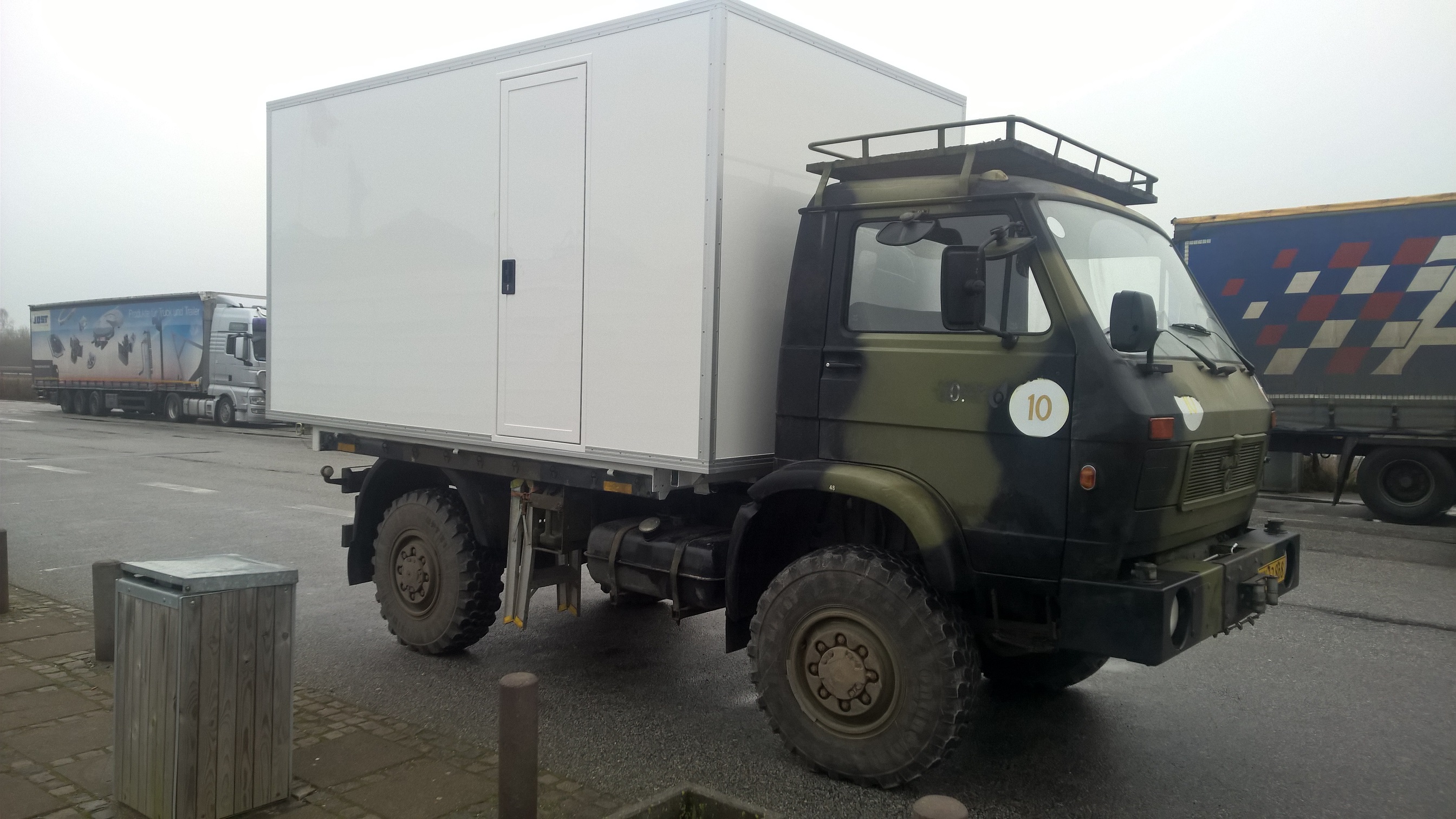

Today was the day to find out if the box actually does fit to the MAN.
I drove to the manufacturer (FiberCon) to review the box and get it mounted using the new brackets and fixings.
The box was real nice and exactly as we had agreed. All brackets and fixings worked as expected and we could mount the 8 large stainless bolts needed to mount the box. Everything fitted as expected and I was a very happy man. I think the size is just right for the MAN.

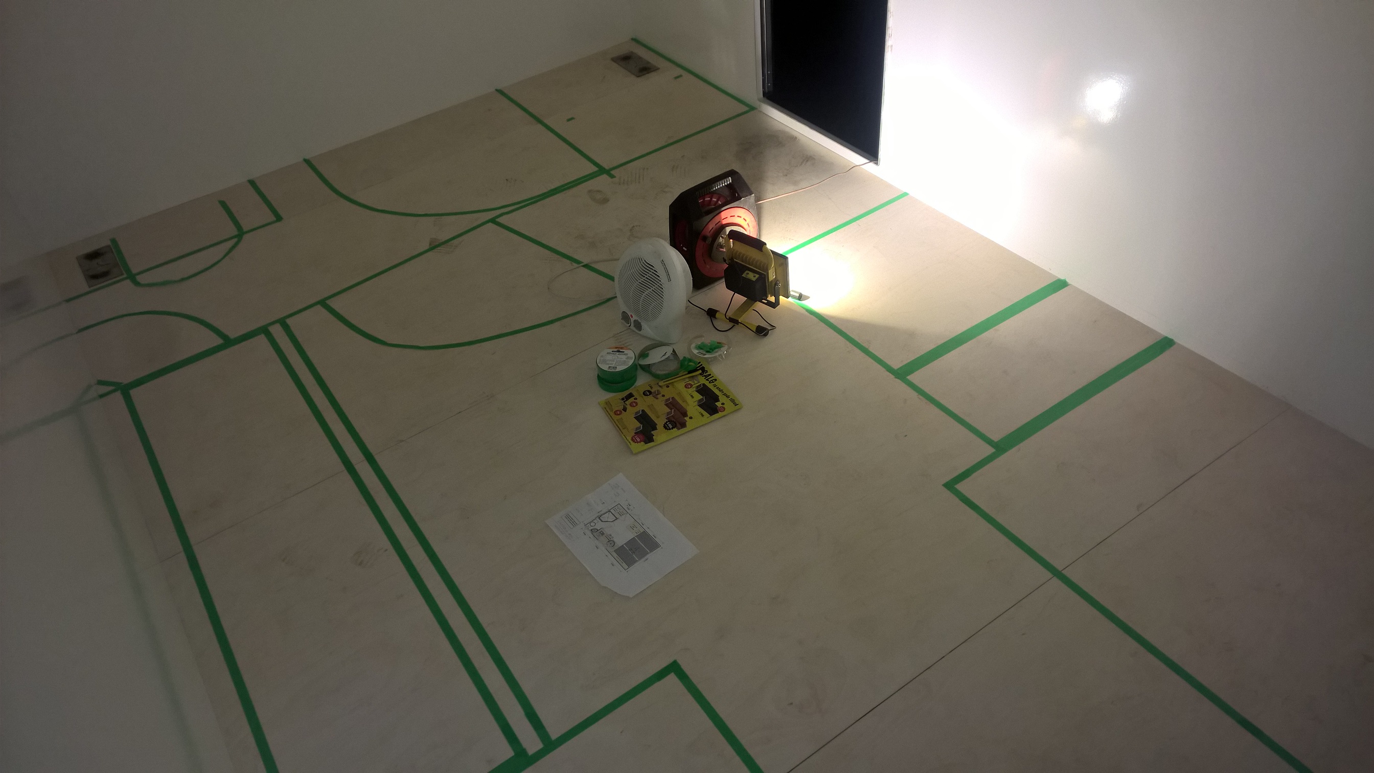

Bach home with the box, I tested how fast a 1000W electric heater could rise the temperature from 2 deg centigrade to 19 deg centigrade. 30 minutes was needed. Now I am sure that the 4KW Webasto will doo the job.
Jørn, Sales manager at FiberCon is handing the box over to me.

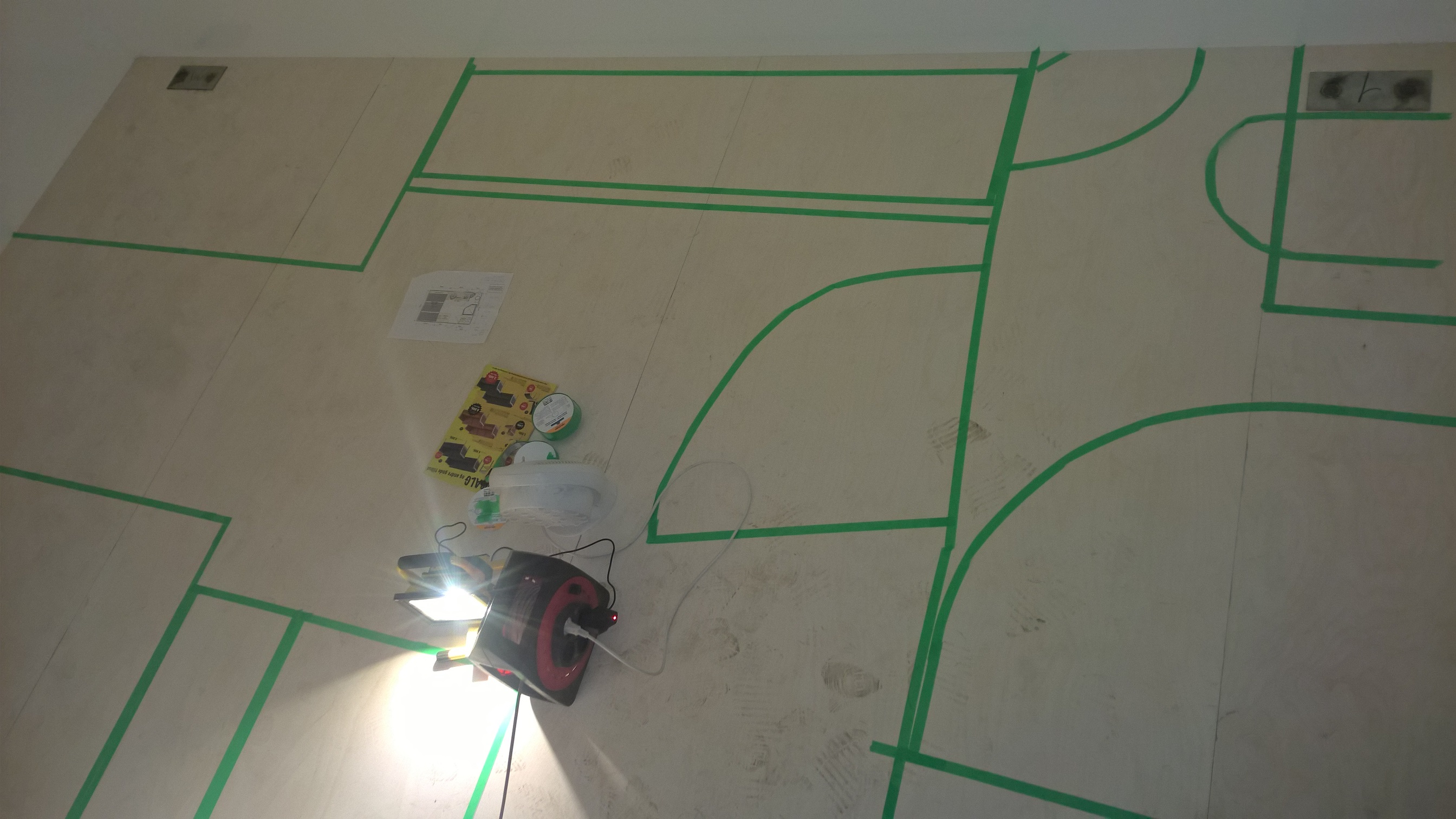

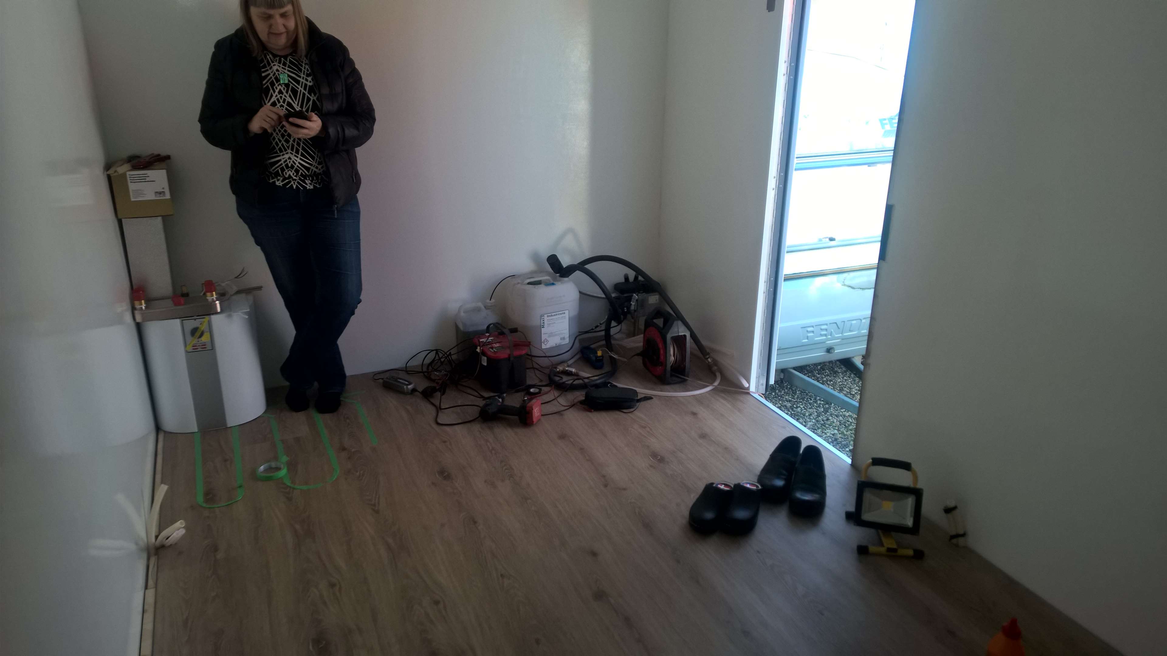

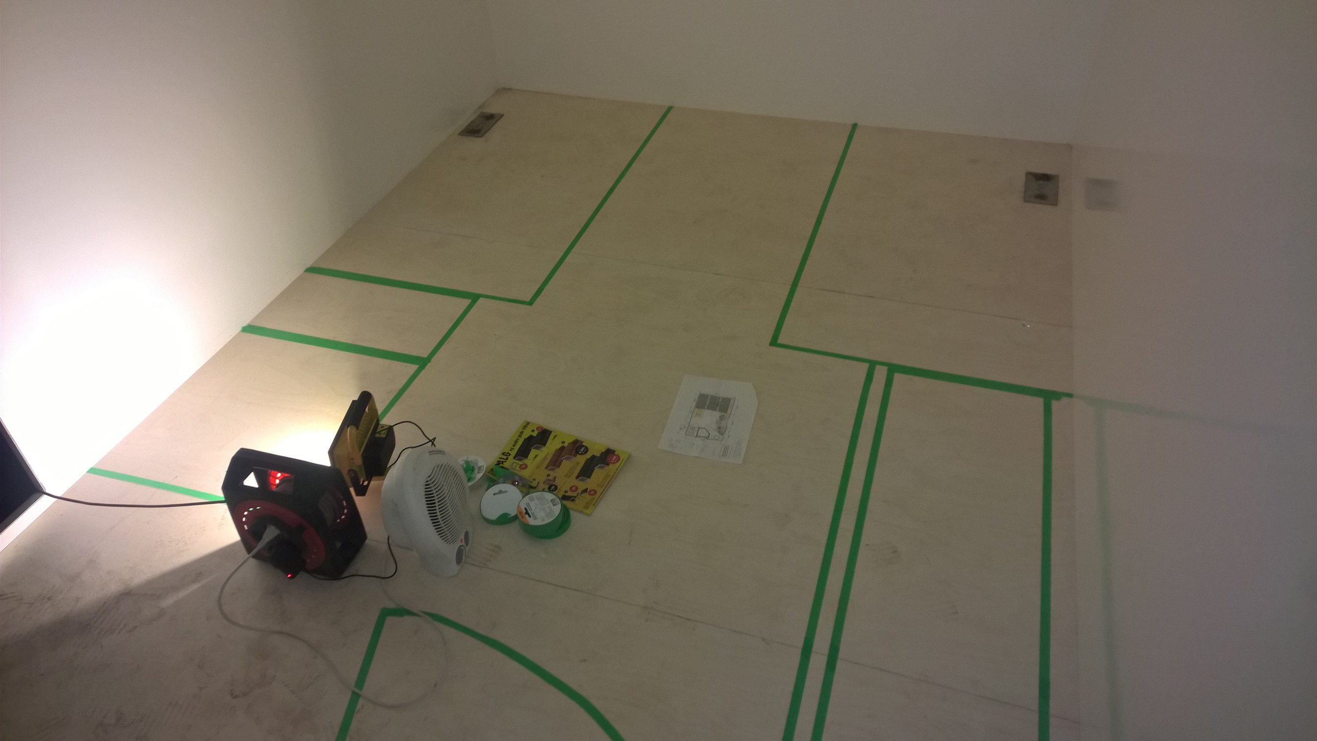

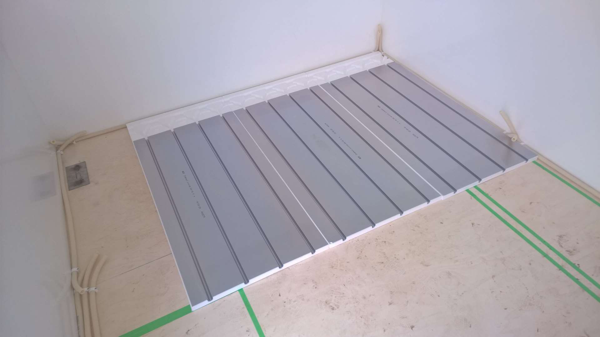

It is a fun process to go from thoughts and drawings, to the physical world.
With the box home at my own workshop, the truths about size and feeling of space can be tested. We have now marked up the floor with masking tape, to evaluate the layout. I don’t know if any other has tried to do the same before starting the actual build, but for us it definitely is showing much more than a drawing.

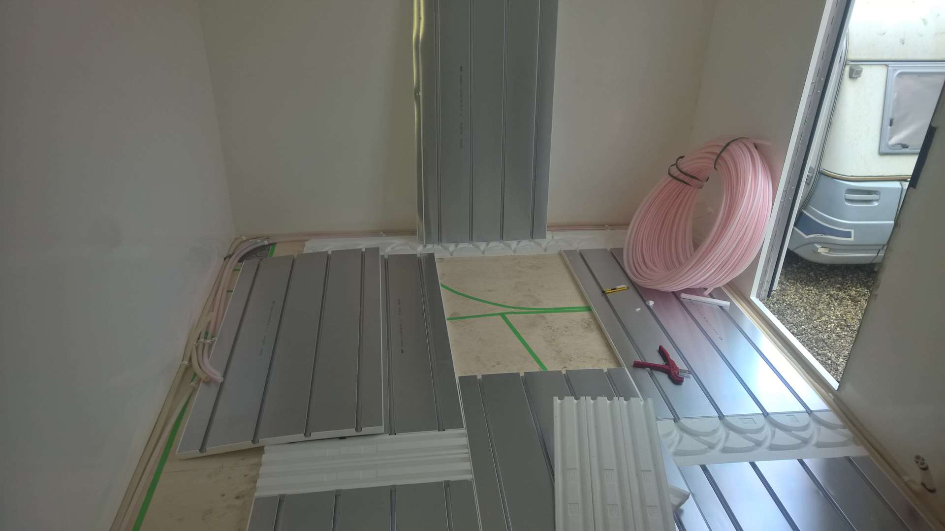

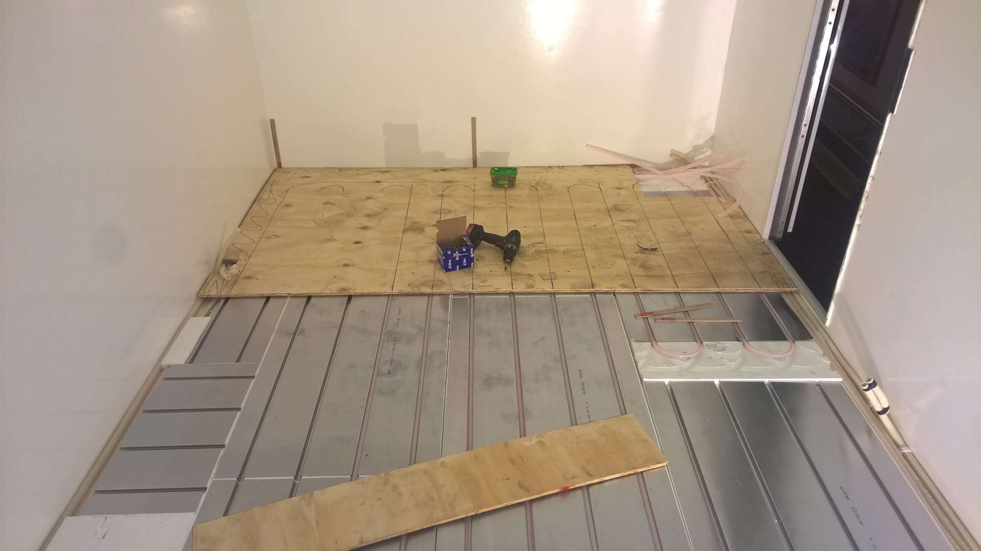

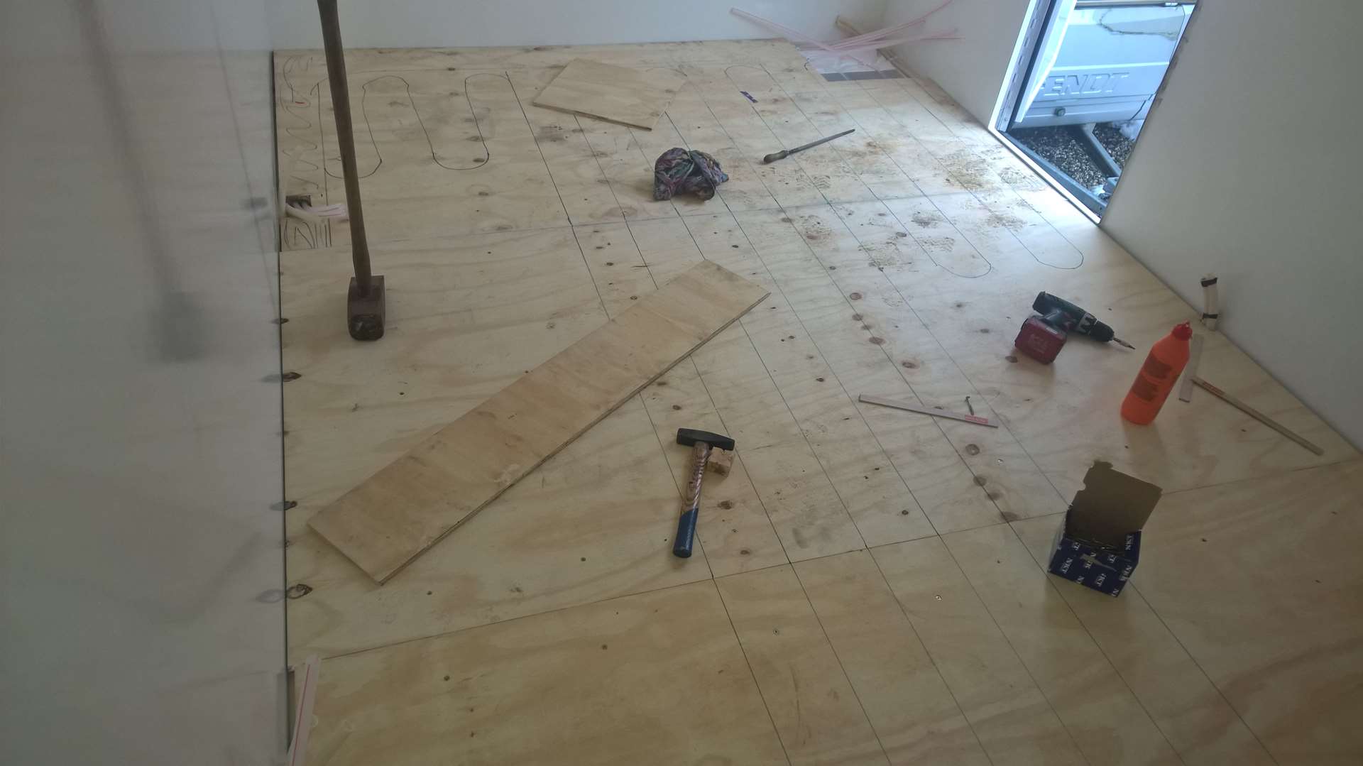

The next thing that will happen, is laydown of floor heating tubes and the new floor.
Any comment or input to our project are welcome.

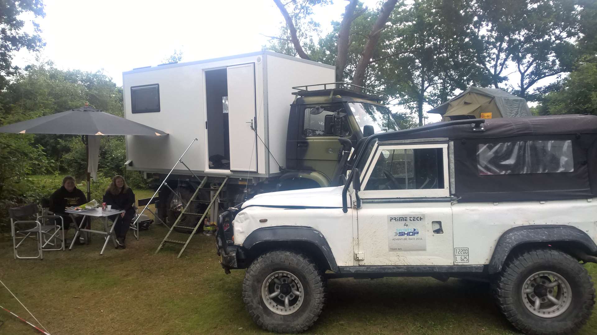

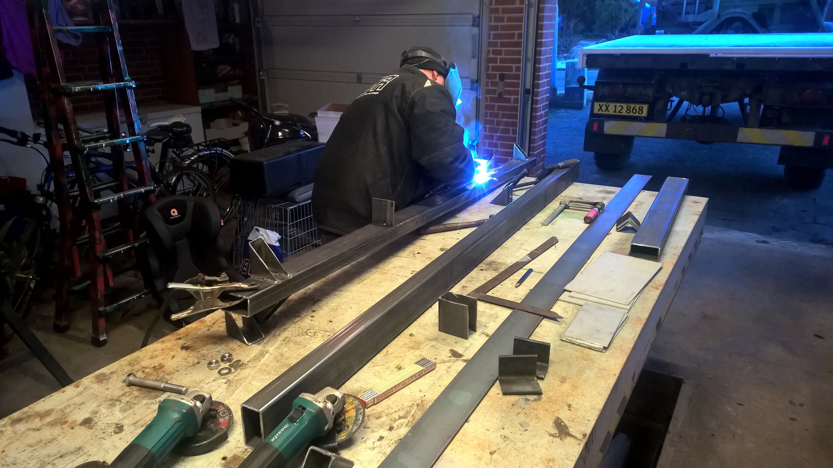

#16 Beitrag von BennyDK » 2017-02-13 10:15:10

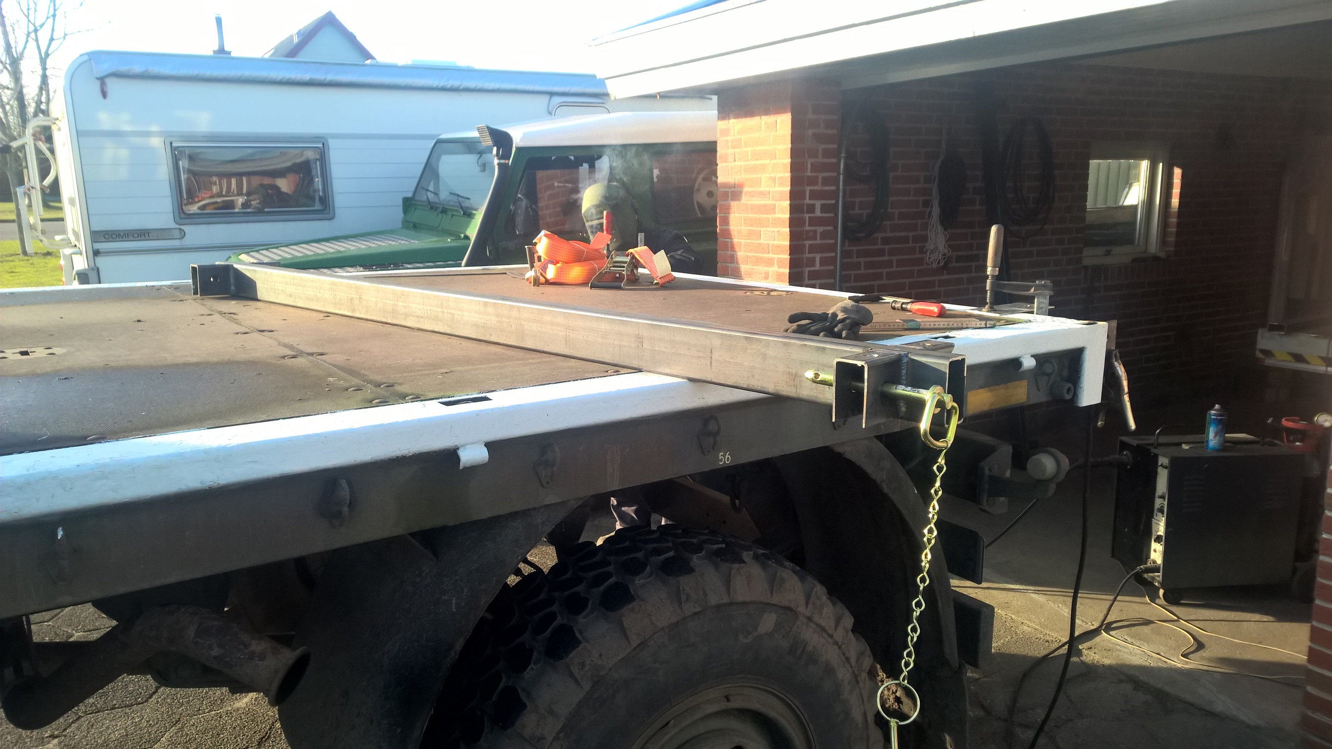

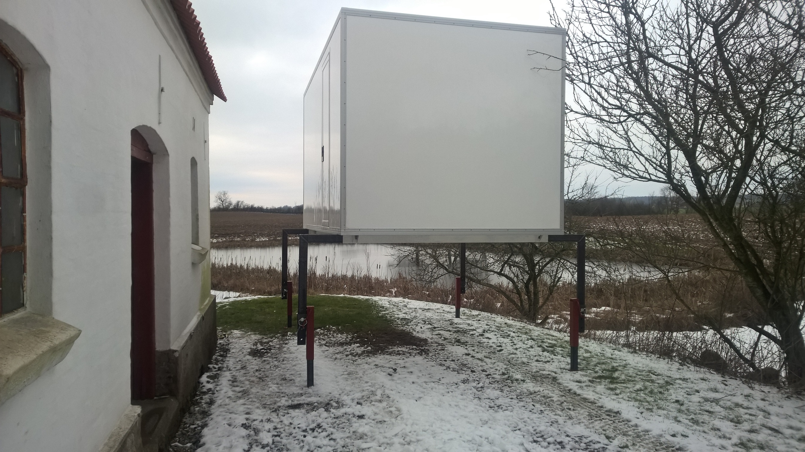

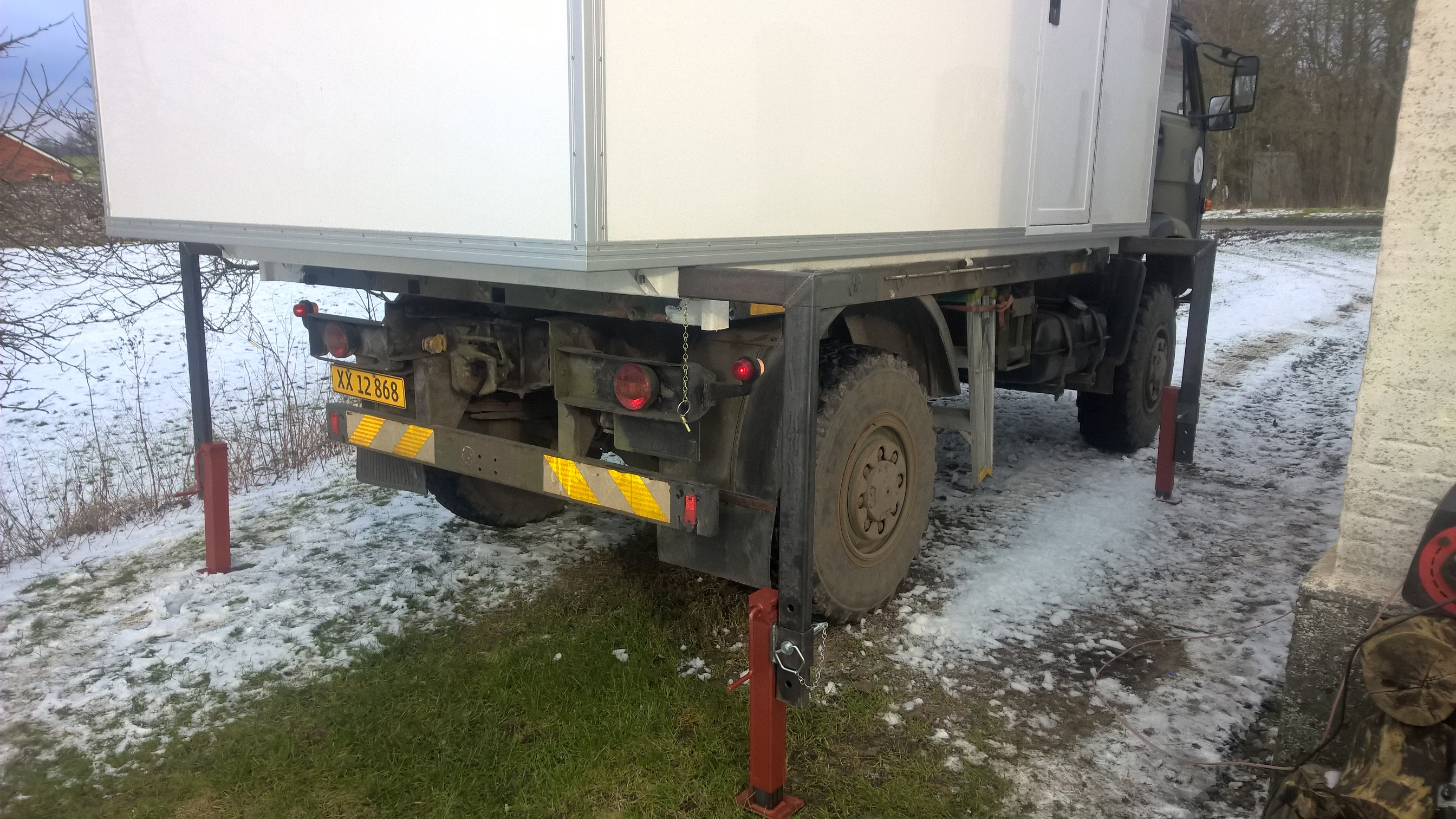

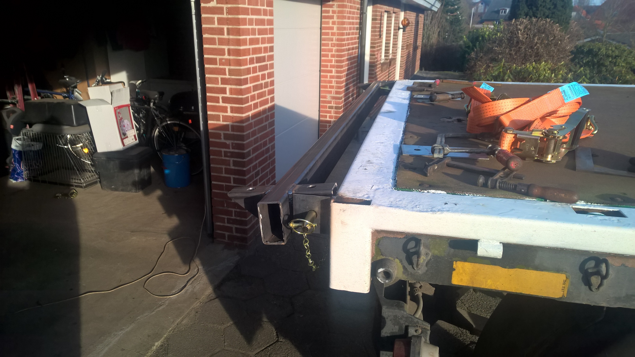

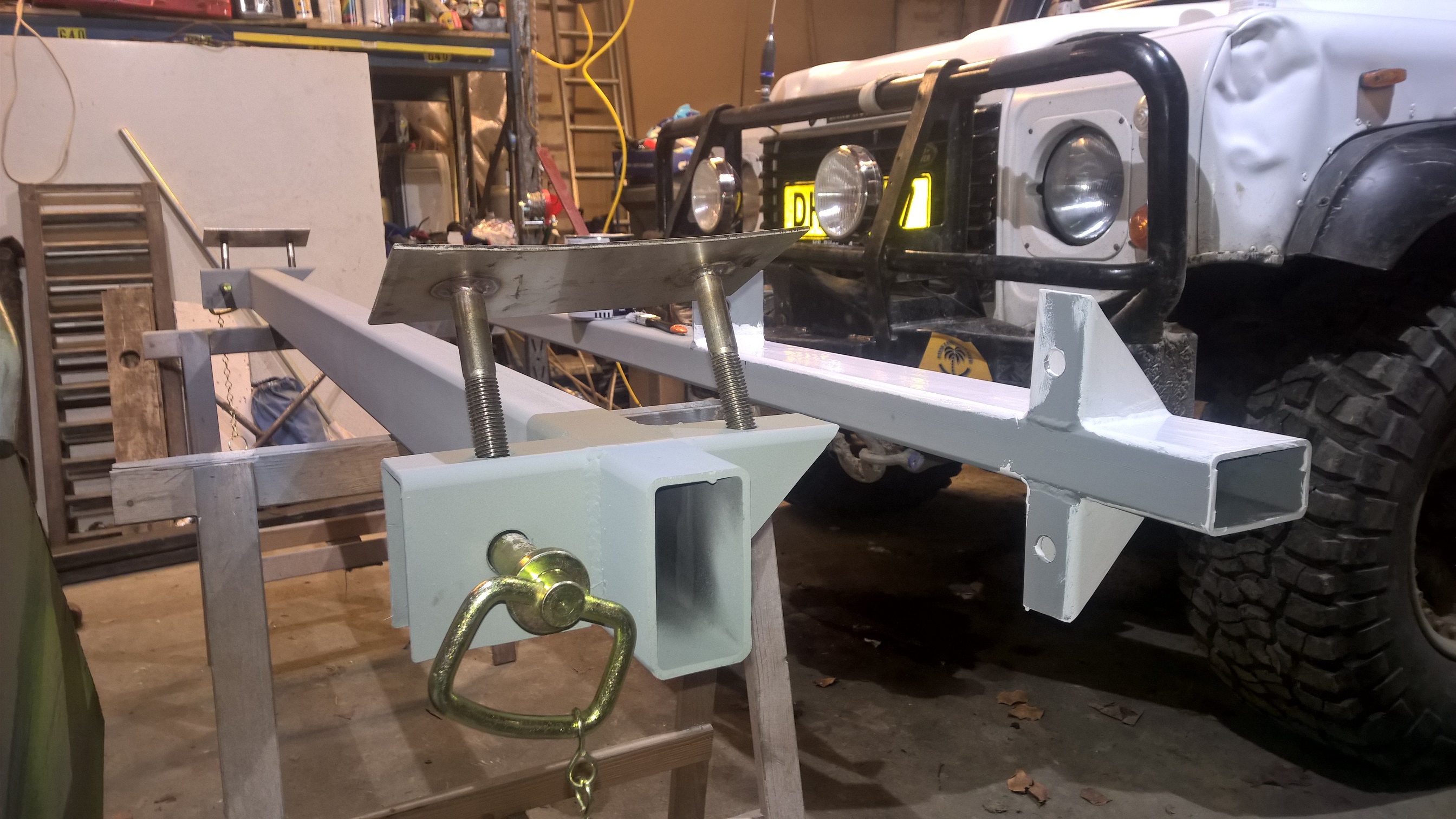

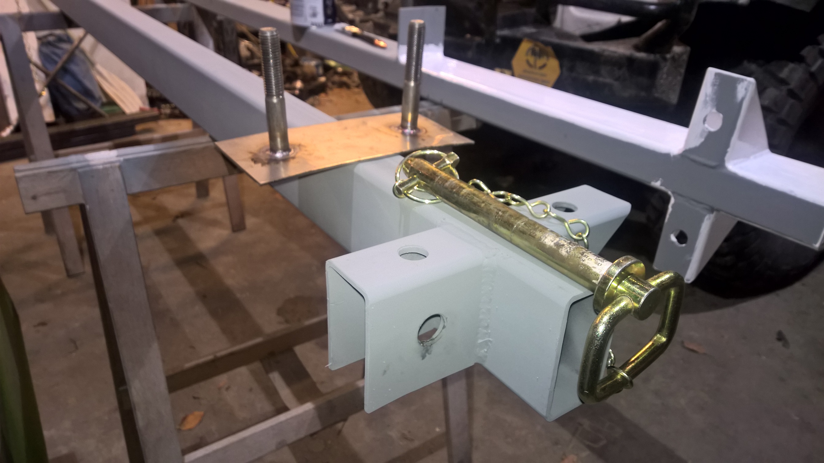

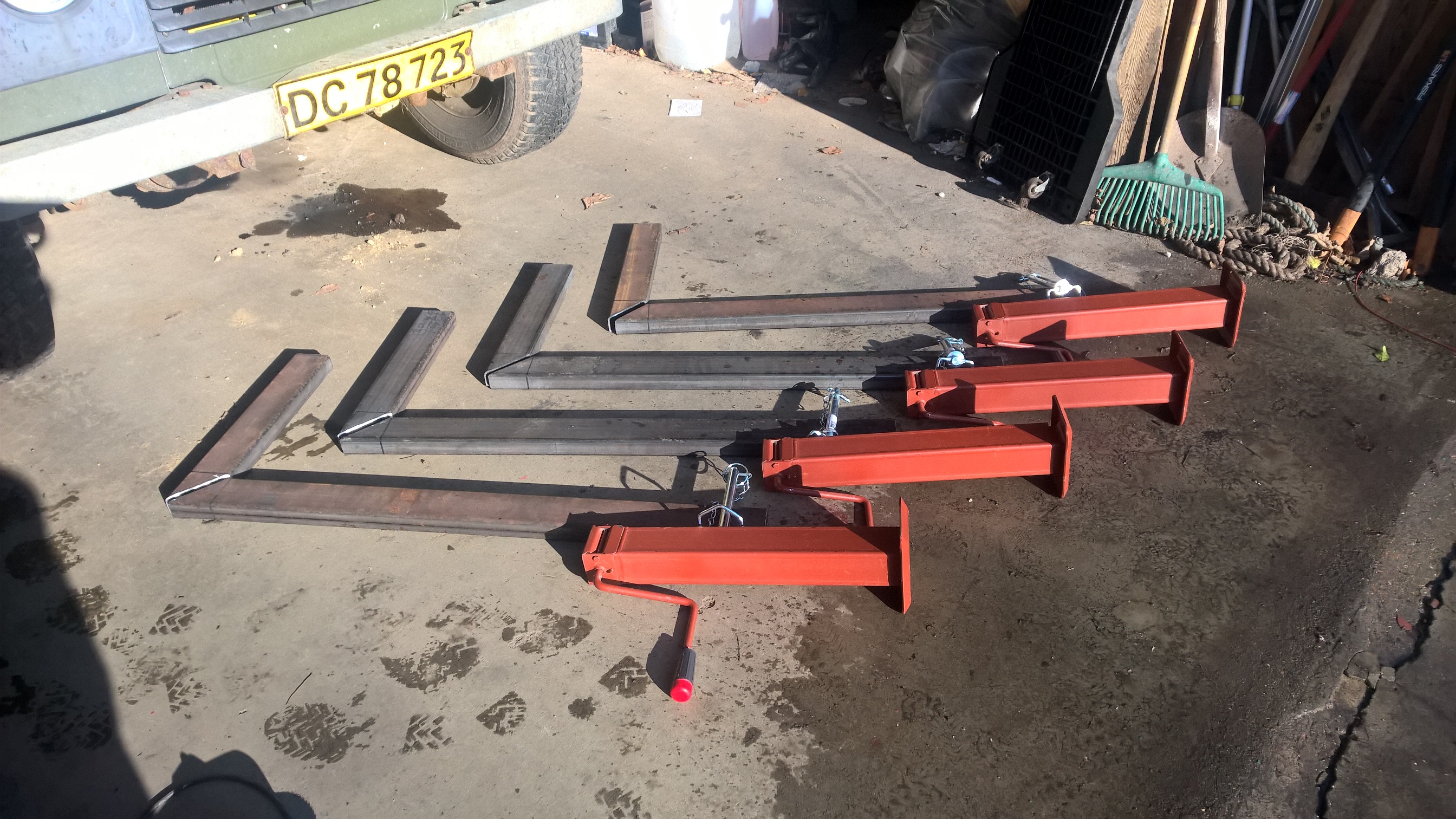

This weekend it was time for making the box able to "stand on its own feet's"
The box can now easily be de-mounted and mounted, and the MAN can be used as an ordinary truck when not carrying the box.
Each of the jacks can lift 1500 kg, so next step is to find a way of securing more stability for the stand alone box.

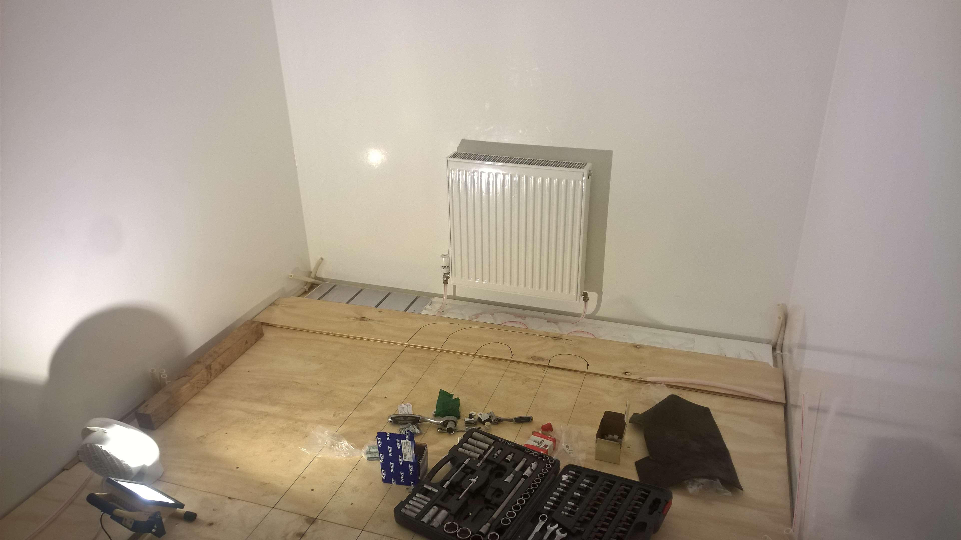

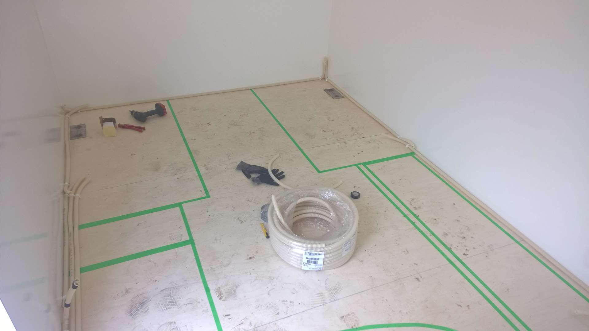

Now it was time to spend another day at the box building project for the MAN.
It was time to start up the working inside, and the first to do is preparation for electrical and heating installation.
I started preparing the electrical installations, by fitting empty flexible pipes that later on can be used to guide the needed electrical wires. The flex pipes is mounted all the way round the edges, with more pipes where I expect to need more wires. The tubes for cold, warm and waste water was also mounted.
When I did the drawing for the box, I already planned for floor heating. The floor heating is done by using a 24 mm system prepared for 16 mm heating tube. The system secure equal heat distribution by pre formed aluminum profiles in the Styrofoam.
It was a little fiddly to ensure that the floor heating ended up only for the visible floor, and not below kitchen, fridge or water tanks. But when the heating tube is fixed in the aluminum profiles, it is actually ok.

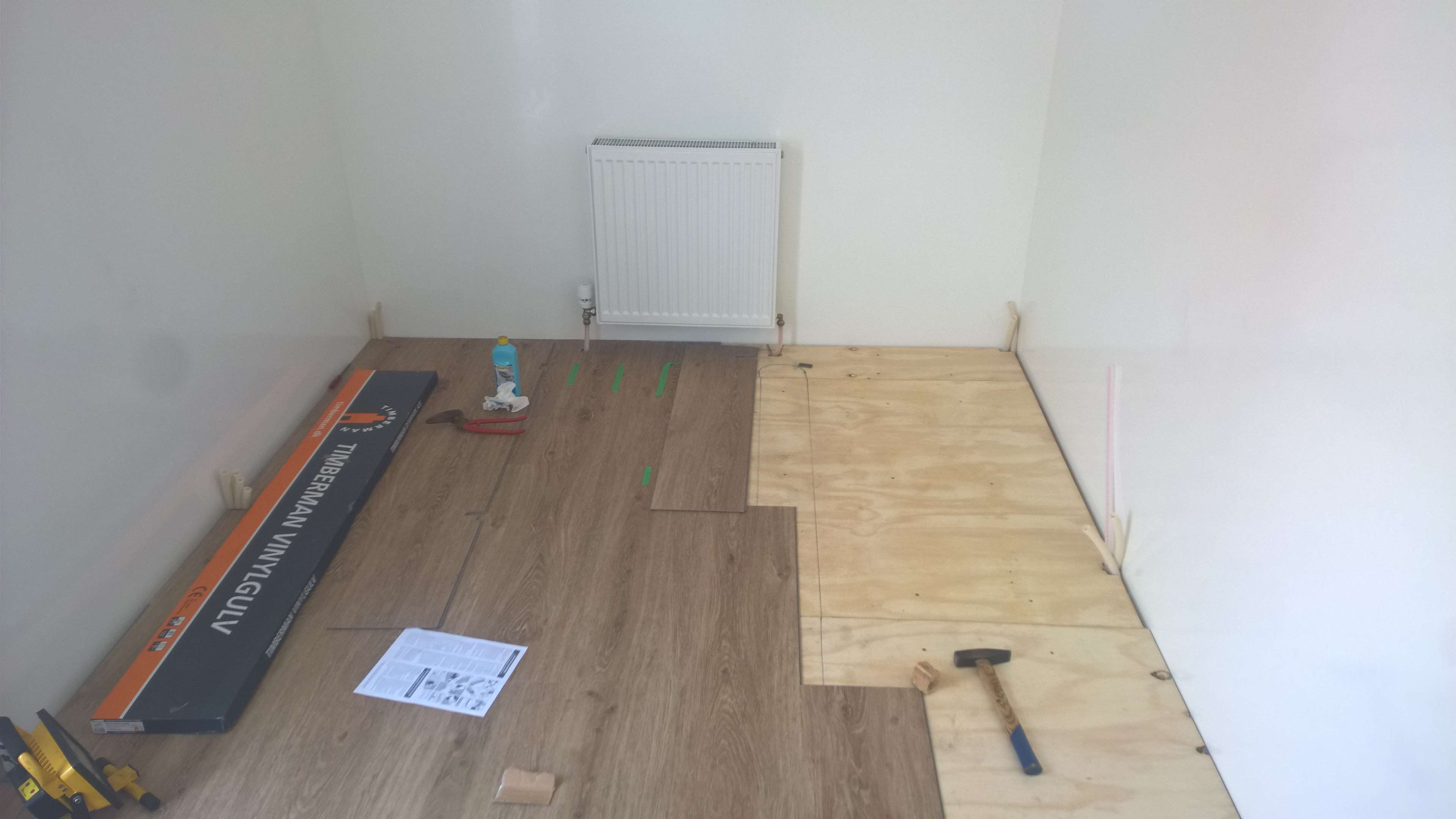

On top of the 24 mm Styrofoam, I mount 12 mm plywood. The plywood is simply mounted into the original floor of the box, ensuring not being too close to any of the heating tubes. I used a marker to illustrate the position of all tubes below the plywood floor.
Before I can continue with the floor, I now have to mount the heating system. When the heating system is mounted and functional, the floor can be heated and the moisture can be removed. Then the final vinyl floor can be mounted.
If you have any comments or ideas, please do not hesitate.
Best Regards.
Benny
To be continued
For electrical wires and water
First module plate is tested
A little fiddly with all the pipes
Starting with the final 12 mm plywood
Ready for heating

#18 Beitrag von BennyDK » 2017-03-13 12:39:31
The heating and floor are now finished.
The Webasto Thermo Top is running smoothly and heat distribution in the floor is as expected. The floor heating is only mounted in "walk" areas.
We have chosen to mount a radiator in circulation with the floor heating. The thermostat for the radiator is this way also controlling the floor heating.
The outside temperature is at the moment between 0 and 5 °C and with an constant inside temperature in the box at 23 °C, the consumption is 1,5 liter of diesel per day. Way below what is needed in our Fendt caravan.

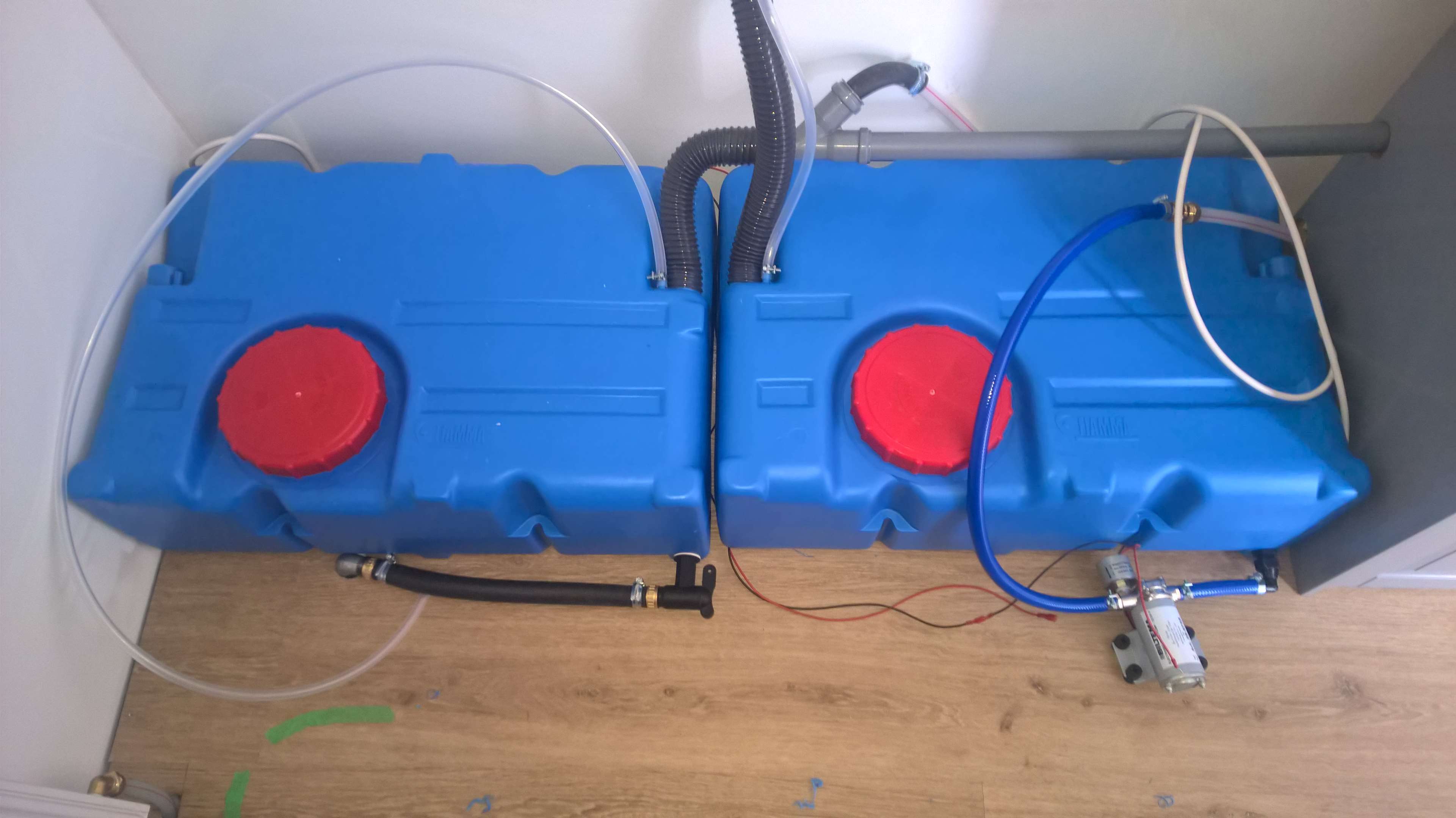

It has been some time since the last update, but the building is slowly stating to take shape.
- Most of the furniture is ready to be mounted permanently.
- The heating is finalized
- Water tank for fresh and waste water is finished
- Drain to waste water tank is finished
- Cold/hot water is running

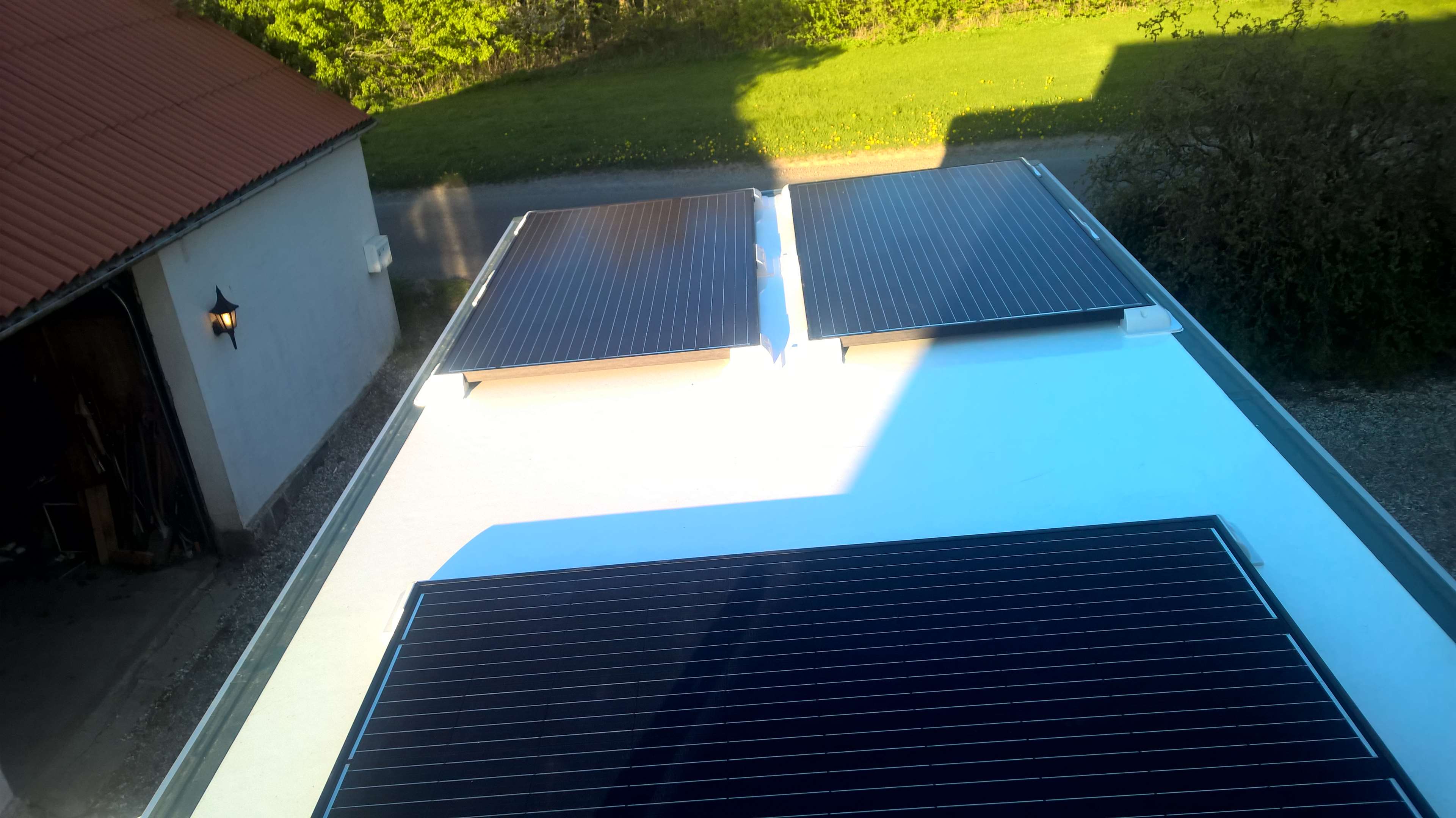

- Battery bank and inverter is running, inclusive "land-power"
- Solar panels is mounted, but not yet connected

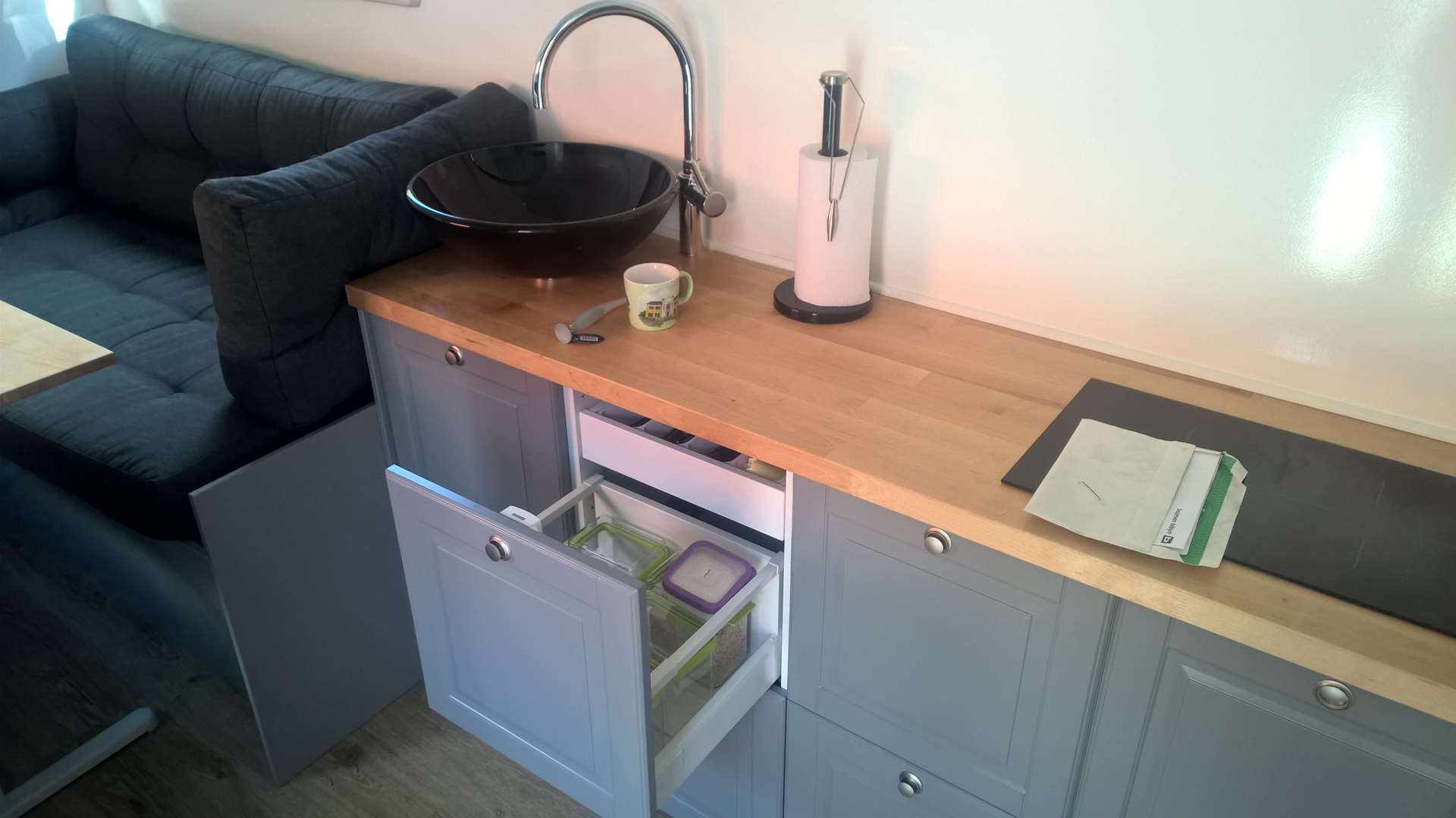

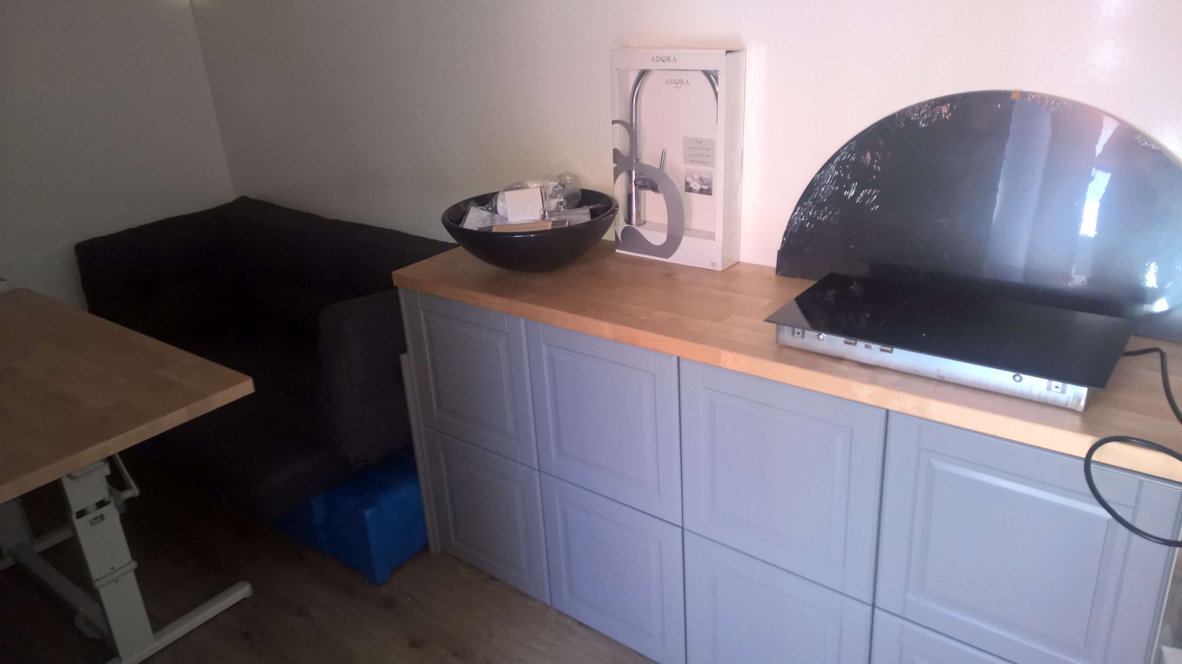

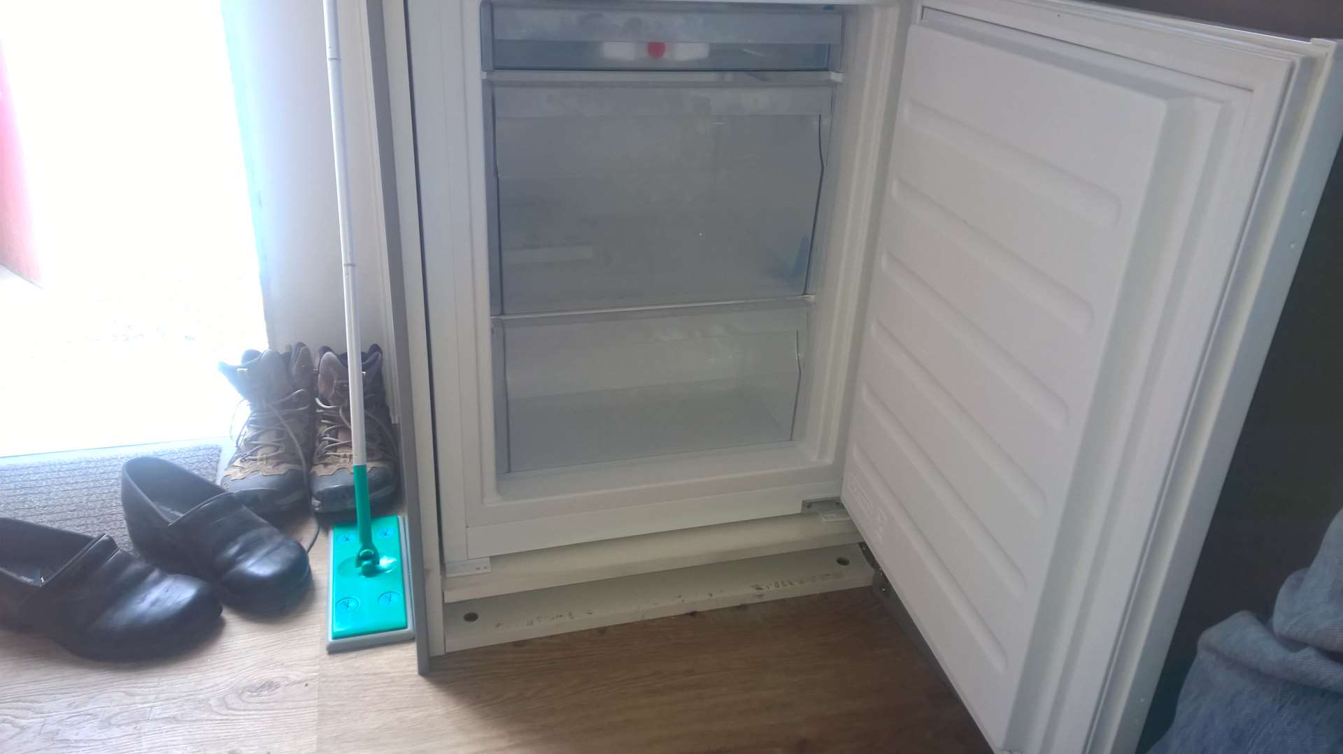

Furniture is ready to be mounted (All is from IKEA)
Heating is finished and hidden in a cabinet
Water tanks for fresh and waste water 2 x 70L (one more for fresh water will be mounted later).
Preasure pump and drain are ready
Hot and cold water running with constant 2 Bar preasure
3 x 24V 80 Ah marine battery in the camperbox + 1 x 24V 110 Ah starting battery on the MAN.
240V 2500W sinus inverter/controller/charger
3 x 300 Wh solar panels mounted on the roof

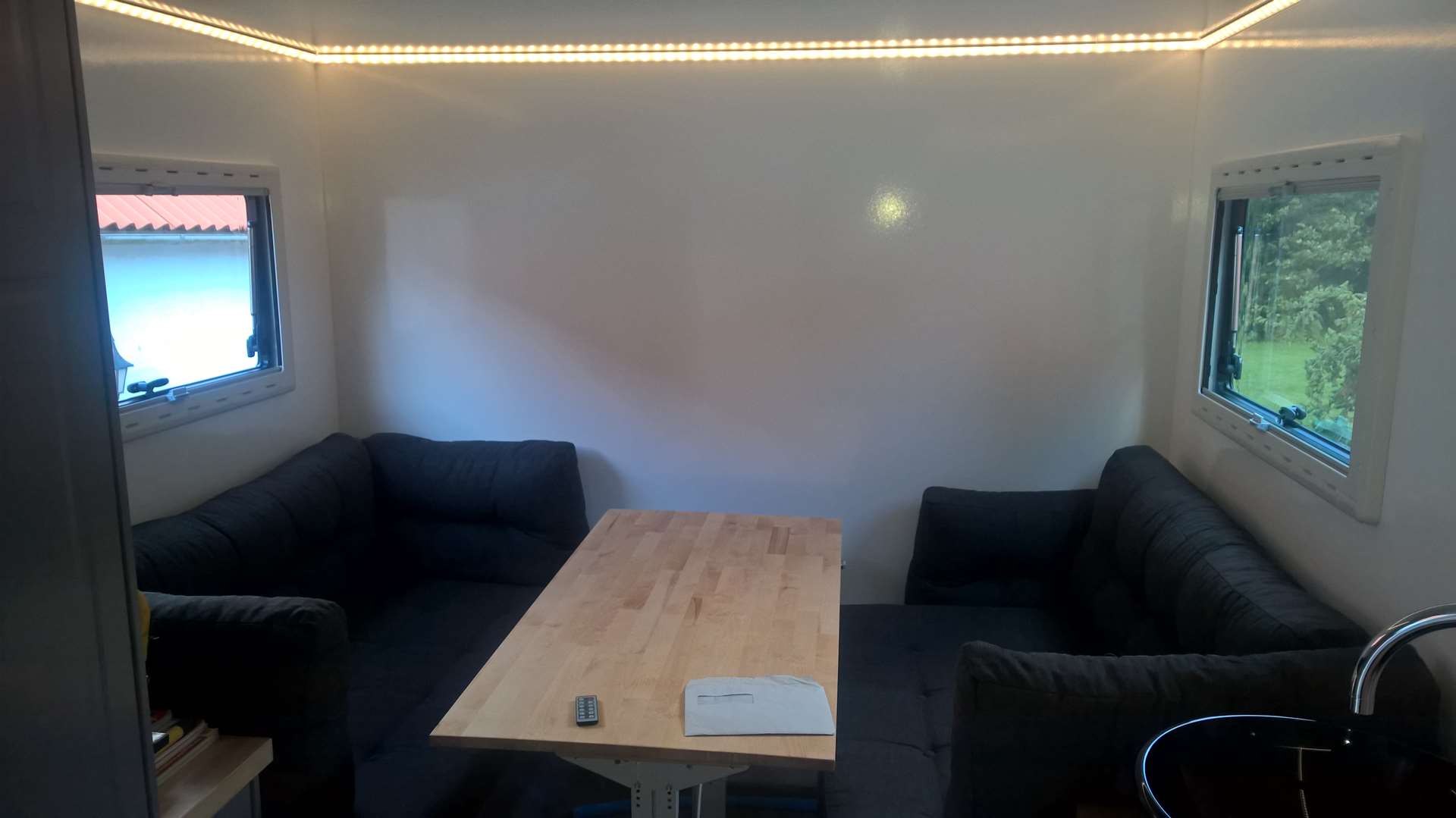

Das Bauprojekt der neuen Box für unsere MAN 8.16 ist nun knapp am Ziel.
Wir haben die Box schon eine Woche im Sommerurlaub getestet, wo wir zum jährlichen Offroad-Treffen im Danish Land Rover Club Teilnehmer war.
Ich habe mich dafür entschieden, diesen Beitrag auf Deutsch zu machen, weil ich gerne ein paar Kommentare zum Projekt hätte. Also habe ihr irgendwelche Kommentare oder Fragen, fühlen Sie sich frei zu fragen.
Die Box hat jetzt folgende Ausstattung:
Die Kiste:
Dach und Wände in 50 mm Glasfaser-Sandwich
Tür von Outbound
Boden in 30 mm extra starkem und hitzebeständigem Glasfaser-Sandwich + 12 mm Sperrholz + 20 mm Styropor mit Fußbodenheizung + 12 mm Sperrholz + 3 mm Vinylbodenbelag
2 x Seitz S4 Fenster
4 x externe Stützbeine zum Heben der Schachtel an und aus dem Auto
Heizung:
Webasto Diesel für Wasser
Durchlauferhitzer für Warmwasser
Fußbodenheizung und einem Heizkörper
Elektrisch:
3 x 300Wh Sonnenkollektoren
2400 W Wechselrichter für 230V
Möglichkeit für "Landstrohm"
6 x 80Ah Exide marine Batterien
Stufenlos LED-Licht mit Fernbedienung
Mehrere 230V Steckdosen
Wasser:
140L Wasser
70L graues Wasser
Konstant Druck (2 BAR) Wasserpumpe (24V)
Wärmetauscher für warmes Wasser
Vorrichtungen:

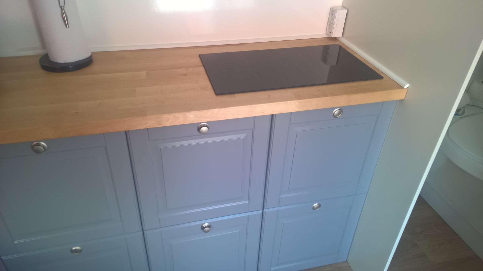

IKEA Möbel
IKEA Kühlschrank / Gefrierfach
IKEA Induktionsherd

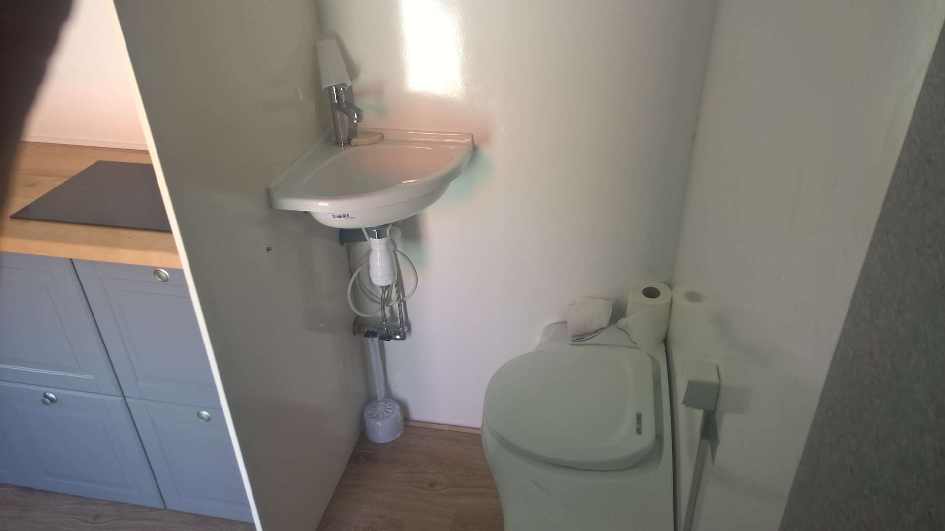

Thretford Kassetten-WC

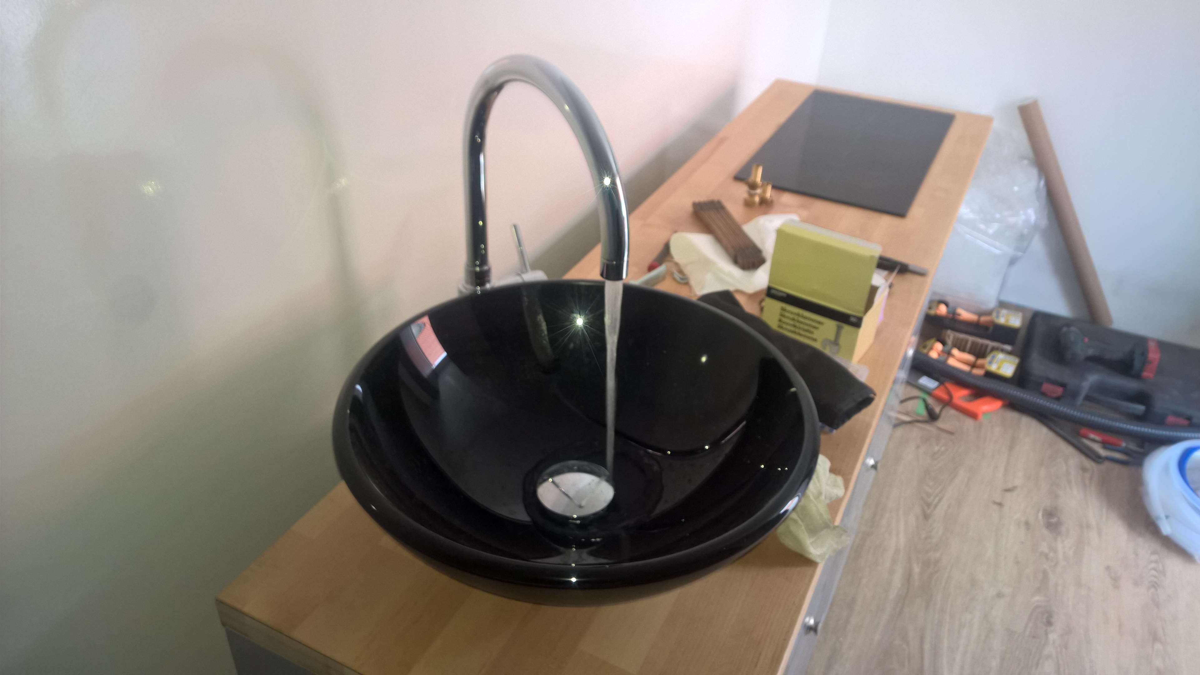

Warmes und kaltes Wasser in Küche, WC und Dusche
Alles scheint wie erwartet zu sein. Wir sind sehr zufrieden mit dem Bild und freuen uns darauf, für etwas anderes Zeit zu haben, als die Box zu bauen
Dusche mit Thermostat
Gefrierschrank
Kühlschrank
Induktionsherd
LED-Beleuchtung
IKEA Küche und Waschbecken von Bauhaus
Höhenverstellbarer Tisch, der ins Bett verwandelt werden kann
Toilette mit Waschbecken
Bereit für eine neue Reise
Treppe mit Geländer
Premiere Tour mit Land Rover

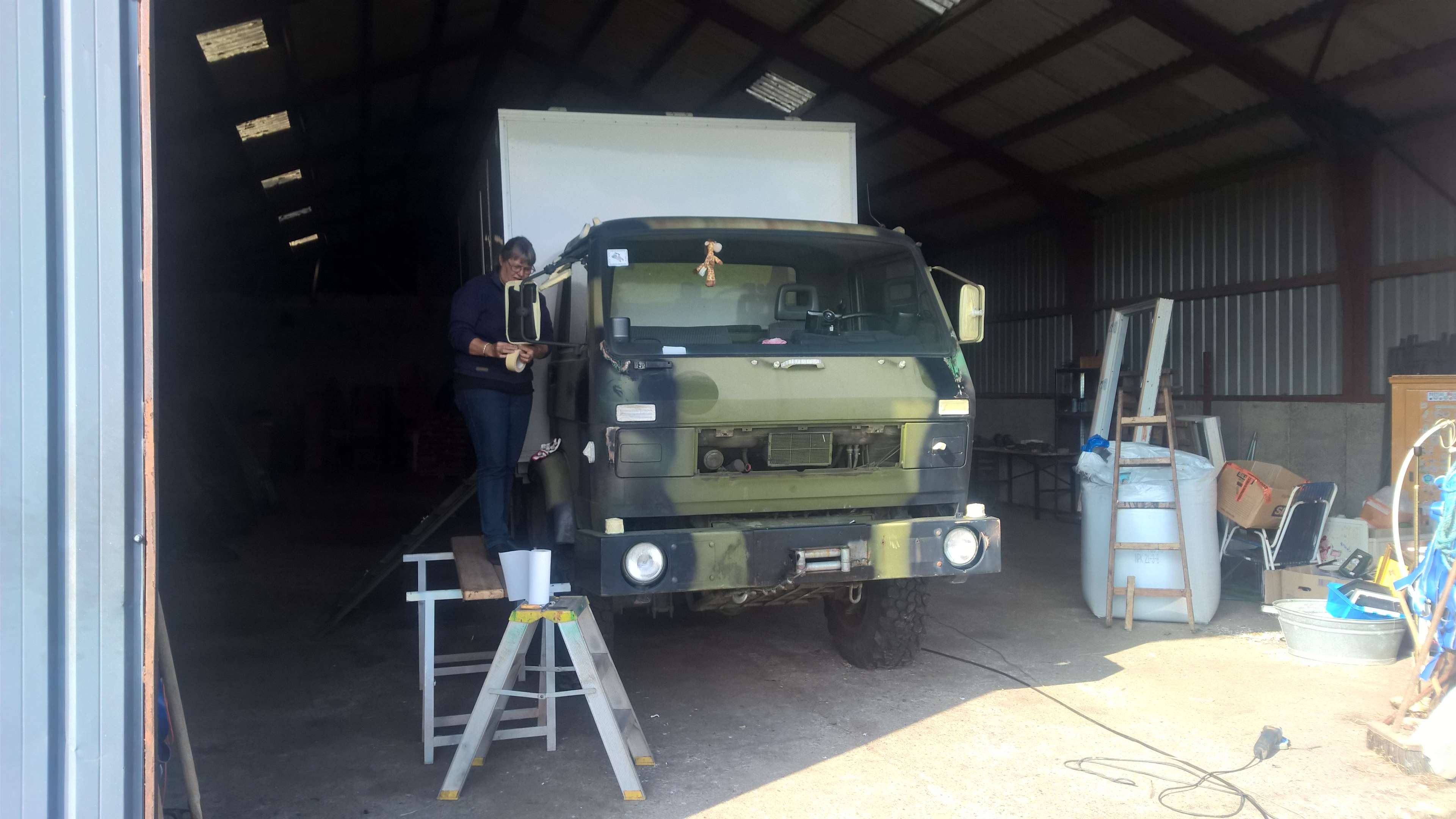

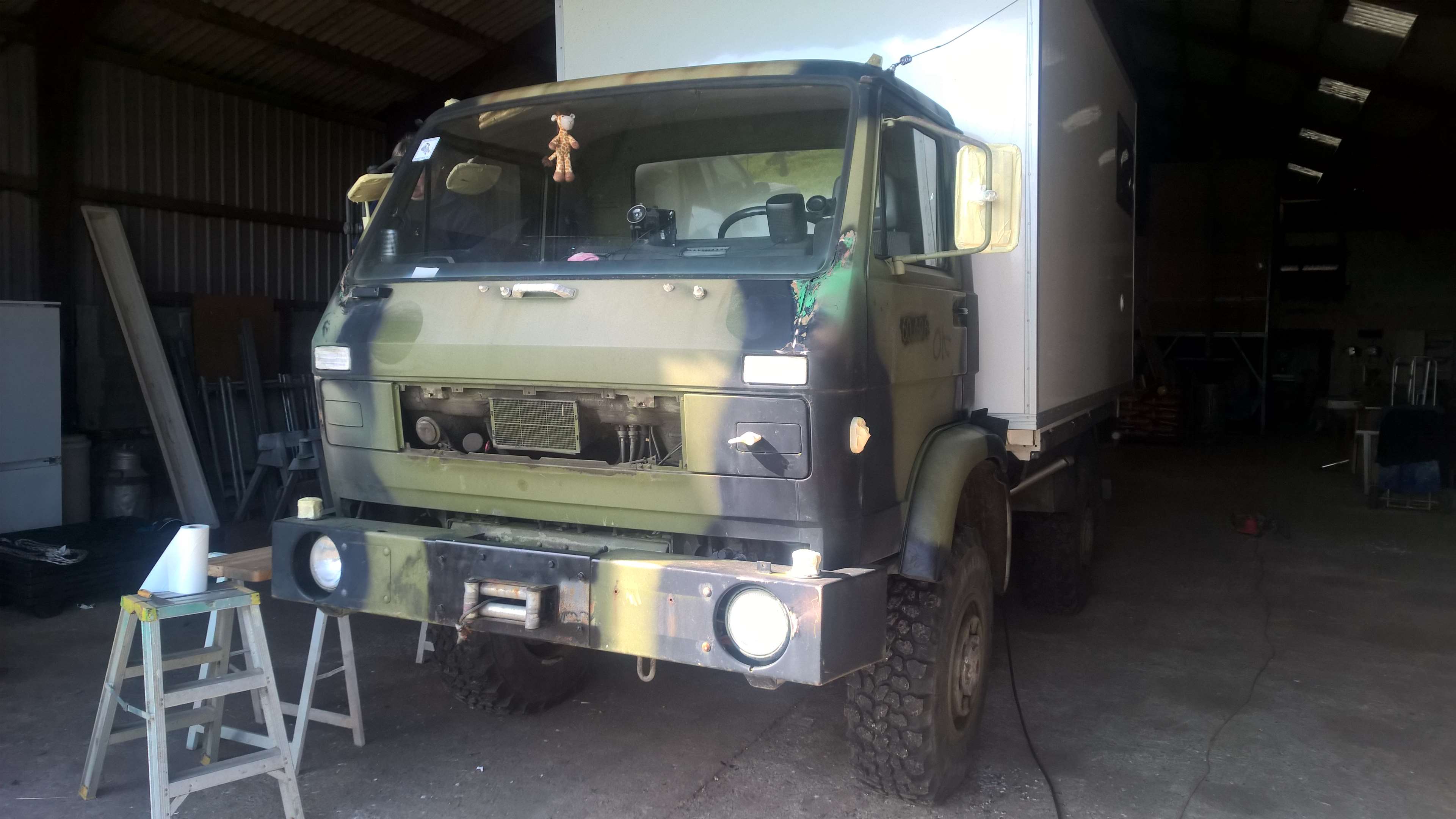

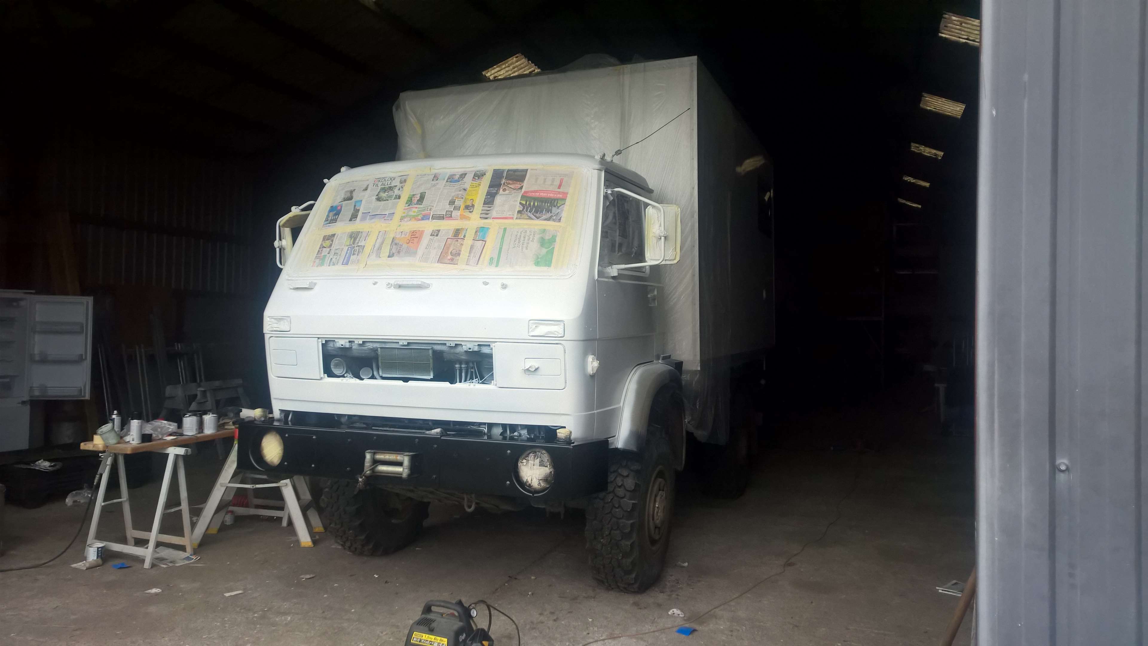

Nachdem wir viel Energie und Zeit gebaut haben und die Kiste zu bauen, ist es jetzt Zeit, am Auto zu arbeiten.
Deshalb wurde diese Wochenende verwendet, um es in einer etwas neutralen Farbe gemalt zu machen als das "armygreen".
Jetzt ist das Auto im fein weiß in der gleichen Farbe wie die Box.
Grüss Benny

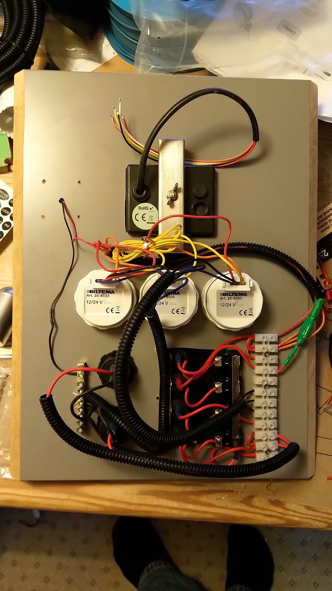

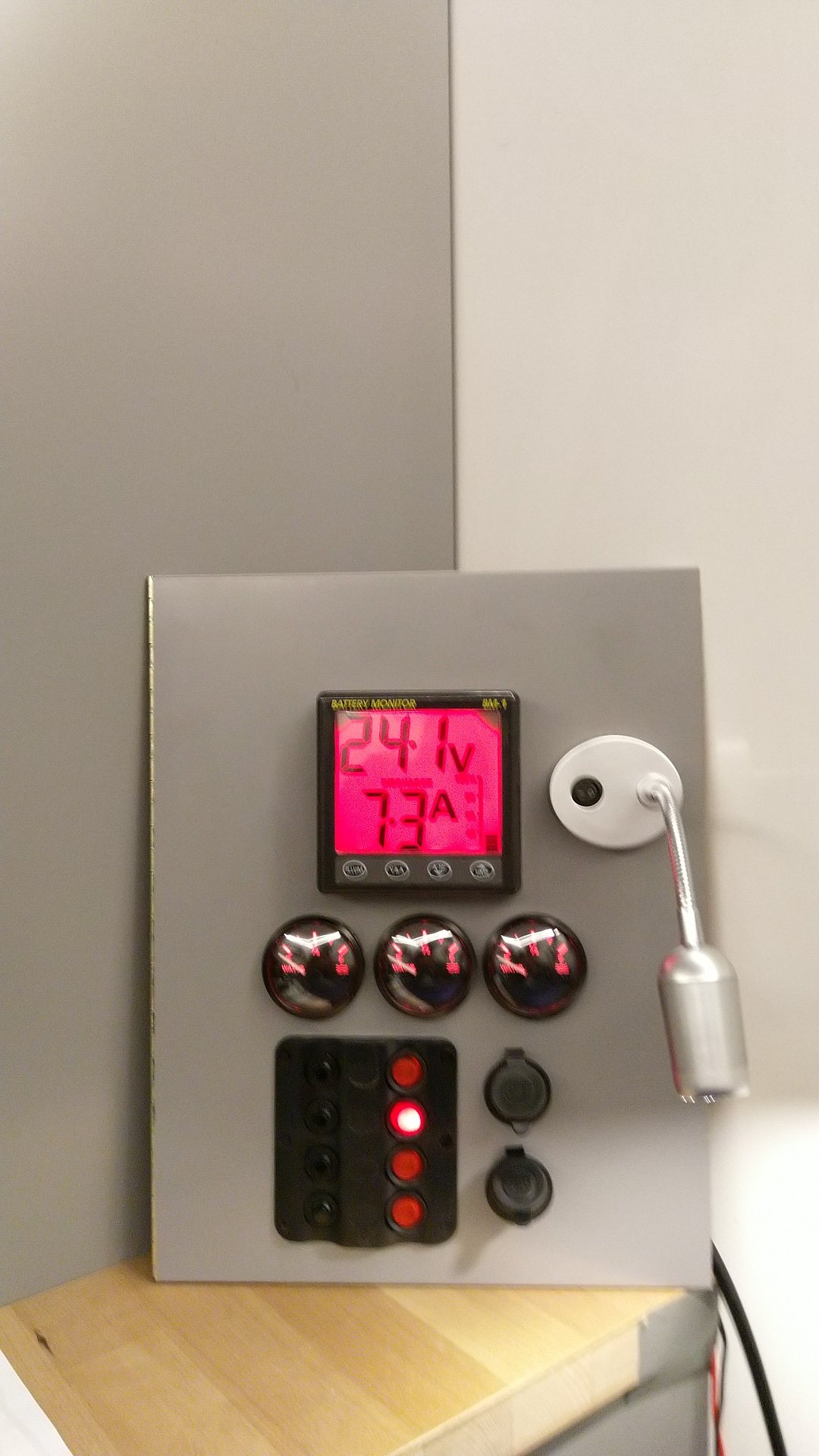

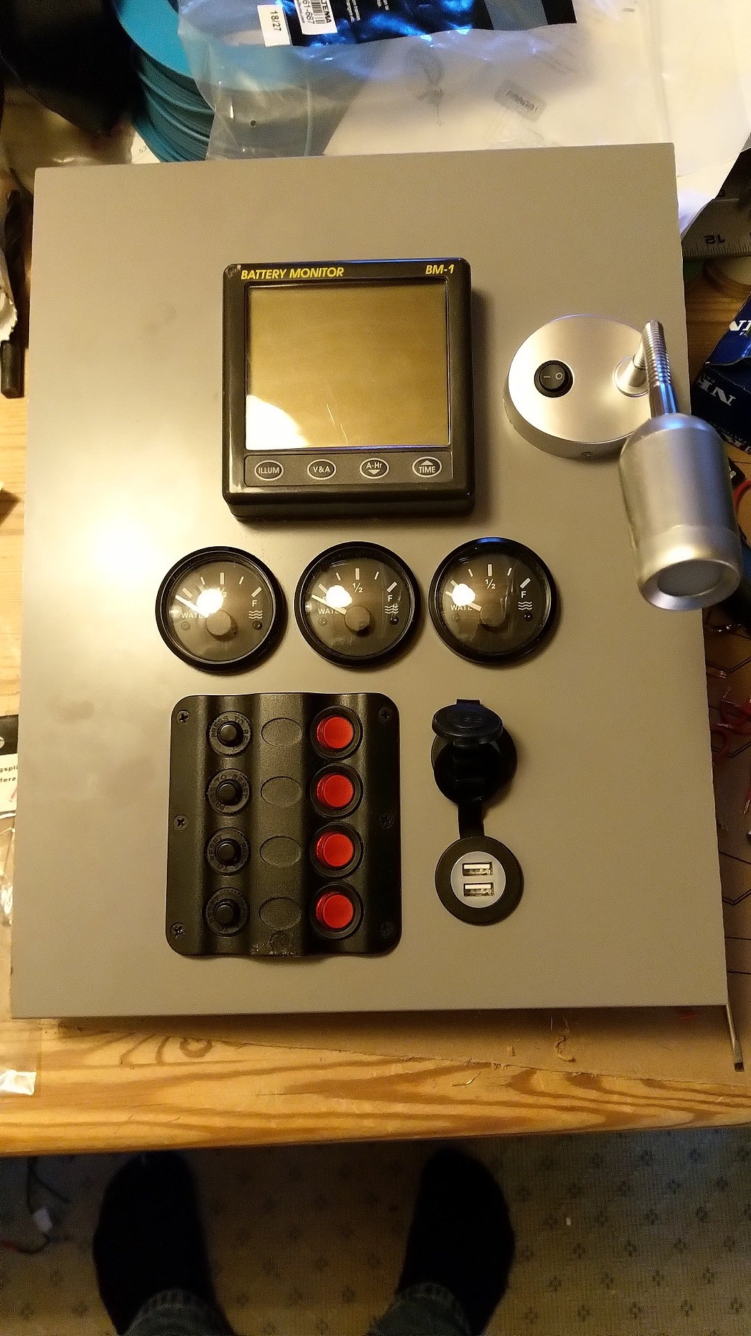

Nach einer längeren Pause, ist es wieder Zeit für ein bisschen Arbeit am unsere MAN.

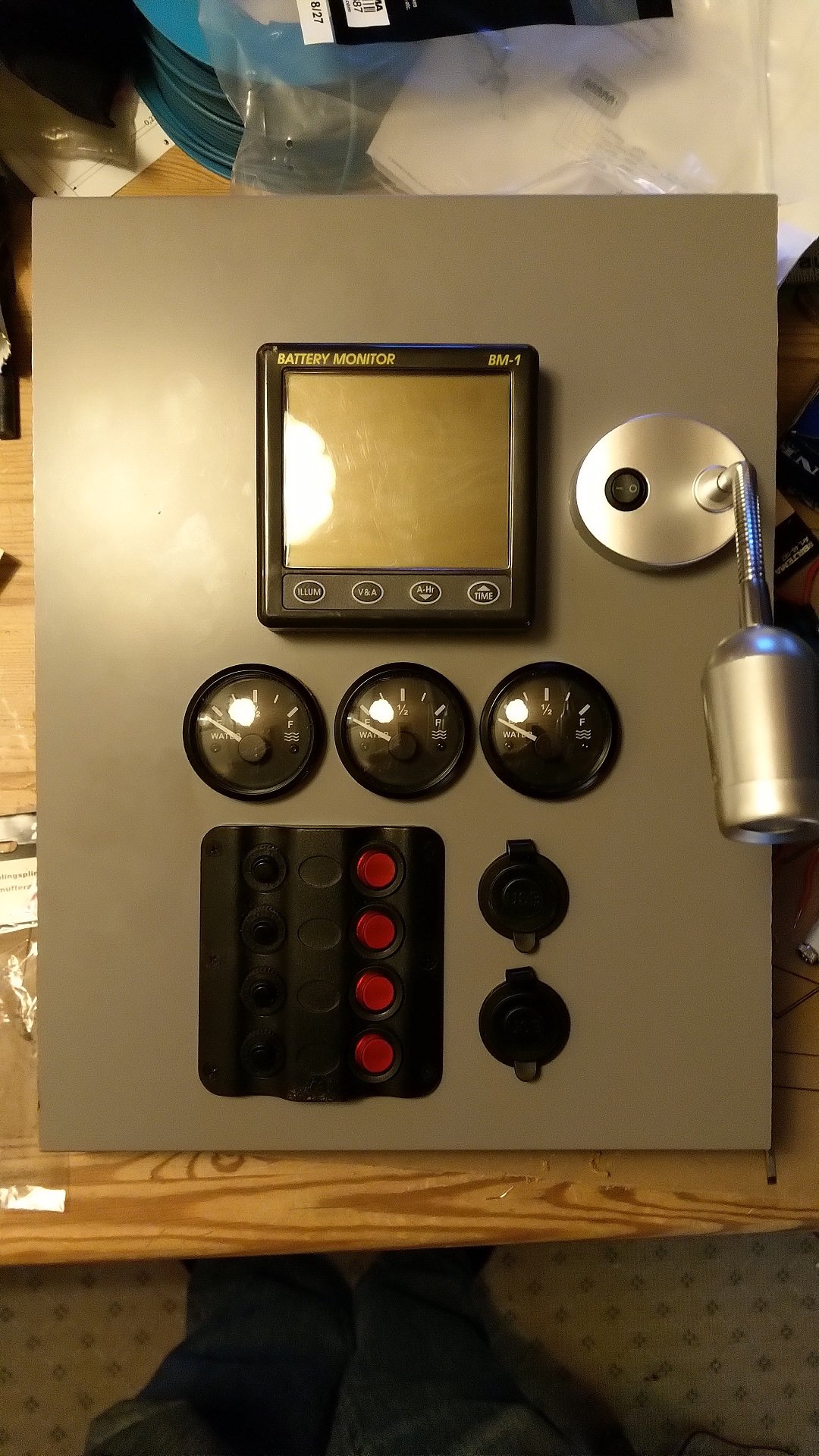

Jetzt geht es um eine vernünftige Strohm / Info Panel zu herstellen, das mindestens Information über Batterien, Wasser und grau Wasser geben.
Das Panel ist nun fertig und getestet. Next Ziel ist Niveau Sensoren in unsere 3 Wassertanken einzubauen.
Grüß, Benny
