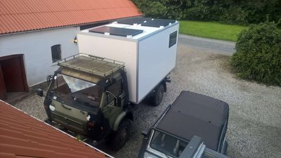

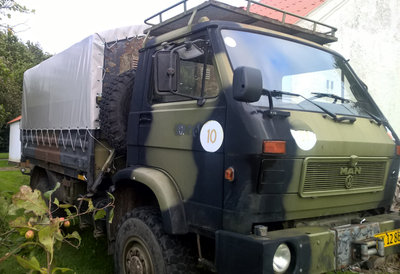

I have now started up planning and execution of my MAN 8.136 expedition project, and I would like to share my ideas and findings with you.
First off all, sorry for the language. I speak and read the German language pretty fair, but the written has always been a challenge for me. That is why I prefer to do the writing in English.
Before starting up the project, I have spent a lot of time reading all the interesting posts in this forum. It is incredible how mush knowledge there are shared between enthusiasts.
A small introduction of myself.
We live in the southern part of Denmark, about one hour from Germany. We have been driving Land Rover for the last 25 years as our daily driver and for off road fun, but also for more serious offroad racing. Along the years the racing is reduced to participation in the local Land Rover trial cup, and the wish for traveling has been rising. We have over the years been traveling a lot in the Icelandic highland, in Norway and in Sweden using roof tent, but now we want something with more comfort. That’s why we now have been starting this project.
The first decision to take was the choice of type, size and brand.
The type is chosen to be as an ordinary truck (LKW) because of the Danish tax regulations, this also means that the camper-box has to be transported as a load and it must be able unload the camper-box from the truck. A connection between the camper-box and the drivers cab, is also not possible.
The size is decided to be at max 7450 kg, because of the EU regulations of "Driving and rest time". For a private registered truck these roles it is only valid for trucks from 7500 kg and above.
The brand is chosen to be a MAN, because of the availability of MAN 8.136 used by the Danish army and now being sold out. This truck fits all our wishes: 4x4, 3 front seats, simple diesel engine without any electronic, right size (weight and size).
So now the truck has been bought and registered. It is a 1990 MAN 8.136 with 47000 km on the clock and decent Michelin tires. It is running great and is easy and quite fun to drive.
I have decided to build as much as possible by myself, and at the beginning this did also cover the camper-box. But finally we decided to buy an empty box. This is more expensive, but we think it will be a better long term solution. So now the hunt started for the right box to the right price.
I send out request for offer to a number of manufacturer being mentioned in this forum and some found by myself, and got answer back from some of them. We finally decided on a Danish manufacturer (http://www.fibercon.dk/) that was able to deliver an empty fiberglass box for a reasonable price, mounted with a door from Outbound in the Netherland. I will pick up the box at the end of this month, and the plan is to update this post with photo and information along the actual building process during the next couple of month.

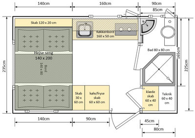

Planes for the box.
The box is manufactured with 50 mm fiberglass sandwich for walls and roof, and 40 mm fiberglass sandwich with 12 mm inside plywood as floor.
The box size is 4000x2350x2150 mm (LxWxH) and the empty weight will be app 450 kg. The box will be mounted on the original truck bed, using two large brackets. One in front of the bed, and one at the end of the bed.

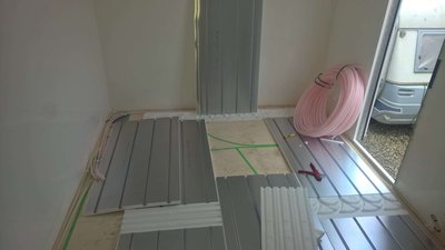

Heating will be done as floor heating (water) like in a house, using a Webasto Diesel water heater.

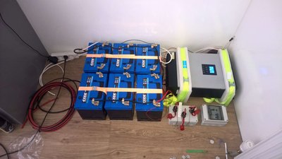

Main power will be 24V from 2x240 Ah batteries, charged by 600Wp solar cells. 230V will also be available from a 2000W inverter, mostly for the refrigerator.
I hope you like the project, and I will keep you updated when we are doing progress.
Please write your comments below.

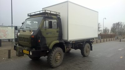

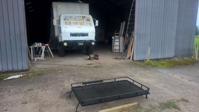

I will carry thy spare wheel on the roof rack, and build a small crane between the drivers cab and the box. The crane will be able rice, lower and swing the boom (manually), and lift using an electrical winch mounted below the bed like the original one for the spare wheel. When not in use, the crane will be lowered to roof height of the drivers cab.
Best regards, Benny
Best regards, Benny

I have doubts if it is a good idea to mount the spare wheel on the roof rack.
1. I don´t think, that the roof rack is made to carry a load exceeding 100kg. I would set the limit to 60 - 70 kg max (Only estimation. But that will limit the load on every foot of the roof rack to app. 15-20kg, the weight of a full 20l jerry can).
2. Such a heavy load mounted so high up woudn´t improve the behaviour of the vehicle in curves and off road.
What would you think of mounting a wheel rack on the front bumper? Enhaces the length of the vehicle a bit, but that seems to be the minor problem to me.
Nevertheless you should shift the construction of the crane a bit till some more ideas had been suggested.

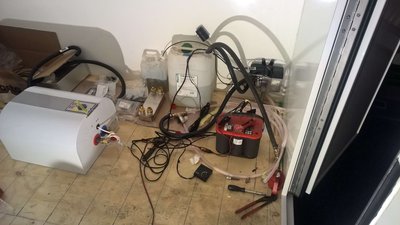

Re: Building new box for MAN 8.136
Thank you for your comments and input.

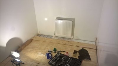

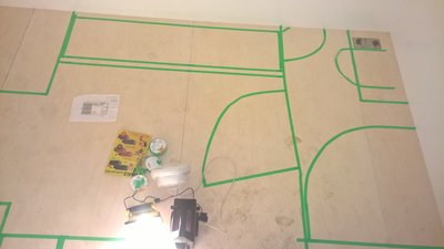

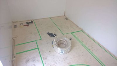

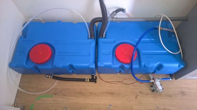

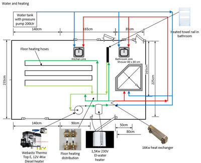

Some more details for our building project. This is how I expect to install water and heating.
The water will be with constant pressure using a pump and expansion tank for the purpose. This will give the possibility to use standard (and cheaper) pluming equipment. Cold water will be supplied to all taps, directly, and warm water will be supplied using a standard and cheap (160 Eur) heat exchanger, large enough to give constant hot water.
Heating can be given in two ways, off grid or connected to 230V.
When off grid, the heating is given from a Webasto Thermo Top E (4Kw) diesel heater. I have been in dialog with the distributor for Webasto and Eberspächer, asking for diesel burners able to be used continuously, and the recommendation was that Thermo Top is the only series that can be guaranteed for that purpose.
The Webasto will be installed with the possibility to run the water pump, without running the burner itself. Hot water from the pump, will continue to the El-water heater and use the 30Ltr as a heating buffer before entering the heat exchanger for hot water. After here the thermostats will control the heating and returning cold water to the Webasto.
When connected to 230V "land power", the electrical water heater can in most situations supply the needed heating. The circulation will be the same, but the Webasto water pump will be running without the burner is running.
When doing the pluming like this, using standard components, the only expensive part will be the Webasto.

Pretty comfortable. I have to admit, that this is much too comfortable for me.
. Can´t make any comments / suggestions with that.
But good luck with your project.

This made me think twice and I came to the conclusion, that water from jerry cans and a pressureless watersupply might be less comfortable, but much more durable and also cheaper in production, maintenance and repair.
If I want hotel like standards in my living quarters, I take a nice hotel.
But everybody is different - which is good!
Best regards

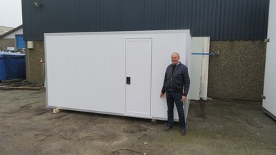

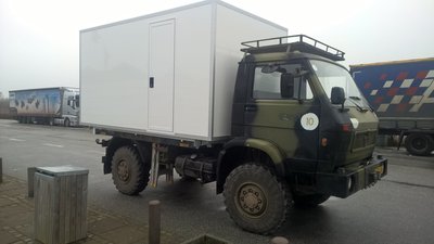

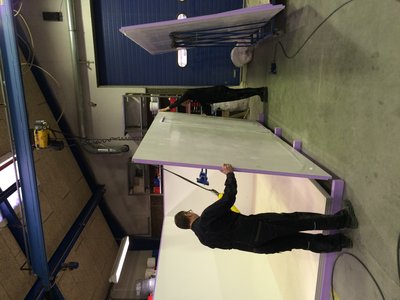

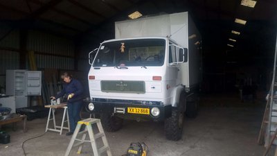

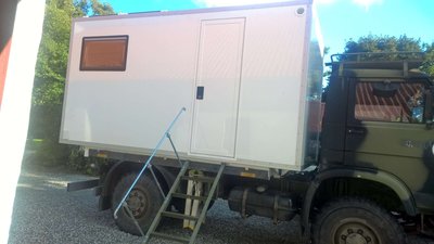

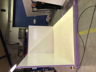

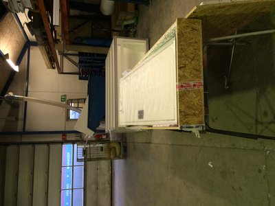

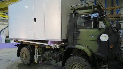

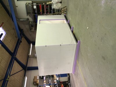

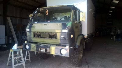

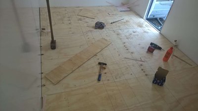

Now the new box is starting to take shape.
The panels are being assembled and the Outbound door are ready for mounting.
Soon we are ready to mount the new box to the car.
Best regards,
Benny
Best regards,
Benny

Pretty nice heating construction plan. I would add a water to air heat exchange (don't know the right word in English)
like this. The advantage is, to get a comfortable temprature within minutes and with air tubes behind or under the furniture you willget less problems with condensation and moisture. I think with your floor heating, which is really comfortable as well, it takes minimum 5-10 times longer to bring the cabin up to 20 degrees in winter. You can install the blower like a radiator and aktivate it with a thermostat or switch.
Post more pictures
we all like to see your progress.
regards

For your water system I've a question:
You are planing a 200 Liter Watertank, so I guess you have to take care for your waterquality.
Do you want to disinfect your tank ervery time or are you planing to install a waterfilter??
These filters have the property to reduce your volumeflow drasticaly when using a ordinary pump (for example Schurflo)
If you want to have a accetable volumeflow to have shower with filtered water. You have some options.
a) Use more the one filters parallel.
b) Use a pressure tank behind the filter. But then you have just the volume of the filter with a high flow.
c) take a high pressure pumpe with a reducing valve behind the filter.
d) adjust two water taps in each sink filtered and not. For the shower: Dont drink the shower water

Now the new box are ready, and we have to finalize bracket and other stuff needed to prepare the box to be mounted and demounted when needed. It has been a busy Saturday, and tomorrow new painting will be done the places that will be hidden by the box.
Monday I will pick up the new box, and the real fun can start up

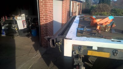

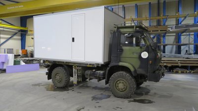

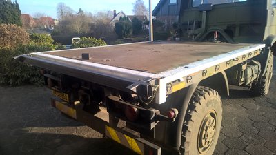

Today was the day to find out if the box actually does fit to the MAN.
I drove to the manufacturer (FiberCon) to review the box and get it mounted using the new brackets and fixings.
The box was real nice and exactly as we had agreed. All brackets and fixings worked as expected and we could mount the 8 large stainless bolts needed to mount the box. Everything fitted as expected and I was a very happy man. I think the size is just right for the MAN.

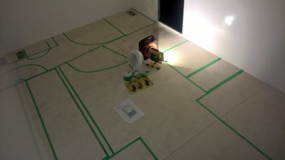

Bach home with the box, I tested how fast a 1000W electric heater could rise the temperature from 2 deg centigrade to 19 deg centigrade. 30 minutes was needed. Now I am sure that the 4KW Webasto will doo the job.

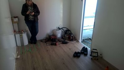

It is a fun process to go from thoughts and drawings, to the physical world.
With the box home at my own workshop, the truths about size and feeling of space can be tested. We have now marked up the floor with masking tape, to evaluate the layout. I don’t know if any other has tried to do the same before starting the actual build, but for us it definitely is showing much more than a drawing.
The next thing that will happen, is laydown of floor heating tubes and the new floor.
Any comment or input to our project are welcome.
Best regards
Benny

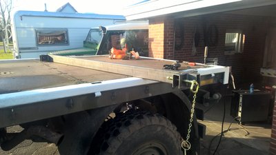

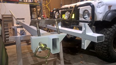

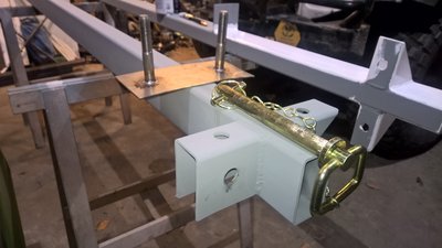

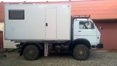

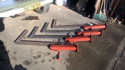

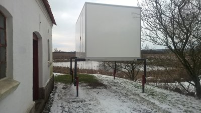

This weekend it was time for making the box able to "stand on its own feet's"
The box can now easily be de-mounted and mounted, and the MAN can be used as an ordinary truck when not carrying the box.
Each of the jacks can lift 1500 kg, so next step is to find a way of securing more stability for the stand alone box.

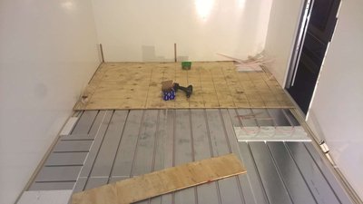

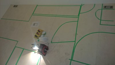

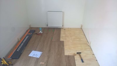

Now it was time to spend another day at the box building project for the MAN.
It was time to start up the working inside, and the first to do is preparation for electrical and heating installation.
I started preparing the electrical installations, by fitting empty flexible pipes that later on can be used to guide the needed electrical wires. The flex pipes is mounted all the way round the edges, with more pipes where I expect to need more wires. The tubes for cold, warm and waste water was also mounted.

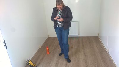

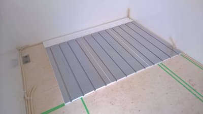

When I did the drawing for the box, I already planned for floor heating. The floor heating is done by using a 24 mm system prepared for 16 mm heating tube. The system secure equal heat distribution by pre formed aluminum profiles in the Styrofoam.
It was a little fiddly to ensure that the floor heating ended up only for the visible floor, and not below kitchen, fridge or water tanks. But when the heating tube is fixed in the aluminum profiles, it is actually ok.
On top of the 24 mm Styrofoam, I mount 12 mm plywood. The plywood is simply mounted into the original floor of the box, ensuring not being too close to any of the heating tubes. I used a marker to illustrate the position of all tubes below the plywood floor.
Before I can continue with the floor, I now have to mount the heating system. When the heating system is mounted and functional, the floor can be heated and the moisture can be removed. Then the final vinyl floor can be mounted.
If you have any comments or ideas, please do not hesitate.
Best Regards.
Benny
To be continued
Best Regards.
Benny
To be continued
The heating and floor are now finished.
The Webasto Thermo Top is running smoothly and heat distribution in the floor is as expected. The floor heating is only mounted in "walk" areas.
We have chosen to mount a radiator in circulation with the floor heating. The thermostat for the radiator is this way also controlling the floor heating.
The outside temperature is at the moment between 0 and 5 °C and with an constant inside temperature in the box at 23 °C, the consumption is 1,5 liter of diesel per day. Way below what is needed in our Fendt caravan.

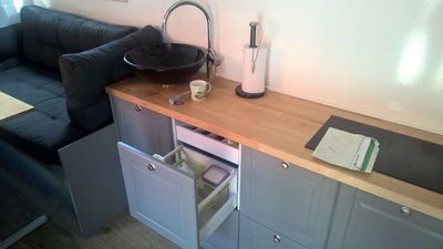

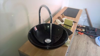

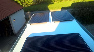

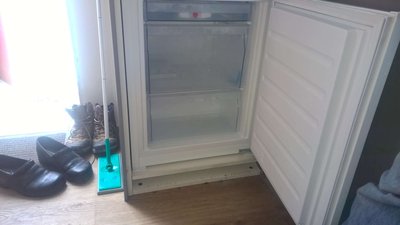

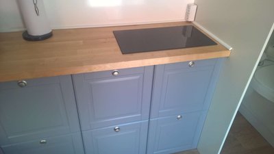

It has been some time since the last update, but the building is slowly stating to take shape.
- Most of the furniture is ready to be mounted permanently.
- The heating is finalized
- Water tank for fresh and waste water is finished
- Drain to waste water tank is finished
- Cold/hot water is running
- Battery bank and inverter is running, inclusive "land-power"
- Solar panels is mounted, but not yet connected
Next steps:
Connect all electrical 230V installations and power outlets
Connect solar panels to controller/inverter
Permanently mount furniture, freezer and refrigerator
Build frames for sitting area with lid for storage
Mount two Seitz S-4 windows
Mount frame for door to empty toilet cassette
Mount thetford C4020 toilet
Mount shower base, shower and drain pump
Build wall for toilet room
Mount sink in toilet room
Next steps:

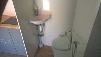

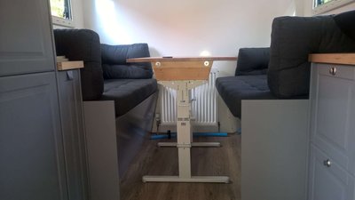

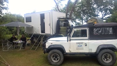

Das Bauprojekt der neuen Box für unsere MAN 8.16 ist nun knapp am Ziel.
Wir haben die Box schon eine Woche im Sommerurlaub getestet, wo wir zum jährlichen Offroad-Treffen im Danish Land Rover Club Teilnehmer war.
Ich habe mich dafür entschieden, diesen Beitrag auf Deutsch zu machen, weil ich gerne ein paar Kommentare zum Projekt hätte. Also habe ihr irgendwelche Kommentare oder Fragen, fühlen Sie sich frei zu fragen.
Die Box hat jetzt folgende Ausstattung:
Die Kiste:
Dach und Wände in 50 mm Glasfaser-Sandwich
Tür von Outbound
Boden in 30 mm extra starkem und hitzebeständigem Glasfaser-Sandwich + 12 mm Sperrholz + 20 mm Styropor mit Fußbodenheizung + 12 mm Sperrholz + 3 mm Vinylbodenbelag
2 x Seitz S4 Fenster
4 x externe Stützbeine zum Heben der Schachtel an und aus dem Auto
Heizung:
Webasto Diesel für Wasser
Durchlauferhitzer für Warmwasser
Fußbodenheizung und einem Heizkörper
Elektrisch:
3 x 300Wh Sonnenkollektoren
2400 W Wechselrichter für 230V
Möglichkeit für "Landstrohm"
6 x 80Ah Exide marine Batterien
Stufenlos LED-Licht mit Fernbedienung
Mehrere 230V Steckdosen
Wasser:
140L Wasser
70L graues Wasser
Konstant Druck (2 BAR) Wasserpumpe (24V)
Wärmetauscher für warmes Wasser
Vorrichtungen:
IKEA Möbel
IKEA Kühlschrank / Gefrierfach
IKEA Induktionsherd
Thretford Kassetten-WC
Warmes und kaltes Wasser in Küche, WC und Dusche
Alles scheint wie erwartet zu sein. Wir sind sehr zufrieden mit dem Bild und freuen uns darauf, für etwas anderes Zeit zu haben, als die Box zu bauen

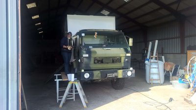

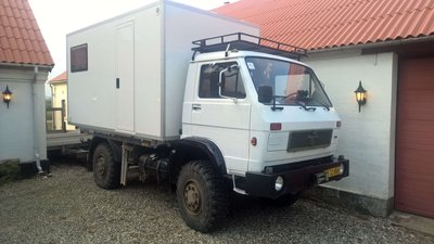

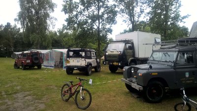

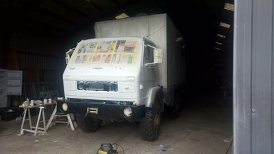

Nachdem wir viel Energie und Zeit gebaut haben und die Kiste zu bauen, ist es jetzt Zeit, am Auto zu arbeiten.
Deshalb wurde diese Wochenende verwendet, um es in einer etwas neutralen Farbe gemalt zu machen als das "armygreen".
Jetzt ist das Auto im fein weiß in der gleichen Farbe wie die Box.
Grüss Benny
Grüss Benny

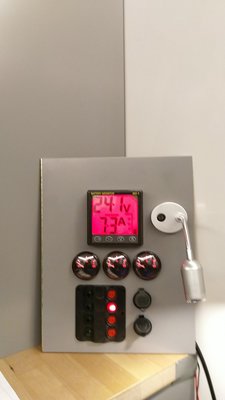

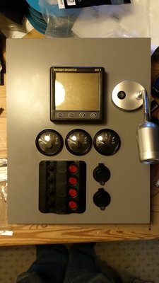

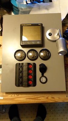

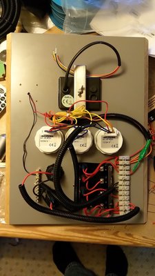

Nach einer längeren Pause, ist es wieder Zeit für ein bisschen Arbeit am unsere MAN.
Jetzt geht es um eine vernünftige Strohm / Info Panel zu herstellen, das mindestens Information über Batterien, Wasser und grau Wasser geben.
Das Panel ist nun fertig und getestet. Next Ziel ist Niveau Sensoren in unsere 3 Wassertanken einzubauen.
Grüß, Benny
Grüß, Benny

@Wasserversorgung
Normaler weise verbrauchen wir nicht vieles Wasser. Unsere Erfahrung nach, brauchen wir in Durchschnitt 10 Liter pro tag pro Person. Unsere 140 Liter sind für eine Woche für uns geeignet. Das geht prima so lange als wir innerhalb von Europa reisen.
Als wir das Layout für das Projekt planten, war eines der Ziele, dass die Box abnehmbar sein sollte und dass sie ohne Stehen auf dem Auto verwendet werden kann. Daher sollte sich alles in der Box befinden, damit es auch bei starkem Frost eingesetzt werden kann.
Wir hätten gerne Platz für mehr Wasser, aber dann wird es in einem zusätzlichen Tank außerhalb der Box sein, der nur bei warmes Wetter verwendet werden kann.
Und ja - den Sonnenuntergang an einem breiten weißen Sandstrand an der dänischen Westküste zu genießen, ist eines der großen Erlebnisse
Gruß Benny
Gruß Benny
