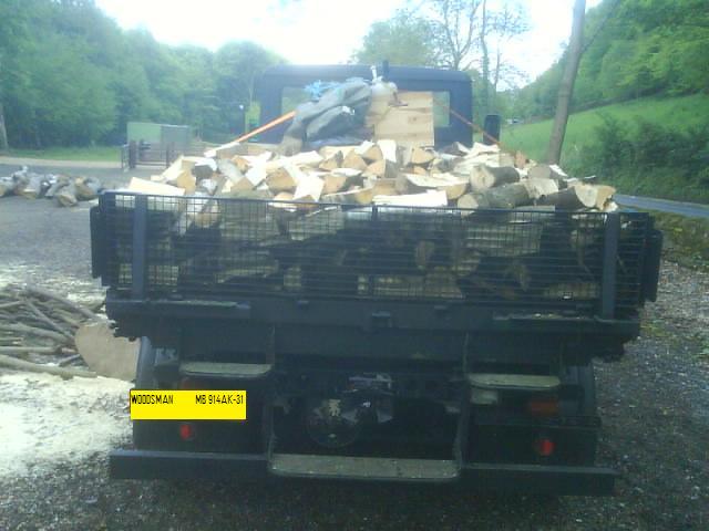

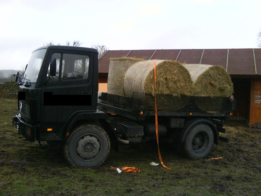

#41 Beitrag von WOODSMAN » 2011-05-14 16:18:08
Well if you have a vehicle with a demountable ISO twist lock chassis like mine then it can be used for both work and leisure within weight limits.
Zuletzt geändert von WOODSMAN am 2011-05-14 16:29:52, insgesamt 2-mal geändert.
