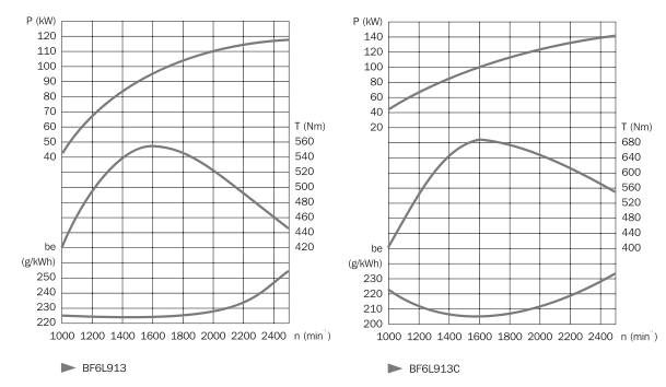

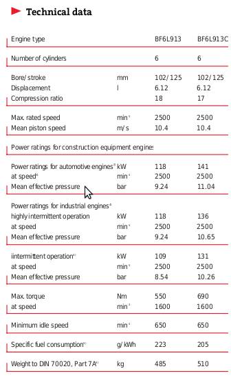

I have a question to ask, regarding the engine power. Has anyone modified this engine with an inter cooler (as BF6L913C (C = Charge air cooler)), or boosted the power up (rated 124kw as is) by other means?
And does anyone have data on how much this would increase power and where to get a inter-cooler kit.

Many thanks Uwe.
I actually located the Inter-cooler (charge air cooler)
[/img]
from the BF6L913C price 537US$ so I'm waiting for parts catalog and Deutz BL/ FL 911 FL 912/W, 913 Motor Werkstatthandbuch that I found on:
http://www.fachliteraturversand.de
So I can see what else I need for installation. and if it will fisically fit on top of the engine with out taking too much space. I know I will have to increase output from the injector pump, and probably change the injectors. And likely also the turbine. And finally the cylinders seem to be about 2mm shorter for the Inter cooler version. Making compression ratio 17 instead of 18.
So on the long run, you are probably right. its just too much trouble. So I will just crank up the volume of the kraftstoff.
