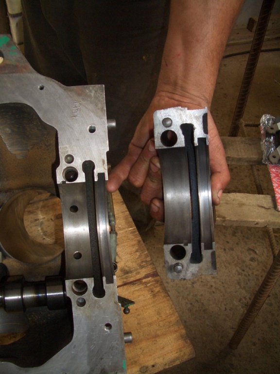

hello thanks for the fast reply.
when we take the oil filler cap off there is a blow back coming out, we presume this is compression from worn piston rings.
we have taken the engine out and the clutch plate is very worn, and the crankshaft bearings are also worn, we think this was from lack of oil changes as well,

for the normal or abnormal wear of the piston rings, everything has been written above.
As far as I know, the reverse thread on the crankshaft is already there on the OM352 engine? If not, you might have a very old engine that is not yet fitted with that feature. Anyway, this is a well known technique and nothing special, but don't expect a wonder in case of reduced oil leaking. Even with that thread, there is always some oil leaking through the seal. It is the principle of that kind of seal, to be wet by oil and thus let some small amount of oil pass through. The wetter the seal is, the better it holds back the big amounts of oil ...
For the oil rings of the axles and transfer box, it is impossible to find out the correct part numbers if we don't even know the type, VIN and year of construction of your truck. ***sigh***

Hello David,
You should definitly do a leakdown test. After pressurizing the combustion chamber with the piston at TDC and valves closed. If you have blow by into the crank case your compression rings are not sealing. If you hear air escaping in to the intake or exhaust it will be a valve problem.
Good luck Swen

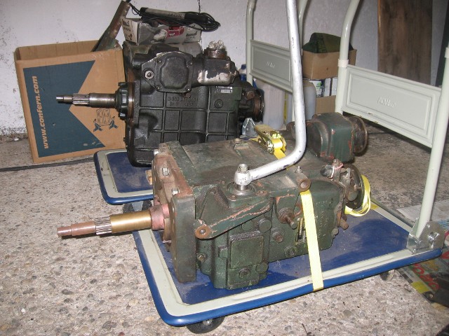

the gearbox should have ATF or gear oil in it. the mechanic says gear oil so we are not so sure have tried to upload a picture of the new groove for the crankshaft seal
cheers david

Hi David!nessie hat geschrieben:the gearbox should have ATF or gear oil in it. the mechanic says gear oil so we are not so sure
Is what I quoted above a question? I think so ...
In case of the gearbox, there are many possibilities, which type of gearbox you have. Depending on that, the oil to use varies ...
Most likely you will have a Mercedes-Benz G32 gearbox (new designation of that is G3/36-5/8,98). For the year of construction of your truck, this will need to be filled with ATF Type A Suffix A. Don't use gear oil, because this might in the long run (I think it will take years) destroy your synchromesh mechanism! There are a few (2 or 3) gear oils that are compatible with the materials used in the old synchromesh parts, but even here in Europe they are hard to find. So, better you use ATF as Mercedes-Benz says in the handbook.
All the time we are talking about the gearbox, not the transfer box. Right? Because the transfer box is quite another thing in case of gear oil. It needs hypoid gear oil, the same as in the axles.
P.S.: Here is a photo of some (not all) types of gearboxes used in the 911 truck. The G32 is the one in the background. Easy to recognize, I think. Watch out for the square ribs on the lower part of the housing.
Zuletzt geändert von Pirx am 2010-03-22 17:56:06, insgesamt 2-mal geändert.

Many thanks for you quick reply.
Our mechanic has told us that all the MB trucks over here use gearoil- John Deere HY-GARD transmission and hydrolic oil- because this is better for the high temperatures here. Could this be the gear oil that is hard to find in Europe? (Our gearbox is the G32 type.)
The engine starts to go back in within the hour - so wish us luck!

Hi David,
I don't know the John Deere HY-GARD gear oil. It is definitely not one of the mentioned oils.
I couldn't find out anything about this oil until now (and I can't spend much time for that) except that it is a so called UTTO oil. This is a special kind of oil for agricultural tractors that can be used for the engine, the gearbox (very special in agricultural tractors), the axles and for hydraulic purposes.
In the past, we had discussions about the use of such an oil in our trucks, but I think nobody dared to try out.

thanks for the information you have been great help to us!
All we can find out is that the UTTO oil can become thin with age, but we will be servicing and doing oil changes regularly, so it shouldn't be a problem for us.
Let us be the 'test' vehicle for this oil and we will let all allrad readers know what happens........
