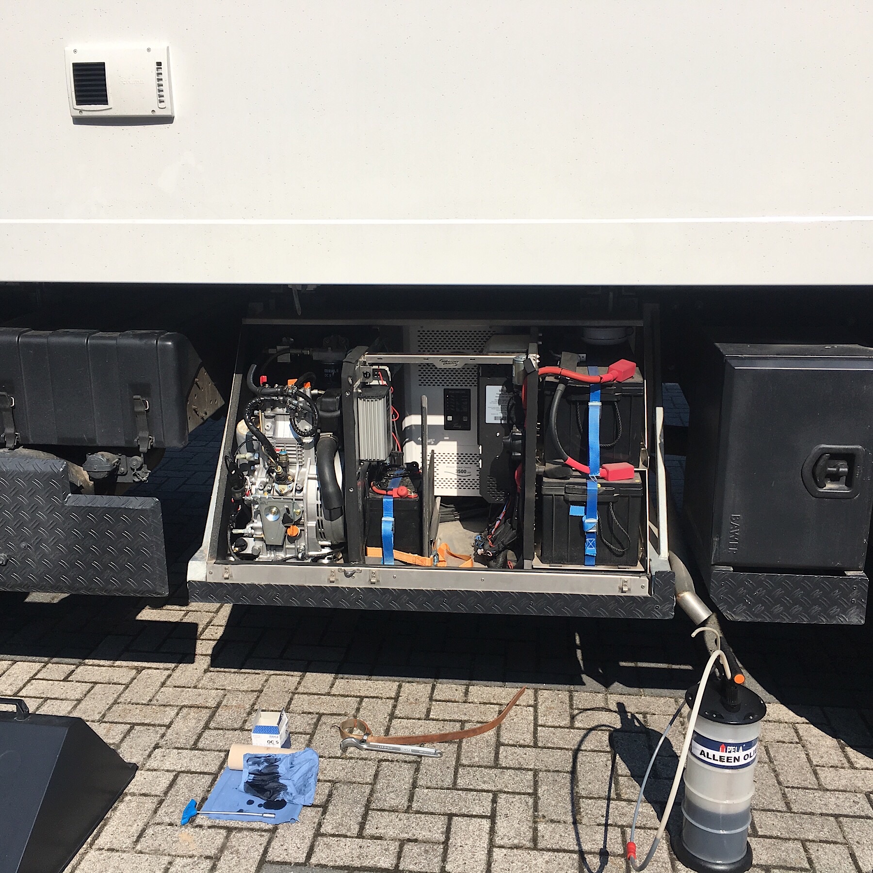

#14 Beitrag von Seapilot » 2019-03-15 17:46:57
Hier das Problemkind mit der alten Abdeckung die hier für Wartungsarbeiten abgenommen wurde

Seapilot
Beiträge: 1729
Re: Berechnung Überdruck
#17 Beitrag von Seapilot » 2019-03-15 20:41:33
Sebastian da hast Du sicher recht. Lüfter für Überdruck haben die Holländer geplant.
Hier mal das was sie vorgesehen haben
Below the work to be carried out by Recrea Service, on the account of WhisperPower
Changing the cooling set up and closing the holes in the bottom part of the enclosure / All-In-One compartment:
• Removing the fan and oil cooler from the compartment, closing the open space with a stainless steel metak sheet.
• Closing the ventilation hole underneath the batteries with stainless sheet metal
• Re-positioning the oil cooler and the fan in the middle of the chassis of the Iveco, as high as possible, in a 45º angle, so dissipation heat can go out
• The side of the covers will be provided with an angel profile and a rubber edge profile that can be compressed.
• Replacing the locks of the covers with a stronger version.
• Closing as much wholes as possible (rivets, cable entries, etc.)
• Mounting a fan for cooling the electronics when used, and creating an over-pressure when going through the water.
