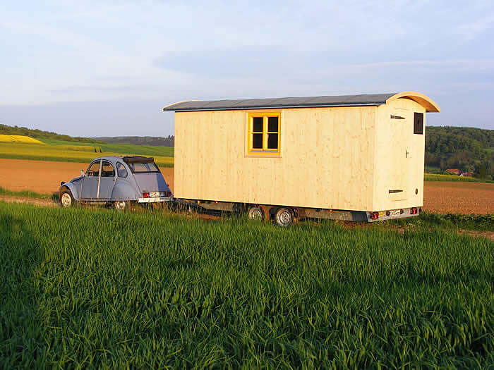

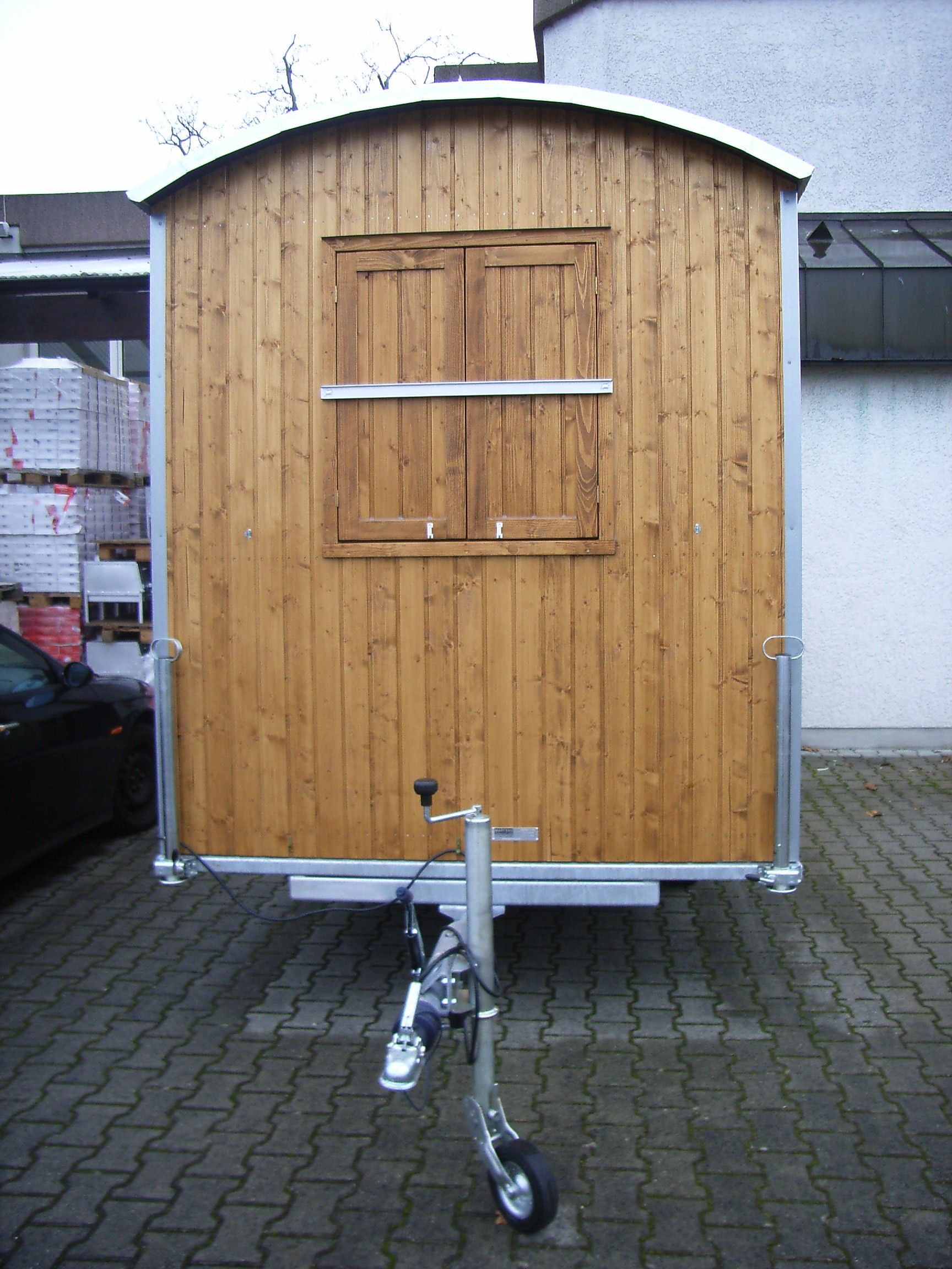

One of these? But without the chassis and wheels.

WOODSMAN hat geschrieben:One of these?
Documents from Andrea's PC 005.jpg [ 73.52 KiB | 104-mal betrachtet ]
I would be interested in this particular combination. :cool: Of course the towing duck legalized with this trailer :rock:
