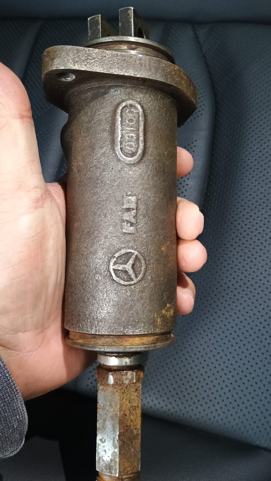

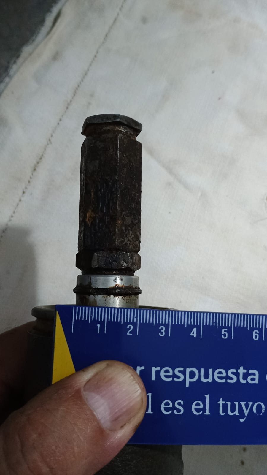

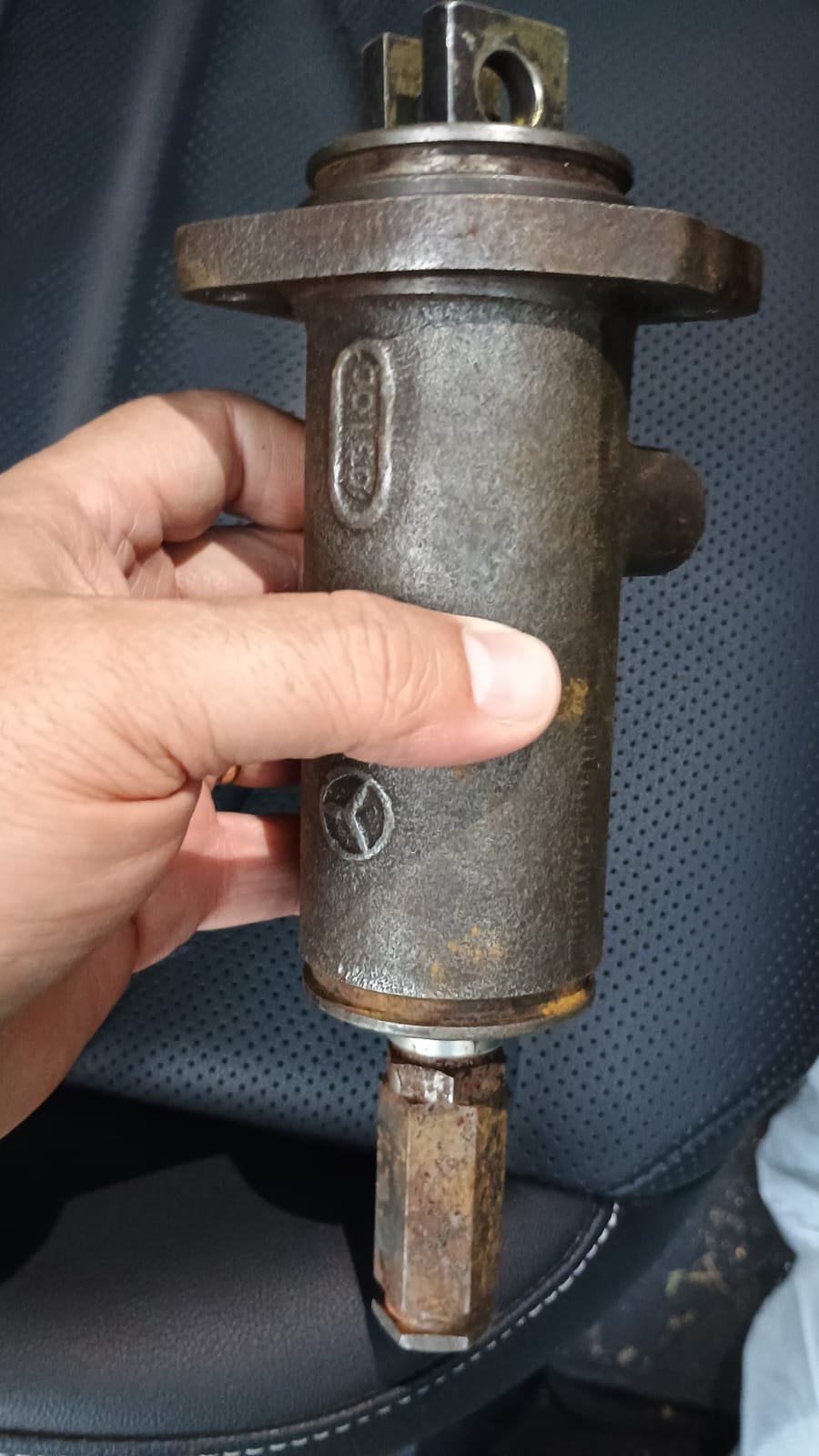

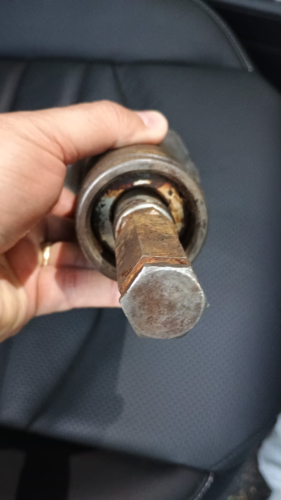

Hello everyone,
I am restoring a 1981 Mercedes-Benz NG 1932A 4x4 in Argentina.
Model: 389.125
VIN: WDB38912514810175
I need to replace the original clutch slave cylinder.
According to the Diesel Technic catalogue, DT 4.60684 should fit my truck.
However, my original cylinder looks completely different.

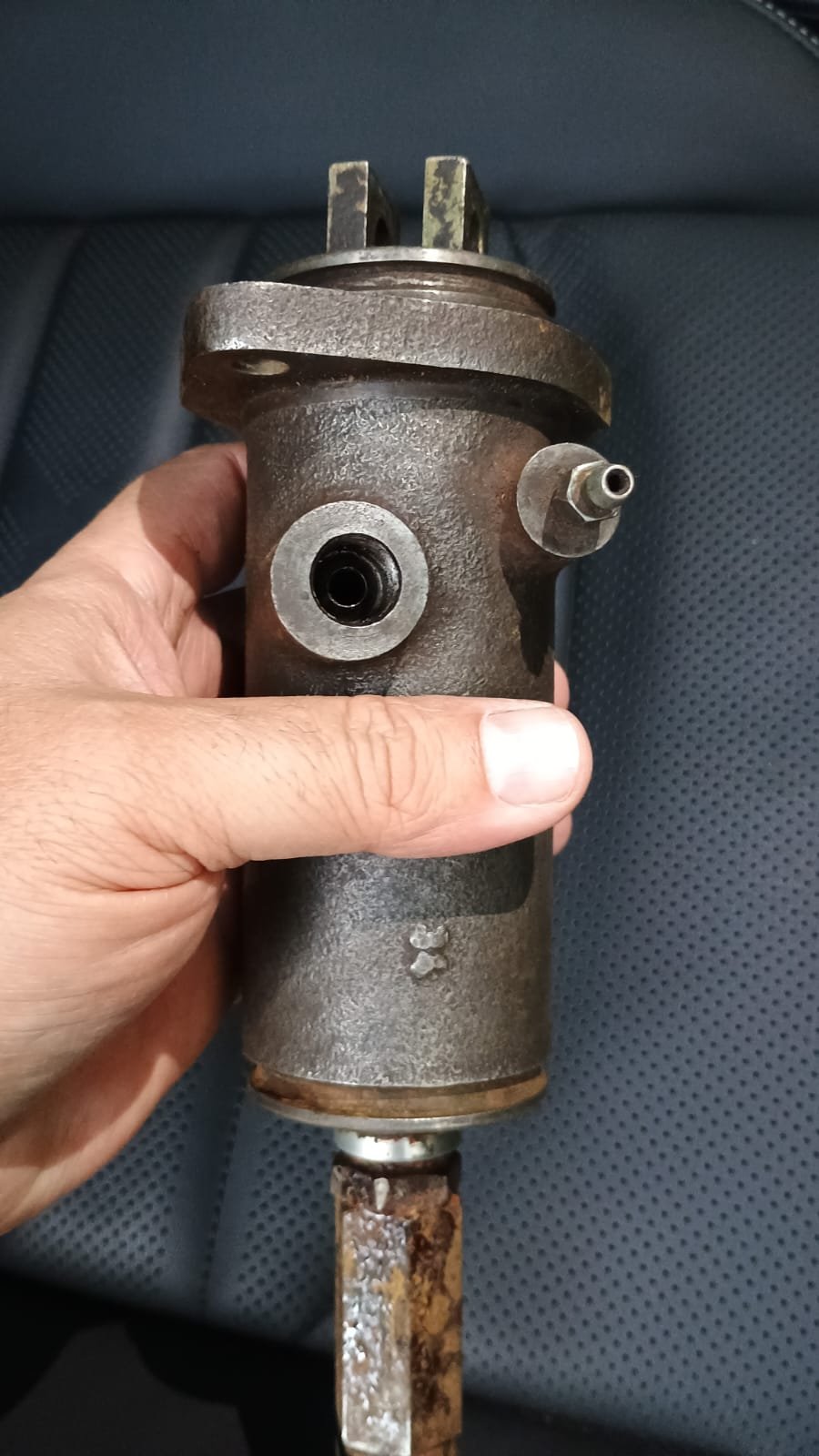

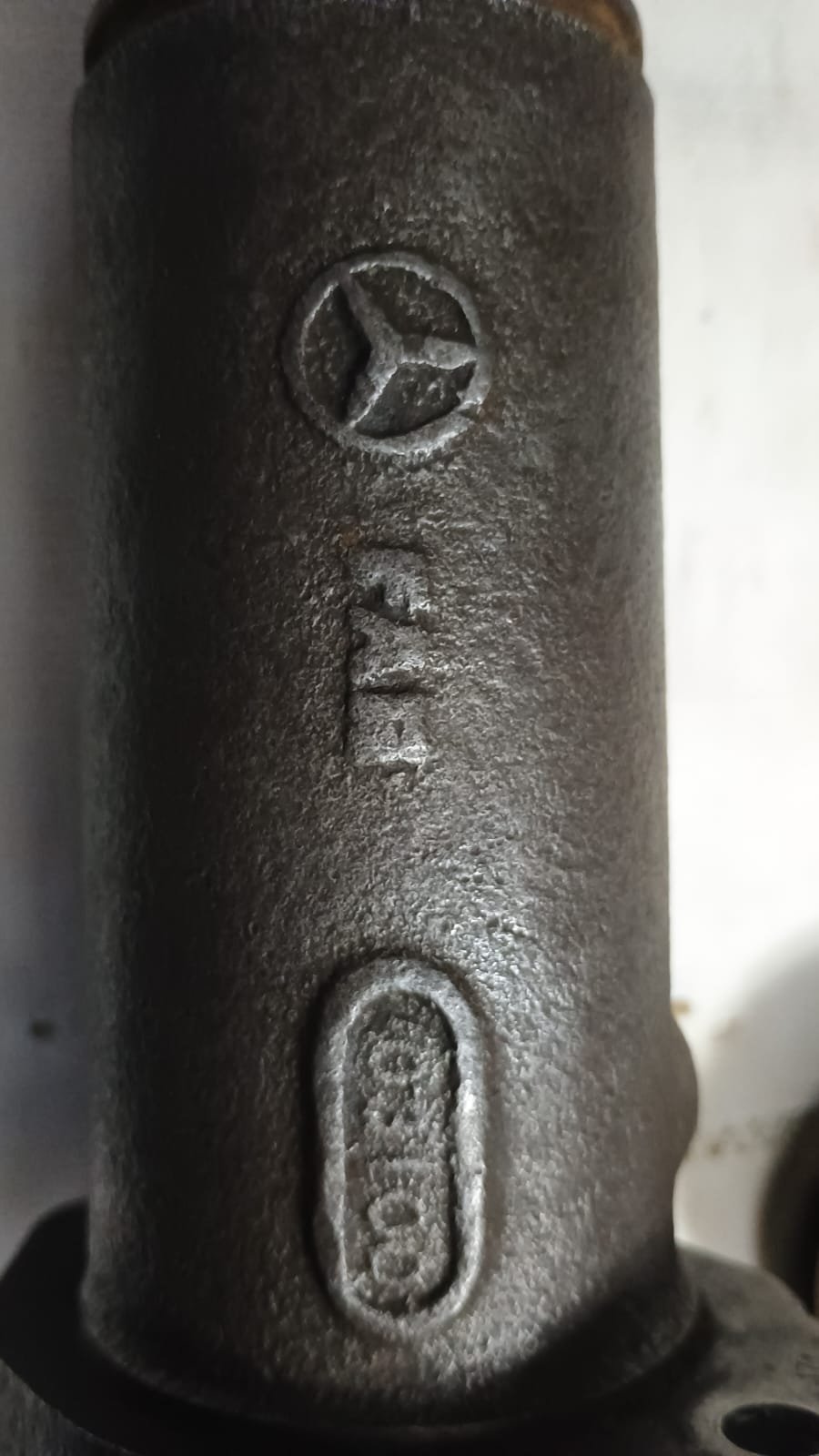

The original unit is marked with the Mercedes-Benz star and FTE, but unfortunately there is no visible part number anywhere.
I have attached detailed pictures of the original cylinder, the mounting, the pushrod, the flange and all visible cast markings.
Has anyone seen this version before?
Does anyone know the original Mercedes-Benz part number?
Is there perhaps an early and a late version for the NG series?
Any information would be greatly appreciated.
Thank you very much!
Marcos
Argentina

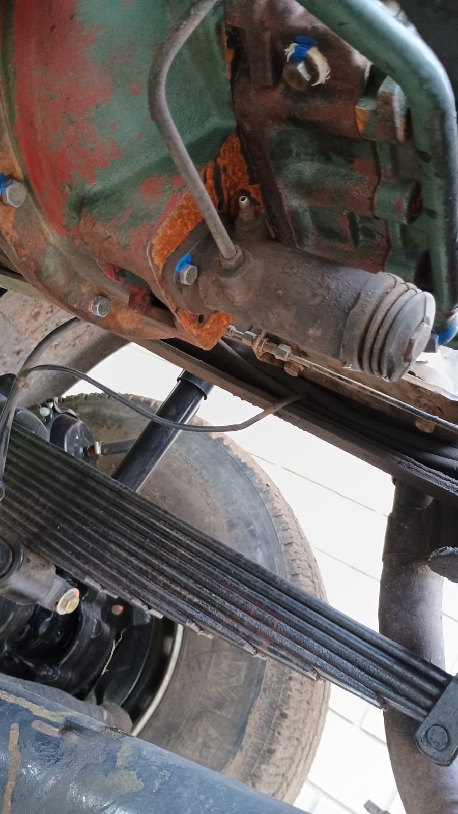

Original slave cylinder installed on the gearbox.
Overall view after removal.
Front view showing the mounting flange and pushrod.
Mercedes-Benz and FTE cast markings.
Additional casting marks ("311").
Hydraulic inlet and bleeder.
Pushrod and clutch fork detail.

Hello Marcos!
As your truck is equipped with a PTO, according to your VIN, it does not have the standard slave cylinder, but a special version.
The part number for this cylinder should be A 001 295 08 07.
Suerte!

I understand it's a rare part, but the prices seem a bit high to me for a slave cylinder. It might be better for me to repair the pushrod and the cylinder (they look pitted) and just replace the seals and O-rings. Knowing the part number for the repair kit is extremely helpful.

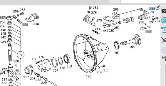

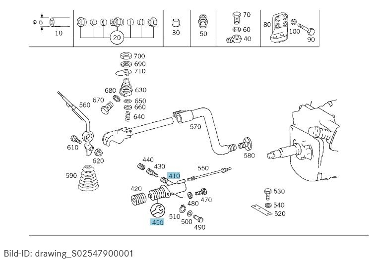

Meanwhile, my local Mercedes-Benz Truck dealer is checking the part number. Their EPC suggests A 001 295 88 07 instead of A 001 295 08 07.
They also sent me this exploded view:
exploded view.jpeg (38.04 KiB) 1910 mal betrachtet
The slave cylinder shown there looks completely different from the original FTE cylinder installed on my truck.
Since my truck is equipped with a PTO, could this perhaps be the standard version instead of the PTO version?
I'll report back once I have an answer from Mercedes-Benz Argentina.
Thanks again to all of you for your great help!

#10 Beitrag von Pirx » 2026-07-21 9:22:38
Hello Marcos!
This seems to be a failure in the current spare parts system (XENTRY parts information). It only shows the standard clutch cylinder for your VIN.
By using the old spare parts system (EPC), the PTO clutch cylinder appears on the screen for your VIN!
The correct exploded view looks like this:
The correct part numbers are:
A 000 295 91 07 clutch slave cylinder = FAG KN 4402 A1
replaced by
A 001 295 08 07 clutch slave cylinder = FAG KN 4402 B1
replaced by
A 001 295 60 07 clutch slave cylinder = FAG KN 4402 C1
A 000 586 50 29 repair kit to clutch cylinder A 000 295 91 07
A 000 586 55 29 repair kit to clutch cylinder A 001 295 08 07

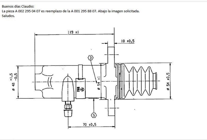

They checked the current system and sent me the attached dimensional drawing for the cylinder they believe is correct for my VIN (002 295 04 07). At first glance, however, it does not seem to match the original FTE cylinder installed on my truck.
Before ordering any parts, I will compare the dimensions of my original cylinder with this drawing. That should confirm whether it is really the correct replacement or whether I should continue looking for the PTO cylinder (A 001 295 60 07 / FTE KN4402 C1).
