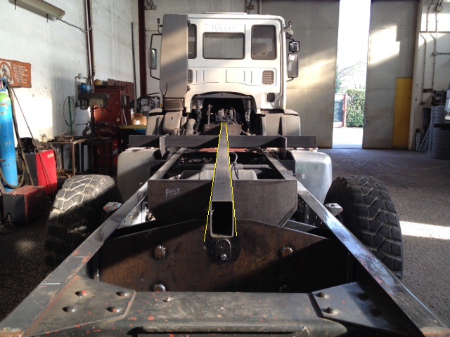

#36 Beitrag von Enrytre » 2014-03-28 23:37:14
Thanks Pairoa Google Translate English well enough but from German to Italian is very bad ... I sensed but not fully understood thanks again.
I do not know how it will behave in off-road but in trying to twist behaved very well no twisting of the subframe ...
Here are photos of one of the most critical phases ...... the cross-lifting wheel.
Raised up to remove from the ground to the opposite wheels do not lift ..
The subframe has behaved properly! No twisting, perfectly aligned with 40mm twist of the original chassis Iveco.
I will not conceal that both me and the engineer that the workers this morning we were very happy with the result ...
To you the judgment and any findings of a technical nature ... for me as my first project I am proud then at least as a static test for the dynamic test using the means I have to wait but the premises of a good job are all there.
Bye Enrico

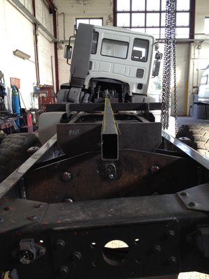

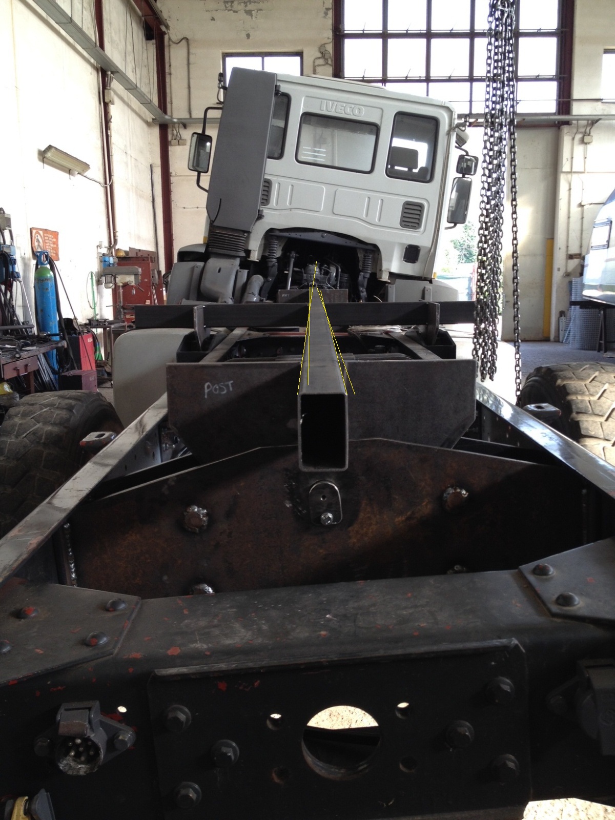

pairospam
Beiträge: 950
Registriert: 2010-11-22 14:27:25
Re: Desertikon 4x4 on Iveco Eurocargo 95e21WS
#38 Beitrag von pairospam » 2014-03-29 4:47:45
Enrico:
Excuse me but I have taken your pictures and checked what I thought at first sight was wrong with them, and it is clear with the guide lines that you have lateral bending of the longitudinal beam towards the right when twisting the frame the way you did.
This is not good. You have to compensate this effect or something will brake. Maybe allowing the central pivots glide a few millimeters side to side will help.
Cheers and keep the good work.
Pairoa

#39 Beitrag von Enrytre » 2014-04-02 0:11:33
thanks for your observation Pairoa but ...... the subframe is not complete with all its structure ..... now in these photos below is complete and a lot more solid ....
What do you think ....guys ??
Bye Enrico
