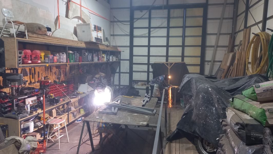

Inside the shop, while it rained outside, the work turned hectic when Ramón, Gabriel and I were all three working simultaneously with steel and throwing smoke and sparks all around. The bikes had to be carefully covered to avoid any damage from the sparks. It was a noisy mess, but it was necessary.

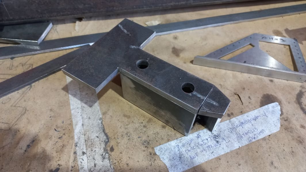

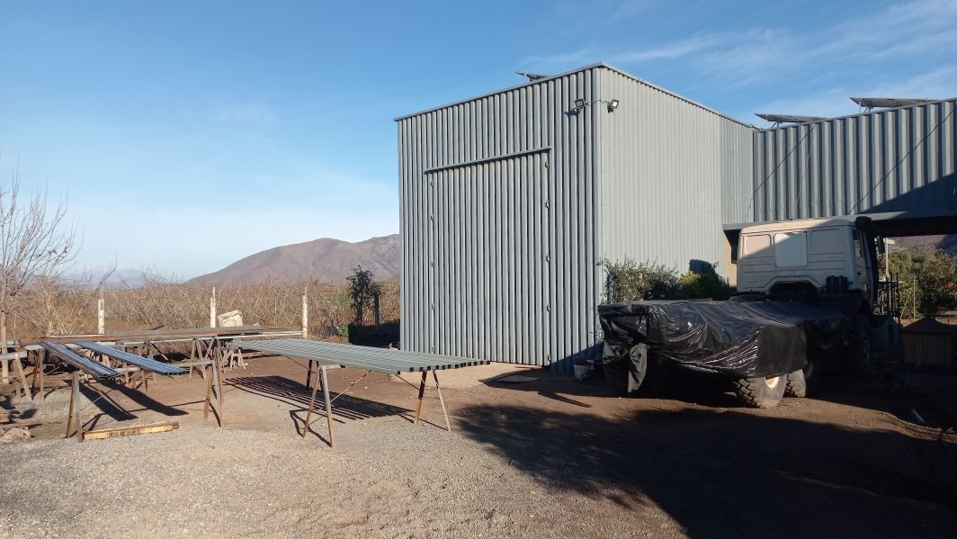

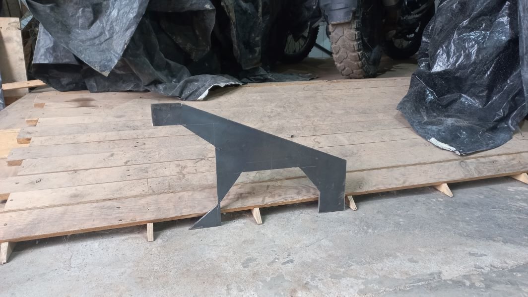

From the metal sheets collected at Verardo’s workshop I extracted some pieces needed for the brackets of the subframe. I decided to put to the test the whole thing before building it seriously, so I drilled 8 milimeters holes to let the structure lean on such delicate pivots to see if they held. In that case it would be apparent that the actual pivoting points of the frame were the exact ones, and I could go for the serious building from then on.
As part of the ceremony, it took me quite a while to align perfectly the pieces and to clamp them to the frame and the subframe.

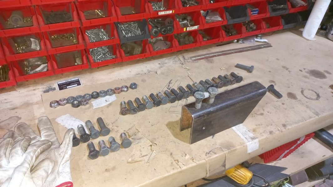

Gathered the M14 bolts and nuts I collected during all these years to select the better ones to use in the making and bolting of the crossmembers, and it was quite a lot although they were all too short. Hmm…

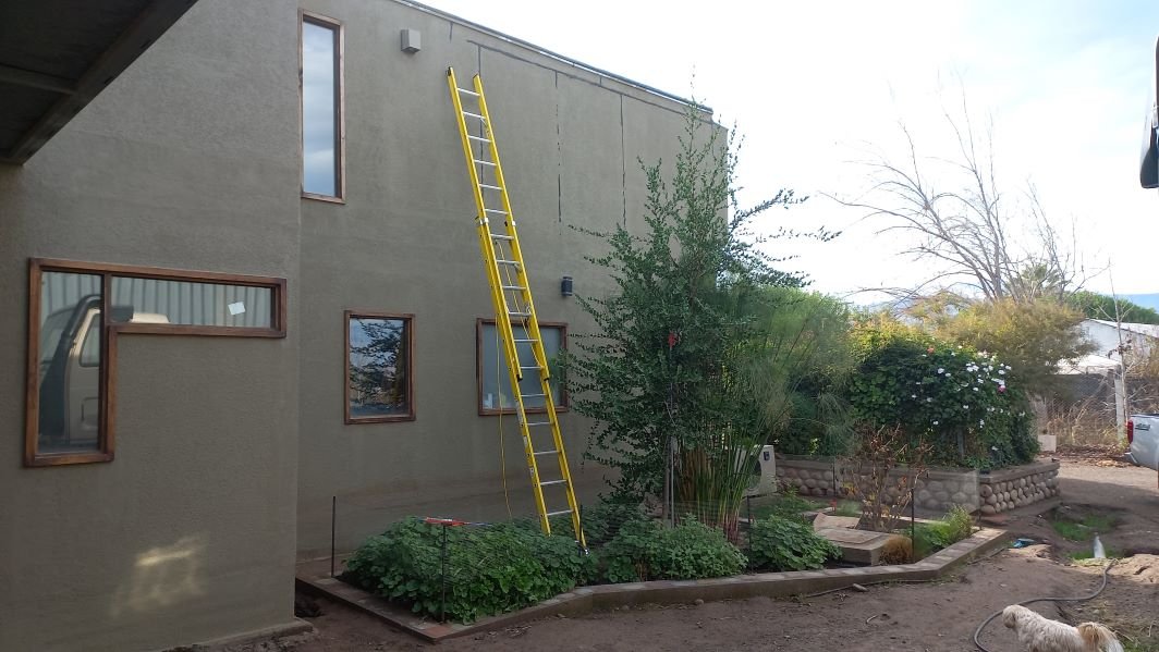

I was at it when Gabriel told me that there were a few cracks on the paint of the walls of the house that had to be dealt with, and as he and Ramón would not be available during the next days, it was Pairoa the one that had to deal with the issue, and quickly, as the forecast menaced with another rainy weekend. It was necessary to seal the cracks on the walls and re-paint the whole house.
So, I went out to buy a long, long, long telescopic ladder as it was not possible to use the tricky ladder I momentarily assembled for dealing with the panels and the manual winch of the roof of the shop once upon a time.
I spent that afterrnoon and the whole next morning at the task of repairing the supposedly infallible covering of the walls, applying a lot of urethane compound to seal the cracks that would have allowed the water to come in and cause catastrophic damage to the wooden panels the house was built with. Painting would have to wait.

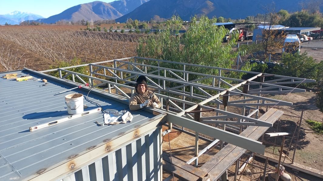

The sun shone at times warming the earth and the hearts, and Ramón went on with the roof of the kennel, dressed up like an only child under his welding gear to keep up with the cold of the evening.

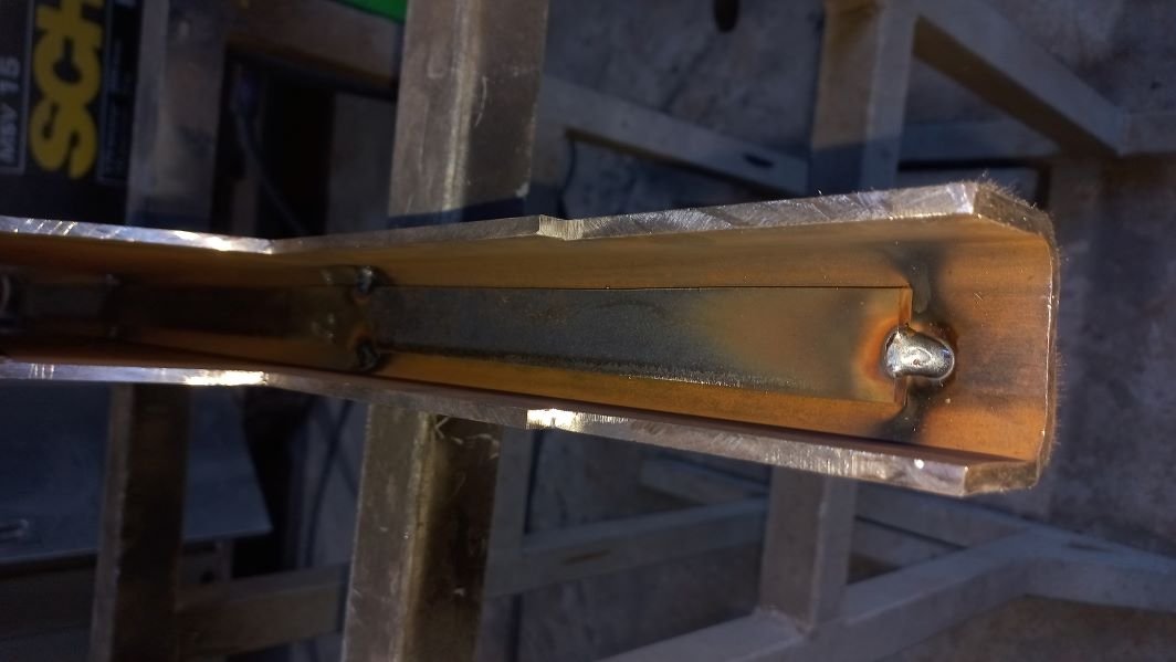

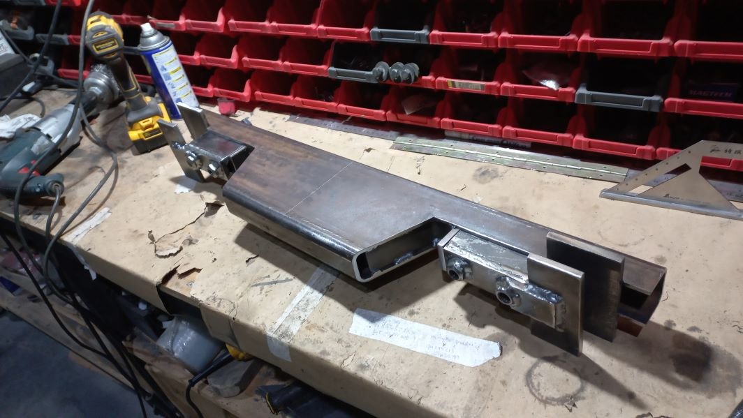

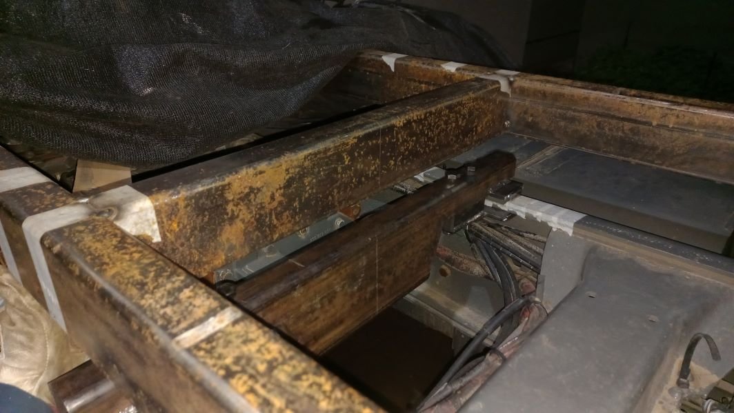

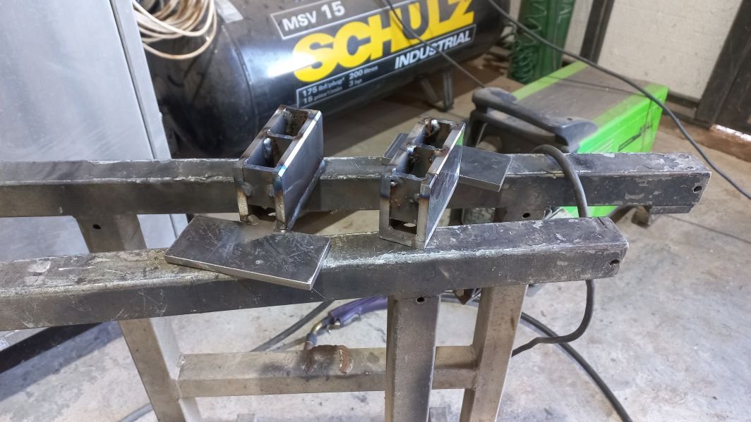

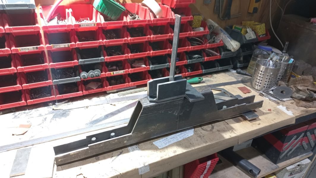

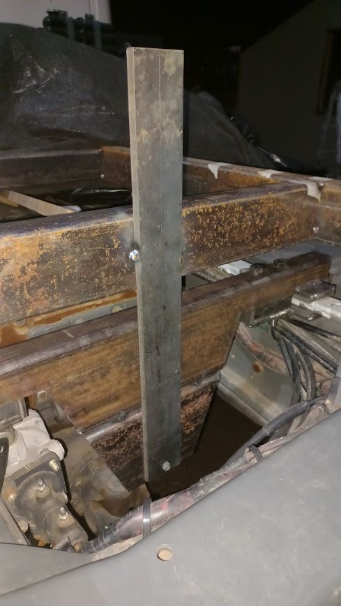

At my request he inspected the crossmembers I was building and suggested to reinforce them with additional steel, even if it seemed that it was okay. It never harms to be on the ultra safe side.

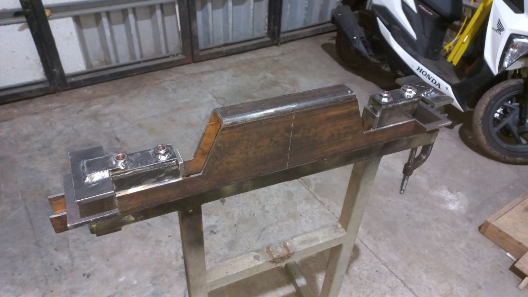

I followed his advice and went on with the building of the front crossmember. This piece would go gripped to the upper upper flange of the frame beams of the truck by bolt-driven brackets. The design of the brackets was a little tricky and I wanted to make them very tough and precise though easy to install.
Working with 8 mm-thick steel was relatively straight forward, as to cut and weld it was easy and with not too much heat deformation, but still there was some, which made the process a little boring as some corrections with lime and powergrinding on the brackets were needed.
I thought I reinforced them enough to withstand the forces they should resist, and much more, you know… that Godzilla stuff. I was happy with how they looked and how they worked, in the end.

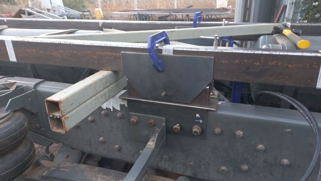

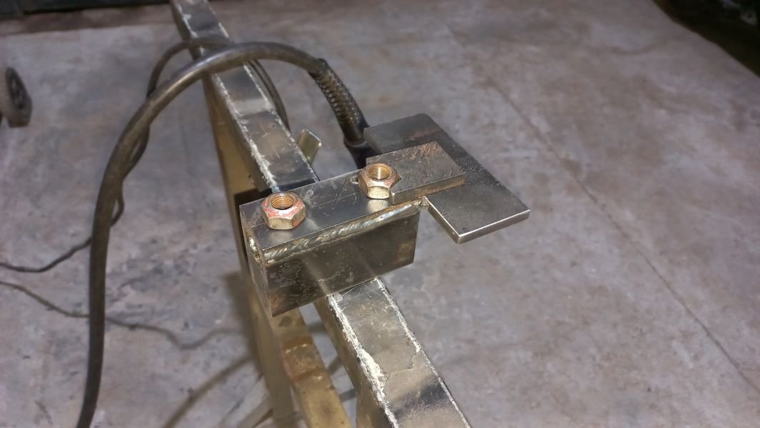

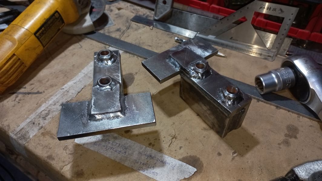

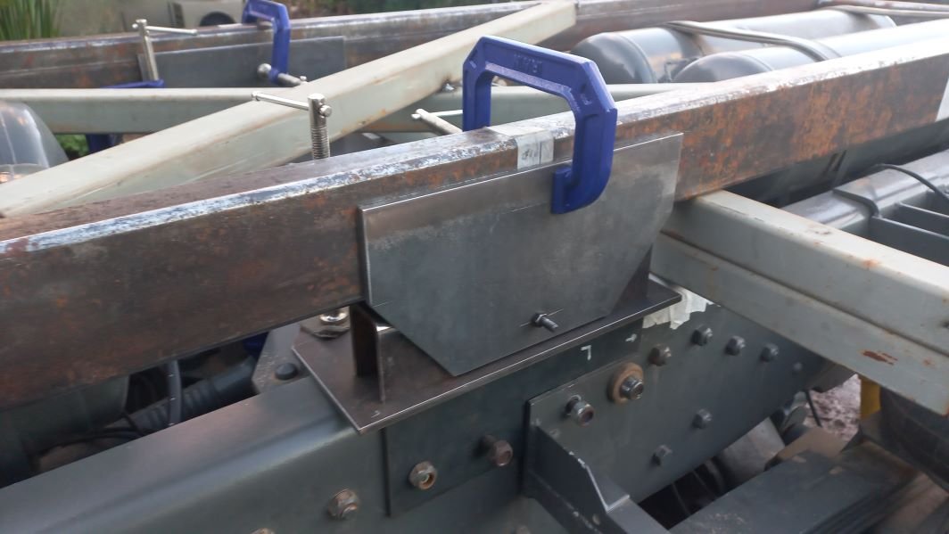

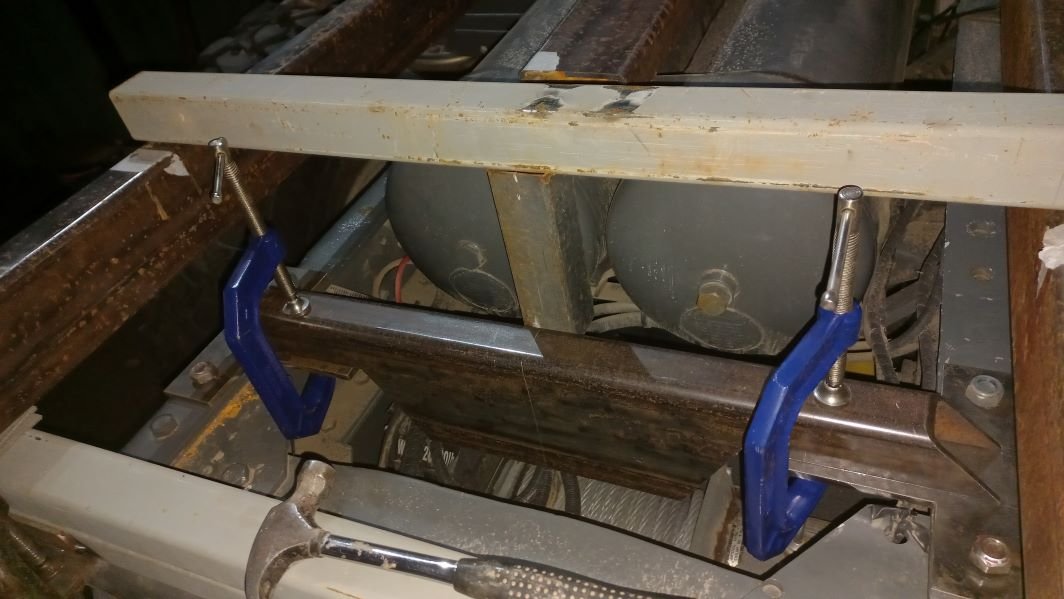

Finally, I had some time to take the crossmember and made some reinforcements here and there until it was ready to be mounted. I went to a rubber-to-metal bonding workshop that I used to go before and got some pieces of high-density rubber for the brackets from the owner who, after some years, still remembered the project I was in.
I took the welder to the side of the Merkabah again and tack welded all the pieces held until then by the C-clamps. I measured it all again making sure it was all still aligned and straight.
Late in the evening I installed, momentarily but perfectly aligned, the front crossmember on the frame. I had to move the brake servo pump to make room for the bracket to be applied, as it stood in the way. It should not have been a big deal, but now the access was pretty difficult with all this metallic stuff hiding it from sight and reach.

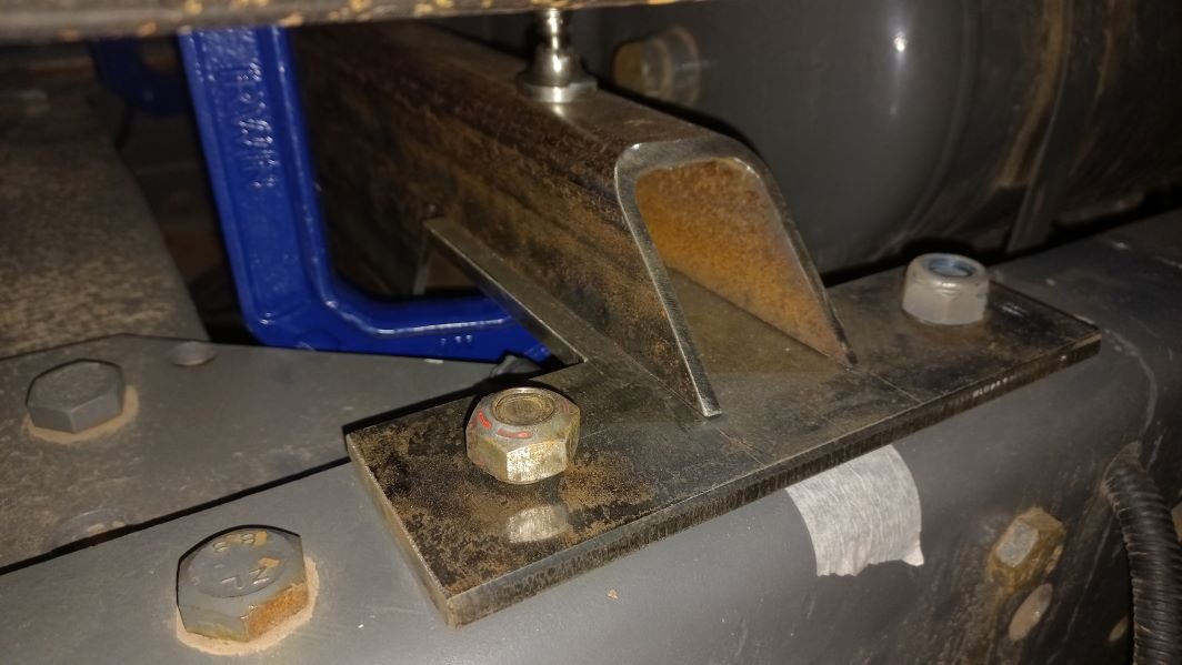

One of the reasons the design of the rubber mounted subframe was abandoned was the fact that the access from the side of the truck to the stuff in between the rails would have been completely blocked, making repairs, inspections or servicing pretty difficult.
Finally, with the subframe fixed to the frame by the central pivots, I aligned and tack welded also the rear crossmember that would hold the rear pivoting bracket.

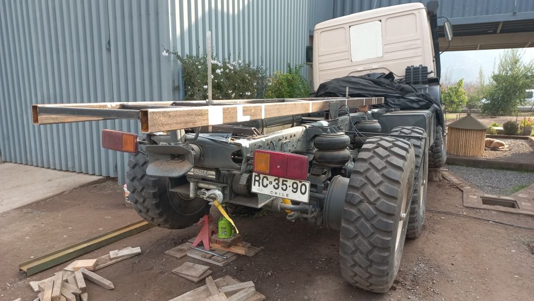

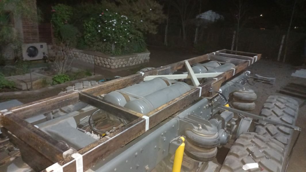

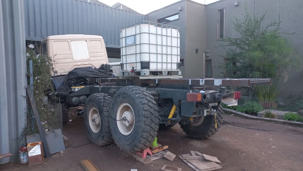

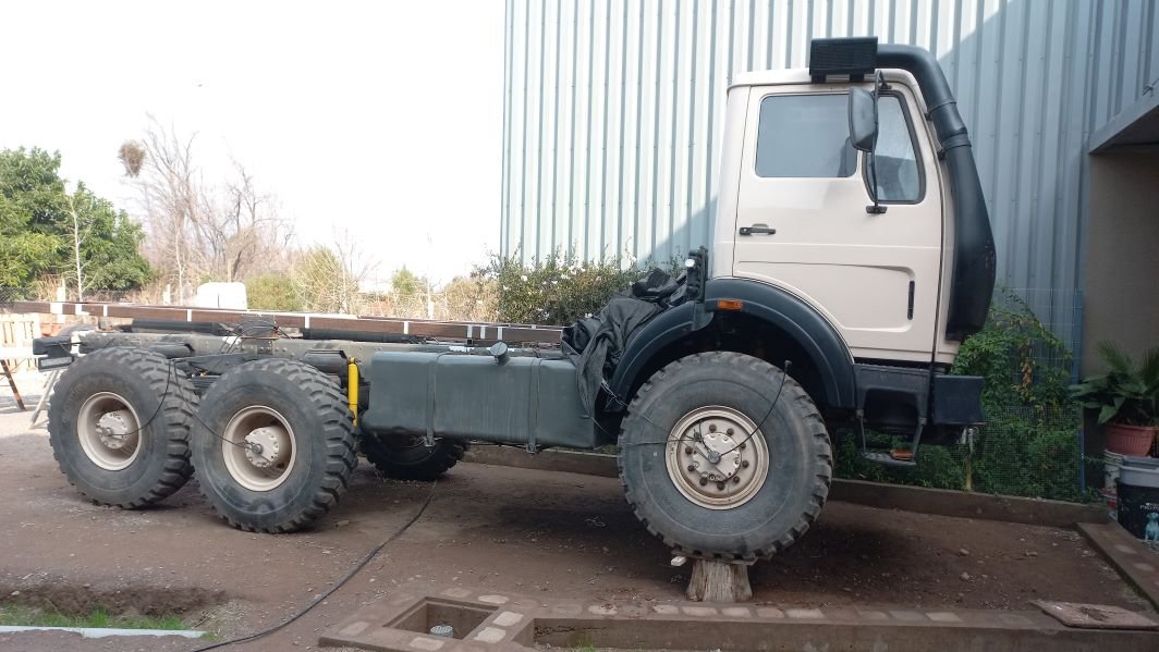

The next weekend began by gathering the pieces I would need for cross lifting the axles to bend the frame and see, again, how it behaved.
I got the hydraulic jack and a lot of pieces of wood to play with, under the attentive look of Trump that missed not one of my movements.

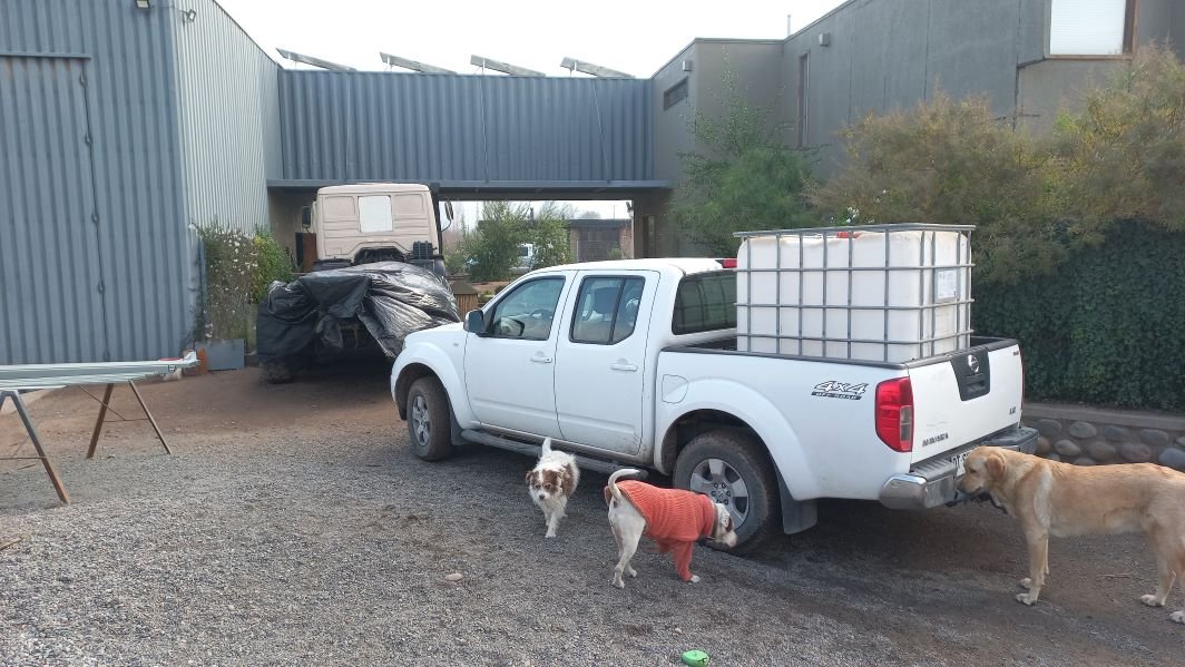

I also borrowed from Marco, Eduardo’s cousin, an IBC tank to apply some load on the frame, as planned before.
After a couple of thousand strokes, I finally got the truck on a stump and a stand, twisted enough as to lift the right wheel of the third axle.
The longitudinal pivoting axles of the frame remained the same as measured while the Merkabah was on Eduardo’s workshop, far in the depths of the frame at both the front and the rear.
Sorry, but I cannot correct the orientation of the vertical pictures.
Eduardo gave me a hand, and we placed the water tank on the frame, right on the center of the boggie.
Re: Mercedes 2626 AK 6x6
I connected the water hose and began to fill the tank with the precious liquid we praise so much in the summertime.
As the filling rate was not very fast the evening came, and it became progressively darker and cooler. I did not want to make any measurements with the light of the phone, so I wrapped the whole thing and left for another cup of tea and a big glass of milk and banana.
The next day arrived with a bright sun and a clear sky. The Merkabah seemed not to protest her ballerina-like attitude and her unlikely coat.
And, of course, the measurements did not change a bit. Probably one or three tons would make no difference for a frame made to withstand 26 tons, so I took the numbers for certain and began the not very encouraging task of emptying the water tank and remove it and the stump and the stand from under the axles. Pretty boring.

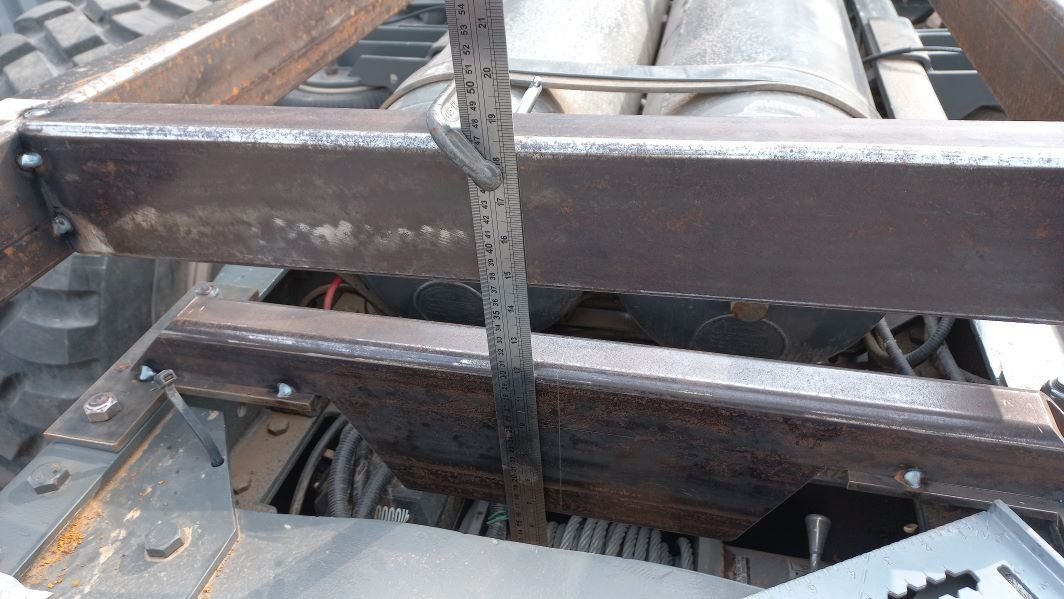

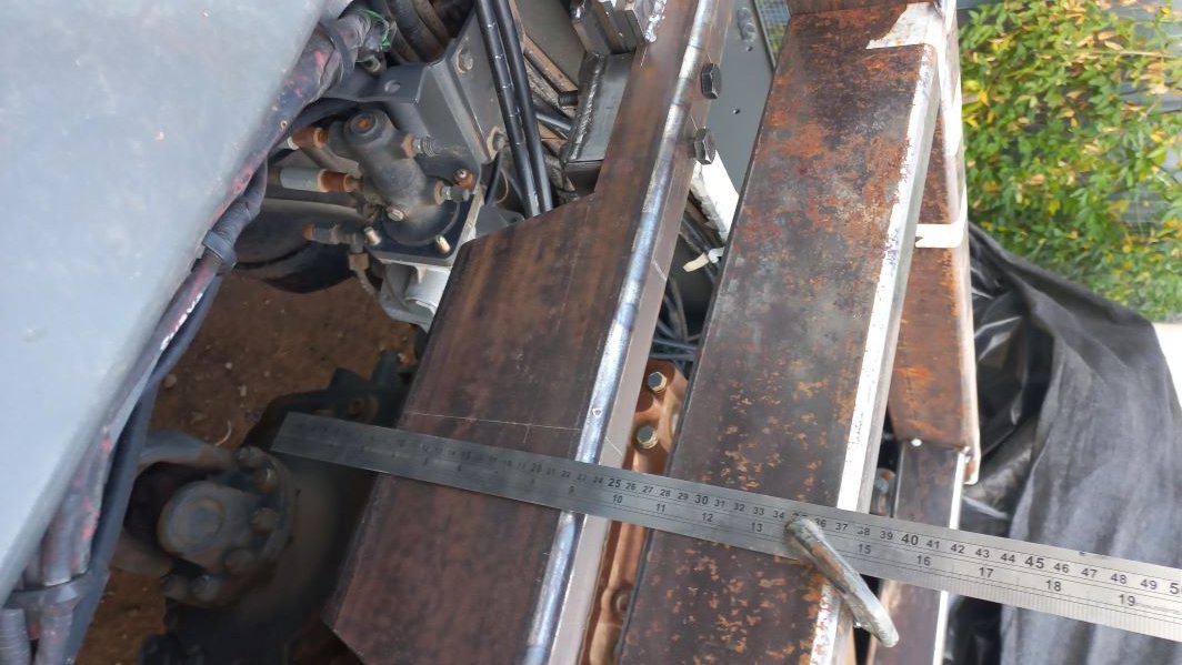

When I could, I resumed the work and cut and drilled the rest of the pieces of the rear crossmember, tack welded them and tried to put the big and heavy thing in place. Unfortunately, the winch was in the middle, as expected when the pivot point was so deep down.

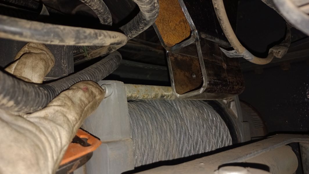

I unscrewed the winch and kicked it as back as I could. That gave the exact amount of space to place the crossmember and the head of the M8 bolt. I would think on how to fix the winch issue later.
Then, I repeated the operation with the front crossmember, which was only 27 cm deep and did not require an additional piece to get to that level.

Put just a couple of welds to fix them, with a long lever. In case there were still big stressful forces the weldings or the bolts would give. Then, wrapped the back of the truck and enjoyed a nice meal as the day came to its end.

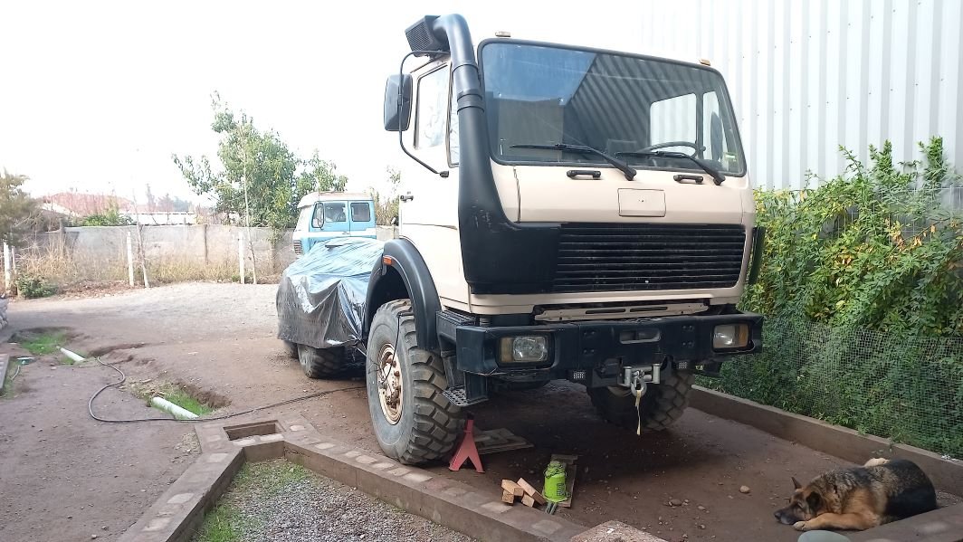

And the Merkabah once again went to play. I drove her to the same spot where she twisted to maximum. My old man had some difficulties going down the cabin because it was very high… and he is already 81. We are not the same at 81, guys.
The frame spiraled under the tension, much more than when jacked up, but the subframe kept perfectly straight.
Success. It was all okay. The weldings and the bolts stood and nothing broke.

Hello again:
“xxx” seems the right time for the first camping indeed, Max. I only hope to still be able to go up and down the cabin.
“… While twisting the main frame, one of the fixed point at the middle of the long sides will move forward and the other backwards.
This requires a lever with two pivot points in the middle oft the long sides of the frames.”
“… the center pivots can stay fixed. But in that case, the front and rear pivots must enable a certain movement in longitudinal direction. Which, I think, you Pairoa already had in mind ... “.
Kind of, dear Klaus and Oli:
Placing the central pivots right on the center of the boggie console, the toughest and more rigid piece of the whole truck, minimizes their displacement, though they move, actually.
More elegant concepts include bigger and rubber-mounted central pivots to deal with this movement, but I wanted to keep the design as simple as possible, and I have seen a lot of examples of what works and what ends in disaster.
That is why I do not mind the pretty extensive length of the transversal plaques that will bond the Box to the subframe through the longitudinal pivot. I am counting on the slight bending capacity of those pieces to absorb the very tiny to and fro movement derived from the torsion of the frame. It is not much.
Also, Having a composite crossmember made from two or three pieces of rectangular steel profile may give the piece a little less rigidity compared with a solid one when talking about the longitudinal resistance, while keeping the strength.
Sounds right, though I cannot be 100% certain. That’s why I wanted to make a full test before, and it seems to work well… so far.
I will install the serious bushings (already ordered) and make another test. And when the metal frame of the base of the Box is ready, I will make another test, and so on ad nauseam, to see if things change in the making. Hope they do not.

Here is a picture of a MB original construction. I gues the movement of the levers was mor than 5 cm against each other:
userpix/182_10171_1.jpg

Hi again, Oli:
The original MB anti torsion subframe is a complicated piece, not very lightweight, and includes a torsion bar linked to the spring packs. It is a three pivot or triangular shaped system, which "fixed" or strong pivoting point is the rear one with a longitudinally rotating axle, and the lateral or transversal pivots are way on the front and they pivot in relation with both the subframe and with the upper structure, allowing plenty of movement in the aft-front direction.
The Casales offered me such device, taken from their 1017, that could have been modified, heavily modified, to fit the Merkabah, but would have been a real crime to ruin the piece.
The frame of the 1017 is also very different from the AK2626 and way more flexible than any stiff kipper-minded model.
The frame of the Merkabah does not move that much, and I am pretty confident that my anti torsion subframe design will deliver and endure. If not, you will be the first to know!
Hi:
Not too many things to report today, because at this time of the year the regular work becomes a little hectic and the Merkabah is forced to the eternal waiting. And it really has been quite a special year this one.
Anyways, when I made the practical twisting test of the frame on the riverbed with my father, the construct behave as perfectly as calculated. I was so happy that I began to think in fabricating the metal frame for the base panel for the Box as soon as possible.
So, I rescued from the oblivion the jack stands that supported -barely- the load of 500 cement bags on the bed of the green Nissan truck. Some were a little bent for the effort, nothing that a loving trim with the powergrinder could not fix, but I wanted them to be adjustable to the millimeter in order to build the frame perfectly square and even.
Some big bolts and the correspondant nuts were then selected for the adjustability of the height and with a little cutting and welding I modified the stands to be up to the task, under the constant and proactive supervision of Trump, of course.
At some moment, I removed the pieces of the central bracket of the left side of the subframe and enlarged the perforations for the actual 5/16” pins and then welded the metal bushings prepared by Verardo’s people.
They came pretty good to me and, supposedly, each bracket could stand twice the weight of the whole Box.
It was late when I put them back in their place and tack welded them, again. Yes, they looked good.
And at some other moment, I removed the front and aft crossmembers and began to make the appropriate cuts, weldings and reinforcements to make them fully ready to use.
After many weeks without any news, finally the dealer of the servo clutch sent an email granting a reimbursement for the part I gave back to them as it was, of course, irreparable. My usual luck.
So, I went to Santiago and purchased another one but profited of a special sale and got an original Wabco servo clutch for half the original price minus the price of the Cojali crap. Lesson learned.
I tested if the thing worked before taking it out of the shop, but only when I was at home the next day, and after bolting the servo to the support, I found out that the fitting had the wrong thread. Ops.
What to do? Put it in the pocket and drift to another issue. Life is hard.
The crossmembers needed some more attention so I finished the work on them. I trimmed the sides of the front one a little, and carefully welded lateral reinforcements and, of course, welded the bushings.
Slowly but surely, with his ennervant precision, Ramón approached the finish point with the roofing of the kennel. It would be capable of supporting a few dozen more solar panels, a heliport or the fith chimney of the Titanic.
From the rest of the big metal plate that was left, I cut one of the plates of the front bracket of the subframe. It was one big heavy piece. Originaly, the design featured an odd shape and many funny carved holes to keep it strong but light.
F..ck it; keep it plain and simple.
Yet, to cope with the limited but sure back and forth movement, I needed some play to avoid the direct conflict of the plates with the crossmember, so I added in the design an inner washer and the correspondant supple to keep the parallelism of the plate with the subframe’s crossmember.
This time Trump and Alicia made turns to control the operation and give the appropriate orders and directions to the subscriber.
The rest of the crew did not bother too much and remained distant, aware of the burning sparks and busy with their own metaphysical self-imposed tasks.
I put the front crossmember and the half bracket plate in place and it all fitted perfectly. I put a couple of tack welds and went inside to change clothes as it was someone’s birthday, and that took all my attention for the rest of the day.
I made a picture of the 10th cutting disc that I had used in just a couple of days. Though it is a boring process, I always prefer to cut the pieces by myself. If not, what is the fun?
To avoid overheating the power grinders I worked with both of them alternatively, with the gates of the shop widely open to keep the fresh air coming.
Fortunately, my neighbor is a welder and makes his living on it, so I bother no one with all the noise as he himself competes with me with the use of the welder and the machines in the weekends.
It took me a while, but I cut and finished the three pieces for the brackets and I decided to install the rear ones first, and there was a reason for that.
Remember that the rear bracket was so long that there was a neat conflict with the winch, and it was not just a matter of moving it a little? Well, it was just the right time to address the issue.
When put in position, the bracket plate made clear that some radical move had to be made. I decided then that the easier way was to put supples and lower the whole winch tray just the exact amount to clear the upper tie bar of the winch not to compromise the departure angle too much. You know I care about it because I always put myself in trouble and more than surely it will be meaningful in the future.
The recently modified jack stands worked perfectly to lower the quite heavy tray, though it was difficult to move under the frame with so many kissing attacks.
When measured, only 3,5 cm of clearance were needed, good, but I had got to make a couple of ad hoc supples from what I could find without deviating too much from the main goal.
I immediately put my eyes on the 150x50x5 profile and made some calculations. The numbers, roughly, as my skills and knowledge are pretty limited on the matter, turned.
So, I cut and shaped a couple of supples made from the said profile and some nice weldings.
When put in place, I confirmed they fitted and fixed the problem very well, so I marked them and drilled the holes needed to put the bolts through to attach the tray to the frame again. I needed eight new and longer bolts, also.
Even if I drilled with love and care, one of the holes was misplaced and I had to correct it with lime and Dremel. Pretty boring, and the whole process was time consuming, as it is when you must correct or adapt any given unplanned situation.
This project has had a lot of it, the try and error thing, but it has not made a big impact on the general mood… so far.

One afternoon I decided to work late and finally installed the supples for the rear winch tray. They were not the same grey color, but I did not want to use anything but what was available on a clean and ready-to-use spray can.
They looked pretty allright, according to me.
To bolt the winch back in its position, I had to remove the roller holder, and I had to unwind the cable because the last time I used the winch I did not rewind it orderly, do not remember why but I knew I was going to repent for not doing it at the right moment.
The support of the subframe missed the tie bar for just one milimeter, as expected. Good.
The bad news was that one of the square nuts to bolt the winch with was missing, so I had to get or fabricate one to secure the winch and put an end to the issue. More time to spend on these countless little things.
The next discovery was that the plug for the wire control was now obstructed by the frame, and I could not make the winch work to rewind the cable.
I went to look for the remote control and, guess what… the battery was discharged from being there, annoyed, for the last twelve years. Hmm…
I wrapped again the rear of the frame with the plastic sheet, closed the gates of the shop, turned off the lights and went to sleep. Enough for that night.

One of those days I decided to order the steel profiles needed to build the base panel for the Box. Gabriel and Ramón helped me to pick and store them as my back still showed signs of aging and misuse.
At a given moment, I took outside again the MIG welder as I wanted to place and weld the big brackets of the subframe. Had to correct the alignment of the beams a little and held the rear part of the construct as it tended to bend under its own weight. Just a couple of milimeters, of course, but I could not help myself… you know.
I just put some stitches thinking of taking the subframe out and weld every component for good outside of the frame, but we discussed about it, Eduardo and I, and he convinced me to weld everything in situ to let it cool down and normalize on the frame to avoid further deformation. Sounded logical.
The next weekend I had a whole day free, so I uncovered the Merkabah early and left the subframe warm up under the pale but very present sun for a couple of hours.
Then, I seam-welded all the horizontal aspects of the components of the subframe at maximum voltage with the 0,8 mm electrode. It went pretty well, I think. I left the vertical welding for later, probably to be welded by Ramón as was the original plan.

I tried to borrow from him the Ford Cargo to use the crane to remove the subframe from the frame of the Merkabah to finish the welding and to begin the construction of the base panel of the Box, but he told me that the truck was grounded as it needed major surgery on the engine.
The subframe now weighted a lot, not manageable without a crane, so it was not great news. I was going to need a forklift to do the job.

When I was checking if the best place to put it was under the front bumper, sort of hiding it, I kneeled and noticed something strange about the front axle, something ominous.
Oh, oh.
I went under the cabin and realized the full scale of the problem: two of the cups from one of the cross-pieces of the left cardan shaft were missing. Ops.
When I assembled the cardan shaft, the hands were not the original ones and so the cross-pieces stood a few milimeters wider, and thus the snap rings could not be used. I came with the idea of putting washers welded to the hands, but obviously the welds were not strong enough.
Well... if there is something that I have learned from all these years trying to keep up with this project is that, no matter what, anything can be fixed… anything.
But, thinking about all the work, time and resources needed to replace the cross-piece, my heart almost broke and my spirit was left hanging from a fryed thread. Christ, it hurt.
After drinking a bitter cup of tea, I went to the task of searching for the parts, being them the cups or the cross-piece as a whole. I found them on the internet on European pages, but I was not sure about the exact coding, as the numbers were different from the EPC list, the old parts, those which were in situ, and those which were listed for sale.
At the present moment, I am relying on one of the souls of the forum, great guy, to help me out with this pretty big inconvenience. Meanwhile, the Merkabah is at rest, once again, looking the time pass by.

Anyway, it just meant that the work on the Merkabah had to be delayed, as usual, and Eduardo, who was going to help me again with the bleeding of the clutch, kept happily up with his business.
Though it seemed that every single little step to make any progress always became a steep mountain to climb, I was in a good mood as, all in all, the Merkabah was almost streetworthy, so I picked the license plate to choose the better place to put it definitively.
Oh, oh.
And so, everything about the project was in pause, imitating the nude peach trees under the menacing cloudy skies waiting for the spring to come. There was no forklift available at that moment, and I could not use the shop as Ramón had to fabricate a new front gate because some idiot had smashed it with a truck not long ago.
