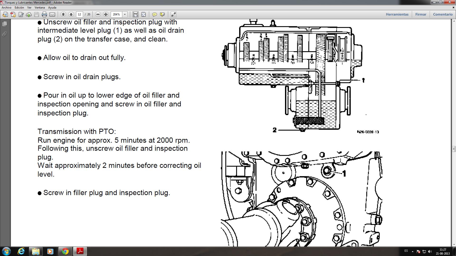

P.S. sorry for offtopic; but I need to change gearbox/transfer box oil on mine and can not locate plugs for drain/fill.
Actually I see several plugs but I am not sure which is for draining, which for fill and which for level control.
Can you or anyone else help with some photos or pictures from manuals?
it is same separate (splited from engine) gearbox as on yours (do not know produstion model, it is ZF...something)...

@ domagoj: welcome to the thread. I do not own the page but I believe that this is what it is intended for, to help in any way, so your question is not off-topic. Glad if I can be helpful but unfortunately I don't know how to upload the Acrobat Reader file right for you. I will see what I can do.

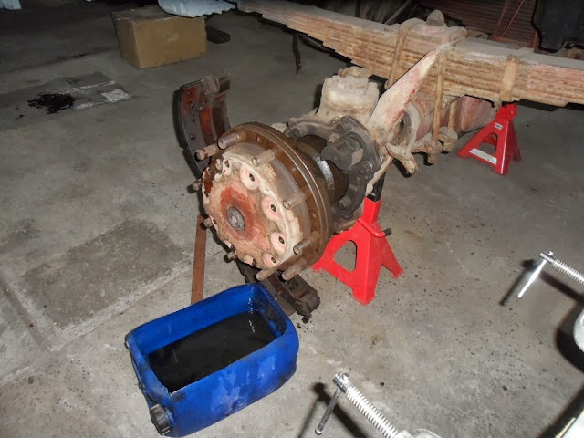

Hi again:
Well, let’s continue. I am pretty aware that this can be a quiet boring phase of the story from the point of view of a reader, but for me it was very important and significant, and every detail was crucial as I did want to make no mistake in reassembling the bogie.
Back at the shop next Monday, with renewed spirit (and aching thighs) and the rest of the bolts and nuts, I dedicated some time to tighten everything I could on the tail of the truck. The bolts I brought were not enough, as usual, but… what the heck.
I put on the inner covers and they looked very good after the reparations and the paint. Then, I undusted the brake chambers, kept closed in their boxes for so many months, and put them in to watch and calculate the length of the push rod. I realized then the very unpleasant detail that one of them lacked of the rubber bellow, just the one that I never inspected. Christ… and I had bought them more than one year before!
I called the distributor and the boss said that he would try to help me in some way as there was no replacement for the bellows. It was only a matter of asking for help to the very big Boss, then.
As it was a little overcrowded now, moving in between the frame rails for adjusting, putting and tightening pieces was much more difficult. I could only fear of when it came the time to install the tecalan to connect and to organize all the different systems.
Slow and all, I did reach to put the brake shoes bracket of the right side of the second axle and the brake camshaft, with all the retainers. Please do not laugh, as it was actually a very slow job, though not as slow as in the beginning.
The last thing I did was to close the tray for the winch with its front cover, and said – Okay, that’s it! At that precise moment a doubt came into my mind: Would this thing withstand the lateral forces if the truck got stuck at the side of the road? Good God… would this thing ever come to an end?
As you already know all the members of my family I will introduce to you the last arrived, Cachito. A few days ago I went out to take the car out to go to work, and when I opened the gate this guy showed up, fearless of Deva that stared in distress at him like saying – What the hell this thing is!? He just gave me a glance and entered the patio. I’m back! I think I heard him say. And he stayed, at Pairoa’s Foster home for missing dogs. I don’t know what is happening to me. I was not like this.
Looks like my patience has been growing as the Project goes on (and become stuck), and even Carmen profits of it to use me as her dummy for her last wool tricot creations while I try to concentrate in front of the computer, opened on the Allrad LKW pages. I think I am just growing older.
Go on. Too much intimacy.
Instead of enjoying that thrusday holyday I stayed dusting out other parts to continue with the assembling and I found the last pair of brake shoes, just the one that had the broken and missing metallic rims. Fortunately I had well kept the spares in the little sparebox many months before. Unfortunately, though, I missed the right number of retainers so I could not put the brake camshaft of that, the last hub. I put on the shoes provisionally and the rest of the assembling was dependent of when the retainer would be available.
I continued with the rest of the hubs and installed shoes and camshafts as well.
Zuletzt geändert von pairospam am 2013-08-28 6:06:51, insgesamt 2-mal geändert.

As you can see I had marked the brake camshafts the wrong way (L for Links and R for Rechs, in German, you know…). That’s why I worked so slow and aware, too many possibilities of mistaking.

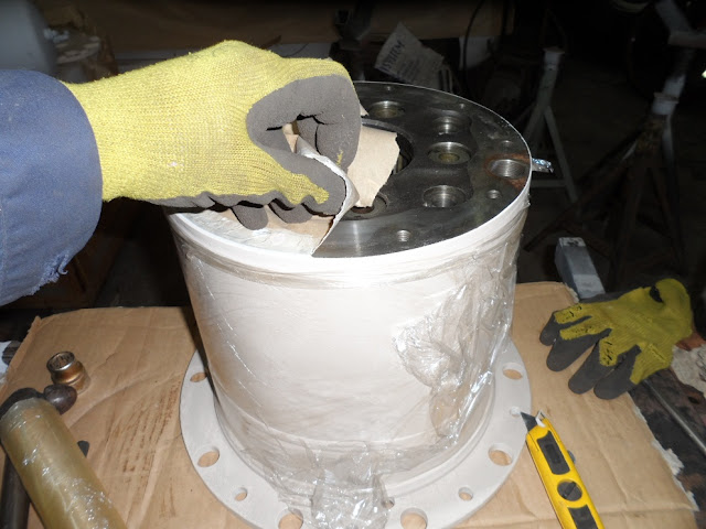

The next thing to do was to assemble the wheel hubs and for that the lanes of the axles had to be uncovered, and so they saw the light after many months covered by plastic and dust. The heavy pieces and the bearings fitted perfectly though the effort was not minor. The planetaries followed and when it came the time to tighten them I could not remember the order of the bolts and washers so I appealed to the photographic record again. As I was not sure about the torque I called my brother in law and we agreed to do it together the next day, to avoid screwing up something.

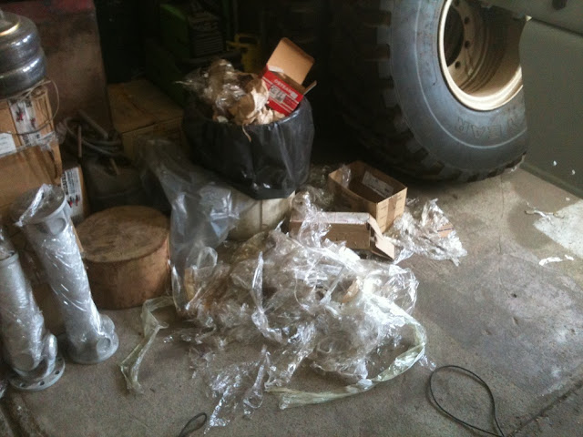

The pile of discarded carton and plastic was huge and exceeded the trash can capacity, but I was happy.
I put together the three ensembles of hubs and left the one that lacked the retainer and when I was leaving I stumbled up with something I had absolutely forgotten… to fabricate and weld the supports for the second axle shock absorbers. Ops. The imprecations I kept to myself, of course. Now I would have to work and weld uncomfortably, trying also not to harm the hubs.
To make the story short, I could not find the famous last brake camshaft retainer so I bought one that was slightly different but worked as well, even if it was chinese, so I ended the assembling of the wheel hub that was uncomplete and then Eduardo and I torqued the bearings and finished the issue by bending the security washer flange. Good.
Zuletzt geändert von pairospam am 2013-08-28 16:30:09, insgesamt 1-mal geändert.

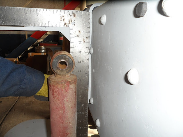

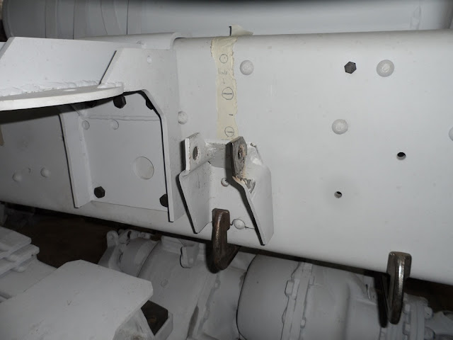

Before saying it was over I had to fabricate the supports for the shock absorbers of the second axle. I gave the issue a lot of thinking and I almost left for Verardo’s machineshop to ask him some pieces of steel and his tools to make the supports, but at some given time I found the cardboard model and suddenly I changed my mind. How couldn’t I be able to fabricate them by myself? Besides, going to Verardo’s ment to loose at least two days among conversation, making the cutting pattern, waiting for the right time for cutting, if there was a moment for that, etcetera and etcetera. Too much.
I marked and cut the steel of what was still left of the frame of Spare, strictly avoiding any welding lines this time. The most complicated would be to double curve the pieces, as the original support of the old yellow Mercedes left to die on the Aconcagua riverside; remember?
After a lot of tries I found the best possible way to bend the pieces with total control using the few tools I had at hand; do not forget that we are talking of 8 mm thick steel plates. A few burns and efforts and I had to leave, though. Someone had to work to pay for the amusement.
But the time was always pretty scarce, and the progresses quit slow. As every single thing about this project, fabricating pieces and parts always required a lot of time.
The thing is that I finally reached to bend the plates properly and then marked and cut the lateral reinforcements. It was not easy nor fast, as you could imagine. I prepared the pieces, pinpricked them and then MIG welded everything. Only at that point I realized that the supports were too short and so I had to stretch them by 25 milimeters; another afternoon spent at marking, cutting, preparing, welding and grinding the bloody little pieces.

When the stretching was done I cut the pieces for the bushings of the shock absorbers. I drilled them until I run out of drill bits and I had to go to Verardo’s for the right powerdrill and the right bit.
After all the pieces were ready I pinpricked them trying to maintain the perpendicularity using the same shock bolt and nuts. It went all right, but the working week was over.
Saturday morning the cats had their appointment with the veterinarian, and Regalo behaved, as always, like the lady she is; Jinx, on the other hand, was furious… as always. Not even four people reached to make him swallow his pills. That’s personality, my friends. He turned his back at us the rest of the day.
In the afternoon I went to the shop, again, to continue welding the pieces. Once finished I grinded and retouched the supports for good. Some minor adjustements and then the final test with the actual shock, that fitted pretty well. I was just about to finish with the bogie, and so was the gas for welding, right on the last mark of the manometer.
I pinpricked one of the supports to the axle and tested how the shock absorber was placed respect of the suspension air chamber and of the superior support; spectacular, as planned. Good, but I went away with Eduardo to help my colleague with the installation of his new HD satellite TV system, leaving the mess behind.
I woke up early in the Sunday morning and went out for a run, but my injured ankle protested a little. Ops, maybe it was too long a run. The spring was arriving and the trees, including Carmen’s peaches, were starting to deploy their amazingly beautiful flowers at the countryside, and Cachito and Amanda were pretty curious about a pregnant horse that pastured around. It would be the third spring for the Merkabah since the beginning of the project. Late that day I came back to the shop and made some order, but I had not enough time left for working.

The thing is that I realized that the original design included a central fin to reinforce the welding to deal with the long lever, and I had forgotten it completely trying to go on faster. Bad… and it was not the first time that I underestimated the forces involved. I want to do one and many Bremsprobes, of course, but convinced that the results will be remarkable.
And, by the way, if you know me a little by now, I am not the type of guy that worries about pointing fingers, he, he.
As soon as I arrived to the shop again I made a layout of the forgotten fins with cardboard and then chopped a little more the already skeletric frame of Spare and formed the fins using the power grinder. Once I was sure about the shapes and the measures I pinpricked the pieces in position. I decided to weld with the MIG at full power, just for the fun of it and to avoid welding again downside-up with 70/18 electrodes; it was not easy nor fun the last time.
Well, what’s the difference between the previous and the next picture? Let me tell you: two hours, many burnings on the fingers and the neck, repeated head strikes, low back pain, cramps and a dozen cursing and interruptions because the welding nozzle became obstructed continuously by molten electrodes - a gravity issue. I show you the worst support, the one with the less elegant welding cords, but that’s the way it came, proudly speaking, though.
I put in one of the old shock absorbers to calculate the right height for the superior support to maximize the range of movement of the axles with that given shock (stock). I marked the shock to make it centimeter by centimeter, to avoid mistaking; the idea was to profit of the range of the shock as much as possible and use it also to limit the vertical inferior movement of the axle, but it was already late and the game finished for that day.
The working place was full of dirt and metallic debris and before I started to work I powerblown and then swipped and cleaned the floor. When it was all a little more decent I took the hydraulic jack and lifted one and the other axle to make the bogie swing to examine the movement range, again, and also to check how the struts of the sway bar performed. All okay.
I marked the precise height for the support but there was a problem because there were only three supports at hand, two even, taller than necessary, and one with the right height, but alone; if you remember, I got them from the yellow Mercedes at the riverbed junk yard.
Almost started to fabricate a new pair of supports but I opted for the easier way and decided to modify the long supports; cut and drill… that was the solution. The simplicity and strength of the design could well manage the shortening.
There was another problem, though: the hole for the bushing bolt of one of the supports was torn, repaired and then torn again. I wanted to go the machineshop to use heavy tools for repairing it but in the end I decided not to complicate the issue more than necessary; I applied a little welding and then, patiently, grinded and powergrinded it until the result, far from professional, was at least acceptable.
After marking where the bolt holes went on the right side of the frame it was the turn to drill them. Oh, super-extra boring job! I really hate drilling the frame. After a while the holes were drilled and clean, and this time it came not so nasty because I put on the earphones with a selection of the very bests songs ever, at full volume. The music also blocked the radio station listened every day by the workers of the shop, with their unbearable regaeton and cumbias, at least unbearable to me.
Unfortunately the drill holes were closer than I wanted or recommended, but at least they would be near a couple of rivets, that are like two welding points between the rail frames. This time I allowed myself to say WTF!
I installed provisionally the support and the shock, make sure of all the measurements and put again the air spring to check if it all fitted and made sense, but it was late and I did not want to drill again not a single hole. I made some order and took Carmen back home on the Africa Twin, to eat something good.
Obviously, the next thing to do was to drill the bolt holes for the support of the left side of the frame, and so I did. Looking at them again they look not too bad, and the actual distance between them and the rivet holes is almost 4,5 mm.
But that was a strange day, and things were like that, strange; many difficulties to accomplish even little tasks and very few time to do it. It was time for priming the recently born/modified pieces but it was cold and someone said that it was probably going to rain.

The next afternoon, just entered the workshop I started with the deep cleaning of the place, necessary for the next working steps. Eduardo and the mechanicians of the shop helped to lift and unlock the cabin and I secured it with a strut and a rope, just in case.
My brother-in-law and I thought about the best way to proceed and decided to leave the stands under the axle and begin by disassembling the hubs for cleaning and servicing. That way was more secure than putting the higher stands under the frame to allow the axle to be removed and be serviced out. Too many kilos of cabin, frame and engine to mess with. Safety first.
I worked a lot to clean and to make a little order all around the truck and I still lacked time to leave everything ready to start working on the front section. Again, pieces of steel, parts and dust had accumulated in every possible corner. Maybe you cannot see the difference on the picture, but the work behind it was not minor, that’s the reason for it.
As the afternoon became night I was left alone at the shop until I decided that I was done, still with a pile of parts to classify and to store in boxes, and a couple of bruises on the head because of some nasty strikes while cleaning under the frame. It was a very good day, though.

When I could finally find the time I started by emptying the oil of the axle casing and the drum hubs and then began to disassemble them. As a pretty curious fact the oil of the axle was incredibly clean, quiet rare for the standards of the truck so long. When I removed the right brake drum I found that the brake shoes were as new but everything was soaked in oil; looked like the retainers were out for a while. It was a relief, though, to find that the size of the components of the hubs was smaller than those of the rear hubs and then the cleaning job would be easier, or so I thought.
On the pilot’s side the scenario, even if dryer, was not happier; the brake drum clearly showed that its glory days were long passed and that there was no resuscitation for it, the wear was terrific. The brake linings were practically inexistant and even the rivets were worn from rubbing against the drum. Comparing both sides I couldn’t decide which was worst, and I did not know either if I should try to preserve the oil-soaked brake shoes. The front brakes are the most important ones and it is better to be safe than sorry. Anyway, it was now clear why the truck refused to stop and when the pedal was near the limits the rear wheels blocked and it tended to yaw. Of course… it had no front brakes at all!
At first I mumbled some cursing because I should have to replace the brake drum and probably negotiate it with the lady owner of the yellow truck dumped at the riverbed (it still had one), but then I remembered that the truck that donated the sun shade and the big diesel tank near the coast could also be of help. There were alternatives so I calmed down a little; there was not need for new, big and terribly expensive drums. Only later that day I remembered that the front end of Spare was still at the cattle, with both brake drums. It deserved a look but I had an uncomfortable hunch about it, though.
I continued disassembling the right hub, struggling with the dirt and the oil. The good thing was that the oil preserved pretty well the components, though preventing them to work properly. The locking bolt of the pins of the brake shoes was loose, probably because they forgot to bend the lock plate.
On the outside there was rust, dry mud and still some grams of pebbles on the corners.
When I loosened the brake shoes there was a fall of oil and dirt; I had long forgotten how disgusting was to disassemble and find that kind of mess that should be cleaned sooner or later. Horror.
I snapped the bolts of the end cover and… nothing happened. In the end I had to knock it down with the sledgehammer because more subtle ways didn’t work. When the cover was removed another bit of oil fell down and I had to leave because I had more productive things to do than waiting for the hub to drain completely.
