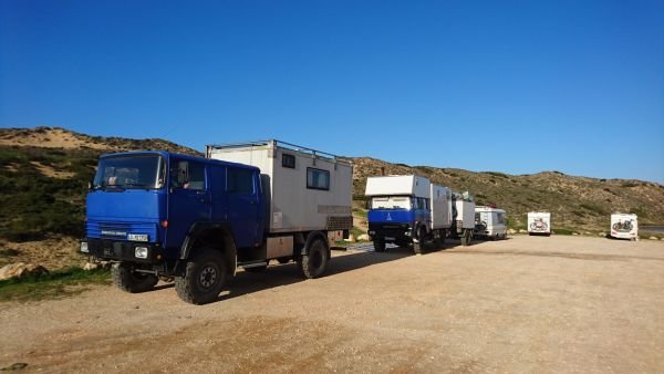

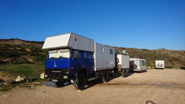

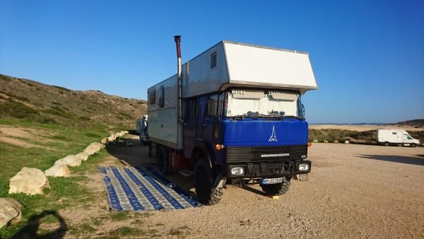

I wish to mount a cabover box on my 170D11 like on this image:
Ich möchte eine Cabover-Box wie auf diesem Bild auf meiner 170D11 montieren:

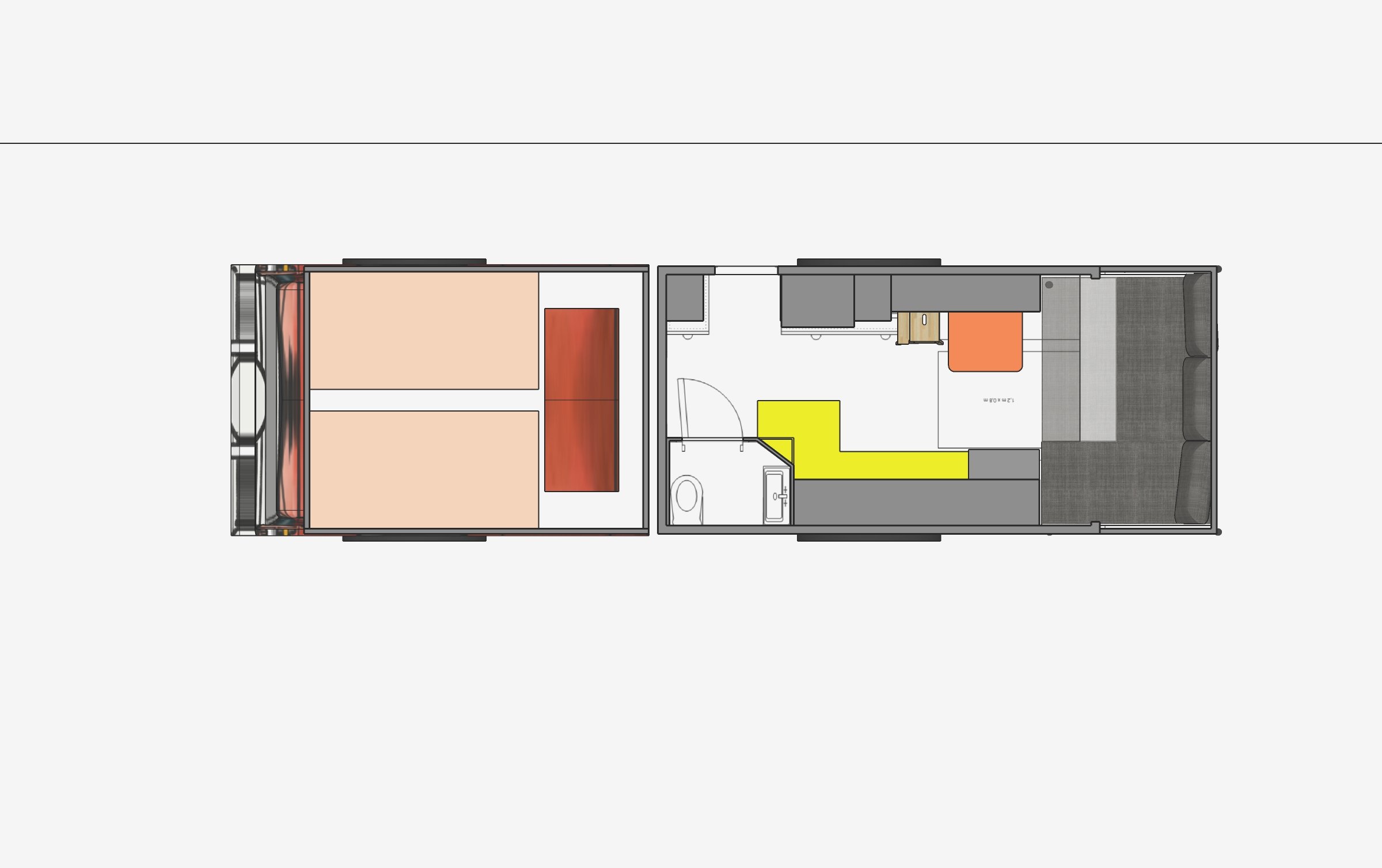

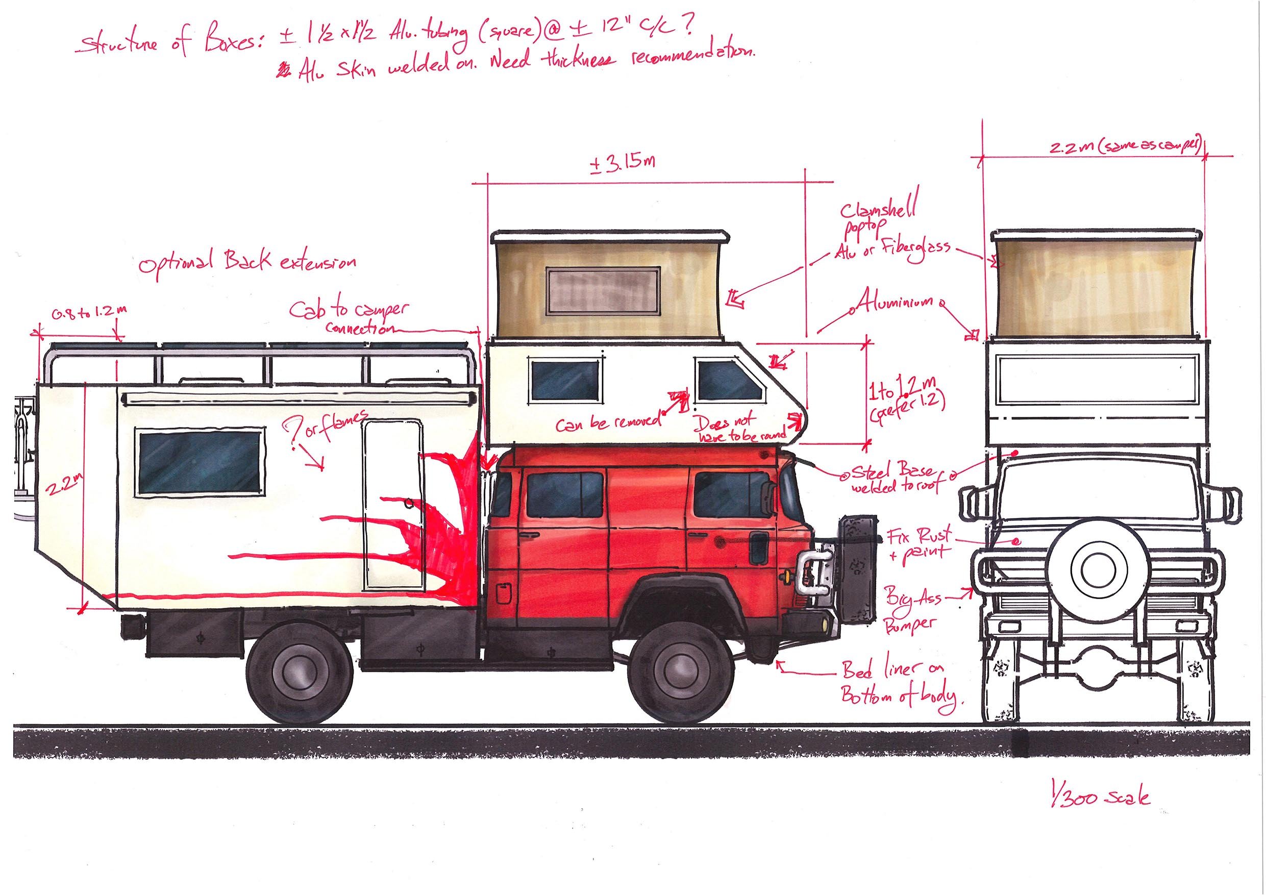

This is my current project:
Dies ist mein aktuelles Projekt:
I'm trying to find technical information on the best mounting strategy / mounting points on the driving cabin.

I had a 170 D 11for several years. The drivers cab may be a little weak for such a load, so it would be adviseable to create an inner structure to cope with the loads of the Cabover and prevent the cabin from collapsing at the next bumb...

My idea would be to bring them closest possible to the front and rear mounting points of the cabin, and to the sides where the "B"-pillars are, there is a strenghtening wall running across the cabin. I would attach it there.

But thank you for the additional reference photos! It's reassuring to see that multiple people have done this before! And yes, I had noticed that the B-Pillars were pretty strong, I'm actually a bit worried about the corners of the cab because of the windows that wrap around...

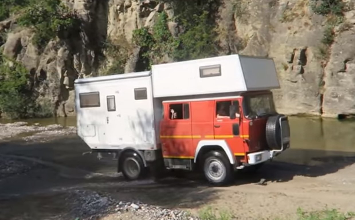

A few years ago we had those pictures here:
http://beimirwirkt4x4.de/Galerie_Mobby/ ... leeper.jpg
http://www.der-fehntjer.de/uploads/imag ... uge-8-.jpg
I like topsleepers too, so i called Goldbecker years ago.
They said, that they can build again such a cabin, weight will be around 180 to 200kg, price around 7000 to 8000 Euro.
Building it by yourself will be much cheaper i guess.
