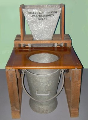

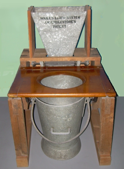

Re: VT 2500 Vakuumtoilette verstopft
Does not sound good. Need to eat more Bran.
One of these original portable toilets then no problems even in frozen weather.
