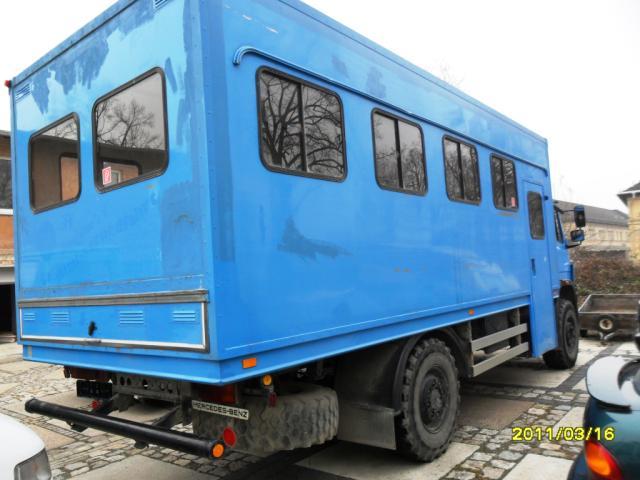

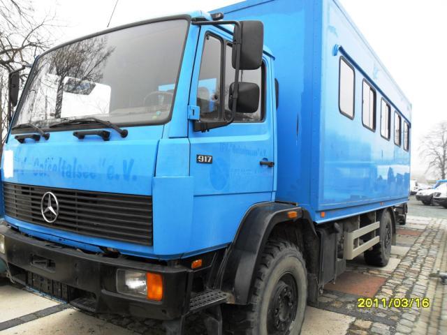

There are some brown spots on the koffer, indicating that it's made of steel.
With a koffer-length of 6m that might indicate that it'll be to heavy for a camper limited to 7.5 ton.
And there will be a lot of job to defend rust, of course.

Hi Groentas,
look into your old thread, I have given you a link to another 917.
This one seems "quite big" to handle - I would always prefere to stay shorter than 7 m total lengh (ferry boat costs ... and super market parking lots... check the "turming radius" of a longer car !) and the entrance door of the cabin is not good for driving off road. Cabin has a big overhang in the back, windows seem to be single glass (?).
Car seems to eat oil, there was an oil canister to be seem in the passengers cab on another picture - I think I saw this car already in Mobile de (?).
besides that a nice car if you can live with that.

Udo (DL 8 WP) hat geschrieben: This one seems "quite big" to handle - I would always prefere to stay shorter than 7 m total lengh (ferry boat costs ... and super market parking lots... check the "turming radius" of a longer car !) and the entrance door of the cabin is not good for driving off road. Cabin has a big overhang in the back, windows seem to be single glass (?).
I'm also concerned about the size (and weight). It should be ideal for an organization transporting tourists on Iceland or similar.
The lowest step on the entrance stair would have to be removed / lifted one step. If possible the door should be lifted to, rather than cut off. I suppose that'll be easier than lowerig the door on a koffer with flat floor.
The pictures are from mobile, yes. There's a yellow there to, which har run much longer but is much more expencive. That indicates that you're right about technical problems with the blue one. The yellow has better finish to.
