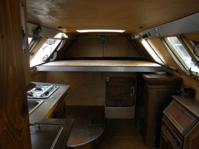

I could make it about 200kg lighter by
Replacing he Kitchen Countertops (5cm thick)
Lighter interior furniture
Removing one of the diesel-tanks. 400l is more than enough for my plans
Replacing/removing a box across under the container. Contains an emergency generator
Replacing two 11kg gas bottles of steel. Glassfiber is lighter, but not good in winter

To reduce the weight cut off the bullbar (~50-100kg) and make some new light furniture. With that you loose easily the 200kg and you don't take off the performance possibilities.
I general make sure that the truck is technally in good condition all the other things can be more less "cheap" fixed.

#12 Beitrag von Veit M » 2011-04-01 11:19:34
If I see the furniture inside I expect this is very heavy stuff.
Especially if something is made from press board this will be heavy.
Better use e.g. plywood.
Keep the spare tyre, you never know if a tyre patch will do the work and forget tyre foam (this guck out of the bottle), this will not work.

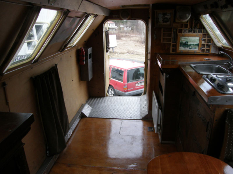

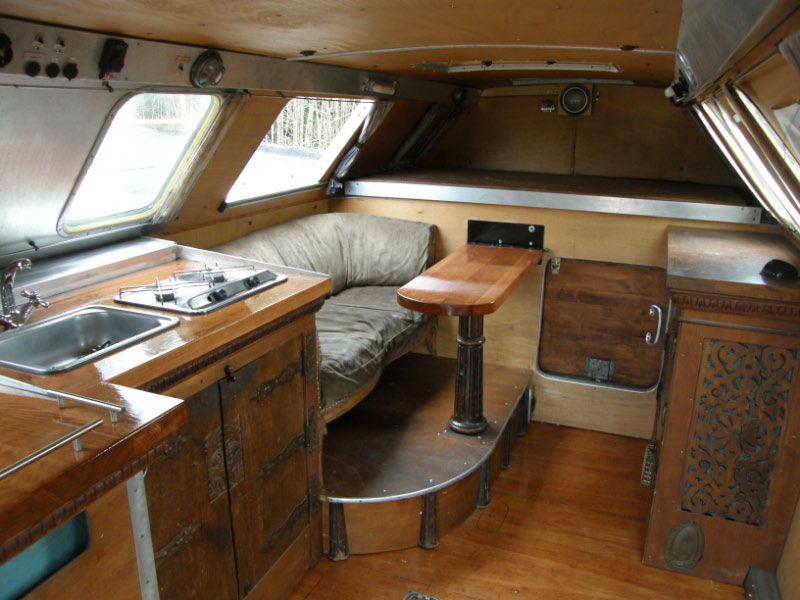

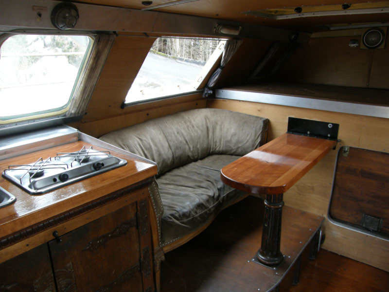

#16 Beitrag von groentas » 2011-04-07 21:02:37
Here's how it looks with sofa and table.
The picture is taken with a sidehatch open.
The seller wants to keep the sofa, so I'll definitely have to make/find my own.
I'm in doubt wether I shall put it in the same place or on the other side.
My idea is to extend the kitchen and have seats and table on the other side.
Along the wall I'll put a folded bed.
In this way I can get some distance to our daughter which makes a lot of noise and moves a lot while sleeping.
It will of course be some job to make these changes.
But almost all things are easy to move, fixed with srews to the wall.
What I can't move is the bath and kitchen.

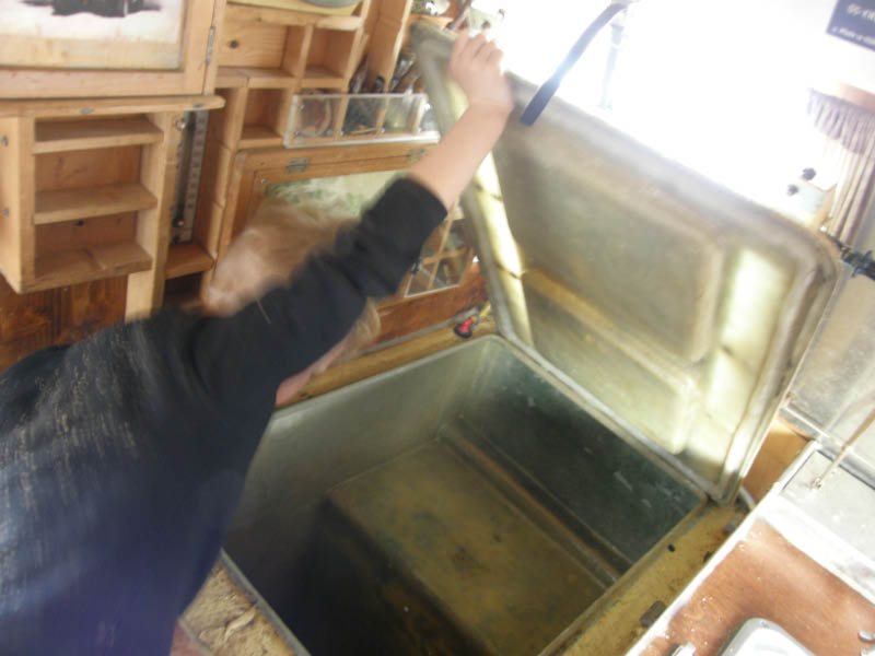

The latter has watertank and gas bottles, hot water and refrigerator, all encapsulated with glassfiber to prevent tsunami.
What's inside the closet, where I'm thinking about having the bed:
The entrance:

It's still 6 days until I'll take the trip to see the car toghether with our daughter.
According to the seller the LAK has double windows since it has been for offisers.
It's not so easy to see on the pictures, I think this one shows best.
The car itself has been for officers to.
Thus it has some original soundproofing and the electrical units are prepared for wading (1.2m?)
The latter might be useful on Iceland, but I hope I'll not need it.
I don't know if it will still be waterproof either after all these years.
Some layers with clear rubber paint might help.
The water tank is on the outer wall, inside the kitchen Bench.
You can see a picture of it over, the hatch is quite big.
To be guaranteed about freezing I'll have to put an electrical heating elemt into it.
But I don't think it'll be any big problem, at least not as long as I live in the car and have above 0C inside.
The seller says he replaced all sim rings (ordered from South Africa) after buying it.
Thus there should not be any oil leakages at all.
As far as I've understood, upgrading from 110 to 130HP should just be to adjust the diesel pump.
Exchanging the mechanical radiator fan with an electrical should give a few more HP.
I'm more conerned by the big distance between 4. and 5. gear, making speed very low if road to steep for 5.
The alcove is about 60cm high.
That's what I've read as recommended as minimum above the madras.
That's some of the reason I might want to make bed for us 'downstears', while our daughter will use the alcove.
I'v been told that the 1017 and other newer cars are much better to drive.
Thus I've started investigating / looking at theese cars to.
Any comments about that, except weight?
