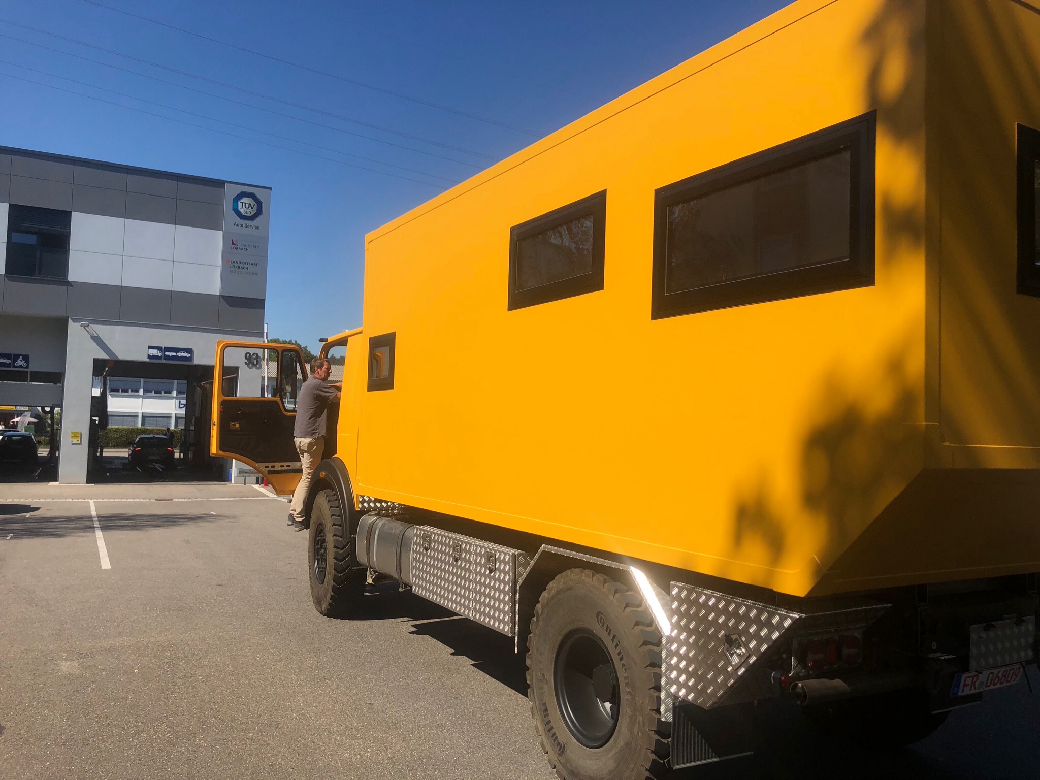

We have plastic boxes. Wonderful! Completely water proofed.
Don't know the brand and the truck is not here. You can look in the pictures in my signature.
We did buy them at Winkler.
They are attached at the box

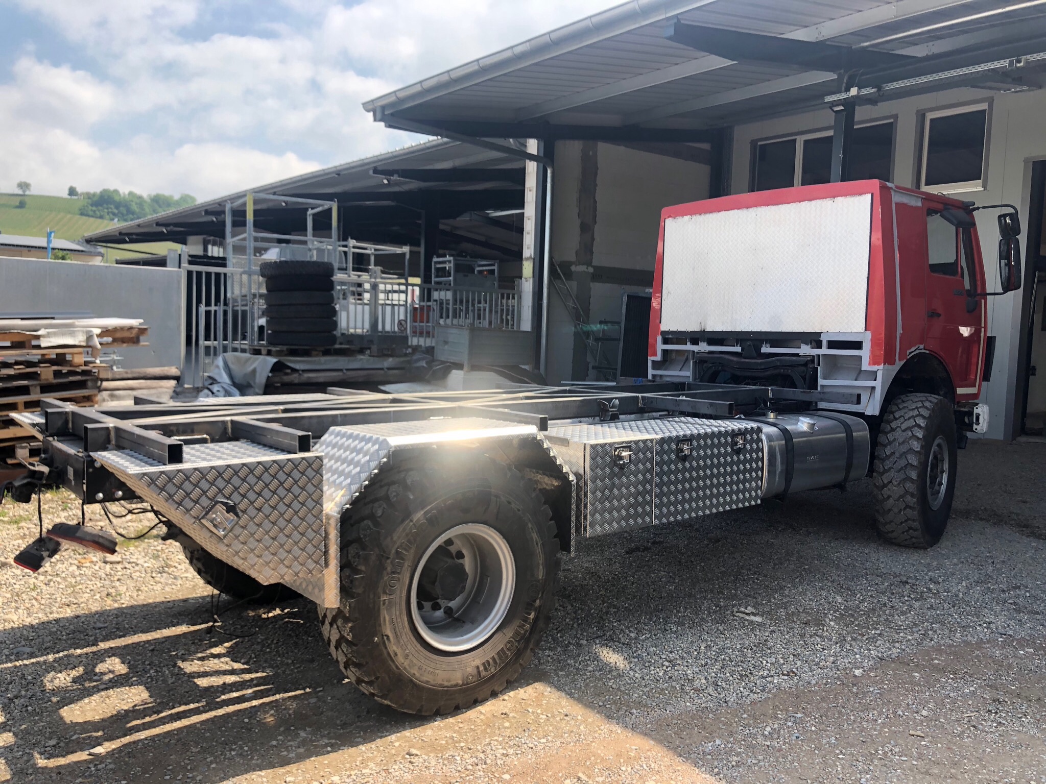

we had ours built to size and I was told, that you can’t build them yourself for that, 1500mm about 500€, 75mm in the back 350€ and mudguard 300€.
https://www.staukasten4you.de/#
Or online 2nd hand, if you lucky ;-)
good luck Roland

Frank's box look like they are from Lago. https://www.lagoaccessori.it/de/product ... rd/vertigo
also available at https://www.staukasten4you.de/staukaest ... stoff/?p=1
