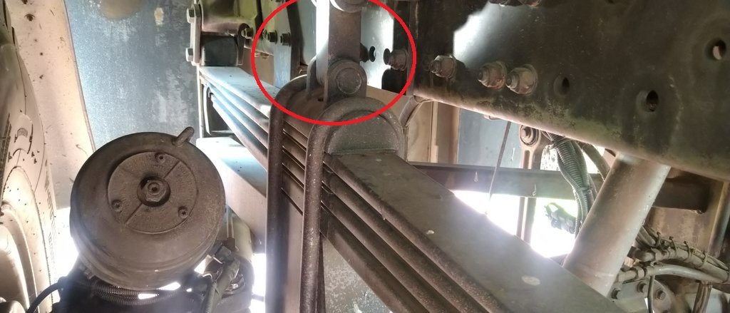

Ok, I get it now. It has parabolic springs (Parabelfedern). I looked at the frame and it has the usual C-shape normally used in regular trucks. It does not have a frame profile used on MAN KAT trucks.
I did not want to have an air suspension. I plan to travel into some extreme locations, such as Siberia in the winter or Pamir Highway or maybe other places initially planed by this Swiss couple - https://www.4-xtremes.ch/adventures/xtremes/ so that would be one extra potential problem to worry about.
Nothing wrong with air suspension, just one less thing to worry about.

Rear wheel steering components:
pairospam
Beiträge: 934
Registriert: 2010-11-22 14:27:25
Re: Project: Think Beyond Limits - Actros 4x4x4
#26 Beitrag von pairospam » 2020-06-03 18:57:59
Hello, Jerzy:
Good to hear from your project again.
I cannot see well from the pictures. Can you tell what is this piece attached to?
tooFATtoDRIVE
Beiträge: 180
Registriert: 2017-06-16 20:46:29
#27 Beitrag von tooFATtoDRIVE » 2020-06-03 19:06:02
I will take some pics of this part.
Because this was an airport sweeper, the setup you circled in red is designed to limit the wheel movement in the up and down direction. On the runway all the attachments would be in more or less set position. The limited wheel movement would protect them should the wheel hit a hard patch of ice, jump over it and then compress hitting the tarmac.
For the offroad use this will, of course, be removed.
pairospam
Beiträge: 934
#28 Beitrag von pairospam » 2020-06-03 20:36:10
Okay.
Waiting for the pictures to see how that thing is and how it works, I wonder if this is one of the reasons you found the truck so stiff. Also, the 16:00R20 are big monsters and, full inflated, they tend to make the ride very rough.
What you know is true, according to my research, and you cannot modify at will a parabolic spring setup. Okay, neither a leaf spring, but it is a little less dramatic.
Looking the setup for the rear steering and the overall rear suspension it is of no surprise that the truck weights 11 tons alone. It is a quite massive steel batch.
Greetings.
Pairoa
willem
Beiträge: 646
#29 Beitrag von willem » 2020-06-03 20:49:03
Neither heavy steel nor 16.00r20 are a reason a truck cannot be comfortable! It's of course hard to say from only a forum post, what somebody calls uncomfortable or not.
But maybe, first try remove those vertical travel limiters before considering anything else. To me, it looks like they stop any suspension travel, and actually your 1600 tires are the only suspension you have :ninja: It might be a difference of night and day.
tooFATtoDRIVE
Beiträge: 180
#30 Beitrag von tooFATtoDRIVE » 2020-06-03 21:03:57
The tires are actually even taller. These are 445/95R25 so approx 1480mm tall. The 16.00R20 tyres are 1350mm tall.
I agree that the limiters need to be removed first before I take it for a test ride. I will play with the tyre pressure too. These limiters are not present in the front, however, yet this is where you first notice how bumpy is the ride.
Should the above be not sufficient, I might have to change the parabolic springs. Luckily the length are the same front and back so if lucky, I might only need to replace the front ones (the existing ones would be fitted at the rear).
Any other suggestions?
