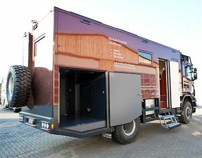

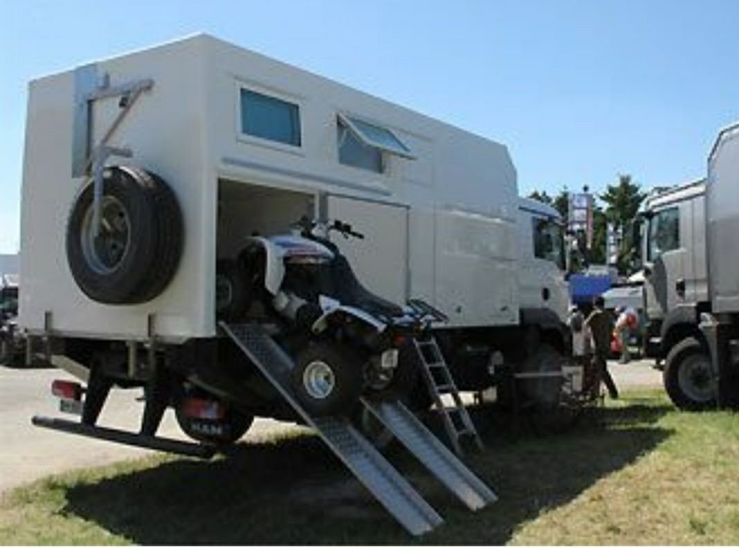

Moin! greetings to all, there are great contributions in this forum, I love it.
I come with another doubt that the experts recommend.
I'm going to build a chassis and we want to bring an ATV or quad in the garage, under the bed.
So that we have 1m of height in the bed, and the garage below with the necessary height for the vehicle.
What do you think is the best solution?
Where I live there is no experience in these vehicles and any contribution would be very useful to me!
Regards

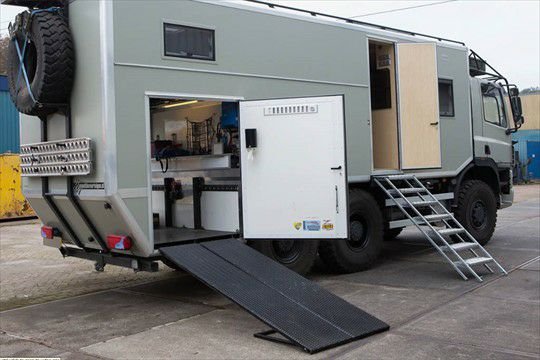

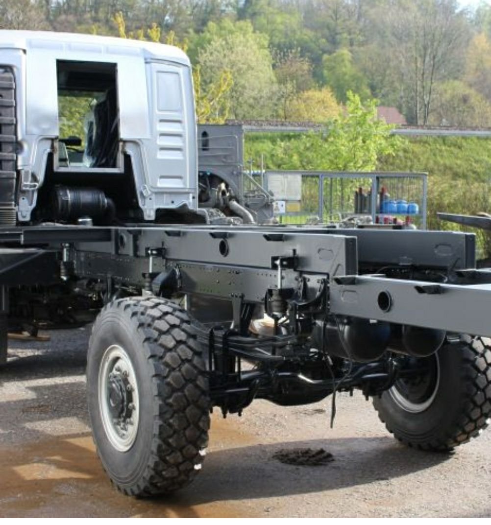

I have sent this image and resolves in part, what do you think of the experts? Regards
Beiträge: 2832
Re: S-shaped subframe construction
#3 Beitrag von hugepanic » 2019-04-14 14:12:11
that Z-Bend in the last picture does not look well designed.
The overlap looks pretty small for such a big profile. -->
OR the profile is way oversized... anyhow, it looks weird and that is never good...
Usually you want champfered ends of such profiles to allow a smooth load transition.
