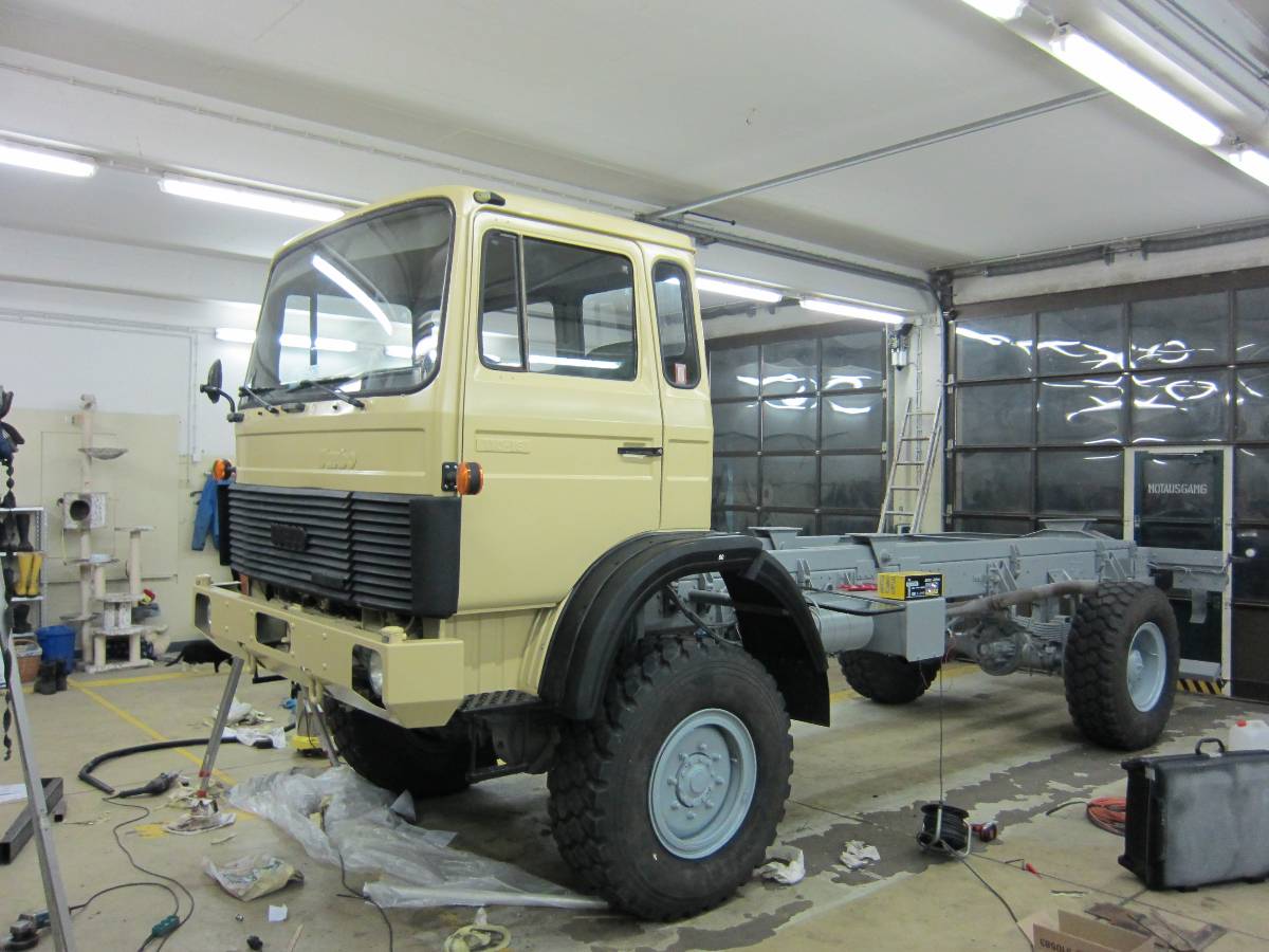

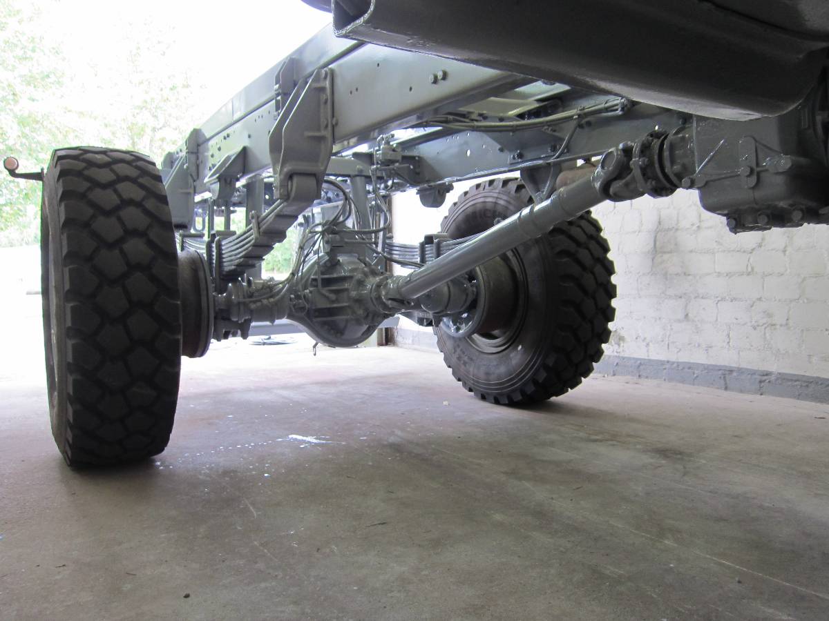

Hi just wanted to share a few pictures of my refurb of a Iveco 110-16. This is as far as i have made it so far but im happy with the result. I had a bit of body work to be done on the cabin due to corrosion but got it sorted quite well so it should be a while before i would need to work on that again. It was a terrible job so i hope it will at least be a few years..... God how i hate to work in thin plating. Painting was fun though and im pleased with the result. Now on to the fun part with design and construction of the living quarters!
Feel free to comment in german if you have any comments or suggestions. I fully understand but just struggle with the gramma so can not write it!!
gruess Allan aus Sunderlygum in Nord Friesland.

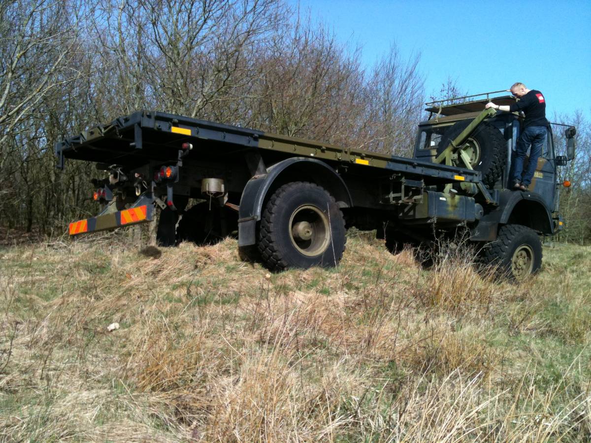

How i got it
How i got it

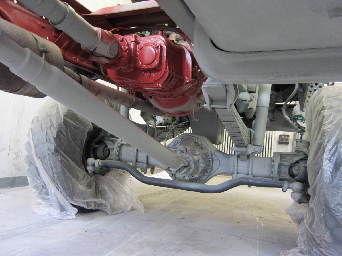

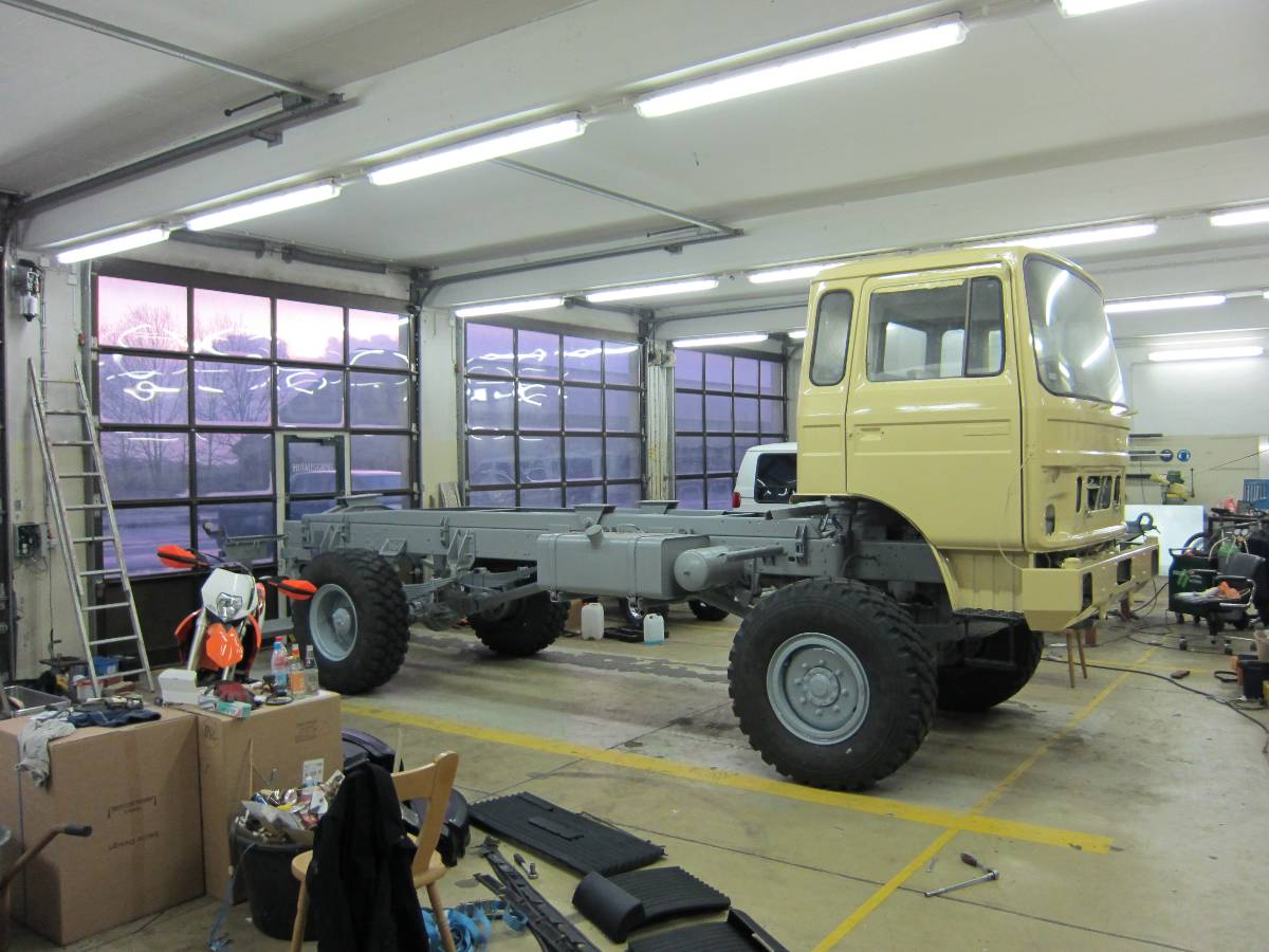

frame painting after rust removal

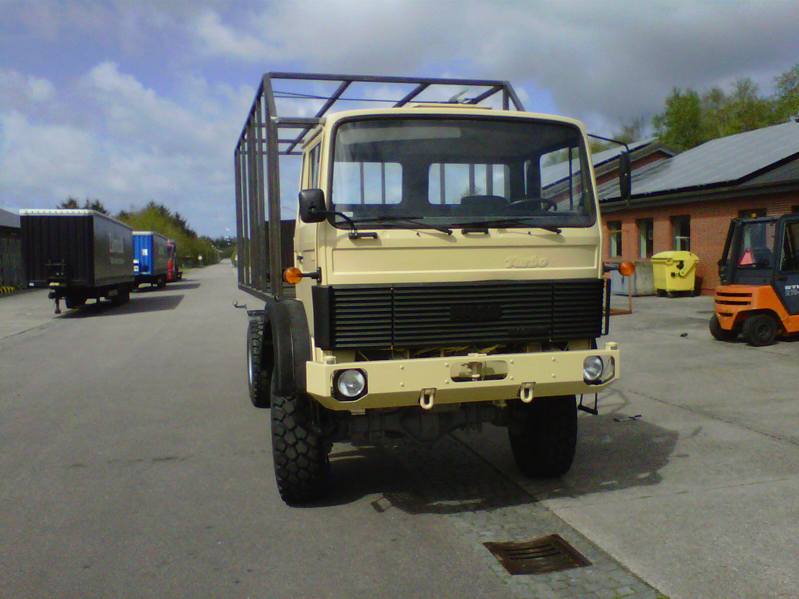

final coat "staub grau" makes any leaks or defects easily identifiable, and by the way looks great!

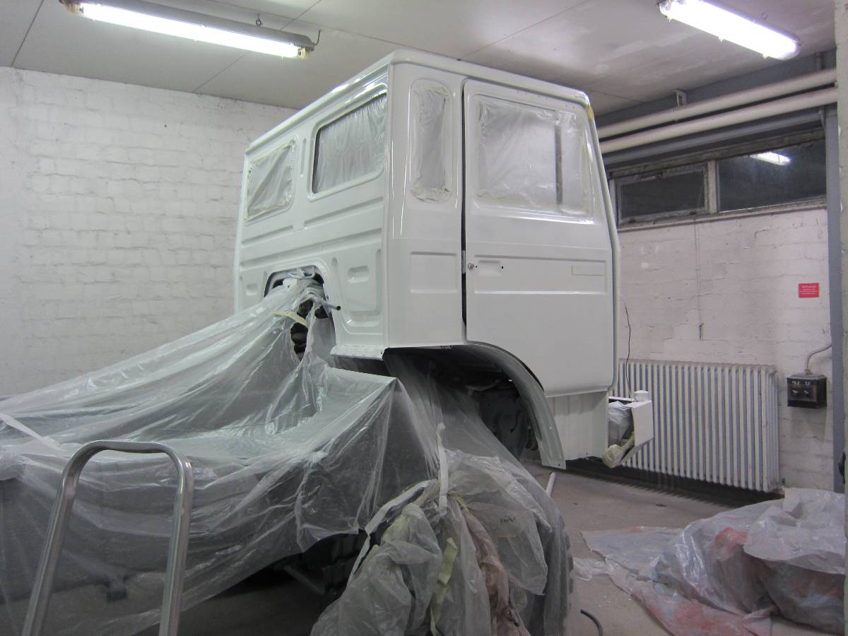

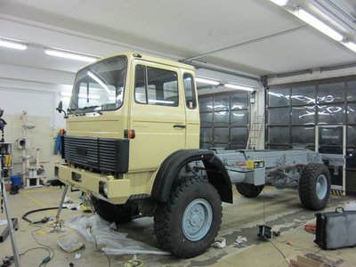

Fahrer haus priming coat after filler and sanding any steel repairs
Final coat. Not sure about the colour, not so "sandy" i was hoping for but more baige.....

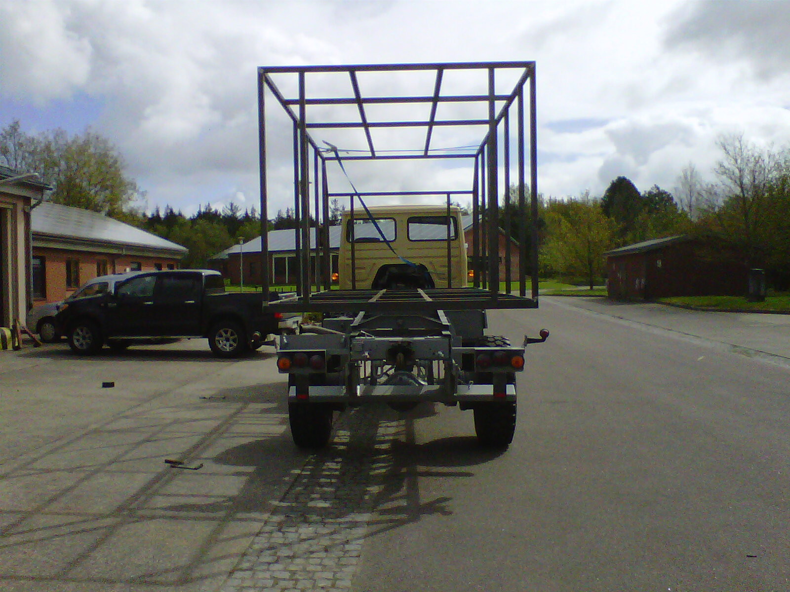

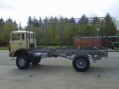

This is where i am now. Will not do anything inside the cabin for now but move on to the construction of the container. I will make it 6 meter long and only 2,3 meter wide as i dont want a to "fat" look once on the truck:-)

Hi, Allan:
Nice truck and pretty nice job for sure.
How did you manage to clean the frame and components before painting? Did you dissasemble them?
I am having a hell of work taking off the cables, piping, tecalans and some supports to clean every corner before even thinking of painting my own truck.

Hi Pairospam,
For the preparations, i think you are overdoing it by removing all the cables etc. I also have to restrain myself from not going overboard and take all appart to make it perfect. I dont know the condition of your truck but mine was with only minimal rust in a few places. Taking everything appart will only risk that it will start leaking etc when assembled again. Especially the air system i dont want to mess with.
I used a HP steam cleaner for everything and with the 125 degree celcius steam, it removes all grease, tar and even rust scale and loose paint. I used a cup steel brush on an angle grinder to remove any remaining rust and that was it. For very tricky spots on the transmission etc i used a hobby sand blasting gun.
For the painting, i used marine paint from Hempel as it is far better than what you get from a normal paint shop and buying for a complete truck in a local car paint shop will cost a fortune. Use to different colors for the primer though, it makes the job so much better if you can see any corners etc not covered by the second layer. A spray gun will make the job almost fun and so much better than a brush. It also allows you to apply a thicker layer of paint. The marine paint also helps here as it does not have the tendency to run as easy as other paints.
rgds Allan

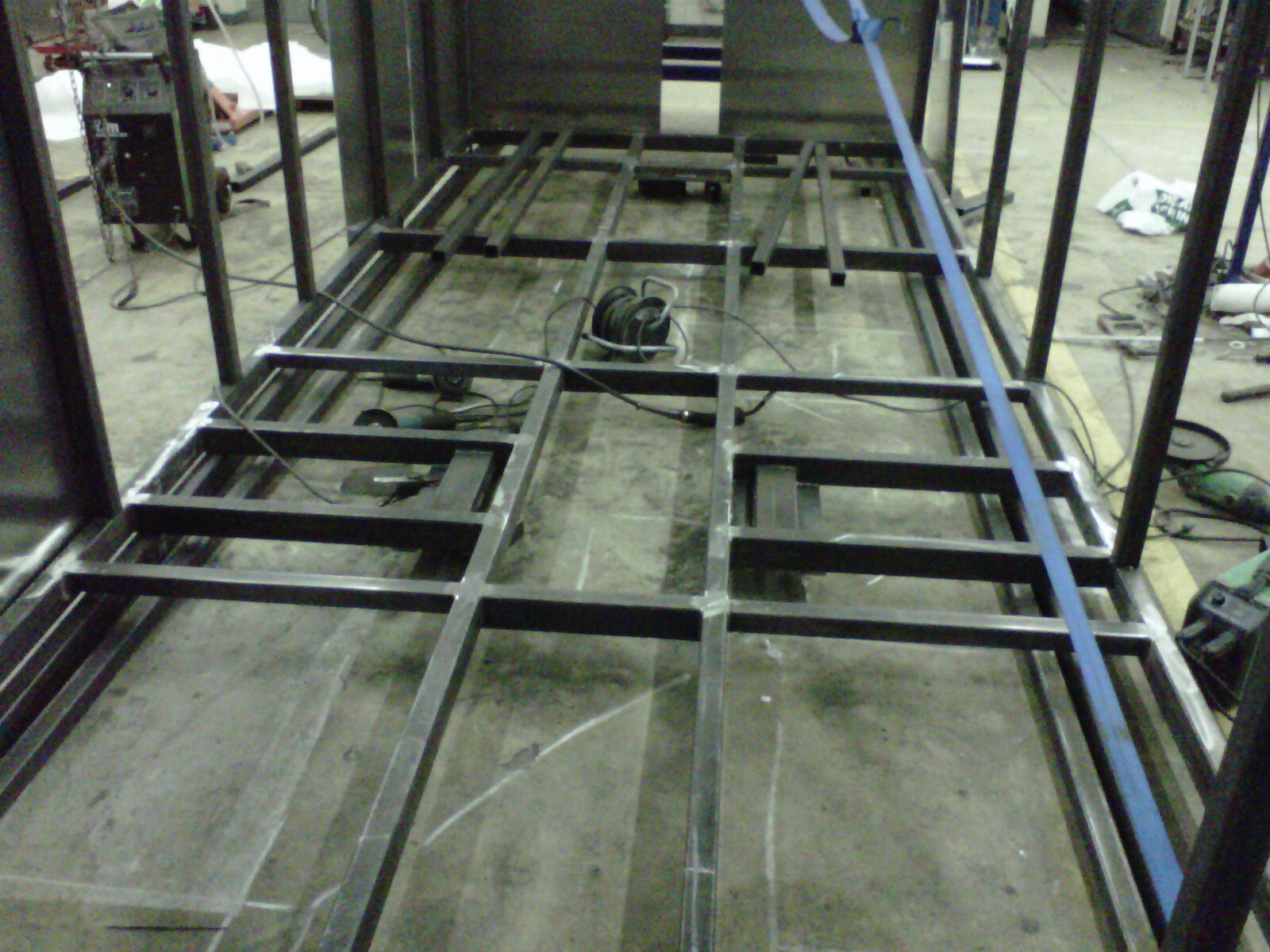

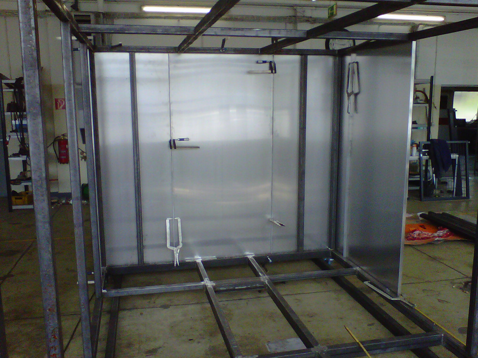

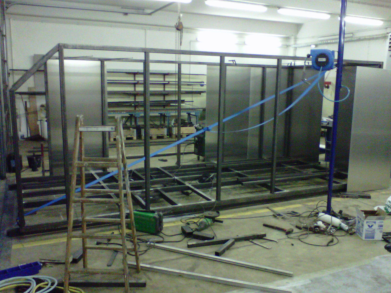

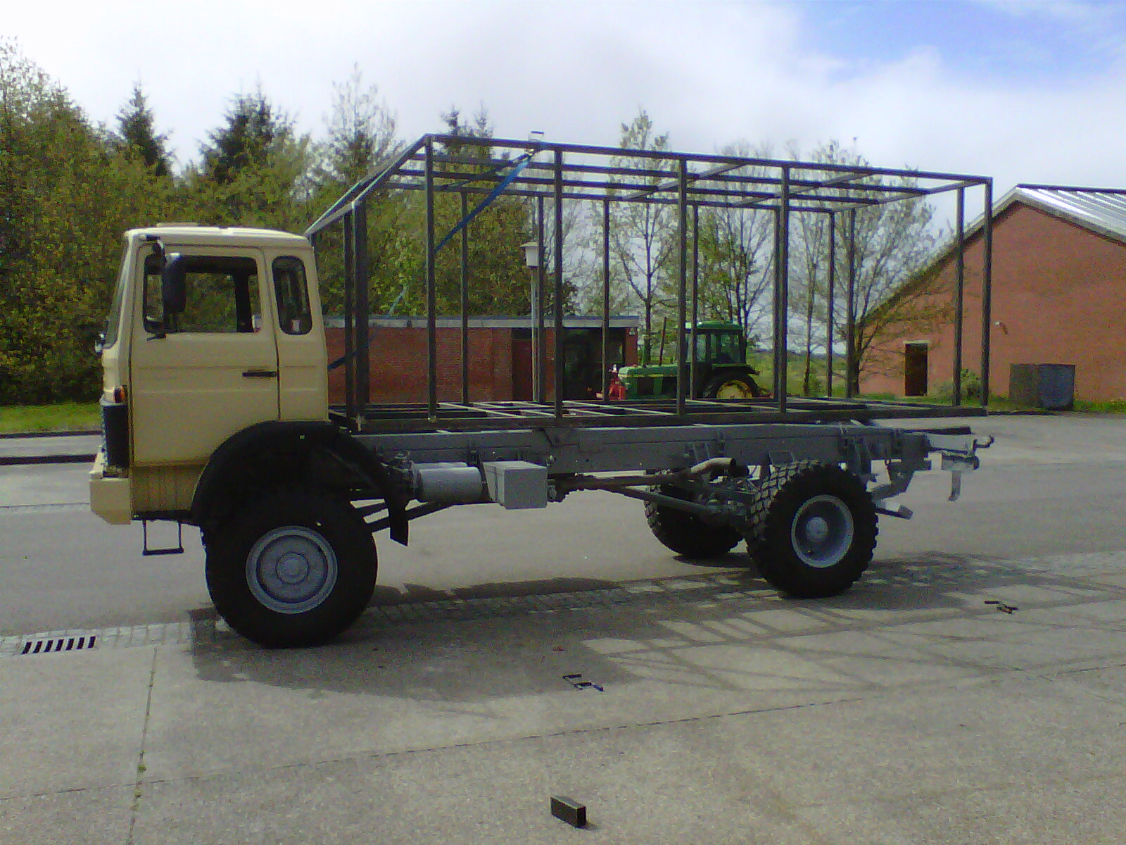

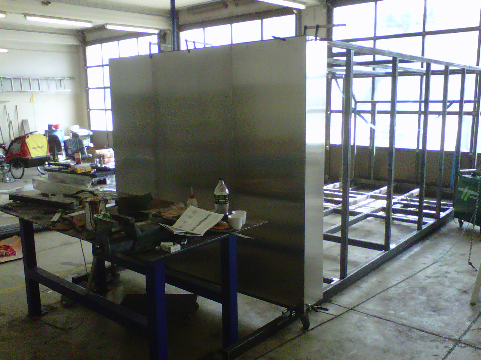

Set back by work quite a bit (what a waste of time..... ;) but finally got a long weekend to get the cabin started. Went quite well and im happy with the proportions and progress. The plating solution will give me no visible rivets and it will end up looking quite "clean" with only an angle on the top and bottom. Need to find a nice one like the trucks have on the reefer boxes though.
A few pictures of the progress so far:
Note the 50x50 profiles are only tagged in place for stength during welding but will be moved to where the plates join each other.
plates are bend 25mm on both sides and will come together at the 50x50 steel profiles and rivetted together into the steel profile. This should give a clean snug fit without visible rivets.

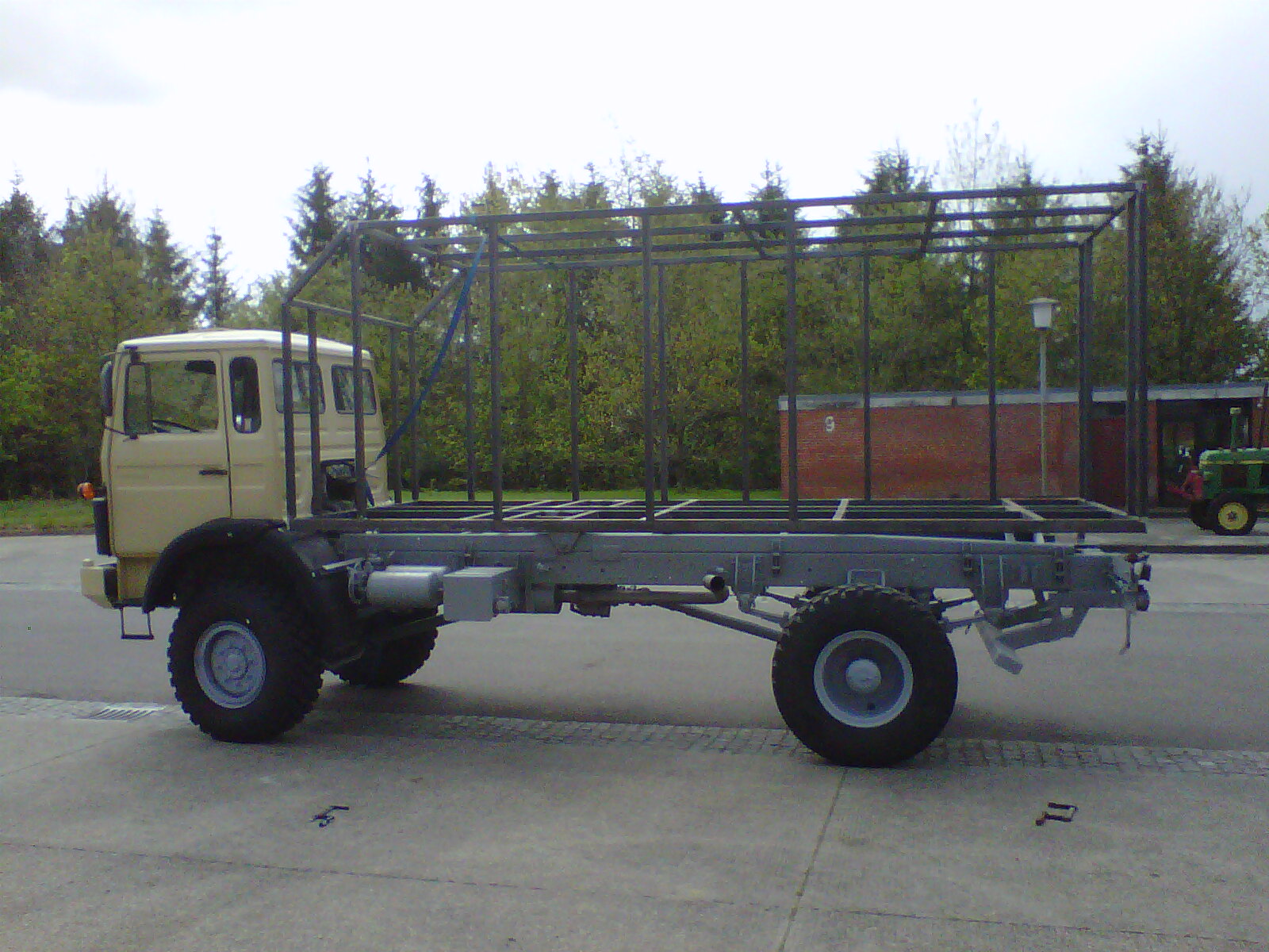

Spare tire fold down bracket and a platform for a dirt bike will be fitted later
Cant get along with the baige i think..... think i found another color called "pfeffer3" i like a lot better so will have to re-paint....

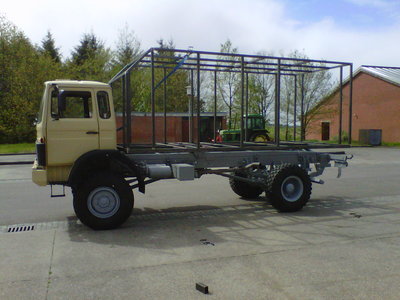

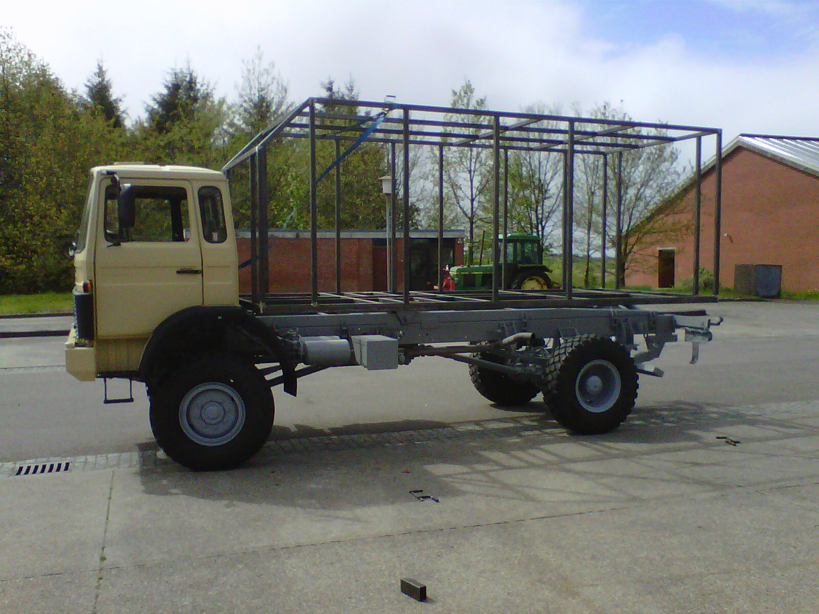

Checking the brackets and marking up for the holes. Also checking if i like the proportions compared to the truck and think it works out great.
Made a F/U with the brackets and had to re-do them. This should work though. 10mm plate with box profile inbetween.
Frame comming together
