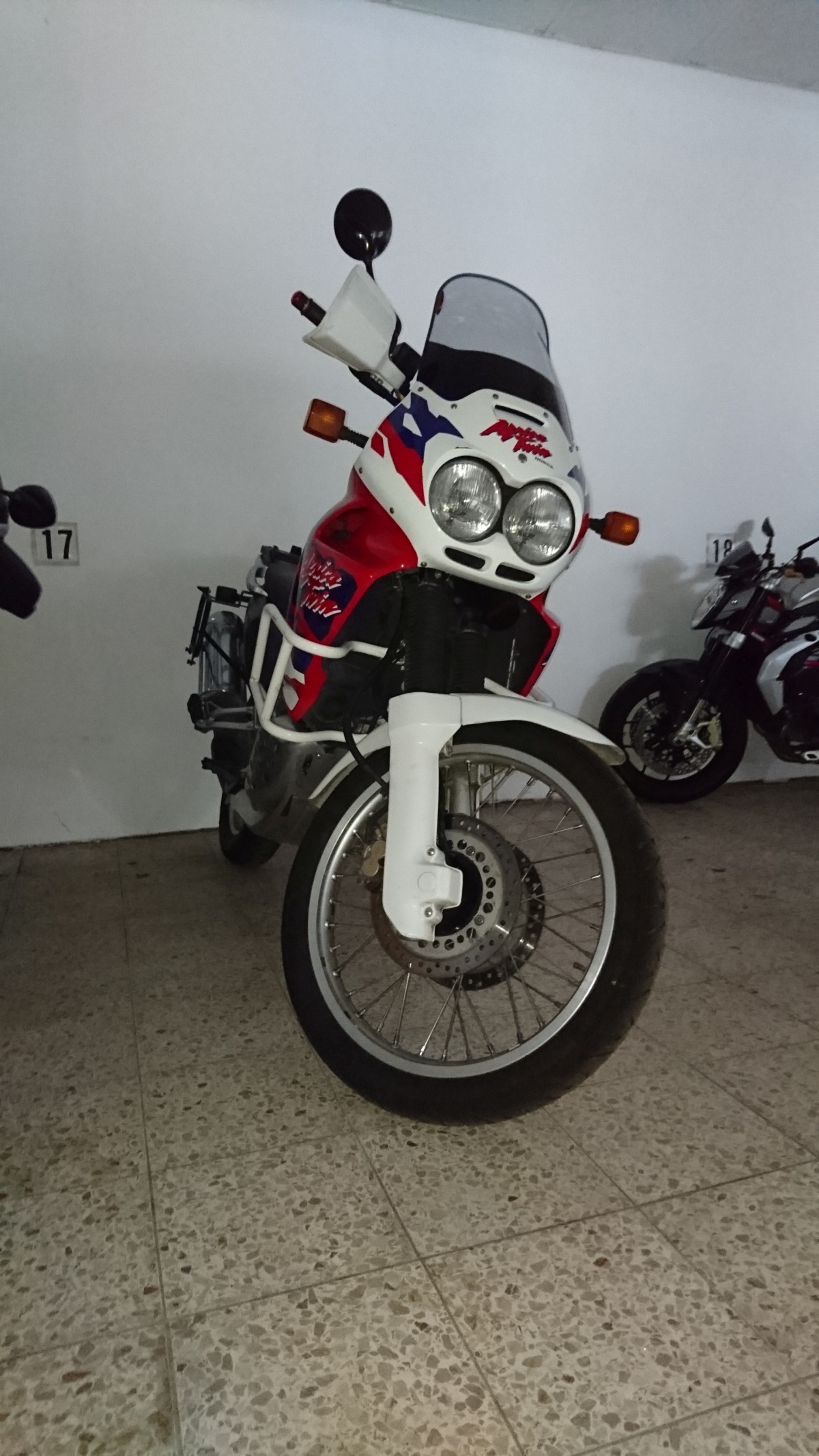

It's great to watch the progress and your constant enthusiasm still not beeing exhausted... Great job, thanks for sharing it with us!
And: I like your Bike! ;-)

@Rumpelstielzchen: thanks for your words. Many people like the Africa Twin, especially now that there is a new one that is not as good as the old one... at least according to me. The one on the picture, is it yours?

@pairoa:
Yes, that's mine. Had a RD03 for many years and nice tours, then gave it away due to house and dogs and lack of time. Now I got the Virus back, so I bought this RD07A recently. Unfortunately still too little time for it, as always. Did you ever try the new one? I haven't yet...

Yes, I have tried it, pretty hard... but it was not the same feeling... there was no love.
Ride, ride her! Use the Africa Twin even to go to the bathroom!

No Love for the new one, I can understand that.
And goin' to the Bathroom with the AT? Yeah, nice Idea!
Houses in South America seem to be MUCH bigger than over here... :-))
