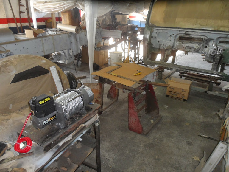

I took out one of the winches from its original box, or what was left of it, and measured it all again. The idea was to build a compact box around the winch and bolt it hanging under the front crossmember, the more compact the arrangement the better, not to compromise too much the angle of approach. Considering the position of the radiator, some centimeters behind the crossmember, there should be enough space to hide the winch behind the fender, at least partially.
It was pretty useful to have the front crossmember of Spare to play with a little and to help for the measuring of the different components of the future winch support.
It seemed a good idea to make a mockup of the support/container with carton board to figure how things would look like and fit, and that’s what I did. The superior plate would be bent to follow the form of the cross member to which it would be bolted. The compactness would confere strength to the structure. The inferior and frontal plates would be one-piece mounted on hinges on the rear for easier maintenance and removal/installation of the winch.
With such an arrangement there was enough space left between the baseplate and the radiator. I was only concerned about the strength of the whole construct. I thought that a baseplate of 6 mm was a little weaky for a 20.000 lb winch, but that was what the manual said. Anyway, the mockup showed also that the front bumper plate would be intervened minimally to expose the protruding control box and the engage/disengage lever of the winch. The angle of approach would not be critically compromised. All in all, not bad.

The case would go bolted to the cross member from above, to the original defenses on the sides, but from behind there had to be a quiet solid structure to anchor it from. An 8 mm profile bolted to the frame rails would provide a good support and, even if I had to cut a little strip to allow the radiator stand freely behind, I was very fortunate that I could make such an arrangement without interfering with all the other stuff that ran by the place.
Concerned about the performance of the radiator with all that stuff in front of it? Yes, but just a little.
Saturday morning Carmen and I woke up early… no, not really, got in the Montero and drove south some 300 km. It was the wedding (the second one) of my cousin Daniela and the reception was in an idilic place in the country, on the gardens of a typical adobe house of central Chile. My cousin was pretty happy, the buffet was delicious, the ceremony a success, the pool very fresh and some of my cousin’s girlfriends very cute. Hmm... It was hotter than San Felipe because of the humidity, but it was a very pleasant moment.
We spent the night at my aunt’s, Daniela’s mother, and my uncle, a pretty skilled pilot and craftsman, showed me the right product to work the HDF lining panel of the Merkabah with. It was a special glue that resisted water and heat, unknown to me. Hugo used to build boats, so he knew what he was talking about.
We came back home by the coast instead of the highway, just to scape the sun, to watch the landscapes and the sea, drive a little on the sand, eat a good fish at our favorite restaurant in Duao, and to briefly visit a friend in Pichilemu. Wrong choice. We got stuck in the summer traffic for hours and arrived at 1:30 AM. This time I will not say: never again!
Sweating heavy, I started to cut the plate to build the case for the winch Monday afternoon. I wondered again if it had been a good idea to follow the manual this time and make it with 6 mm instead of using a thicker plate. A good design and solid welding should be okay, I repeated myself. Anyway, I went on based on the mockup design and spread sparks everywhere, as usual.
After some cuts, semi-cuts, folding and bending the half-case fitted pretty well on the curved crossmember. I only wished that both this and the one of the Merkabah were exactly the same.
When I put the massive winch in the case to make some measurements it looked like the plates were made of paper instead of steel. I thought about making major reinforcements... or should I do it all again?

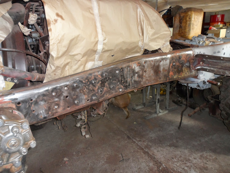

Saturday morning the wills to use the paint gun almost burned my hands. I displayed the stuff to have the right amount of room, light and ventilation, and prepared enough catalized washprimer, at least what I judged to be enough.
I started with the components of the case of the winch and then added other parts and pieces that were waiting for their turn in the piled boxes everywhere. I also finished to prepare the zone that would be patched in the front of the cabin and then applied three hands of washprimer on it. Better safe than sorry.
Some other parts showed up, like the steering knuckles, the supports for the front air springs, etc. I primed them all and then had to wait for them to dry up to manipulate and prime them the other side, wait again and repeat it all one more time for two hands of primer. It was a slow job, as always.
Once the washprimer covered all the pieces I started applying the primer. In the beginning I found a few little empty cans only and I was starting to worry because the store would open only next Monday, when I finally found the big can that I had bought some months ago, buried under a ton of dust, spiderwebs and dog hair. I prepared a lot of primer to avoid preparing lesser amounts each time. Error.
Lots of parts and pieces and lot of time to prime them all. Unfortunately the catalized primer became thicky before I could finish and had to throw to the garbage a non-negligible amount of it, then cleaned meticulously the paint gun and prepared more primer. Lazyness doesn’t ever pay back.

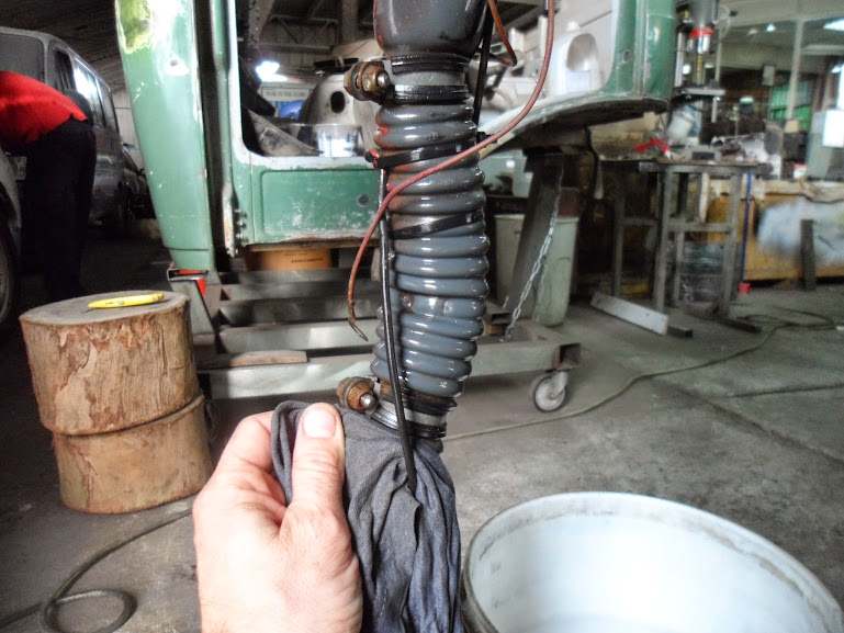

The steering pump was exposed, and all the dirt it was still covered with. I would have to clean it up before the rest of the chassis. Hmm…
I went to work and came back the next day to clean the pump but I got distracted for a while putting in order the parts that were around, and I realized that one of the supports for the auxiliary front shocks was missing. I found it later inside one of the dozens of boxes, halfway prepared, but I also realized that I had not finished with the front suspension issue and the holes for the bolts of the supports had not still been drilled.
As sincerely I was not on the mood of playing with gasoline at that moment I grabbed the drill, a little oil and a big bunch of drill tips and began to make the holes por the supports on the frame rails. Trying to take care of the drill and the bits makes you not very fast so it took me quiet a while to drill both rails, and I got pretty tired.

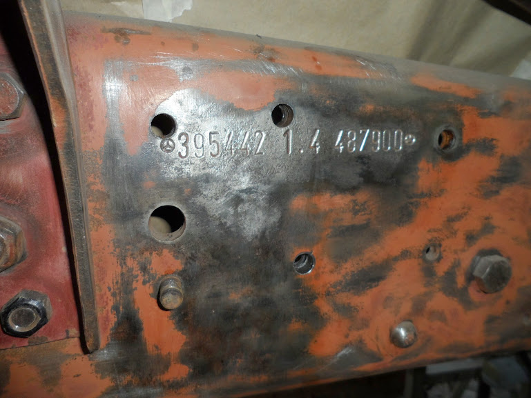

The chassis number would be half covered by the support so I took many pictures of it. I hope the guys of the local TÜV will never ask me to take the support out to check the number, as it is printed in a plaque on the cabin. I hope…

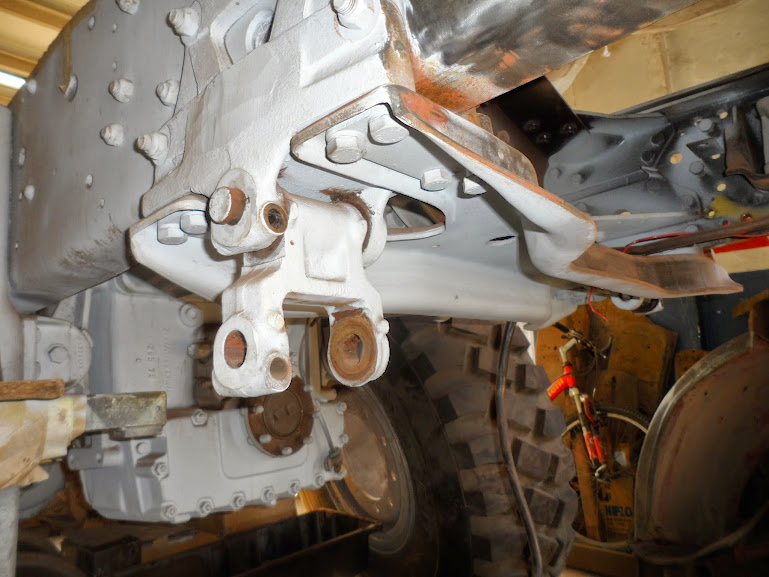

Soon as I arrived the day after I opened the big wrenchs box. I decided to take all the supports out of the frame to clean appropriately the rust and the dirt off. It would be too hard to clean in between them. Particularly between the supports of the cabin and the mudguards. They had to go out.

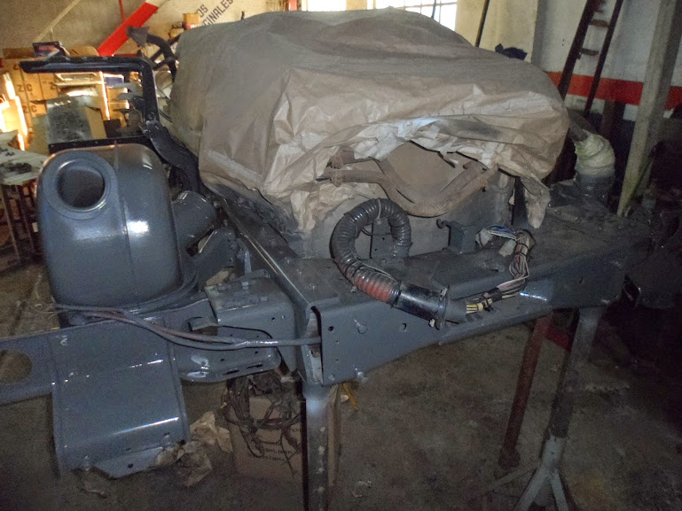

The firsts to fly were the supports for the bumpers and for the head lights. I would clean them for good while they were out, then I would paint them and finally assemble all when ready. I would also flatten out the support of the right bumper that was a little bent.
The coolant reservoir, mounted on the mudguard support, also got out after a brief hesitation. I was not keen on manipulating it but I said to myself that at this point of the story it was of no importance to disassemble a little more. Out with it.
Free from the supports, the steering pump was completely exposed, dressed in dirt and oil. I grabbed the manual tools and cleaned it as completely as I could and then brushed it with solvent. After a while I was a little high, smelling heavy of gasoline, but the pump and the hoses looked much better.
I was going to replace the textile-covered hoses, they were so soaked in oil that they would never be cleaned, and they were as old as the truck.
The frame rail was almost ready, without the supports, almost naked and ready for priming and painting, but the hoses and the pipes of the steering ruined the landscape. I realized also that I would never get to clean the pump “comme il faut” if all the stuff was left in situ, and so, this was the next move before thinking on painting the frame.
The pile of removed parts and pieces was growing by the minute, and it seemed that it would never stop doing so. There was so much work waiting for the next days. Hmm…

I removed the ATF reservoir and all the hoses and pipes. It was a mess, but at least I would be able to clean properly all the surfaces and replace the hoses.
There was still a lot of dirt behind the support of the reservoir, impossible to clean with the thing on. Fortunately it was just oil-mud, and I began to clean it manually and ended up with gasoline and then with metallic brushes. When I stopped, half poisoned despite the mask, it looked better, but it needed a little gritblasting to do a good job.
Pretty slowly… I was making some progress… but pretty slowly.
And again it was Saturday, and I was alone working at the workshop, for a change. The self imposed task of the day was to prepare everything for priming on Monday. Maybe I was aiming too high.
I took out a little support for the exhaust and another little dirt and a little grease were revealed in between the frame rail and the rear support of the spring pack. I got distracted trying to remove it all but it was impossible. Some of it will remain there forever.
With a combination of CSD discs, metallic powerbrush, laminated discs, manual brushes, sand paper and the teeth I peeled off the frame starting from the left side. I proceeded making the necessary pauses to let the forearms and the arms to rest and the powergrinder to cool down. It may seem easy, but it took me a few hours, and at every minute I was covered more and more with dust and old paint.
The steering pump was impossible to clean completely, like some other hard-to-reach spots, as expected, but I did my best, that way I would have to blast the less.
The frame, at the end of the day, was pretty clean, though the flash highlights the remainder primer. It was a really hard and dirty job, but it was worth.
As I prognosed before, Monday afternoon the truck was far from being ready for priming. I calmly wrapped again the engine with paper and sealed it as completely as I could, including the radiator funnel. There were only a few spots where the gritblasting was going to be applied, but the metallic grit gets to every corner and angle, even where you may not expect it to go.

The right springpack was still in place, I do not remember why, so I took it out along with its support and then I masked the rear portion of the frame starting from the middle crossmember. I would paint the rest of the frame later, not then.
I put the bunch of wires in a box and sealed it as good as I could and put my mask on again. I then swipped the place very carefully in order to remove any metallic debris that could be recovered from the the floor along with the grit. After one hour I thought it was clean, but I used the magnet and there were still many steel mesh hairs around. Hmm…

I was very proud of the finition of the filter housing but there was a little defect on the paint in the upper part. I profited to retouch it but the retouching ruined the former paint and I had to paint it completely again, without reaching the same quality. Hmm…
I had to wait for the paint to harden a few days so I spent the time cleaning the rest of the electric bundle, with a vertiginous pace of one hour for every 50 centimeters. That dirty it was.
When I cleaned the wires for the front lights I painted them in grey not to see the red ancient color of the truck. I profited to make some other retouches, not caring about the finition this time; no one else will ever see it apart from me. It went very good, in any case.
Saturday morning Eduardo and I went out for a little ride. The valley of the river Aconcagua looked splendid in its early autumn colors dressing, but the feeling was of uneasiness, thinking on how fragile we are when it comes to nature to decide our fate.
In the afternoon I went to the workshop and worked only for a couple of hours on the truck. I had to change the orientation of almost all the bolts that I had put on to hold the supports in place and tighten them for good. The paint on the bolts suffered but, all in all, the damage was not as bad as I expected, and it would be done a retouch when I painted the rest of the chassis. The filter housing was also put in place, I made some little order with the wiring, tighten some nut here and there and that was all.
I wanted to finish with the front chasis so I continued with the assembling of the most parts I could. The winch was the next on the list, of course. The big guy was pretty hard to handle. 58 kilograms always are.
According with its size and weight, this was one of the most difficult parts to put in place since the beginning of the project, but I will save you from that, for once. The rope and the roller sheaves did not work as wonderful as expected so I had to ask for help. In the end many hands helped the winch case to be bolted to the ad hoc crossmembers, and even then a little and gentle help from the hydraulic jack was necessary to complete the job late in the evening. But… I finally installed the bloody winch!

But why did you mount the winch that deep in the front.
It seems that it is located under the front bumper.
This may limit off road ability.

landwerk: I am looking forward for the finished truck too! The position of the winch is the cheapest compromise I found; some degrees were lost from the angle of approach indeed, but I estimated that hard offroad use is not going to be the major use for the truck, so be it.
