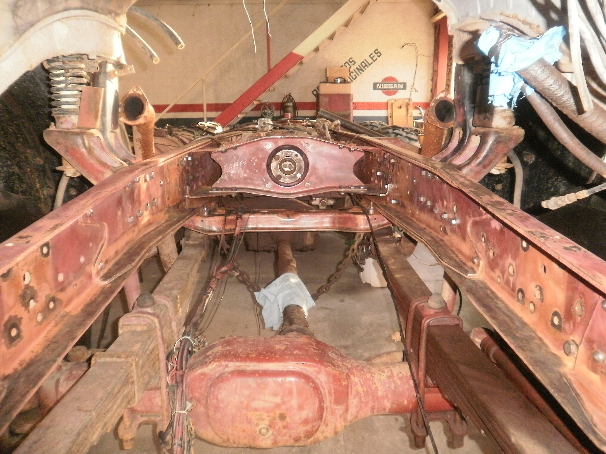

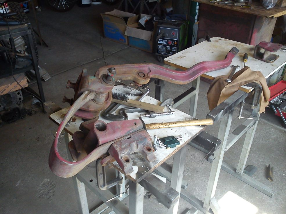

Well, it’s been a while since my last update and many things have happened, some interesting, and some less interesting, some good and some not so good.
I wanted to define what the issue of the painting of the frame would be at the end for I had many ideas and recommendations. As the frame itself was not yet available I took the pieces of the front sway/damping bar of the cabin to experiment with them.

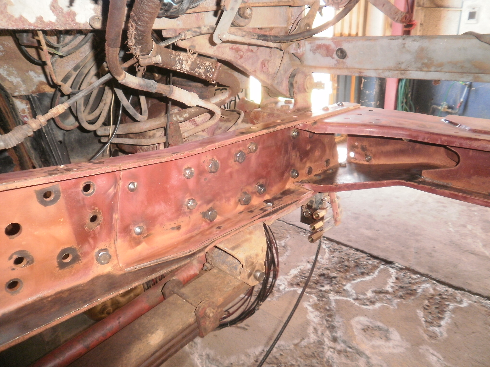

Of course the first step was to clean them and I dedicated to the labor enough time to make them shine as usual. Some people, very practical people, told me not to waist so much time cleaning and to paint at the end the whole ensemble, probably a very good idea but impossible for me to follow at least with the parts and pieces of the engine and the cabin. Perhaps once the truck was in the shop I would think differently.
I almost burnt out the Chinese version of the Dremel tool but I reached to repair the excess of welding of the pillow block. The bolts, as from previous comments, were in pretty bad condition and I could rescue only a few of them so I went out to buy the rest of them in a shop nearby. I also bought the bolts for the engine’s exhaust manifold but I asked this time for stainless steel bolts. I thought that I would not have to cut them again if I had to disassemble the engine again if they were made of stainless steel but soon I was told that it was not the only nor the best of the solutions; it is better to use a special copper based gel to avoid rust to develop on such location. Hmm…and those bolts were not cheap at all.

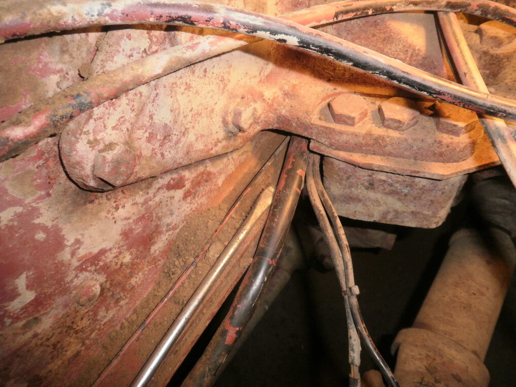

Once the right pillow block and its parts were disassembled I took the left one that included the swing arm for the cabin that made the bloody heavy steel set hard to handle. I remember having made a shy try to take off the hub because I wanted not to damage it more than it obviously was, no way. I left both blocks submerged in kerosene to help loosen the hubs, a little at least.
All the parts were covered by rust, mostly superficial, and when cleaned I found out that the spring leaf was also fractured. Bad. The pillow block was fractured as expected but the repair by welding was satisfactory as shown in the pictures. There were no more surprises and all the pieces were prepared for painting.

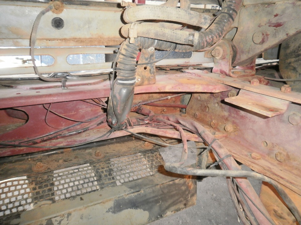

I was at work when the sway bar repair kit arrived and to my surprise and joy it included both hubs. I took the pieces from the kerosene at once and with the stabilizing help of two of the mechanicians of the workshop I hammered until both hubs were out not caring even a bit for them. When the pieces were apart I finally could prepare them for painting too. The best days of the teflon bushings of the leaf springs were passed long ago.
Even if I knew that the fractured leaf spring could not be trusted I spent a little time to weld it and left it apart for who knows when or what kind of emergency. You never know.
Then, after some local research, I bought a can of Chilco46 rust-converter enamel and used 5:1 poliurethane thinner to aplly it with the paint gun. Great! Good covering and very low consumption.

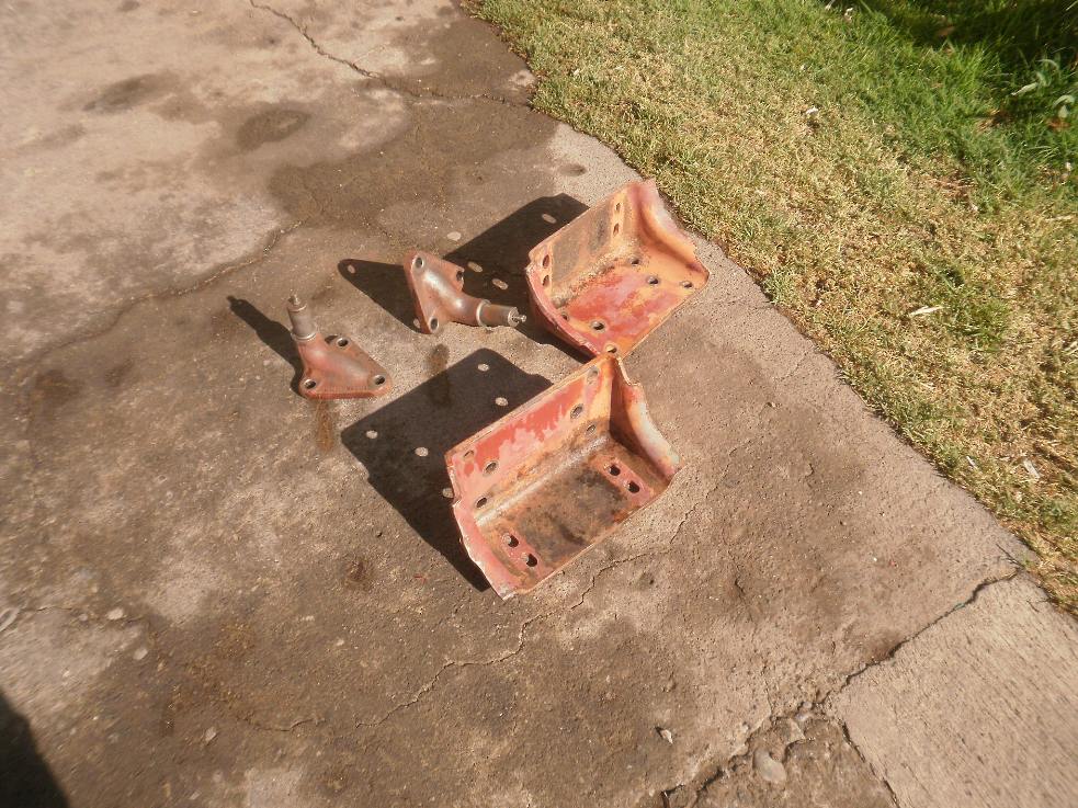

I applied several hands to get a proper thickness to every part, including the repaired spring leaf. I thought that maybe it would be enough and there would be no need to apply enamel over the slightly satin finition of the antirust paint. Wrong.

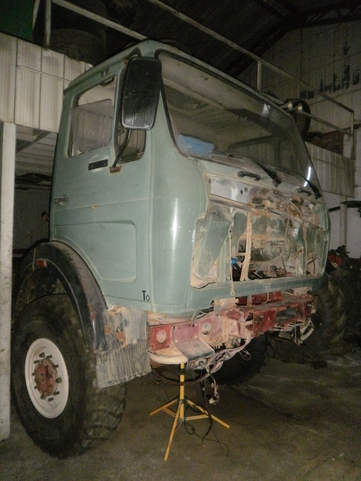

After the paint cured, some days later, I wanted to assemble the pieces and to see how the paint performed when manipulated. Well, not good because it never lost its slightly gomous consistency and easily got detached when hit and made stick one piece to each other. As I had been told before, the antirust paint covers and protects pretty well but it needs to be covered by a serious enamel to protect it from the mechanical stress. Well… that’s why these were just tests. I did not clearly remember why but I did not trust the paint that is used to paint containers that has the three of the attributes that were searched: antirust protection, rust conversion and mechanical protection, so I would have to pay the lack of faith and use both Chilco46 and some good quality synthetic enamel, what I finally did. I really liked the final look and the easiness with wich the paints were applied, compared with the sand-colored poliurethane paint of the rims of the Merkabah.
I initially had some doubts by finally I had to accept that the swap of the cabin supporting system would not work without the swing arm so I ended preparing it for painting. The conic brush was at its lasts, and so was I at that point.

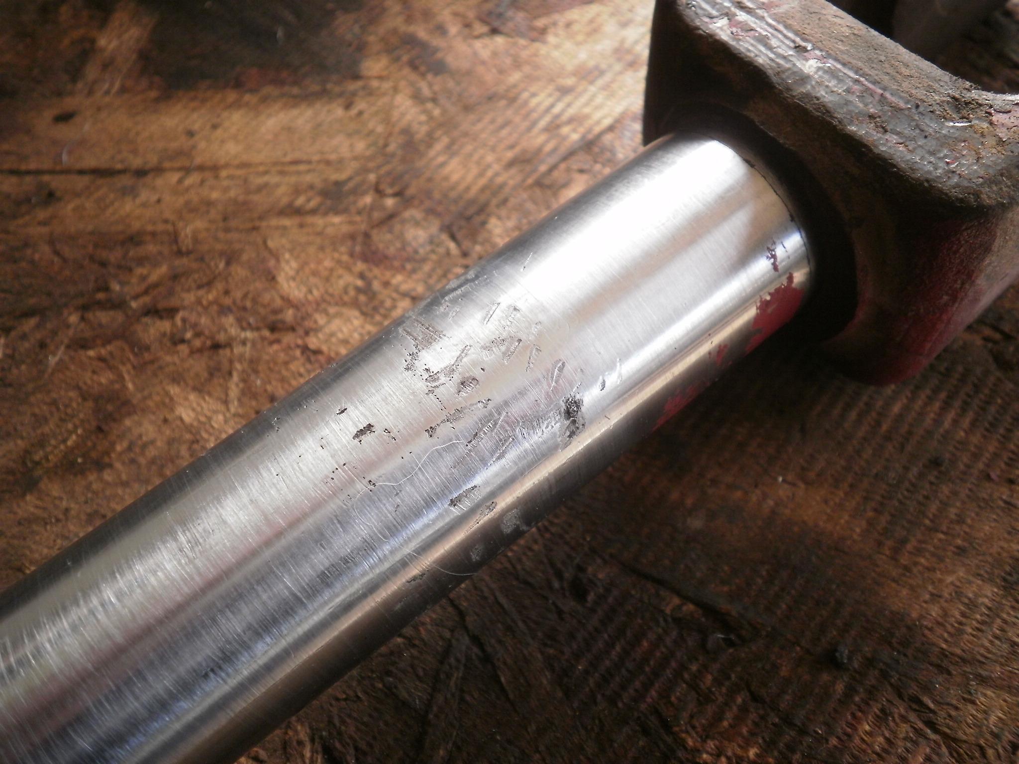

Do you remember the recently straighten gear barr? I took it and removed all the rust of the aft portion and cleaned the less exposed and less damaged front part and put three hands of Chilco46 and then two hands of enamel on it. It ended pretty well to my taste.

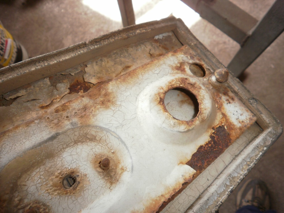

Back in San Felipe the same day I gave a second thought to the making of the box of the Merkabah when found near home a partially dismantled ambulance made by one of the most famous firms in Chile. The alluminium profiles used by them are the toughest (and weirdest) of the local market and a couple of friends have ordered their boxes made with them, but I had (still have) doubts because it was not possible to make 45º shaped attack or scape angles on the box with such profiles, nor I liked the pyramidal upper corners solution. Hmm…
Well, the next day, after a partial telephonic agreement I borrowed once again the Mitsubishi from Eduardo, took my pseudo-mechanician gear and drove back almost three hours south where the unfortunate truck sitted.
To shorten the story, under a sun just a little more benevolent than the one of San Felipe I ripped off the 520 liters diesel tank, the whole front grille and the sun shade from the saddly looking truck. Some bolts were so badly rusted that he had to use the power grinder. The guy gave me one of the lateral air deflectors that he kept at his house as a “gift”. Of course the deflector was the right sided, not the one that I needed but I thanked him anyway.
A little battle, as usual, for the price to pay/ask and I aimed back to San Felipe, but only after making a visit to lunch with my father that lives in a city on the way home.
When I arrived to the workshop I firstly power washed the tank and the supports to lower the quantity of dirt. The big thing was pretty heavy and hard to handle and there was nobody around to help me because it was Sunday. I took a picture to put it in perspective with the tank from Spare; it was 163 cm tall and the autonomy of the Merkabah was supposed to raise to 1.500 kilometers at the minimum.
I know: why to buy things that I already had? Well, these parts were in far better condition and were not expensive at all and, on the other hand, they would save me a lot of work and time.
The Casale’s, the ones that ran their truck in the Dakar rally the last couple of years and that sold me rims and wheels, had offered me a felt to use as isolation for the cabin so I profited my last day of vacation and made them a visit in Santiago. Francisco was hurried and excited preparing his Toyota Tundra for the next January version of the rally (a real monster!), but his brother Ignacio was pretty relaxed and happy for his decision of not to participate this time. He showed me some of their very interesting products to sheathe the inner and the external cabin to isolate it from heat/cold and noise. He owns a MB 1017 based WOMO and he had used the products to make the same job with good results according to him. A 12 milimeters felt seemed to be the most appropiate to isolate the cabin and he gave some samples to work with at home, and he gave me also a special price for it too. Good.
The polyester felt seemed adecuate but I wanted also to put a barrier for the heat of the engine and for the dust too in order to replace the rubber burnt-out protection pads from under the cabin, so I thought about a reflecting barrier of aluminium foil. Ignacio had a big roll of metallized plastic film and gave me a piece to experiment, but we agreed that in the end it was plastic and it could eventualy melt and even burn with direct heat.
Finally at home that day I took the pieces of felt, the metallized film, a piece of actual aluminium foil from the kitchen, a little glue and played. The result was pretty good and the adherence of the glue to the felt was very strong and the aluminium film, once glued, got pretty strong and stood a lot of pressure applied with the back of the pencil without tearing. If more insulation is to be needed the felt piece could be glued to another piece doubling the properties with ease. The problem was that I used a neopren-based glue that once dry is not flammable, surely not ignifugal at all, but I am not certain about its adhesive properties under continued exposure to the heat of the engine. I looked for self-adhesive isolating aluminium products and the prices were pretty high and the manageability questionable so I looked also for thicker aluminium foils than the one stolen from the kitchen, with no luck.

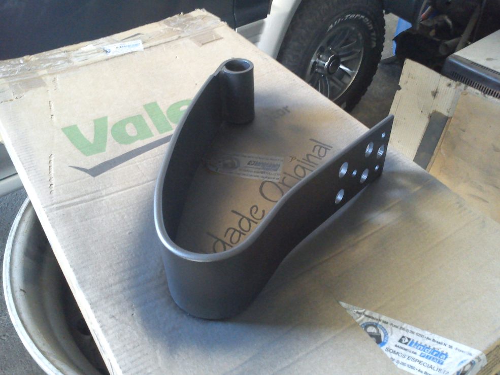

I sighed twice and finished painting the Jost (Rockinger-like) device with synthetic enamel and took it back to the attic where it would have to wait who knows for how long. Having few things left to say or do I looked around for any other stuff at hand to occupy myself and amongst a lot of pieces from under the unconcluded 6x6 Blazer I found the hydraulic cylinder of the cabin of Spare and begun to clean it up just to be able to handle it. After a while I took out the whole cylinder rod and realized, as feared, that the rod was a mess and that it had been rendered useless by force of hammering and worbench vise. Bad thing. I would have to wait to take the truck to the shop and try to remove the heavily stuck cylinder of the Merkabah.
I then turned to the sway bar of the cabin and took off the old and torn silentblocks with the aid of a hammer, a piece of tube, and a lot of frustration-driven force.
To complete the “cleaning” of the sway bar I welded a piece of tube to the old spherical pillow ball bushing and took it off using the gudgeon pin of one of the discarded pistons as opposed hammering mass. The left bushing came out with not much trouble but the one from the right side was so stuck that the pillow ball broke. I had to weld the tube directly to the case avoiding welding the sway bar too. In the end I won and took off the bloody bushing with no harm to the bar.

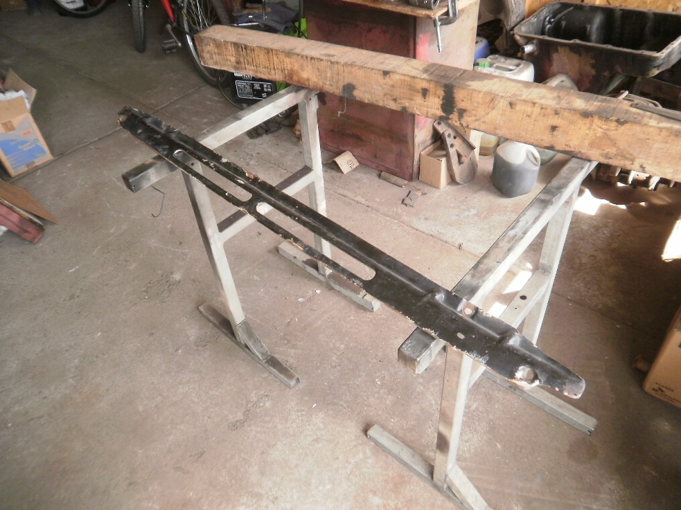

The round orifices for the rods were gone long ago and they had to be repaired too, so I took the welder and re-shaped them. The previous plastering work showed up and caught fire revealing that it was not by far the first flattening job on the cover.

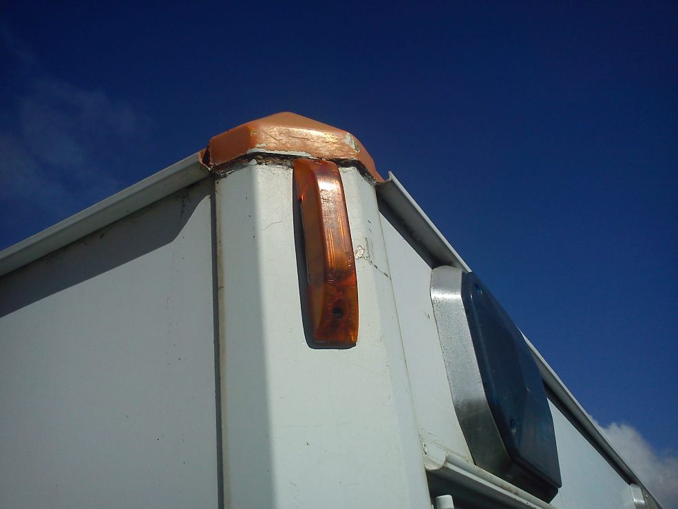

I did not know yet what to do with the “new” second right-sided air deflector. The front panel from the white Mercedes was not intact but better than the panel from Spare and of course better than Merkabah’s. From the external point of view it looked even pretty good, but when looked from the back side there was a lot of rust, especially on the borders. The front cap was not an exception, and even if the rust was superficial it would need a lot of work too. I decided to take the pieces to sand-blasting, but that would be in a near future when there were more pieces to paint, and that meant when the cabin would be ready for painting. Hmm…

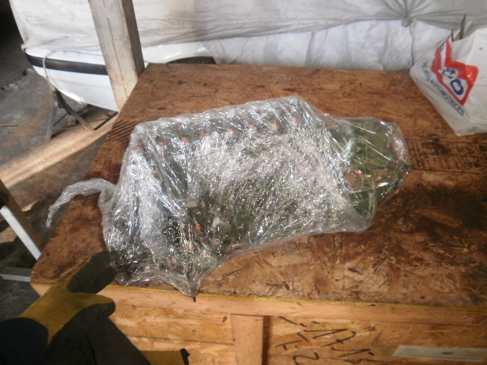

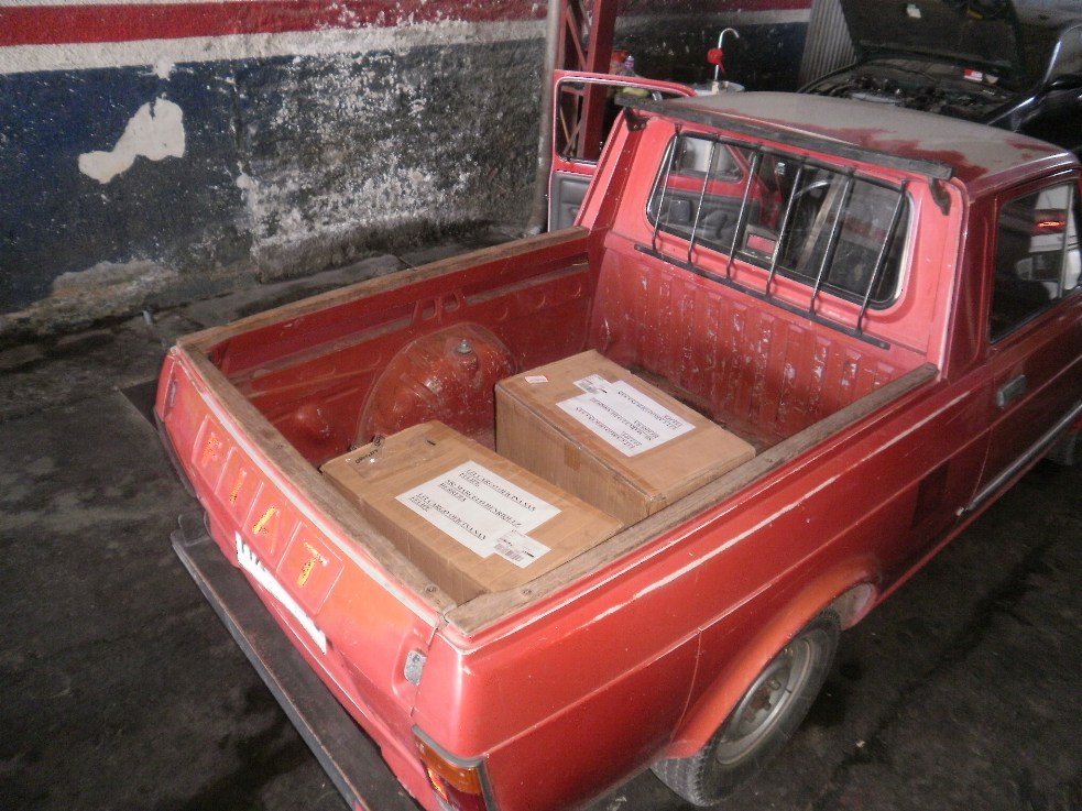

I gathered together the pieces of the engine that already showed some corrosion due to all that time of neglect and abandon, cleaned and painted them with new oil and packed them in plastic film and put them in boxes inside the Blazer. The engine block, a 4,3 litres V6, seemed so small compared with the MB V8! The same job was done with it and it ended along with other hundreds of pieces in boxes. I really liked to wrap pieces with the plastic film and wondered why didn’t I do the same with the engine of the Merkabah in the first place. Inexperience and stupidity, for sure.
I almost filled the entire Blazer with boxes and completed the job by putting in the front bulkhead, the bumper and the capot. Then I made order and cleaned the working space for good. There are only two species of spiders in Chile that can be dangerous for humans, and there were a lot of these in every dusty corner; big, nasty creatures that unfortunately came under my feet.
The amount of garbage, dust and discarded parts and pieces of steel was massive for such a reduced space. I promised myself not to let the things go that far in the future.
The Blazer needed protection for its planned journey waiting for resurrection but I did not want to spend more money in a expensive big car cover, so I got a bigger roll of plastic film and wrapped with it the whole bodywork. The cocoon-making had to be completed with the little plastic film roll for it consumed the whole big roll. I hoped that the covering would keep dust, animals and rain water out of the Blazer for as long as it stayed parked in the country.
Finally, after many days of cleaning and preparations for the big event, I wrapped the Mercedes V8 with plastic just for the fun of it and lifted it with the mobile winch for the first time in months. What a heavy piece of steel! I had already forgot it, but the winch did not as it whined and almost collapsed under the weight. Using a heavy crowbar to give me enough leverage I moved the engine, centimeter after centimeter, towards the back to clear the space.

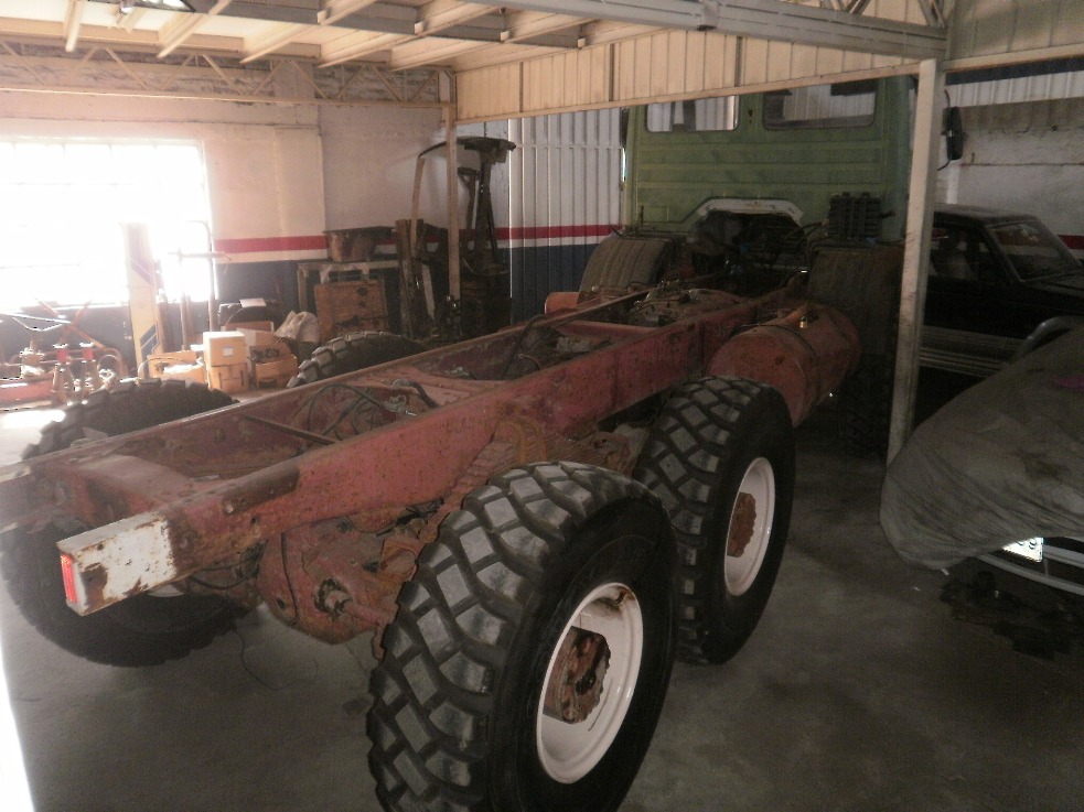

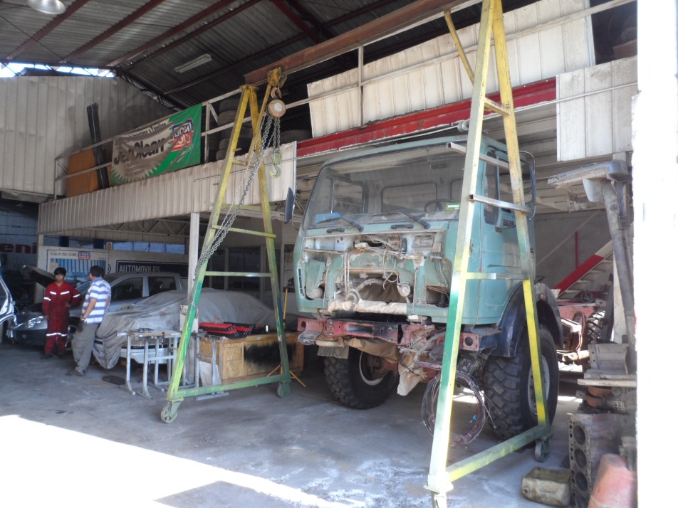

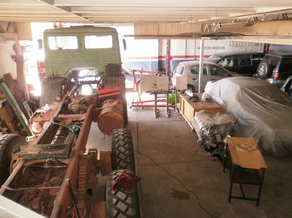

With the engine finally in its new place the truck had enough room to be placed, so the serious work could finally start.
From its new location near the stairs in the back of the working space the overhauled V8 waited the moment to be installed, completed and run after so, so many months.
Of course, as everything in this project, things were not that easy. I made three appointments, three different days, with different crane operators and every time I heard the same words: “Don’t you worry! I will be there for sure!”. Well, they never showed up nor they called to say sorry or anything. The lack of seriousness of these people was astonishing but Carmen and Eduardo helped to calm me down and persevere. I wasted a week waiting for these guys.
The third time that the crane did not show up I was strongly adviced to go on with something else, anything, to keep me busy and to fight the anger. I went up to the attic and stared for some moments the pile of second hand parts and pieces for the Merkabah. I then took one of the big plastic bags containing parts of the snorkel and opened it. I grabbed the air intake case and took it downstairs. It was in pretty bad shape but it surely could get better after a little flattening out, new grille, new bolts, some plaster work and paint. Good; something to care of in the meantime.
At the fourth attempt one of the crane operators did came with a pretty old and almost broken 1972 Ford F100 and we took the Blazer to the countryside. Everybody looked at the plastic-wrapped wheeled thing with wide open eyes and mouth. We parked the odd vehicle in the storehouse and went to take a look at the Merkabah that was very near. The driver shook his head and said that it would be better to take his Ford 9000 for the task, but he had some appointments already scheduled so he could only tow the truck to San Felipe some five days from then on. Hmm...
Back at home that afternoon I remembered that there was one guy who operated a crane a couple of years ago and he could be more serious than the others. I had forgotten where his card was but I knew where his father lived so the next morning I went to make him a visit and after a few words we had an appointment at the workshop at half past midday that Saturday.
Of course he arrived thirty minutes later but I already knew that this was normal for this kind of business. Roberto Maack and I shook hands, loaded the tool box and the recently borrowed truck towing spear from our neighbours and chatted a little on the way to the cattle.
At arrival and after the first sight of the truck he twisted his mouth and said that there was no possible way for his crane to take the Merkabah out of its long standing place with that kind of terrain. Of course we did a ridiculous attempt only to see how the rear wheels of the little truck spinned fruitlessly delivering clouds of dust to the wind.
I excused myself and ran to the place where the tractors of Eduardo were parked, just a block away and under the same storehouse that now hosted the 6x6(almost) Blazer. There were no keys so Eduardo told me on the phone how to make the Valmet start by bridging the cables that went to the starter. Roberto saw me and smiled widely showing both thumbs up when I came back to the cattle driving the yellow little tractor. After planning the manoeuvre he took charge of the tractor and I got into the cabin of the Merkabah. As you can imagine the steering wheel was heavy as a rock. When Roberto urged the throttle the pulling chain tensed and the big wheels of the Valmet started to dig into the dirt but no movement was perceptible aboard the cabin. Then, slowly and smoothly, the Merkabah broke its long standing inertia and began to move backwards. My face had an incredibly wide smile when suddenly I heard a couple of bangs! and pows! and immediately stopped the pulling. I then removed the short shaft from the gear box that spinned eccentrically and hit the frame. We resumed the pulling and I had to manoeuvre between a big wooden box and the old truck of Eduardo’s father and that made my arms ache a little. God… it was hard!
Fortunately Roberto was not concerned about the time even though his phone ringed continuously for other towing jobs callings, so we made everything with ease with time enough to shoot some photos. I did all the heavy work because he had a severe lumbar ache and I guess that it contributed to keep his natural southern german good humour.
We pulled the Merkabah out of the cattle and left it on the asphalt so the crane may have optimal traction. Finally the old truck was back on the road, even if it had no engine of his own. I swear that I could see something like a smile on its face.

We put the towing spear between both trucks and Roberto had some concerns about the angle of the spear, but it was too late for such concerns at that point. There was a major leak of hydraulic fluid from the pipes or from the retainers of the steering box but I did not care too much so we went on and aimed to San Felipe.
The whole trip was uneventful and both vehicles caught the eyes of everyone that crossed ways with us. We made a couple of braking tests and stopped once to check the temperature of the axles and at a steady speed of 20 km/hr it took us half an hour to arrive to the workshop. It was harvest time and we were not the only slow ones on the road and therefore nobody bothered us with speeding. I need to point out that without the weight of the engine the truck’s suspension was almost zero and my kidneys barely stood the trip. Air suspension seats, cabin suspension and upgrading of the frame suspension were on my mind all the time.
Once at the workshop Alejandro helped us with the traffic and Roberto pushed me in reverse and I managed to drive the truck through the doors with only a few free centimetres on each side and the Merkabah, after nine days of waiting and frustration, could finally come into the shop. Alejandro was almost as happy as I was.
Unfortunately the manoeuvre ability of such a truck without auto propulsion is almost zero, specially if Alejandro and I were the only moving force available, so we had to leave the truck half crossed as it ended after the crane was gone, occupying more space than originally thought. We would have to move the truck back and forth until the right parking position was reached but we would need many more hands.

I got in touch with a truck importer in Santiago and I am waiting for his answer about the prices and availability for a pair of top level seats for the Merkabah: full air suspension, millions of different alternative positions, three-point integrated seat belts and so on. They are made in China, of course, but sold in Europe as from german make, and they are fitted for the cabin of the NG class Mercedes. I hope for the price to be fair and reachable. We will see.
When I could I went to the shop after work the next Monday and the truck had already been moved by Eduardo because its position was inconvenient for the displacement of the others cars of the shop. He moved it with the help of five and they could only move it a little, not without some minor lesions and back pain. Weaks!
I then went directly under the cabin and began to prepare the area for the next step that was to put the engine on as soon as the injection pump and the injectors arrived in a very near future.
At first I was not sure about the amount of things that should be removed to achieve a good level of cleaning of the frame and I started by getting loose the wires in order to clean the space behind them. It looked like it would be no big deal. I removed also some supports for the radiator and for hoses, but when it came the time to loosen the bundles of tecalan the thing began to get every time more complex.
At inspection there were half a dozen of wires and tecalan that were not originally put there by Mercedes and I had no idea what they were for.
I removed the right front engine support to see how things looked like and there was some superficial corrosion under it so I would have to take all of them off. I removed also the support of the hydraulic cylinder and the cylinder along with it. I would have to be careful and remember to put a chain or something to avoid the cabin to go forward when tilted.
To make the story short, after a couple of hours I realized that if I wanted to do a good job it would be necessary to take everything off from the frame and make a very good cleaning. Behind every little or big support, behind every bolt and behind every pipe there were tons of mud, old grease, dust and stones from who knows which mountain near Talca and maybe from the Schwarzwald hillsides. Everything that could be removed should be removed; there was no scape. And we are talking only about the front part of the frame only! Of course the right side of the frame was easier to clear because the greater bundle of tecalan and the hydraulic piping were on the left side.

#172 Beitrag von pairospam » 2012-01-25 15:51:07
As you see from the pictures, every corner was full of dirt, even if I powerwashed again the frame.
Anyway, I was the happiest man of the world remembering the sun, the heat and the thirst when working on Spare at the cattle. It was like heaven in comparison, with Carmen taking me some cold drink from time to time. Great.
Going under and getting out from under the Merkabah every five minutes looking for tools or anything was easy at first, but after a couple of hours the reflexes became slower due to the tiredness and I hit my head soundly more than twice against the protruding pieces of steel. It hurt, pretty bad. So I decided to work a little on the front and take off the lower protection bar of the bumper and the rest of the pieces that were bolted to the frame or that limited the access to it from the front.
I fought against rusty bolts and nuts taking every piece off and I found everywhere more dust and dry mud. Slowly, the Merkabah was finally getting into its path for resurrection.
If you pay attention you will note that there was a red tractor and a little Peugeot 307 parked by the side of the old Mercedes. Eduardo asked me to use the space because he had too much work and needed the place to keep the vehicles, but I was not comfortable at all with the idea because you never know when they will be gone and, besides, it was more difficult to move and to handle the pieces taken off from the truck. Hmm… The idea was to move the Merkabah to the left and make it go under the attic so it would not impede or disturb the movements of the other vehicles of the worshop. With the tractor parked there for who knows how long I could not move the Merkabah to its definitive position.
I continued with the dismantling of the front of the truck and realized that the plug of the right headlight should be replaced among a lot of other things. The left side headlight case could not be disassembled from the hinges because the bolt heads were torn and, of course, there was a lot of dirt behind it and behind the bumper.
And the second working day on the Merkabah ended pretty late, as usual.

The next Saturday I worked alone in the shop the whole morning and I did not stop until I removed completely the tecalan from the front part of the frame. I marked every tee and every connecting knob and every tecalan and took dozens of pictures, as always, in order to have a hint on what to do when the time of reassembling arrived. I found some other wires and pipes connected to nothing or in very bad shape. I washed the exposed frame with grease remover and the result was pretty nice but the work was far from being concluded. If you went just 20 centimeters behind the connecting beam between the frame rails you saw that there was a lot of dirt and grease still waiting for cleaning, not speaking of the gear box itself, and also there was still dirt in the inferior face of the rails and beams. I left it all when I got hungry and Carmen and I went to the beach for a ride.
Back at the shop next Monday afternoon the red tractor was not there nor was the little 307, but at their place there was a 406 that still bothered some. I was really concerned about the timing because it was supposed that the injection system of the Merkabah would arrive in three days and the engine should be assembled completely and put on the truck as soon as possible in order to make it run to avoid for the components of the injection to get stuck. I was also concerned because the place was too exposed and robbery is really an issue in San Felipe, and tools and pieces are very appreciated by thieves. Eduardo and I had a little argument on the subject, no blood, no problem, and we agreed about the near future movements. I love my brother-in-law too.
I then turned again my attention to the Merkabah and went over the main pressurized air circuit. The air tanks would be relocated backwards between the frame rails so there was no reason for them to be there any more and by the way it would help with the removal of the other components to clean the frame. Again I shot a lot of pictures and I took off the little air tank and the valves which names elude me at all. The tank was almost full of water! Behind and between parts there were lots of long forgotten stones and dirt that formed a growing pile on the floor. I took also some odd kind of valve that was almost hidden under the oily mud. When it came the time to clean and reassemble the pieces I promise I will know exactly the name and the function of every part.
I left the big steel tray because it would soon be necessary to put the batteries to make the engine run and I left both big air tanks underneath but only because it was getting late.

Finally one day there was no more need for the place next to the truck to park broken cars and tractors, and as soon as I got to the shop I gathered all the helping hands I could and climbed into the cabin of the Merkabah. Then, seven grown up men including the people from the paint shop next door started to push and pull the truck back and forth to park it properly. The steering wheel felt as it was bolted to the floor and I do not remember to have ever sweated as I did then, turning the wheel from one side to the other endlessly with all my strength until the manoeuvre concluded. Everybody laughed at me when I got out of the cabin, dripping with sweat, trying to catch my breath. God, it was really hard!
The horns missed the beams of the attic for scarce 3 centimeters. The calculations where right, but I did not think that it would be that close. On the driver’s side the space left was enough to open the door and to walk through, but after all the discarded pieces were classified, sold and taken away there would be plenty of room to work around the truck.
I moved the wrapped engine and some boxes to arrange the working space and the final layout was set. I had enough room to work comfortably and if necessary the truck could be moved to the front to make any repair, cleaning or whatever.
While I was putting everything in order the injection pump arrived from the shop. Actually, both pumps arrived but only one of them had been repaired; the one from Spare was not recoverable because it had been left unused for too long. To be precise, it was recoverable but they would have to charge me another fortune, the first I had to pay to fix the pump of the Merkabah.

I removed the hydraulic pipes from the frame and decided to remove the electric bundle too, so I tried to loose it from the place where it passed under the cross member of the frame over the tandem. No bloody way. It was stuck, firmly encased by a mixture of sand, dirt and stones as hard as concrete. Only after two hours of struggling against this rocky thing, uncomfortable positions and difficult to reach corners I could loose the wires and plugs free, only to realize that I could never remove the whole bundle from the frame for a couple of wires passed between the opposed main beam and the gear box support. I would have to take the support out to free the wires and also the odometer cable. I dropped the whole idea and left the wire bundle for the next time.
I coiled the already taken off tecalan bundle and secured it to the front of the truck, sighed, and prepared myself for the final cleaning of the frame before painting. With the power drill I managed to take almost all the superficial rust using the wire mesh. Once again the ridiculous nurse cap was necessary to avoid my hair of been covered by rust dust, but anyway I felt like the happiest man on earth.
I had left a couple of little supports but I took them out too and washed again the frame with oil remover and then power washed everything again.
After swiping the water that menaced to drown everybody at the shop I power blown the frame and made sure that in a couple of days all the water left in the corners would be gone thanks to the hot summer weather.
One final shot at the Merkabah that afternoon, just for the fun of it, made me wonder if it was possible for someone to fall in love with an old ship like that. Maybe I was sick, but I really liked it.

Well, the thing was about cleaning and preparing all the supports that were bolted to the frame to paint them too. The bases for the aft silentblock supports of the engine deserved time to their own as the accumulation of dirt and humidity had made the steel rust more than superficially. After some hammering I could get lose the most part of the rust, but my ears did not thank me at all for that.
At first the silentblocks would not be replaced and they would be used untill they died, but when cleaning them it was evident that their journey had already come to an end. The rear ones were the worst looking, but the front ones were also unhealthy. It was not worth the risk. I called the official dealer in Santiago and asked for the supports and allmost fell down with the price they asked for the four of them, almost half the amount that I had been asked for a 40.000 km double turbo OM412 imported directly from Germany. No way.
I phoned the option B store and asked for alternatives. After a while that seemed eternal the seller offered non original supports of German make and by a known company, for an eighth of the original price. I accepted immediately and made a pryer for them to be the right ones and not to end with some Volkswagen Golf engine supports in my hands.
I was cleaning more and more pieces when the injectors arrived, the last pending issue for the assembling of the engine. Good. We asked ten of them to be repaired to leave two as spares when travelling. They looked a little hit but clean, and the points were new and shining. I wrapped them in plastic and left them apart until it was time to assemble the injection system.
I went on with the cleaning almost against the clock. The pink grease remover was so strong that it removed even the paint and made me cry and cough more than once. After that a little session of power brushing completed the preparation.
I also prepared the supports for the connecting rods of the front sway bar of Spare.

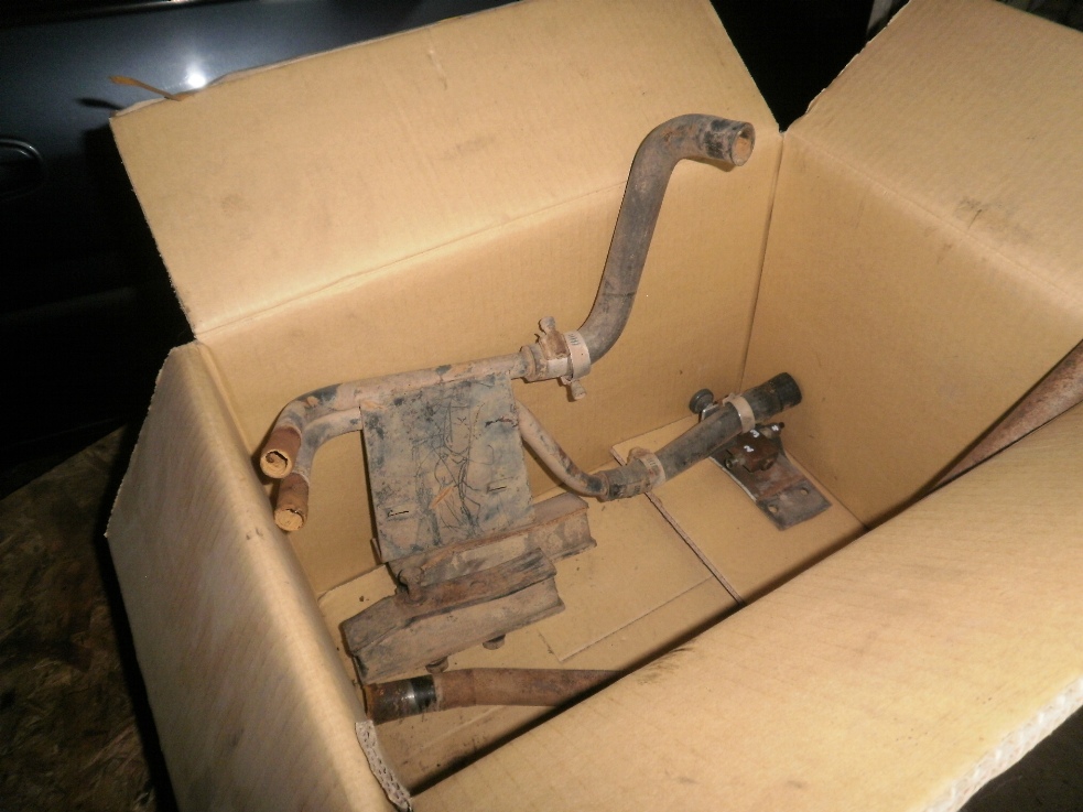

One afternoon, as scheduled, two heavy boxes arrived by bus from Santiago and I went to pick them on the little Fiat known as Fiorella, the beloved red italian lightning bolt of the workshop. The 20.000 lb. winches were there. A friend had installed two 15.000 lb. Warn winches in his Atego and they worked well in the field, but I thought that it was not enough power for the projected 12.000 kilograms of the Merkabah. I searched in the local market and ordered the biggest 24 volt winches in a specialized store in Santiago. Of course they were not Warn winches but of chinese make instead. Fortunately in the end I found out that the store was owned partially by a friend of mine that I had not seen for a couple of years. I rang him to say hello and to tell him about the project. I felt much more comfortable as he backed me up and told me that his winches were O.K.; any problem he personally would respond. I hope that he would not have to travel to Uganda to replace a broken winch.
The boxes remained on the floor until their time came and I resumed the cleaning process to install finally the V8.
I followed the advice of the owner of the paint shop next door and I bought a special primer named washprimer to increase the adherence of the enamel to the steel of the frame, that supposedly had also some antioxidizing properties. Under the threat of suffering a very slow and painful death he assured that it was the solution to the failed experiment with Chilco46 and sold me the amount that he judged enough to cover the whole frame. I also got from him a black catalyzed heat resistant enamel of who knows how many microlayers of who cares wich kind of crap that was the top of the line product they now used for painting the landing modules of Saturn, or something like that. Hmm...
When the frame and all the pieces were ready, and I had got the time, the washprimer was prepared by the painter, the same guy, and he started to apply it to the lose pieces first. I did not like the look of the thing and the guy seemed as surprised as me by the finition of the paint.
I took the paint gun and sprayed all the pieces and I gave many hands to the frame to get a good covering, but the consumption rate of the primer was terrific. There was something wrong and without a doubt it was us, the painters.

I was dealing with the hoses when the engine supports arrived from Santiago. I was quiet anxious but when I opened the boxes and saw that they were the good ones I could breathe with ease.
pairospam
Beiträge: 934
Registriert: 2010-11-22 14:27:25
Re: Mercedes 2626 AK 6x6
#179 Beitrag von pairospam » 2012-02-21 23:47:46
I hardly believed that they all were the proper supports, and I was very happy.

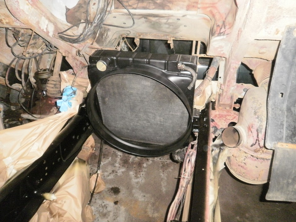

To make the story short for once, the day after I got the matt finition lacquer from the paint guy (for a free, of course) and dedicated the few hours available to apply it to the frame and to wait to see how the black paint changed. And it did, fortunately; even if it was not as I originally wanted it was a semi gloss finition, like the engine paint.
I was called from work so I had to leave early and the engine, again, had to remain still on the ground.
The next day I went to Verardo’s machine shop. My friend was not there but I borrowed from his brother the same bridge-crane that I used to take off both engines from Spare and the Merkabah in the cattle many months before.
At the shop I struggled to assemble it, with some aid this time, and after a couple of hours of a little dangerous and heavy work the thing was ready to function.
I bent the cabin of the truck using the winch and it was time to go home, again.
The day after I put the radiator back in place and bolted the silentblock supports of the engine. I made some retouches of the paint and I also tried, once more, to remove the hydraulic cylinder of the cabin from its support, unluckily again. The support went bolted together with the front left silentblock of the engine so I would have to put the support of the engine alone and wait for that issue to be resolved in a near future.
I could not do any more that afternoon so I went to work thinking on the big day of tomorrow.
And finaly the day came when I hung the old/new V8 from the mobile winch and with the aid of Alejandro and Tito, a cousin of Eduardo and Carmen that was from a few weeks working with them, we moved the engine where we could take it with the big winch. Don't mind about Tito: he does not bite.
