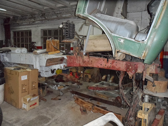

Back again at the shop, I decided that I would continue to fit the front suspension. The massive array of leafsprings should go and I would have to figure out the best arrangement for the purposes of the Merkabah; double shock absorbers and an air spring had to fit in. The sway bar issue was already done.
First of all, I had to remove the frontal cardan shaft. This I tried to take out many times in the past, with no success, but I followed Eduardo’s advice and sprayed a tiny amount of Rost Off in between the two stuck front flanges. Almost like a miracle, the day after both pieces were loose without even the necessity of a hit. I repeated the maneuver on the aft flanges, between the cardan and the gear box, and also the day after it was loose. Good.
Meanwhile, the truck had to stand on the frame to work freely on the front suspension, so I looked for the best way to make it and finally I used the trestles, all of them, a couple of trunks and some pieces of wood. It came a pretty stable and solid arrangement, or so it seemed.
With the cardan shaft out and the axle free of load I removed the U brackets and then began the crappy job of taking down the axle with the aid of the jack and the jackstands, and also of Alejandro, whose help was capital to stabilize the axle when moving the stands.
As expected, one of the central bolts was broken, and also one of the spring leaves, who knows how many years before. I thought it could be worse, though.
It was a good idea to stand the axle on the moving tray, even if the wheels were a little weak for that amount of steel. Once removed from under the truck, with more than one protesting wheening, the place was free enough to work easily, or to jump off if there was a quake.

It was late so I put all back in order and took a picture of the state of the work. Nothing seemed to change even if the hours passed and the efforts multiplied.

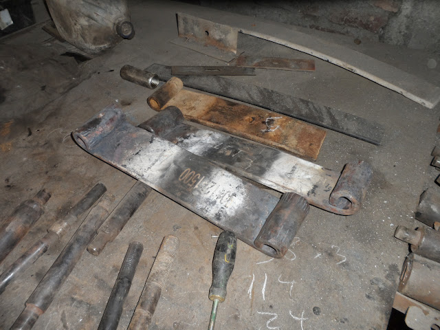

The shackle had a pretty odd and old looking. One of the bolts was broken and there was no nut in the front. The hole for the shackle pin was severily worn out and excentric. It was screwed and I needed to replace it.
Trying to unbolt the shackle I lost the concentration only for a tenth of a millisecond and I smashed my thumb against the frame rail. It really hurt. For a while I was only able to do simple things with one hand, so I undusted the axle and took out one kilo of rust.
The next day I resumed the work on the rusted bolts of the shackle and finally took out the piece without hurting myself again, for a change. The frame was not bad but I couldn’t remove two of the bolts. More Rost-off, and time.

We took it to the shop and began to disassemble it. The front shackle was healthy and could be recycled, but the aft one was a mess and it looked like its good times had passed long time ago.

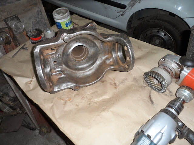

I was high in the middle of the vapours of the gasoline when the drag link for the steering arrived from Santiago, with a delay of a couple of days. It went directly to the pile of new-spares-to-be-used-in-a-near-future.
The washing proceeded until all the parts were shining, and they went all into boxes to wait for the moment Eduardo and I would coincide for the assembling.

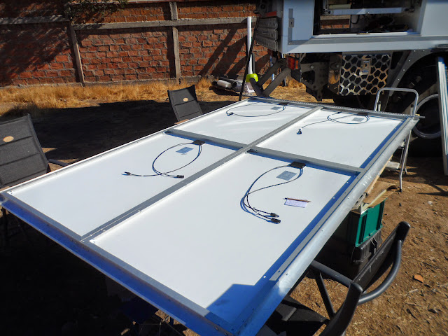

The work on the panels also went on and soon they were mounted on the hand-made aluminium frame. Stefan made up four rubber corner supports for the panels so they can be lifted to catch more of the flat winter sun. The state-of-the art piece of engineering just waited for little retouches before being ready to sit on the roof of the cabin. I went to work and a few hours later I came back to help with the maneuver.

Four grown up men were needed to take the panels to the roof successfully. There were tense moments but in the end the fragile structure was in place and Stefan fixed it to the airline-profiles. The rubber supports worked very well. Previous essays showed that lifting 30° the panels could improve 300% their efficiency.
The problem that arised, previously predicted, was that the panelswere a little heavy and lifting them should be done by some sort of mechanism, but Kurt and Elizabeth wanted to leave in a few days because they had some meetings already scheduled. The issue would be addressed in a few months, when they returned from Switzerland.

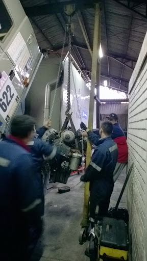

A couple of days later I prepared and cleaned it all to start with the assembling of the engine of the Africa Twin. I started at the order of Eduardo to remove the valves and then we realized that the valve retainers were not included in the box of new spares. Ops. A call to the Honda dealer, another “Ops” at the other end of the line, and the fortune of having the last kit of valve retainers on stock. I also ordered a new set of spark plugs, just because we were already there.
We removed the valves, cleaned and adjusted them very carefully, cleaned carefully the cylinder heads and wrapped them in plastic film, just to put them back in place in the boxes. Hmm…

Back in the workshop, I resumed the work on the truck and tried, fruitlessly again, to remove the bracket for the shock absorber from the springpack of Spare. All this rust! I soaked it with Rost-off and left it aside after struggling a lot with a big lever and the heavy sledge hammer. Heat would be the answer.
Fortunately the two front bushings of the spring packs were weaker and I removed them without too much sweating. Every move, though, consumed a lot of time, as usual, and after making a lot of efforts it looked like nothing had changed at all. Pretty frustrating, but it had been the same since the beginning of the project.
I went to pick the new spring leaves from Guillermo’s and he included six new locking bolts in the pack. The bracket needed some grinding retouches but, all in all, it was not bad. The idea was taking shape slowly but consistently.

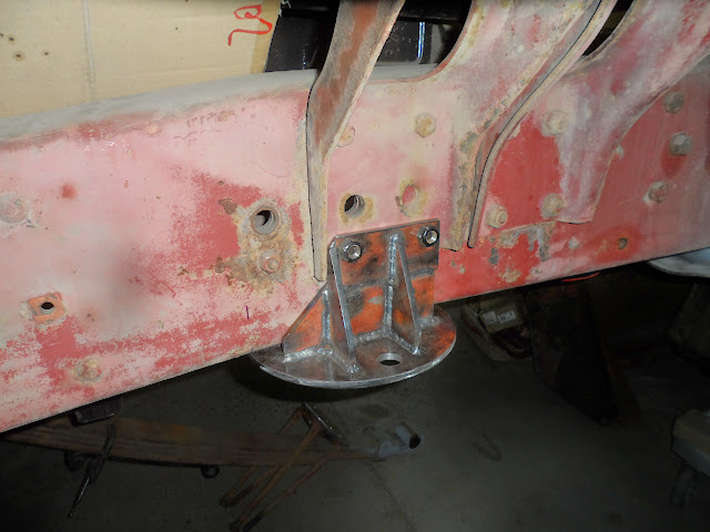

A poor empty box served as donor of cardboard for the mockups of the pieces needed to adjust the airsprings to the springpacks superior plates. The round base plate had to be easily removable to allow the U brackets to be placed and taken off when needed so an intermediate piece had to be welded to the plate.
As always, Spare’s never-ending pieces of frame were the source of steel. After some sparks and a lot of noise the pieces were almost ready for machining.
After closing the workshop to the customers, and let the dust settle, Eduardo helped me a little more with the assembling of the engine of the Africa Twin. We assembled both the cylinder heads and did a few little things and it was too late to continue.

What I did next Saturday morning was to fill up the holes with welding and finished the grinding of the round plates with the help of a new clutch disc that was nearby. Eduardo did not approve, afraid for the spare’s integrity, but the pieces went really okay and the clutch unharmed. Then I went out and bought a set of threading tools and the conic bolts needed. I had not time to do more.
To drill the holes for the bolts I thought it would be better to use a pedestal drill press instead of making it by hand, at least this time. I would use Victor’s drill again, at the workshop of the hospital.

I went on with the fabrication of the supports, welding and grinding, welding and grinding. I really like doing that.
pairospam
Beiträge: 930
Registriert: 2010-11-22 14:27:25
Re: Mercedes 2626 AK 6x6
#467 Beitrag von pairospam » 2014-08-06 0:14:36
On Tuesday afternoon I took the half-made supports to Victor´s little shop where I drilled the holes for the top bolt and for the air intake of the air springs. The next day they were back at the workshop and they fitted perfectly. The only problem was that the flat disc twisted a little because of the heat of the welding and therefore it was no longer flat. Some skilled strikes and bumps after they were almost flat again. Good to have a big sledgehammer.
Then I drilled the holes for the bolts that would be shared with the support of the cabin. Once done, the lateral fixing of the supports was ready. The air spring looked pretty good and pretty solid when in place, but it was necessary to fix the support from the inner side, that meant from the horizontal wing of the main frame rail.
To do that, I looked for a very simple solution as I wanted no more complications. Just put a plate bolted to the support to press down against the rail with a little piece of rubber in between. I have seen something similar in Kurt’s truck and judged it very nice and reliable, at least for this application. So, after another couple of days of cutting, drilling, threading, welding and grinding the supports were ready, for good. They got stored in a box and I went on with the rest of the parts of the front axle.

After getting rid of one kilo of hardened grease and dust I cleaned the left side shaft, enough to let the rost-off spray reach the corners and angles. Once both homocinetics were clean I left them soaking in rost-off and loaded them on Eduardo´s truck to take them to the press the next day.
Next to do… clean the steering knuckles. They were also pretty dirty, as you know, so I began with the normal putty knife work and brushing and carried on until it was time to go.
At home, that weekend, everybody was unaware and/or did not care about my enthousiasm because I was making some progresses. Sydane just gave me a lazy gaze and told me “You are really crazy, Pairoa”.
Thanks to the enduro riding and the chiselling I developed a painful epicondylitis so I decided not to work nor to go riding, at least for a while. Took with me the toolbox and profited to do minor but necessary (and long delayed) jobs at home. Carmen was happy.
Next Monday, with less pain, I continued with the gasoline bathing and brushing of both the steering nuckles. I smelled of gasoline for two days, but the result was worth of it. It was necessary to sand the races because they were not very healthy and I did not like the idea of having more oil leaks around. Hopefully it would be enough. The conical bearings were okay.
As already seen, there had been some work there in the past and the seals had been replaced on the right side for alternative ones, along with the universal joints. Maybe it was the reason why the whole thing was soaked in oil. The left side parts were all the original ones.
The manual talked about an extractor to remove the inner rings and seals of the knuckles, but as I had no extractor nor will to buy one I used a little barr of steel and out with the pieces with just a little hammering. In the end of the afternoon both knuckles were clean and ready for the next steps: sanding/grinding and painting. They should wait until I had more parts in the same situation, though.

Monday, again. Eduardo and the guys at the shop struggled to mount Jago’s engine on the Tatra in a very confined space. They succeeded, of course, but it was not that easy.
