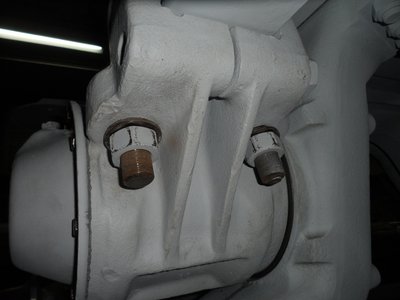

I put on the springs on that side also and the U brackets and the plates followed, but I could not find the conic washers to tighten them. I made a naked attempt but I did not like it at all so I had no option but to go out to buy some new ones, wich I never like as it interrupts the work. But, as always, something told me not to go out at that moment and look for local solutions.

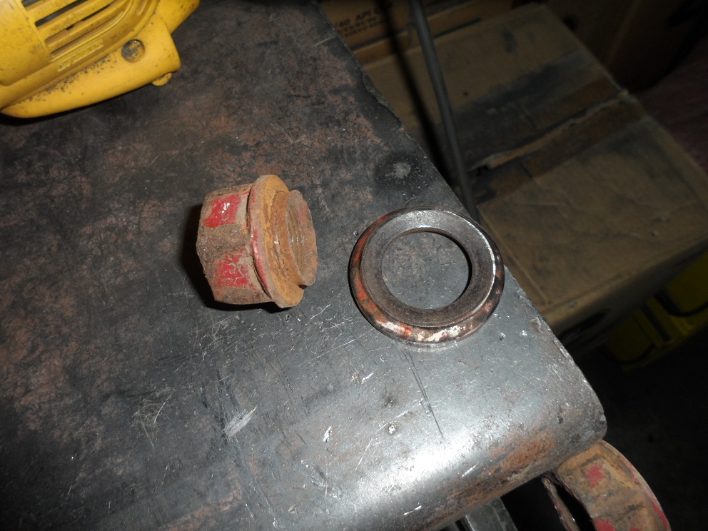

A few minutes after I found the old wheel nuts of Spare in a box, with conic washers included. As you know, the project itself is about to recycle everything to restore the truck, so a little cutting and grinding and cleaning and there were four “new” washers for the U brackets of the left side of the Merkabah.

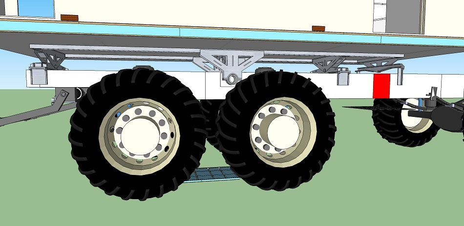

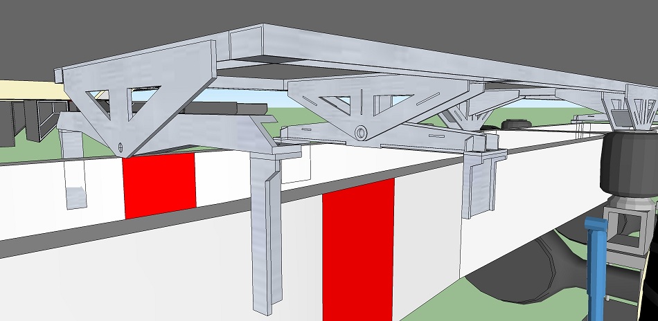

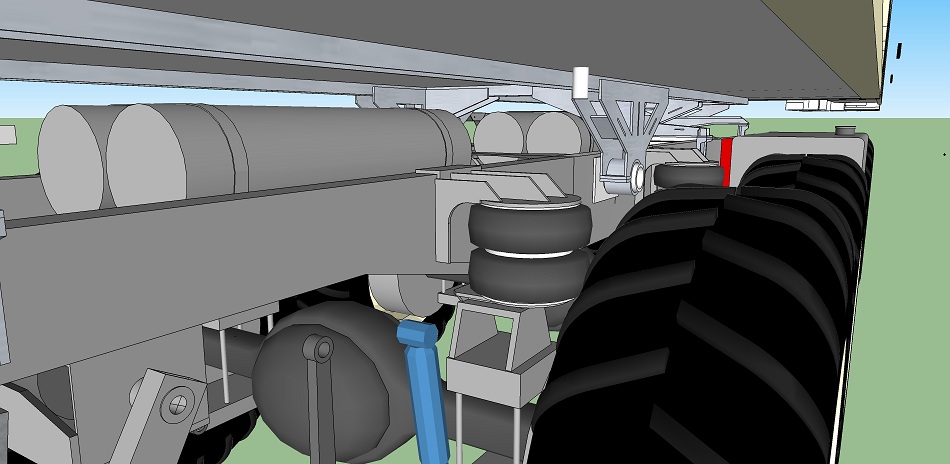

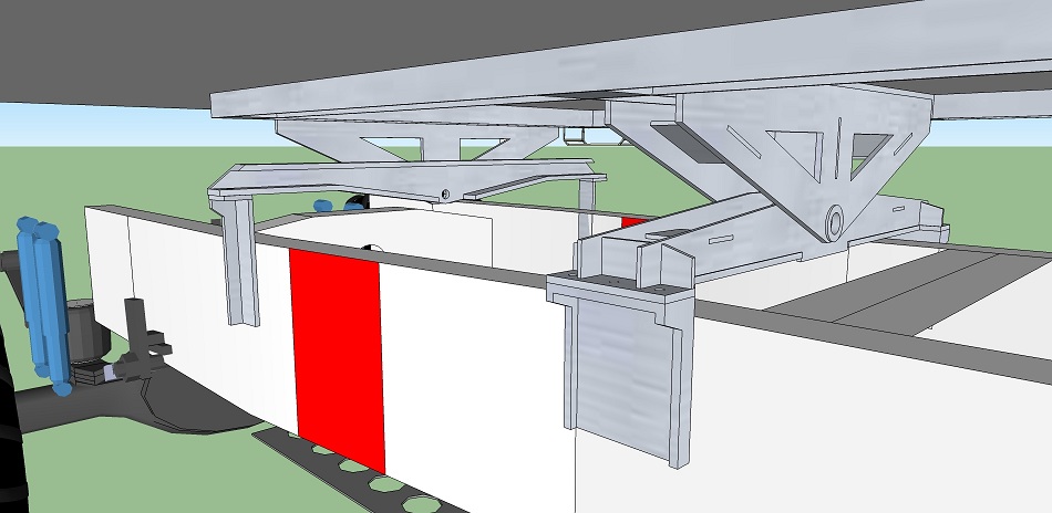

I was worried since a few months about the design of the front pivot of the Box because there was a potential conflict between the support and the superior aspect of the gearbox. I finally came up with a compromise between all the factors to consider, and this was a five point pivoting system, with one on the most anterior aspect before the gearbox and the other behind the gearbox. The extra support would also help to better manage the weight of the water tanks located in the front of the Box, even if the support would be a simpler and less robust one.
Of course, modifying the design of the supporting pivots meant to modify the measures and location of the components of the base panel of the Box, pretty slow and boring job. In the end, though, the idea was not a bad one and it would probably stand in time IF the system with pivots overcome the dynamic tests when the truck preparation was finished.

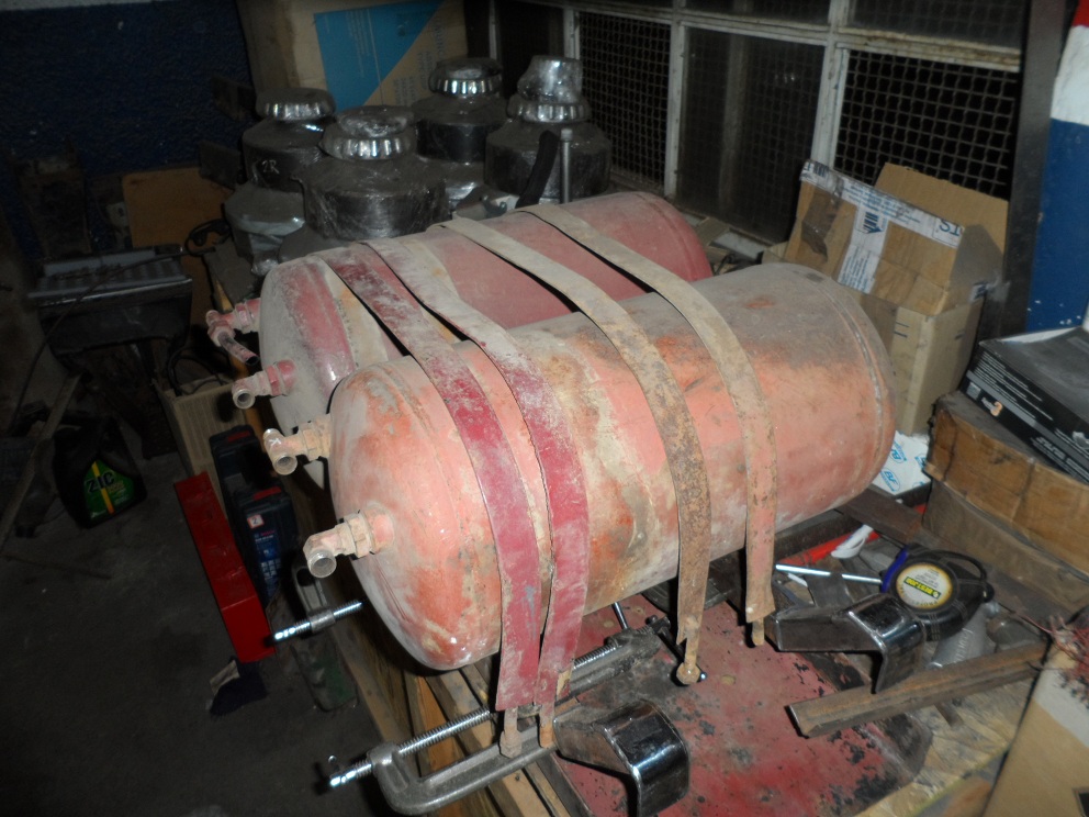

Back at the shop again I looked for the metallic brackets of the air tanks that I knew were in there, somewhere, waiting for their turn to show up. When found, not all were in good shape, especially those from the Merkabah, but good enough to recycle.
I improvised a test bank using the little air tanks and all the measures were the correct ones for the supports.

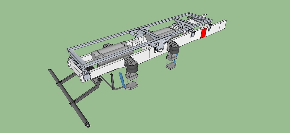

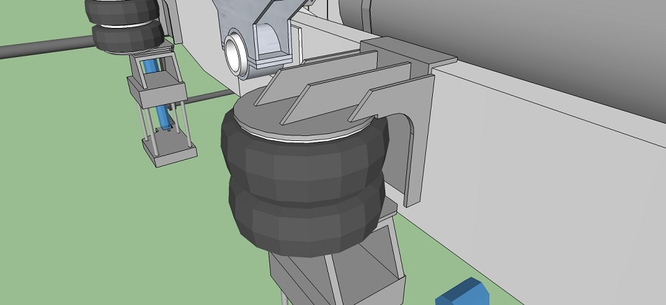

I went on with the planning of the modification and stretching of the air spring supports as discussed earlier. I was not pretty happy of having to take the supports out, cut the pieces, weld them, clean and paint them and put them back again. But life is hard, especially when you think you are making it simpler.
The issue of the pivoting system and the air tanks was solved, at least for the moment, but I was still waiting for the rear sway bar to be repaired for welding it to the third axle. Without the sway bar I could not assemble the hubs, the brakes and the wheels. Bad.
Well, at some point I took out the supports for the air springs and profited to mark and drill the holes on the frame for the air tanks supports. When finished, some time later, I took the brackets and cleaned them. I had to repair one of them that had been broken, welded, broken again and welded again, so I broke it and welded it for the third time waiting, as usual, that this was the last time.

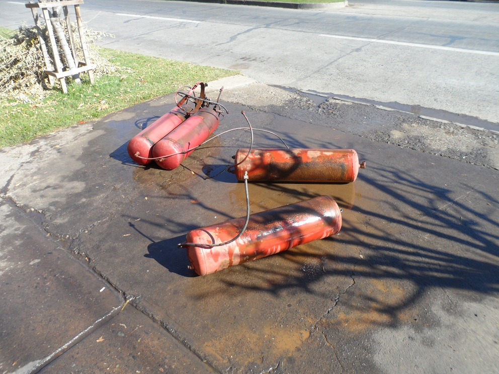

Then I took out of the shop the big air tanks and washed them thoroughly trying to reduce the amount of dirt that covered them, with not much success, though. While they were drying up I displayed the recently finished pieces and gave them many hands of wasprimer and primer. It felt good when the air tank supports fabrication affaire was over.

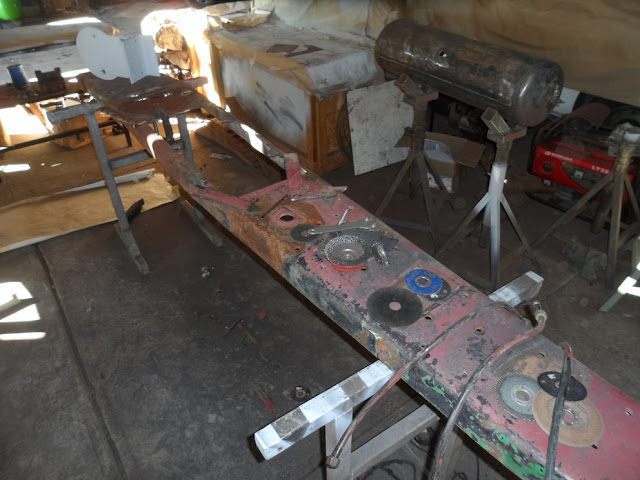

Well, some news after a few weeks of silence. I have been working pretty hard with not much time to write.

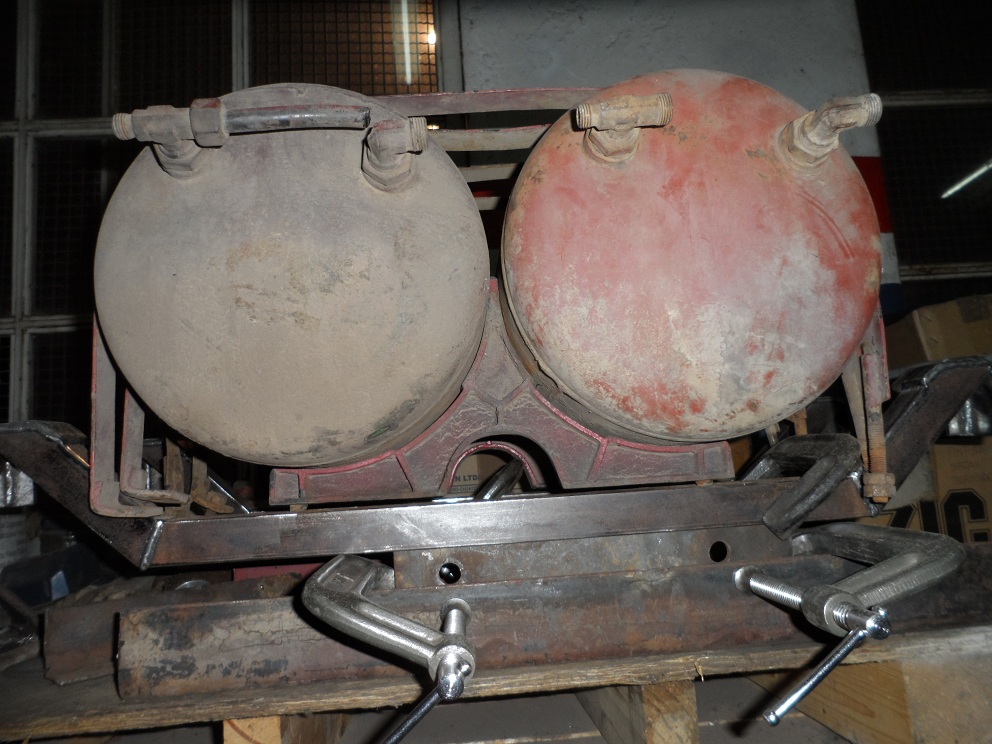

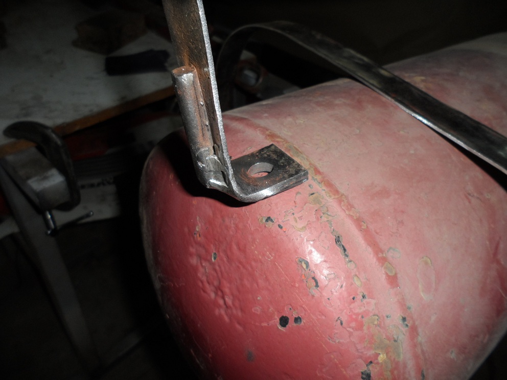

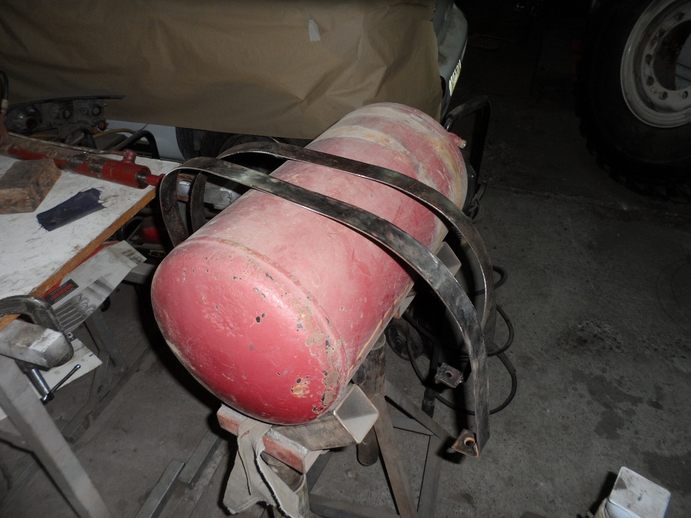

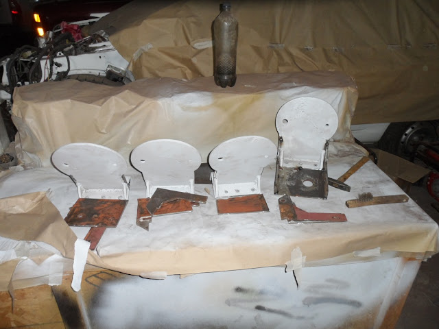

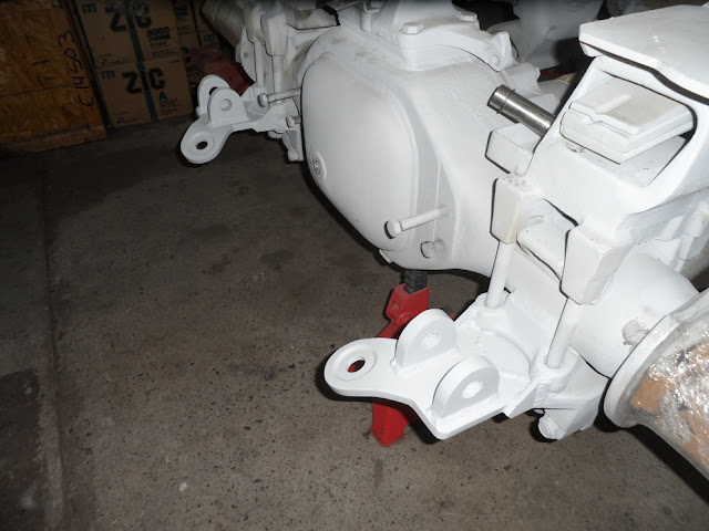

I had just finished the priming of the supports and the brackets of the air tanks and I had washed the tanks when I stopped, right?

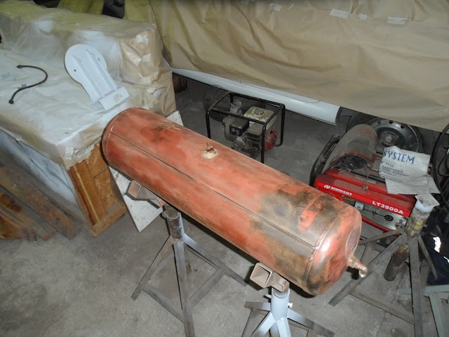

Once the air tanks were dry I took them in again and inspected them without the crust of dust and dry mud. I realized that thirty years of neglect had damaged the surface exposed to the dirt cumulated between both tanks and corroded it in a way that it would be hard to clean. I would need a powergrinder with less RPM so the metal cup brushes could last and the filaments would not end inlaid on the skin of my thigh.
Eduardo and I brang all the stuff to the cattle again and what was left of the frame of Spare was one more time amputated as official donor for the project. It was easier to cut the frame than finding it under the dirt and old leaves under which it was. We took the piece to the shop the next day and I marked it as precisely as possible.
Unfortunately, after almost two weeks, the spring saddle began to leak. But its fate was sealed and it would stay like this for the eternity; I had no intention of disassembling and making any other attempt to stop the leaking. I would check the oil level from time to time and that was all. I was really upset, but after a Darjeeling cup my anger subsided... a little.
The next day I went to the store to get the polisher/grinder. There were only two options, one of which was of the known chinese brand that deserved no discussion, so the choice was easy and I took the USA brand, made in China, of course. I had a lot to do that afternoon so I could not use it and had to leave it for the next day. And so it was.
Handling the new powertool at very “slow” 1000 rpm, very smoothly and without the vibrations and the many kilograms of the big Makita, I started to clean old paint, dust and rust from the first of the big air tanks. I did not want to peel the steel everywhere; the paint that withstood the brushing could last a little longer, especially if covered by many hands of washprimer, primer and new paint.
I had to use the laminated sand paper disc also, even if I did not want it, but the result was satisfactory.

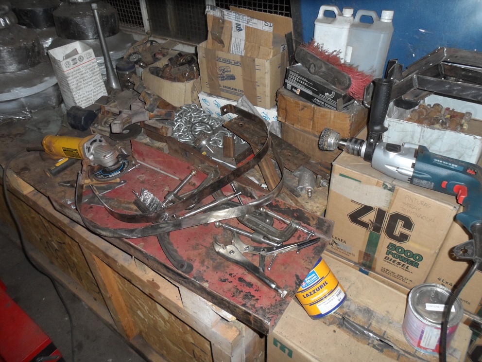

Once I finished the second tank, after many hours of labor and a lot of dust and rust fogging the shop, I put both clean tanks in place and the idea got shape. The height of the tanks allowed the free oscillation of the axle bellow and also to place the Box a few centimeters above.
The third of the tanks was one of Spare’s, and had many layers of paint, rustproofing, and some black thing that looked like tar. All this slowed hardly my efforts and forced me to use a lot the powergrinder. The dust cloud was huge, but fortunately I was alone in the Saturday afternoon. Naturely, I did not get to finish so the labor would have to continue the next week.

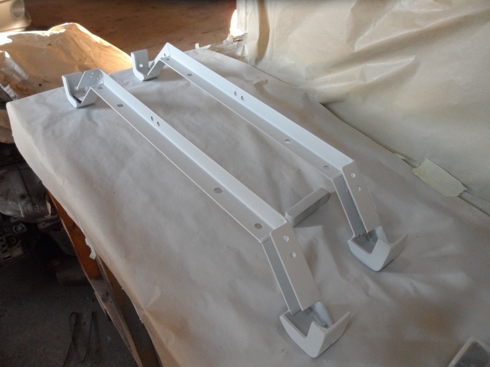

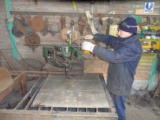

As there was a lot to do I took the powergrinder and started to cut the piece of frame rescued from the oblivion to get the pieces for the supports of the air springs. I cut and cut until I ran out of discs and had to go out to buy some more. I profited the ride to see how the rear sway bar repair issue was going. Everybody told me that, without any doubt this week it would be ready. Just a matter of trust, I thought.
I got back to the shop a little late so I cut just a little more before I received some nice criticisms because of the hour. I did not cut all the pieces, but at least I did something.
Going on with the non-existing working plan, the next day I completed the cutting and the marking of the pieces of steel and began to prepare them for assembling. Under the action of the laminated sand paper disc lots of different and ancient layers of paint and primers and stuff showed up like a rusted rainbow. The most important thing, other than cleaning the aspects that would be difficult to reach once the whole thing would be assembled, was to bevel the borders of the pieces for the welding to penetrate well and the union be solid.
After a few hours the pieces were ready and then I could began the assembling of the “new” supports. Once presented, all the components made sense. I felt a little disappointed because of the “excessive” time required to fabricate any piece or component. It was incredibly slow, but what the hell.
I only had time that afternoon to pinprick one of the supports and, for a change, it was late again. I marked pretty clearly all the single pieces and their location respect to each other so not to confuse myself the next session, as it would be a real mess to repair any error afterwards.
The next day I only got to pinprick the other three supports and I had to go out in a hurry. No time for more.

As always, after a recess of welding, the hand was a little shaky but a few minutes later the welding was solid and smooth. I was counceiled also by a client of the shop that introduced himself as a very experienced and qualified welder, and his tips were very precise and usefull.
I decided to weld with the MIG instead of using the arc welder because the steel of the supports had been heated enough with the primary welding, and I did not want to weaken it even more. MIG was okay and, frankly, I liked the result.
As you can see from the pictures I did not filled up many of the holes that the new pieces had, also for the temperature consideration and because they could be used to fix stuff or other purposes.

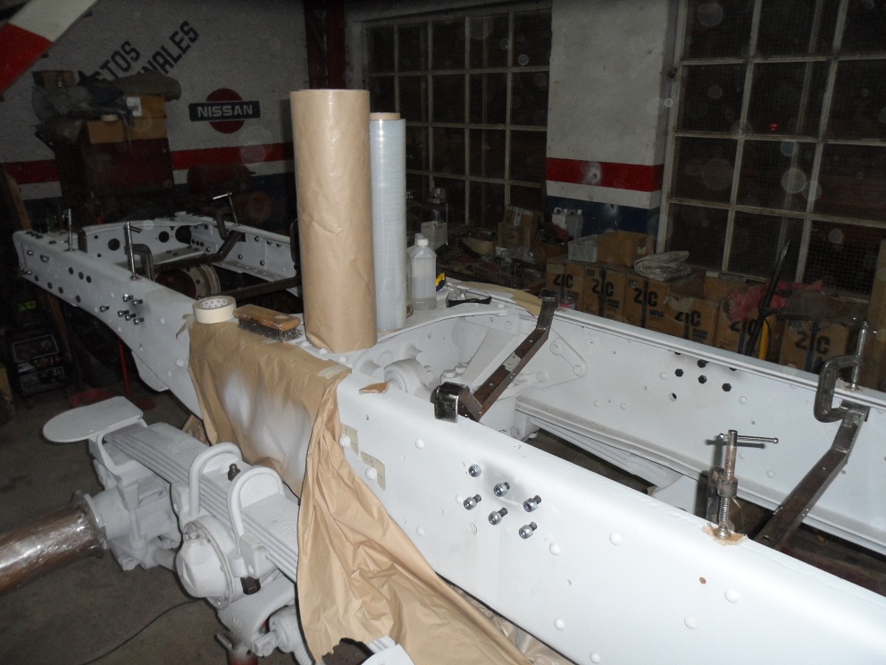

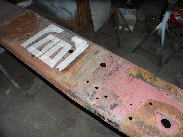

I presented the supports and marked where to drill the holes on the frame, and then it was time to go home, again. Before I left I put on one of the air springs just to make sure that there was not conflict with the support or with the bolts, for the tenth time.

The rest of the afternoon I stayed at the shop drilling the eight new holes on the frame using the same old drill tips sharpened by the skillfull hand of Juan Orrego, a technician from my job place. At each millimeter of advance I stopped to lubricate and to allow for cooling of the tips so it took me several hours to finish, but in the end the tips were intact. The problem was that I had not a proper powerdrill nor a proper tip to drill the holes for the rivets.

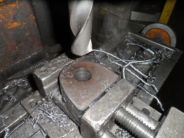

I also profited of the machines and the good mood of the people and drilled the 22 mm. holes in the vertical plate of the supports in conflict with the rivets. I love big industrial powertools.

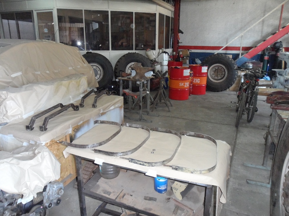

A couple of days passed before I could go back to the workshop to work on the truck, I did not remember why, but when I could I finished the cleaning of the last of the big air tanks and put it in place aside the other three. The amount of tecalan hoses would be monstruous, I thought, but they would all be fixed and orderly displayed in ad hoc supports.
After the measurements and the pictures of rule I took all the things out and displayed them for printing. I only reached to apply two hands of washprimer before it was time to leave.
The next day it was too cold for priming so I decided to speed up a little the work at the machine shop, and it ended to be a very good decision. The pieces for the new supports were already cut and it was just a matter of assembling them, as someone said carelessly. Well, the job of “assembling” ended up being much more difficult and time consuming than I could ever think, as every single thing in this project.
Firstly I put some pinprick weldings to drill the “ears” in couples, then the boys showed me how to use the drilling machines and, pretty slowly and carefully, I drilled the steel. I had to use both the two drills as the regular work of the shop required of them alternatively. It was bloody cold but with all the efforts and the security gear I sweated a lot.
When the working day was about to finish, exactly 30 second before the power was automatically shut down, I finished the second pair of pieces. It was also more difficult and slow because Verardo made them from T1, a harder steel especially for making bushings but more difficult to work with.
The turner said that he would mill the base of the pieces to make them even to place and weld them to the base plate the next day. With that feeling, after a good chat with Verardo, I went to pick Carmen and then, directly, to the shower.

Later, at home, I drew the tray that would be the platform for the winch. For the laterals I would use scrap from the rest of the frame of Spare, but I wanted something tougher for the base plate, something in 8 mm. The location had to maintain the 45 degrees of the departure angle and at the same time use the holes already present on the frame. The tray would serve as well as the base for the pivoting rear bumper, and all the sketches and calculations fitted perfectly.
I know…I know… the rear bumper issue would be a long story on its own. Anyway…
As I was at it, I corrected the design of the supports of the sway bar and also the rear shock absorbers, which were eliminated and replaced by the actual design of those I wanted to put on the Merkabah, same as those that went on Finca and on Le Camion.The front shocks were also replaced as were many other little things according to the illumination state of the subscriber, until I hit the screen of the laptop with the forehead, tumbling asleep.
I went back to the machine shop and Pimentel, the turner, could not avoid my presence and insistence so he could do no more than go on with the Merkabah’s pain. We made a lot of pirouettes to turn the recess for the rubber washer of the shock absorbers, faithfull replica of the original supports, but we could not finish both support plates that day and we continued the next one in the afternoon.
Once we finished, the press operator heated up the plates and bent them 15 degrees. His goniometer looked not pretty solid but it ended up being very precise.
When the baseplates were finished I grinded the drill holes to let the pin pass through the “ears” without much difficulty, and finally aligned them on the baseplates.
Re: Mercedes 2626 AK 6x6
As it was not really my place I just pinpricked the pieces and asked the welder to weld them seriously. He made me heat the pieces up with the torch for some moments and then he worked with the MIG with 1,2 mm. electrode (mine is ,8 mm.). The result was pretty satisfactory and, of course, a few moments later the power was shut down for everyone to go home. The supports were still bloody hot when I left them on the workbench.
The next day the turner not even looked at me when I showed up at the machine shop. He had promised that he would turn the plastic bushings for the sway bar once I welded the pieces of the supports, so he dropped what he was doing and began to turn and turn, leaving a lot of plastic yellow shavings on the ground. I had to dedicate myself to grind again the drill holes of the ears because there had been some deformation with the welding, minimal but enough to impede the pin pass to enter.
While Pimentel was at work, turning each different bushing with different measures depending on the side and on wich arm of the sway bar, I went to poke around the discarded material and I found a half rusted steel plate 8 mm thick with a myriad of tiny holes on it. It was a T1 plate that was around for the last few years, with no use at sight. Verardo did not think it twice and donated it to the project so I asked the cutter if he could cut a piece of it after I maked it, and for answer he just passed me a piece of chalk. He adjusted the pantograph and with a couple of torchblowings he cut the perfect base plate for the tray of the winch, with just one little drill hole in the middle. Coincidences do not exist.
Well, the turner did not finish the bushings that day, so I loaded the steel plate on the Montero and went back to Eduardo’s shop to mess with the winch again. I measured and marked where to drill the mounting holes and I grinded the edges to make them even and smooth. I think I even saw my name written on the plate.
The turner completed his job without me going after him the next morning so I just picked up the sway bar and the supports from the machine shop and put them on the Montero to get them back to the workshop after many months of neglect and pain. I could hardly wait to weld all to the axles! When I asked Verardo about the bill he looked at me with his typical enigmatical smile and told me: We’ll see later! - Great guy, Verardo.

I fixed the supports with some weld pinpricks and then I had to leave as the time had passed and there were some hungry faces looking around. It felt like I had made huge progresses in the last few days. Good.
When I came back to the shop I prepared everything very calmly to avoid making the typical errors of hurrying. I checked it all and found that the supports were a little inclined but nothing too significant so I went on. I also noted that, even if the steel was thick, the lever would be brutal; it would need a reinforcement for me to feel sure and relaxed. I tried with a little fin on the inferior face but it did not convinced me so I decided to put simple squares on each side, welded also to the superior piece of the axle bracket. I had no intention of disassembling the bracket so if it became a solid piece I did not care at all. Yes. And then, to cut the little pieces.
I prepared the little arc welding machine and left a lot of 70/18 electrodes at hand. Then, blowtorch in hand, I heated up the steel until I felt it all was warm enough. The rest was heat and sparks, and I really liked how it sticked and looked. Welding downside up is always tricky but the welding of the inferior face of the suports was not bad in the end, though hard to perform.
When the pieces cooled down I cleaned and polished them again. I was very happy, as you can imagine, and with that feeling I left because I needed to care of the job that maybe makes me not as happy but gives me the funds to play with the truck.
And, finally, there was a sunny day in San Felipe, so I dedicated the first part of the next afternoon to priming, starting with a couple of hands of washprimer on the new pieces and then one hand of primer applied to all the pieces that were left unconcluded many days before. I had to sweep, brush and powerblow everything before starting, of course.
As that particular day there was a lot of work to do on the workshop and the people were going to do late I profitted of the circumstances and went on with the tray for the rear winch. I had taken a couple of discarded L profiles from the machine shop before and with them I made the support for the roller fairlead. The fact that it came separated from the winch was actually a good thing because the bolted support would make more difficult for anyone to steal the winch.
I adopted as a rule to heat up the pieces before welding, even if it was warm, because the difference was truly noticeable. Even the sound of the welding changes when the steel is hot, and the risk of micro fractures is quiet lower.
I ended up with the support pretty late, but fortunately the guys of the shop finished their jobs at the same time. Carmen invited me to dinner out. Everything was perfect on that long but pretty productive day.

Considering the air tanks, two comments:
- I would have used a single mount for each tank to deter one tank from rubbing the other. Sand and dirt getting there during operation will be quite abrasive.
- rusty as they were, have you checked it from the inside? Nothing as bad as rust particles from the tank contaminating all the air valves.
Cheers
lots of work...
Cheers

Very nice update again ! Thanks for taking the time for writing it down and share it with us.
Can I ask what software you use for those 3D drawings ?
Keep up the good work!

@ Uwe: The tanks are not in contact, there is a plastic separator between each other as you can see on the next picture.
No tank had rust or foreign bodies inside, just a fine covering of oil. One of the little tanks had some like half a liter of water but it seems that the oil protects pretty well the interior from rusting.
@ Hajo: The three blue water tanks are fresh water tanks, the one on top for potabilized water (heavy three stages filtration and chlorination), the other two for receiving water from whatever source. The trapezoid tanks under the Box over the rear wheels are for grey water (left side) and black water (right side). They will be filled up by gravity and their capacity is near 70 liters each.
Edit: all the tanks will have interior wave-brakers. Each of the exterior tanks will have exactly capacity for 97 liters .

@ a90: I use Sketchup, from Google. It is not worth to get the Pro edition; enough with the free one (at least for me).

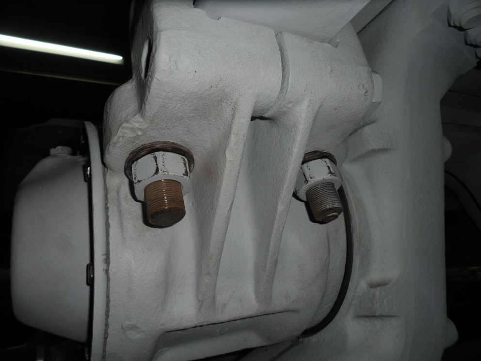

The next working time I had two goals: to apply a second hand of primer to the tanks and to drill the mounting holes on the base plate and on the support of the roller fairlead. I enjoyed spraying primer but God, I really hate drilling! Well, I did it anyway. I spent the whole afternoon at that.
I went to the shop at lunch time to look for some tools and found Dakar sitting very comfortably on the roof of the Merkabah. He came one day, a couple of months ago, lost, afraid and alone, and the people there adopted him immediately. Two nights after he chased out a couple of thieves that wanted to break into the shop through the front windows. Coincidences do not exist, remember? The little but fierce dog earned his site so he can sit on the roof or wherever he wants, whenever he wants.
Well, the sway bar was still greasy and dirty so I gave it the classic treatment. I then put it on its supports and went on with the installation of the supports for the struts on the frame. The height of the horizontal portion o fthe bar was ideal, with a slight inclination to keep the departure angle. The challenge was the mounting of the supports.
The supports had many threaded mounting holes that allowed to mount them in different positions, but the problem was that just one of the holes was useful and there was no other that coincided with the holes on the frame. To drill more holes on the frame rail would have contravened the specific directions of the maker on the subject and, even if it was reinforced by the auxiliary frame rail, I wanted not to take any risk of breakage.
As there is always a way out for everything, the frame rail had the original mounting holes on the inferior wing so I decided to use them and to modify the supports instead of drilling. I planned to weld a perpendicular plate to the support and then the forces would be managed by the plate and the only one bolt to the vertical part of the rail. Enough, but I had to be sure of doing a pretty good welding.
With that plan I went home, hoping the weekend to bring some rain and quiet, but it did not.
As there was finally not rain (at all) I went to the cattle and took another piece from the abated frame of Spare. I needed steel to finish the winch tray. There were no tears, but I really felt sorry for the remains of the former colleague of the Merkabah.
I had dedicated myself heart and soul to the project for many days and, even if I also gave some time to Deva, the recently adopted German Sheperd, it seems that for the dog was not enough and she made her point pretty clear destroying the coverings of the Africa Twin and the Terrano. I would have to take her to run more often to burn energies, but my left ankle was still not in shape for long or frequent runnings. Hmm…

Back at the shop Monday afternoon I cleaned carefully the inner face of the supports, cut and drilled the steel plates and pinpricked them in situ to keep the right position of the ensembles. Then I heated the steel up, a lot, and put many 70/18 electrodes on the job, welding also a perpendicular piece to stabilize the union. Good, but it was pretty late when I ended, for a change.
A couple of days later I continued the work and cleaned the supports completely, including the threads that could still be useful, who knows what for or when. The struts followed but they took more time because of the shape and the differents components. Note that Pimentel preserved the original plastic bushing and turned a plastic sleeve to adjust it to the worn hole of the strut. Pretty good job.
I did not get to finish not even one of the struts that day, but at least the supports were ready. Looking at them I found that the solution was pretty dependable… we would see.
In the meantime, the last arrived piece of frame stood still in silence with resignation, waiting for its own turn.

Well, not pretty much to say or show but the work has been hard though I had very little time, but I managed to finish the cleaning of the struts for priming, but they would have to wait until the winch tray was ready to paint all at once.
Then I took the new piece of frame and struggled a little to separate the main from the auxiliary rails, bonded together by inescrupulous ancient weldings, and marked it to cut the lateral parts of the tray.
As I marked it by heart from what I remembered been designed on the model I made some mistakes and I missed for 15 millimeters extra on the height of the pieces. I realized that I was really obsessed when I was preparing everything to cut those millimeters, wich made no sense because the difference was completely negligeable and it would have consumed time and one disc almost completely. WTF… it would remain as it was.
Before cleaning and leaving I put the pieces in position to organize ideas as the tray had to be built tough enough to withstand the forces that the use of the winch would demand, if it was ever used.
During some periods of very few productive activities I gave some thoughts to the batteries issue. The original idea was about four deep cycle batteries for domestic use and the two batteries for the truck, all put together in the same locker bolted to the frame on the left side behind the cabin. The new plan was of eight batteries plus the other two for the truck. It was not possible to recycle the battery trays from the Merkabah and from Spare because I needed more space, so I designed a cage made with steel L profiles, as simple and robust as it could be to handle the 500 kg and more that all the batteries might weight.
I could have accommodate even nine 105Amp batteries of the same model I already had, but I was trying to get other 170Amp batteries of the same make and model, and they were taller and heavier so better be conservative and keep the number as initially thought. It is really fantastic to play and try things before even touching them!
By the way, the cage is shown without the diagonal reinforcements, I mean… for those who care about the strength of the invention.
As the investment in batteries would be not minor I decided to change the design of the locker for one that could offer the less possibilities for them to be stolen. The “cover” would be in the inner part and the container skin, made of 3 mm steel or alluminium, would be removed as a whole, like a five-sided cube, and would be bolted to the cage by four or six Allen or star bolts. Besides, it would have two heavy duty key-locks.
Fixing the locker to the frame would also be a challenging matter because I would need a series of custom tailored profiles to deal with the bending of the frame at that part of the truck. A pretty similar layout would be used for the generator locker. There was still a lot of things to deal with.
I rescued a long piece from the wing of the rail frame and cut the extremes at 45° and did the same with the laterals of the tray to create a solid union.

Hi there, Pairoa
If I understood correct, you plan to have a box on the left side (batteries) and a box on the right side (generator). In my car, there are footboards under each side of the cabin which are fastened with L-profiles to the frame. To get some stabilization, there is tow rods (one to the front and one to the rear of the footboards) underneath the frame to connect and counterballance the forces in the footboards when one stands on the edge.
I would think something similiar would be good for distributing the weight of your batteries.
I personally would not - with that much batteries planned - put all in one place. Perhaps 2 starter (vehicle) batteries could go (one over the other) in the box with the generator. In winter they would be warmed when you run the generator for microwaving your morning coffee milk
and help cranking the motor with good power...
And of course you will have to mount a strong power generator (or two, seperate ones for vehicle and for domestic power) for charging these masses of batteries... 9 x 105 Ah + 2x 110 Ah for the truck = ca. 1200 Ah all have to be loaded (say you want to replace 10% charge during 2h of driving) -> 60A with 13,8V = 828 Watts. Perhaps this is the wrong way to calculate...somebody may correct me, please.
Also to consider: How to lift the large batteries (44 kg each) into their place inside the rack...and how will you fix them in place?
Aber nichtsdestotrotz: Weiter so!
Gruß, Hajo
edit: looked up the weight of 170Ah batteries

The last subject of worry was the fabrication of the support for the rear shock absorbers, and checking among the stuff I found many kinds of pieces of steel and old parts, all of them doubtfully usable for the task. Nothing convinced me completely.
At some moment, though, I stumbled with one of the cross members of the frame of Spare that I had kept for “who knows when this thing will be useful”. And so it was.
I removed the fiercely stuck rivets and then took out a long strip of metal by its whole length, just to make the shocks fit in. I then cleaned the inside face and it was ready for welding. I used again the MIG welder and I liked pretty much the result.
I realized that I would not be able to manipulate the pieces unless I removed some stuff so I took out the air tanks and some supports from between the frame rails. Pretty boring.
Fortunately the hole for the nut that held the support for the strut of the sway bar was perfectly placed and there was necessity to drill only one more hole to fix the cross member to the frame.
I reduced the width of the crossmember with a pair of precision cuts (!?) and drilled the fixing holes on the borders and cleaned the piece for good.
After a few contorsions I put the crossmember in place and then marked the right height and inclination using an old shock from Spare as guide. The separation between the crossmember and the air tanks was of only 12 to 15 milimeters… as previously calculated… of course.
A few minutes later there was another couple of drilholes on the frame of the Merkabah.
Well, I am a Little late with the updates but I will do my best for everything to make sense.
First of all, I really loved Peter’s 6x6 build from the beggining, thanks Unfug, a clear, nice and elegant approach for a wohnmobile. I will talk about my hesitations on the subject of the battery bank as I go on.

I began to drill the crossmember for the pins of the shock absorbers, but unfortunately I did not have the 15 mm bit that was needed. It would have to wait until I took it to the right place, the next day.

On the 3D model of the Merkabah I drew also the cross member for completeness, with less details though, and following Hajo’s comment I took out the two batteries of the truck from the container of the domestic batteries and put them in the container of the generator. The container would then be smaller, easier to build and more resistant. I also decided to put it behind the generator instead of in front of it because it was easier to bolt on the frame in that order.
When my regular work ended the next day I went to the shop and picked up the crossmember and went to Verardo’s. At the machineshop the workers looked for the right drill bit and one of them drilled the piece in a few minutes. Then I went back to the workshop and spent the next three hours finishing the cleaning of the pieces, powerblowing and sweeping the whole working place. It was quiet dirty, with many kilos of dust, metallic debris and lots of small pieces of steel.
I reached to put all the pieces that needed priming in place and, suddenly, I ran out of time and enthousiasm. They would have to wait another day or two.

For a change, that precise next afternoon it was raining and the temperature was pretty low so no chance at all for priming. I shrugged and went on, looking for the parts to assemble the wheel hubs. It took a while to gather all the pieces, and when I had all them together I felt some kind of panic; it had been so long… what if I did not remember the precise assembly sequence?
I tried to open the Mercedes EPC page on the computer of the office but my subscription had finished just two days before, and I did not remember (neither I still do) the PayPal password to renew it. I then got the notebook and put it at hand, pretty close even if there was a risk of damaging it, in case some photographic reference was needed.
The process that followed was pretty slow as I realized that before assembling I would have to deal with the many retainers of the brake camshaft, the primer that went into the bolt holes and a lot of difficulties. A couple of hours passed among searching the piece, sanding the primer, putting it on, taking it out, looking at the picture, putting on the forgotten washer, taking the picture and so on.
In the end I just reached to put the brake shoes brackets and the brake camshaft on the left side of the third axle.
The sun was shining the next afternoon and it was pretty warm so I sprayed washprimer and primer all over and, while waiting for the paint to dry between hands, I went on with the assembling of the brakes. Every piece had to be cleaned and hand or/and power grinded before assembling, and I checked many times before putting them on for good to reduce the danger of mistakes and the need for disassembling. I also lost some time when I had to go out to buy some bolts, nuts and washers that were not in the original plan.
I put the brake shoes after struggling with their deformed pins and after having to take them out because I forgot to grease them before as they had no grease points. Well, at least I made some progress and went a little farther with the brakes of the right side of the axle too.

As Unfug pointed out very wisely, I gave a second thought to the containers for the batteries and for the generator. They were planned to be bolted to the frame, pretty tight and secure, and for at least 130 cm deep water crossings, but the waterproofing depended on the integrity of the cover. I did not think, even for an instant, that they would be closely exposed to the rocks of the roads and to any kind of traumatisms of the offroad driving that, for sure, the truck would withstand. Hmm…
I trusted the design but I forgot that little detail called inprevidibilty, that has much to do with Murphy’s law. I then put experimentally the batteries in the only place left for them, under the bed in the main locker at the rear. I did not want to put them in the Box, but seemed that could be a not so bad option given the circumstances, though the last word on the subject was far from being spoken.

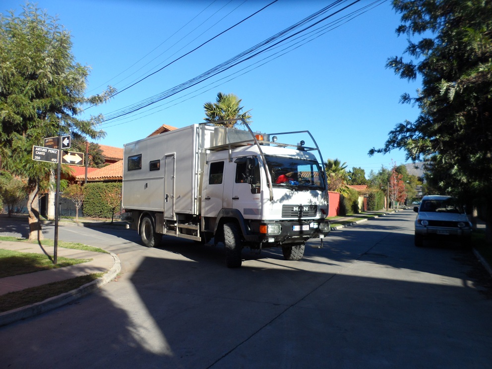

Hello Pairoa,
Wow what a great job... We worked on our Man Kat1 6x6 for about 5 years...and now we travel since almost 4 Years...saw about 25 country's so far...
If there some question I might help, just let me know... Take care
Petra and Stefan
