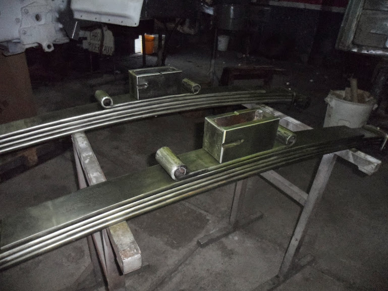

Next on the list was to prepare, paint and install the spring packs and to clean and free the area under the truck from big pieces and parts. I payed a lot of attention when moving the heavy packs and also when manipulating the power grinder during the tedious and noisy job of cleaning not to harm my back. The spring pack of the copilot side was clean of oil so it didn’t cost too much, just the usual patience.
When the steel shone I left the leaves on the bench and wrapped them with paper to avoid them collect dust and to work less when the time to paint them arrived.

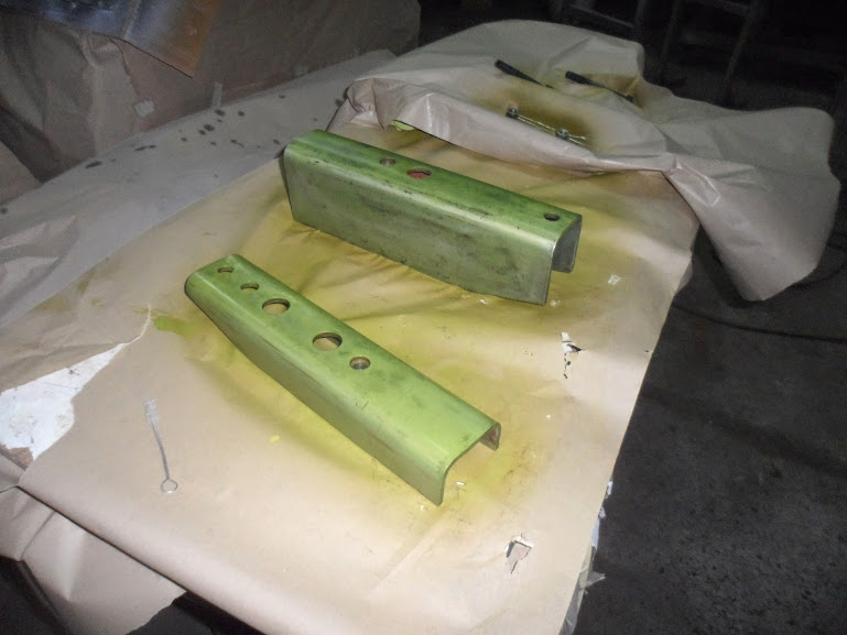

Waiting for the spring leaves to dry up I took the new ones built to hold the shock absorbers and prepared them to remove the paint, with which they were kindly delivered, and fixed a little the pretty rough finition of the bent extremes. Yes… I know… but I can do nothing about it.

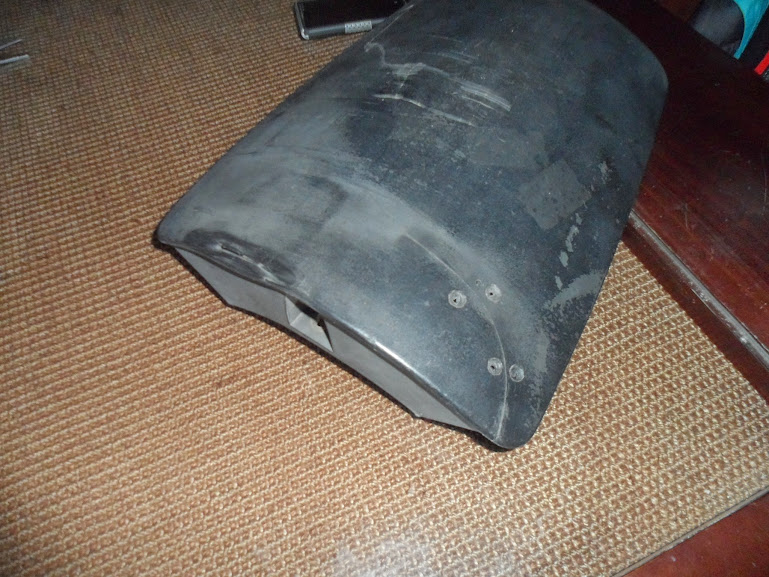

You need some practice to get the right amount of hardener to put on the plaster for it to harden when you need it, not before, not later. After a couple of tests I went for the deflector and applied the plaster, sanded with four different types of sand paper, refilled some defects and sanded again until I was happy enough with the result. I really enjoyed working with the plaster and the idea of doing myself the plaster work for the repair of the cabin started to turn again in my head. Another specialty to practice for widening the alternative curriculum.
Monday after Easter. Moderate backache, still unable to work with heavy loads. Hmm…

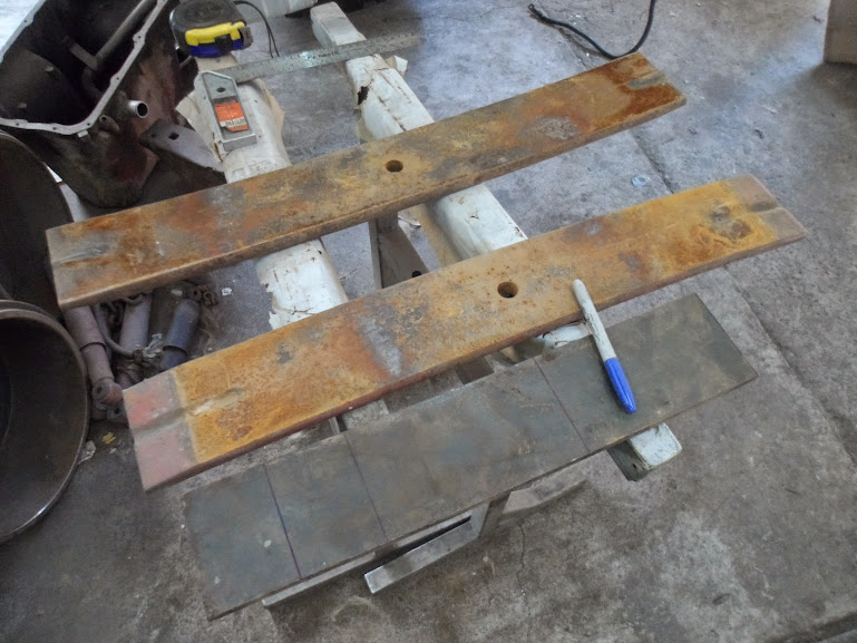

The only item left unsolved for the assembling of the front suspension was the fabrication of the supples to fill the space left by the removed spring leaves. I was about to go out to buy another piece of steel but walking around the truck I found discarded spring leaves everywhere, thus a lot of steel to use. I surely was never going to sell or use them elsewhere so it was okay to pick some, very carefully, the less curved ones, mark and cut them to the proper dimensions. The 70/18 arc weldings would be more than good enough to hold the properly prepared pieces together.
The leaves from the rear spring packs were almost one inch thick, perfect for the task. Paying attention not to stress too much my spine I cut the leaves very slowly and carefully. The big pieces showed some curving but it was negligeable from the aesthetic point of view and irrelevant from the structural one.
Naturally, the hand held cut produced more than slightly irregular edges so I had to work hard to fix them and correctly align all the pieces together.

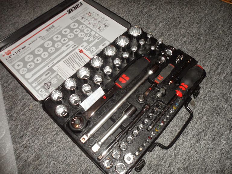

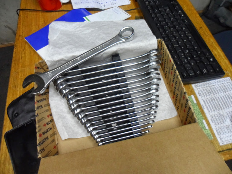

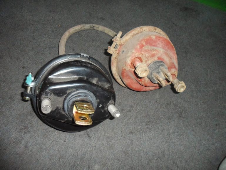

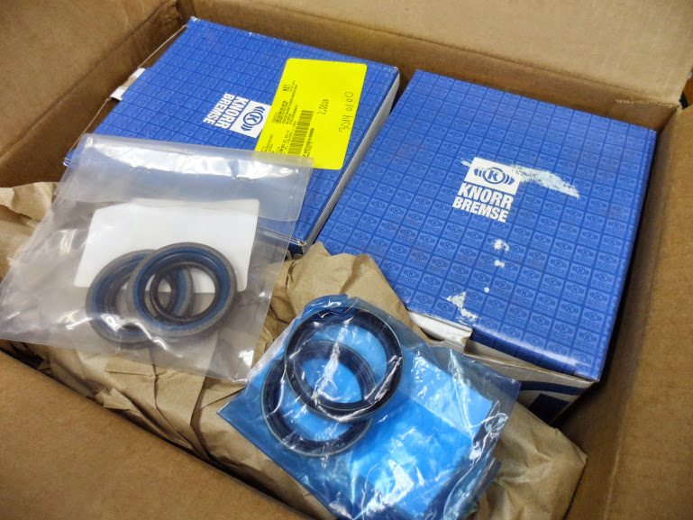

A couple of days later three packages arrived from Santiago and were ready for me to open them up when I came to the shop. One of them was from the Mercedes dealer and contained the retainers of the front brake cams, a couple of o’rings for the brake shoes and both brake chambers replacements. It was impossible in the end to find the right spare for the rubber bellows and so I decided to buy the whole thing.
I bet the quality was by far not the same but I just hoped that the new brakes would do the job better than the older ones. They did nothing at all, indeed.
The other two boxes were a gift I gave the Africa Twin, the Yamaha and the Montero: brand new high quality tools to work with on them at home and, of course, they would be the tools on board when travelling. The Würth guy make me a big discount, fortunately. They looked and felt pretty good!

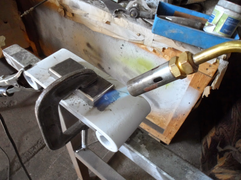

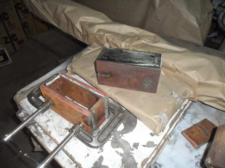

Welding the pieces of the other supple block together was all I could do that afternoon, but I felt not pretty good because of the damage done to my beloved cells by the filthy viruses of the flu, so I took one picture when heating up the steel for welding and then I just welded and welded and finally went home.
The flu finally won and threw me down to bed three days, the whole weekend. I had to get up and work Saturday morning because unfortunately there was nobody to replace me; that made the illness worse and last a little longer, I guess.
Monday morning I was back on my feet and went to work feeling almost good. In the afternoon I still felt a little weak but grabbed the powerginder and grinded and then polished the new block supples. I used the new pedestal drill to perforate the superior plate of the supples meant for the center bolt. It would have been faster with the regular drill, but my hands, my forearms, my shoulder and my back were pretty happy and gratefull to the new tool.
Once the block supples were finished… yes… it was time to go home. Christ! So slow! So many days to fabricate these two pieces only.

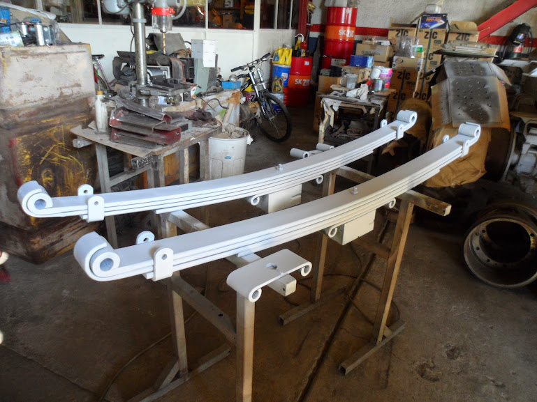

I devoted that day to work on the spring packs and get them ready for painting. First of all I grinded a groove on the inferior border of the supple blocks and modeled a prong from welding into a groove carved on the base plate. I did not want the supple block to slip from its base and the head of the center bolt would not be there to prevent it. I thought that this trick and the tremendous torque that must be applied to the U brackets would be enough to keep the mind’s peace. Many others that had put block lifts haven’t even used any means to prevent them from slipping and have had no problems… to my knowledge.

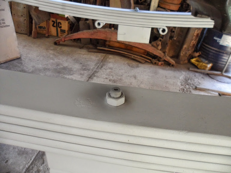

I assembled the left side springpack to test the length of the center bolt and it was okay, though a little cutting would be useful for the U bracket support to be put on top of it.
Seeing the pack already assembled an idea started to grow on my mind: why not assembling both spring packs and paint them like that? Was it worth to prime each leaf individually and then assemble the pack, as I had done with the rear spring packs? Hmm… tempting. There were other considerations also, as the need for help to put the pretty heavy assemblies back on the frame instead of the easiness of doing it leaf by leaf, for example.
I gave the idea a few second thoughts and finally decided that it was better not to spend time and efforts and to paint the assembled packs, so I got both spring packs ready and the center bolt torqued. When the moment came I would ask for help, if needed, as always.
When I unwrapped the leaves of the right side spring pack, though, they seemed to be less clean than the newly polished and assembled ones, so I had to give them a second hand of abrasive disk and metallic mesh before assembling. Yes, yes… I said I know.
The assembly itself was not as easy as it sounds either, of course, and I had to use the lime to adjust the holes drilled on the supple blocks and on the smaller leaves because the center bolt did not fit in, and the steel with which the spring leaves are made is a very damn hard one.
I swept the whole place to remove the dust, all the gritt and dog hair that covered the floor, preparing it for painting. It took me quiet a bit to do so and then I powerblew everything at sight. Then I swept the floor again and ventilated the entire shop with wide open gates for a while.
After many hours of work the pieces were washprimed and I could finally go home, tired but happy. We had a very nice and delicious dinner out.

Monday afternoon. I went directly to the box where the painting gear was stored and prepared the primer. Two and a half hands, according to the instructions. What the hell means two and a half hands?
This time the primer itself gave me no trouble but I had some problems manipulating the containers and the paint gun and I spilled out some of the primer on the bench. It was a mess.
Finally, at least three hands of primer were applied to the spring packs. Good. I cleaned the paint gun and the containers and put them back in their box. I then looked for the shackles to continue with the assembling of the suspension and… guess what? They were not primed! I just put them in a box after cleaning them and did not finish to prepare them for assembly. I did not remember that.

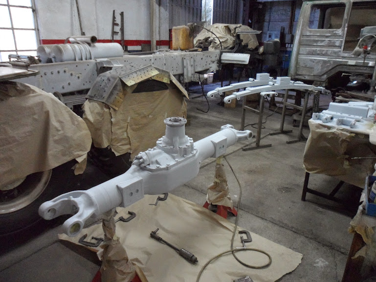

When I put my hands on the truck’s pieces again, which seemed to be more and more difficult each time, I prepared the scenario for painting. Sweeping, blowing, sweeping again, put some masking paper, etc. As I was not keen on priming only the two schackles remaining I prepared also a few more pieces and then I sprayed them all with washprimer. That took me the whole afternoon.
Back at the shop the next working day the idea was to prime everything at hand so I took also the front axle and swept again all around. It was a great pleasure to apply the primer to the big piece of steel that stood still, hiding behind the workbench for so many months. Alejandro helped me to move the pieces as required, and my back stood pretty well. I primed untill there was no primer to paint with. Good. Everything was ready to begin the assembling of the suspension… or so I thought.

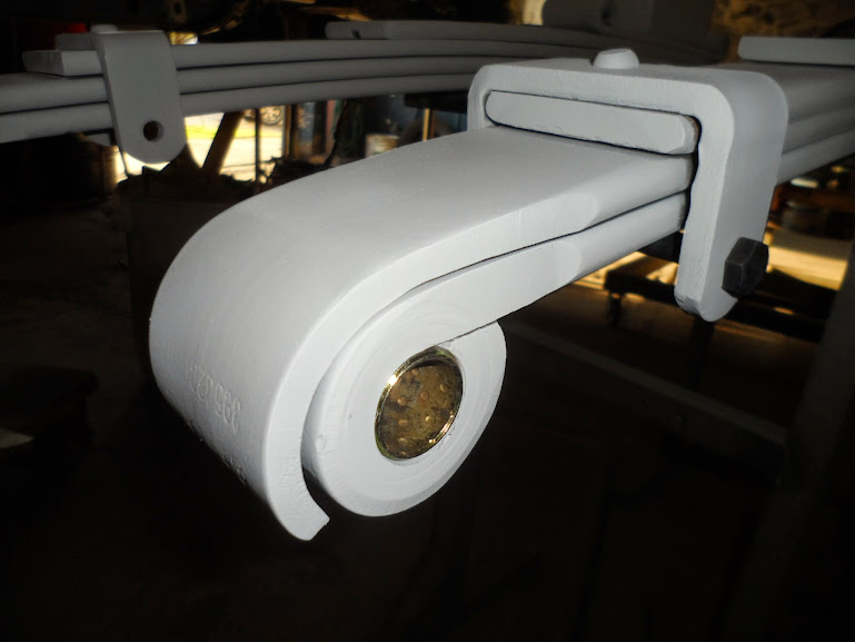

I took a couple of the original washers and made a try to put on one of the shackles. The manoeveur was not pretty difficult but was neither easy; I wanted to avoid using any kind of lubricant to help the assembling for it would ruin the definitive painting of the frame.
Went to Verardo’s machineshop and asked him to turn the washers as I had many times looked for them in the past with no success. The villains that serviced the Merkabah replaced the original washers with some local ones with different sizes and properties, as usual.
To make time, back at the shop, I went on with the cleaning of the antifreezing container. It looked gorgeous… like some polished piece of machinery of an ancient old locomotive in a museum. I had the hint on leaving it like that, but obviously it went not good with Merkabah’s colours so black or grey would be the options.
I went to pick the washers late in the evening, and Verardo recommended to treat them before putting them on, as even if they were turned in Adamantium or something as hard as it, they were not as hard as the original ones. It was too late for experimenting so I got the two old Mercedes washers remaining and went on with the plan. Alejandro helped me again with the heavy spring packs and we both put them in the right position under the frame.

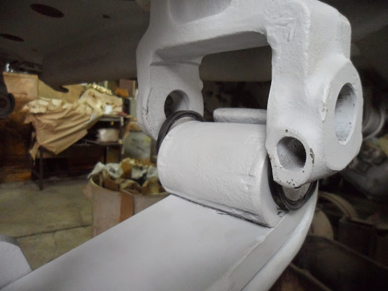

No matter if I put all my strength and patience at work, I could not put the washers nor the pins, so I left it all as it was and went to work to bring bread to my table, like every Friday noon.
Saturday was a day full of social and family events. No time for the Merkabah. Sunday was Mother’s Day, but Eduardo and I managed to go out for a ride after celebrating them properly. Darkness caught us when we were back on the asphalt road so there were no really dangerous situations, just dust, rocks, sweat and fun. On the picture you can see my brotherinlaw helping to fight the dramatic dryness of the Putaendo valley.
On Monday afternoon the first thing I did was to heat up the new washers, to almost 500°C as recommended, and submerged them in oil. This way they would become more hard but not too brittle. Hmm… we’ll see.
With a little help of the jack, pian piano I reached to accommodate shackles, rings, washers and pins. Once I got the right moves it was easier to install it all and soon the spring pack of the right side was ready, back where it belonged. Every piece aligned perfectly with the other. It looked pretty good, as everything that becomes renewed.

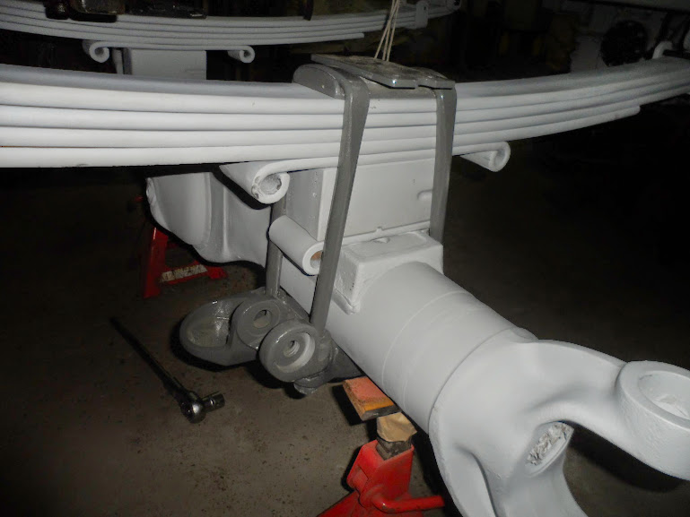

But the real trouble started when I tried to replicate the manoever with the left spring. To start, the rear shackle had been struck and there was a little deformity that I had to correct with the lime. Then, the washers were 2 tenths of a millimeter wider than needed, so I had to rub them against sand paper for long, making my fingertips ache like hell, until they were fine. Following, I had to use the jack to move millimeter by millimeter back and forth the heavy piece because the rubber washers were pretty hard to accommodate on this side and I wanted not to damage them.
To take the following picture it was necessary to make many tries and a lot of time to get the spring that deep into the shackle without ruining the rubber seals, but it does not actually show it.
The worst came at last, though, as always. The spring pack was a little twitched and even if I used the rope to help me align it with the front support, the borders of the curved extreme of the mother leaf were not parallel and thus there was no possibility to make the washers fit in. I had to use the powergrinder and grind straight the sides of the curved leaf, with a lot of patience and in a very uncomfortable position. It was really difficult and exhausting, but there was no other way as I wouldn’t take the spring out again for any reason.
Finally, I made the washers fit and introduced the pin halfway and then it blocked. The twitching of the spring made it hit against the bushing. I gave up and left, heading home, with my body aching after all the physical effort. I guess that the torsional forces may have played a role in the making of the worn hole of the original spring support, but the truck had been badly overloaded so, who knows for sure.

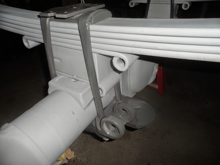

The next time, I took it with no hurry but with no pause. I got the spring support loose, pulled a little the support with the rope, counter-twitched the spring pack with a big lever and with my whole body weight (it just moved three millimeters, anyway) while Alejandro pushed the pin deep in the bushing with the rubber hammer, very nicely. I then bolted the support back on and torqued the bolts and finally put all the lockers for the pins in. Ah… good.

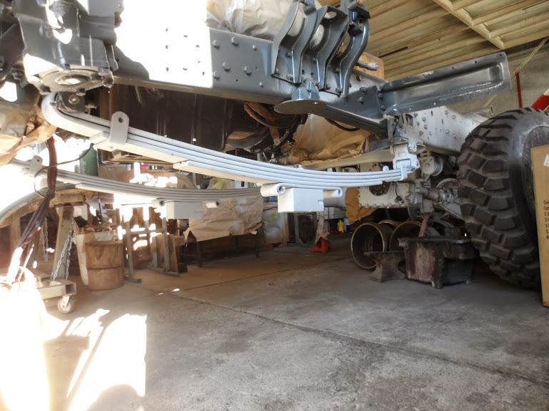

To my eyes the “new” springpacks looked spectacular, especialy after all the trouble. A couple of pictures and then make order, sweep and clean it all up again for the next step: installation of the front axle.

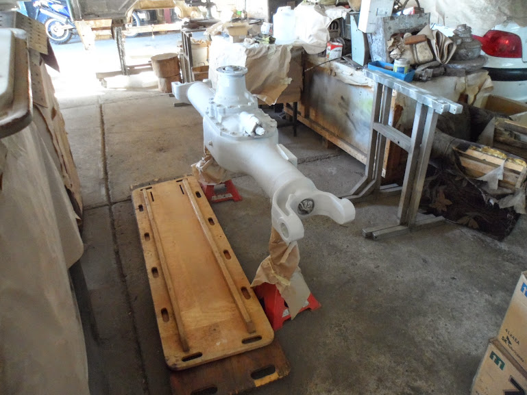

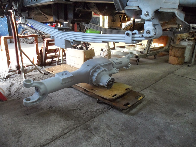

I thought about the best way to take the axle from the stands to under the frame and after half a cup of tea I concluded that I was going to use the old wheeled creepers. There still was a couple of them somewhere and when I found them I took the wheels from one and put them on the other to double its capacity to stand the weight of the axle. Put one creeper on top of the other and went to look for help for taking down the axle as I was in no way able to do it by myself, but everybody was busy.
pairospam
Beiträge: 927
Registriert: 2010-11-22 14:27:25
Re: Mercedes 2626 AK 6x6
#556 Beitrag von pairospam » 2015-05-18 5:31:10
Had to kill the time doing minor things waiting for someone to help me. I collected the rest of the parts of the suspension, from boxes or sparsed in the attic, and cut the extreme of the central bolts to avoid conflicts with the saddles for the U brackets.
Later, when I was beginning to be really bored, Alejandro arrived and he gave me a hand to load the axle on the improvised and upgraded creeper, with no trouble. The axle quickly went in position and Eduardo helped me with the stands this time.
It was already late and everyone passed in front of the truck waving goodbye while I was trying to put the U brackets and the modified inferior supports that included the brackets for the sway bar. I don’t know if anyone has ever noticed it before, but I made a mistake and welded the pieces in the wrong position, facing upwards instead of downwards. Big mistake, yes. I hoped it would not cause a major problem but the only way to be sure was to assemble and see the sway bar working.
Well, a little more and a little less sweating, with the left side there was no problem and everything fitted perfectly. I was not sure about the right side because of the apparent deformity of the springleaves, but in the end it fitted also pretty well once the U brackets were tightened. The front axle was finally where it belonged and the suspension was ready for real testing.
But, the feared “but”, I had a doubt regarding the stability of the springpacks since I bolted the first U bracket: would it be stable enough like that? The center bolt, or at least its semi spherical head would not be there to prevent the basal leaf and the spacer block from being knocked off lateraly if the truck fell into a big hole or there was a big impact from one side. Damn! Seeing it made the feeling more uncomfortable. Eduardo returned briefly to pick some stuff and made a little comment precisely on the subject, just when I was thinking about it, and he left as if nothing has happened.
I put all in order, cleaned the place and stood staring at the lonely skeleton of the old truck that refused fiercely to be reassembled without care and precision, no matter how long it may take. Okay, I would put the axle out again and figure out how to block efficiently the springpacks and stabilize the suspension in a safer way.

A whole day passed before I could reach the workshop again, and when I did I went straight to loosen the axle. I had not torqued the U brackets so it was not big deal, just a pain in the ass, especialy if trying not to damage the paint and not to stain the primer.
I had already a plan to block the basal leaf to the axle and the lifting supple block to the former one. A couple of pieces of a cut and discarded spring leaf, one of the old center bolts and one of the old pins were the source for the material needed. I would weld the heads of the center bolts on the inferior faces and guide blocks for the supple on the top faces of the basal leaf springs.
Sparks here and there and the odd smell and smoke of the burnt leather from the welding aprong filled the shop again. After carefully measuring and adjusting the pieces I prepared it all to make the basal leaf the key piece that would make it all stand, hopefully.
Maybe it was a nonsense and a futile effort because, as said before, some guys just use the lifting blocks and forget, but these were pretty tall blocks and it is always better safe than sorry.
I used the welder and allowed the pieces to cool down a little before applying the primer directly, without washprimer. I was not on the mood this time and I had to go to work later, so… just primer.
At the time that I had to go to work it was safe to manipulate the still warm pieces so I put again the axle back in place. Everything fitted perfectly, with a mimimum displacement allowed as originaly wanted. It would be harder now to knock the springpacks off the axle. I felt better, and tightened the U brackets pretty hard without torqueing them. I hoped not to have to disassemble the thing again, but you never know.
The last thing I did before leaving to put bread in my table was to clean the paint gun, just in case I needed to retouch the Merkabah, as I did thoroughly while waiting for the primer to dry up.
It was a pretty heavy working afternoon but it paid off for sure, and I was late for work only a little. The Merkabah was entering the next phase: assembling of the power train… or something like this. Whatever…
Did I mention that some weeks ago there was an auction of the Army, and that among other stuff there was a couple of MAN Kats for bidding? Christ… I was so tempted! These creatures are so rare here, so rare that the guys hardly use them because they are afraid to break or ruin something and not be able to repair it. Fortunately the prices were higher than expected (fortunately for me), and they were pretty rusted, as suspected. Bad. But still….

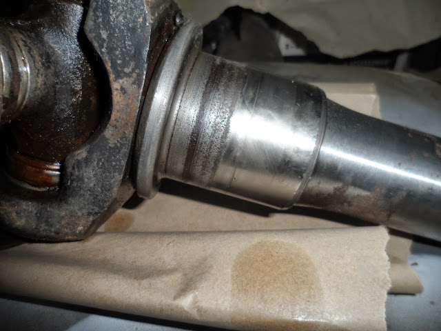

But… always the damn “but”, I picked the shafts from their lethargic and dusty dreams and got to prepare them for changing the cross joints and put them in place, finally. I washed them with solvents, again, and cleaned them off a lot of dirt that they still kept even after countless sessions of cleaning.
The races were heavily worn out but the repair kit included the four races so I would have not to concern about new oil leaks from the retainers, or so I hoped.
After wrapping and protecting the spindles I cleaned it all again with solvent, and I was going to load the pieces on the car to take them to the press when I had a bad feeling. I went to the office and took one of the new joints. Remember that the joints were brand new, special, offset, very expensive ones, purposedly bought by a friend who knows his business, checked and re-checked by the EPC and picked up by hand directly in Stuttgart, where the original truck was born. I got them and stored them next to the other new parts and never had a doubt that they could possibly not be the right joints so I never checked them.
They were not the right joints. Just like that. They were bigger. Hmm…
What really surprised me was my first reaction, like feeling and saying: Ops… another problem.
I checked and measured again it all. There was no way they could fit in. Made order and left after telling Carmen about the new issue while my mind was full of thoughts, looking for alternatives to overcome the impasse. Assembling the front axle was the core of the developing work-plan, and now it had come to a sudden stop until finding a solution that seemed neither easy nor cheap, and I was, of course, the only responsible.
I wrote to Germany for councelling and I was told that I had to wait a little until the first days of June, and it was then a couple of weeks for waiting, something I am not really good at.

I cleaned the piping supports and primed them along with the inner covers of the brake drums that I accidentaly found under a thick layer of dust. They had been sand blasted and primed once in the past but they were a little rusted after some centuries of neglect. They required a new dedicated cleaning session and new washprimer and primer application.
I was sanding hard when Jaime, the guy from the shop next door, arrived with the brake shoes with their new linings. I had made him take them to Santiago to do the job because I found no specialized brake shop in San Felipe that I could trust. The riveting job looked pretty well done and the quality of the linings was reknown so it was all okay, except for that they did not clean the shoes before changing the linings. Another future job for Pairoa.
The brake shoes were put back in their boxes until figuring out how to solve the problem of the universal joints and resuming the front axle assembling.
pairospam
Beiträge: 927
#566 Beitrag von pairospam » 2015-06-29 19:09:29

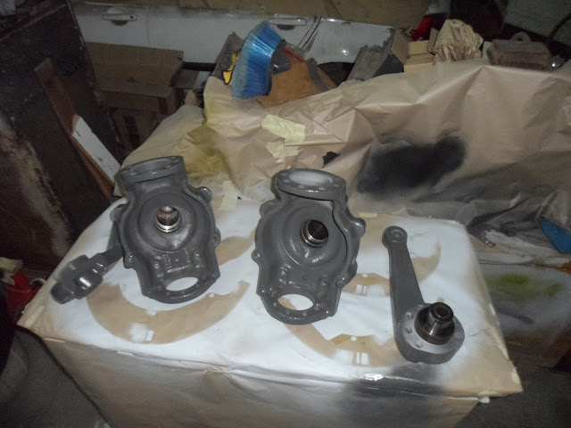

After preparing the pieces the anticorrosion juices were applied. I really like the way they look when primed, especially when compared with those which had been primed long before, covered by the time and the dust.
What needed to be painted in the definitive grey was painted and hung from some wire in the attic. But I still had some paint in the gun that, this time, I wanted not to throw away so I cleaned the front axle and the spring packs up and sprayed them as an experiment, just to see how difficult it would be to paint the frame with all the parts assembled.
Well, it was hard. Not a simple job to reach every aspect and every hidden corner of the truck. I played until the paint was over and then took some pictures as they show better than the naked eye the places where the paint was not enough. I would have to give at least two more hands to get the right finish, and to pay more attention to the details, but in general it was okay, and I liked more and more the color chosen for the frame.

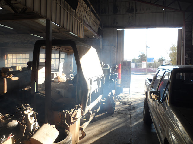

The next day, I received a call from a member of the local 4x4 forum who thought that a friend from a friend may have the solution to the problem of the universal joints. He sent me then a picture that showed a shaft that clearly was not the right one for the Merkabah but he told me that this guy knew a lot about my truck and that he may have other pieces of interest, maybe the right joints.

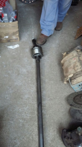

I loaded the shafts and the joints on the Montero and headed for Santiago right away. Maybe it was just a false clue, but I am convinced that things happen always for a good reason. The guy that called was a total unknown for me and he was offering his time and effort for free to help me, as many have done, so it was worth the trip just to thank him.
I missed the meeting point, of course, and after a while we finally gathered and went to an ancient neighborhood where the answer to my prayers was supposed to be. Outside the workshop a half cannibalized 406 Unimog showed its nudity to whoever had the guts to look. I felt a little sad but at least it was a good sign: we were close. I followed Sergio, the helping guy, and passed along a series of wrecked Unimogs and a couple of old L series that looked just a little better than the one on the street, and among them one that had been refurbished and was ready to delivery.
There was a newer Unimog covered by dust, spares and neglect in the middle of the yard. It has been there for years - Sergio told me, surely driven by my open mouth staring at the noble and uncomprehensibly half killed truck. The engine looked complete and I was told too that the drivetrain had no fault. If it was not for the Merkabah I surely had made some attempt for its revival, no doubt about it. All I could do, though, was to secretly drop a couple of tears for the fate of the poor beast.
Sorry, but I had to show it, Iain.
There were dozens of small and big parts sparse in a strangely organized chaos all around, among them many used and abused mechanic winches and transfer cases as I could identify. Sergio warned me to show no particular interest even if I was dying for having any piece that the owner of the shop might have but, to shorten the story, the man had neither spares nor solutions for me, but he had a business friend that might be of help. He called him and gave us his address, half city away.
Sergio leaded and I followed through the growing afternoon traffic of the big ugly city. The old guy owned a small but incredibly well supplied store of Mercedes truck spares a couple of blocks away from where I went to ask for the same joints one year before. With very polite manners and full of stories ready to go out from his mouth he told us that he formerly worked for the official dealer of Mercedes Benz and started his own business after twenty years of being an employee. He really knew about trucks and identified the Merkabah perfectly just by showing him the sample of the joint.
He made a few drawings, took some measures, kept the joint, told a hundred interesting stories about the virtues and flaws of the EPC and about everything and promised me that he would call me when his partner in Bremen or somewhere else answered him about the bloody joints. I thanked him and Sergio and returned to San Felipe just a few minutes before the traffic jammed at the rush hour.
The options were just a few: find and buy new universal joints; buy the whole shafts, both sides; turn the bearing caps to make them fit with the yokes; buy 38 mm normal cross joints and replace the 40 mm caps of the Mercedes offset joints by turning the races to make the caps fit and then cement or harden them. I did not like them, not one. Anyway, it was just a matter of waiting, and faith.
Well… it was necessary to go on so I grabbed the primed sway bar and its repair kit, bought a couple of years ago, and spent the whole afternoon at installing the bloody thing in. It looked easy but it was not. The bar was heavy and hard to handle and the struts blocked just when you needed them to move easily. Bad. To make it worse the superior bushings got stuck and the threads of the bolts worn out.
Also, I did not understand how the pins and the inferior bushings were assembled as they looked, and actualy were, impossible to fit. Tito, one of the mechanics, gave me the practical answer, but I was so tired that I left it all for the next day.

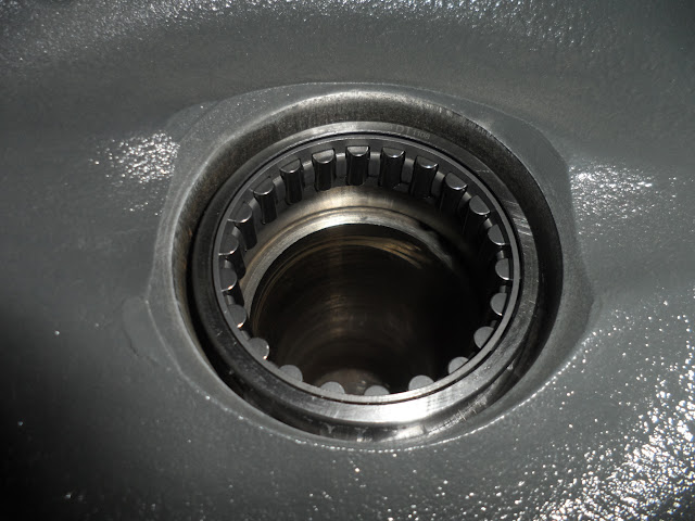

Monday, time to proceed. The spares were there for months, waiting for this moment. As I had not the precise drift 387 589 02 15 00, according to the assembling manual, I got a couple of socket wrenches, the old ring seals and Scotch tape and made up my own drifts. Well, they worked great, and very carefully the shining new bearings and the seal rings were put on both steering knuckles first. I wrapped the heavy pieces and put them back in their boxes because my wishes have always proved to be wrong and I had a hint that something was not going to work this time, again.
I inspected the axle very carefully again and found that the inner left race was a little damaged, not by me, by the previous owners who did not take very much care when replacing the seal rings. I used a little lime and fine sanding and I considered it was enough. But everything happens for a reason, and when I was ready to install the new bearing I had a huntch and put my finger in the hole to explore. A little metallic piece was almost at reach, out of sight. Grabbed the magnet and took out one needle from the destroyed bearing that I was not missing at all. Maybe it would have never done any harm, but the Big Boss warned me of its presence so it was potentially disastrous.
Once I was sure that there were no more pieces inside the axle I drove the new bearings and the seal rings in. It was far more difficult than with the knuckles because of the uncomfortable positions and I ended up pretty late, alone for a change, but it was worth it.
