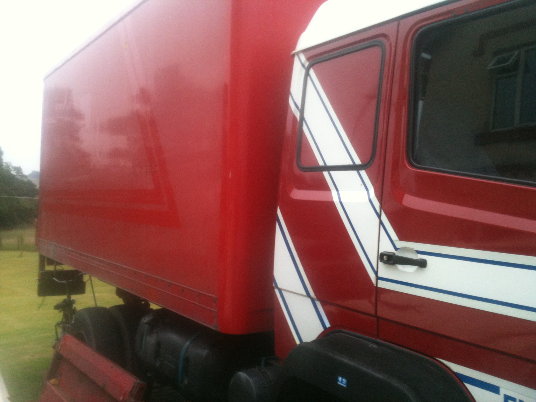

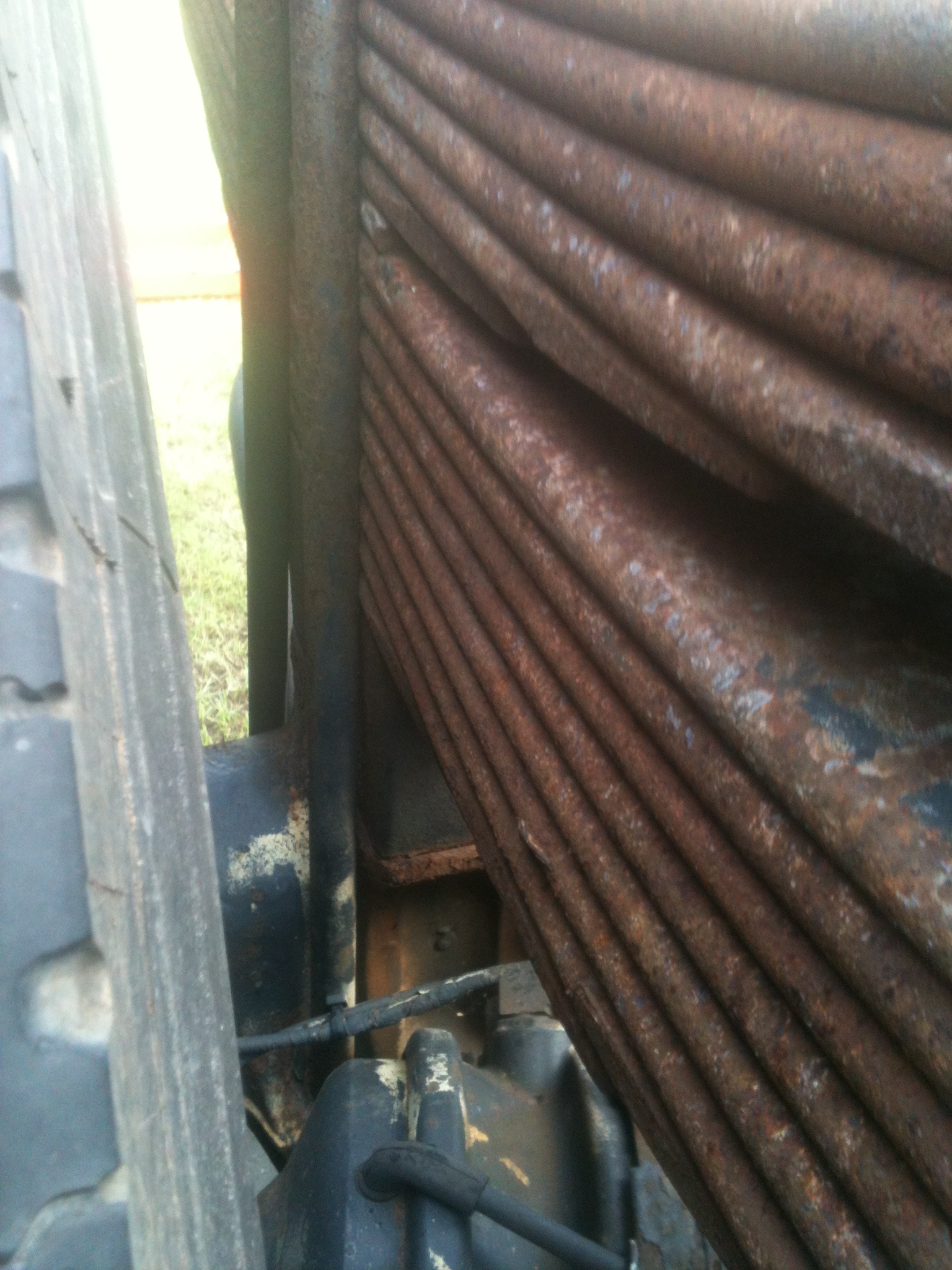

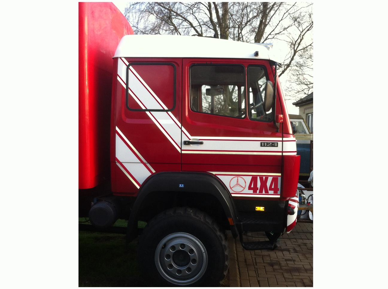

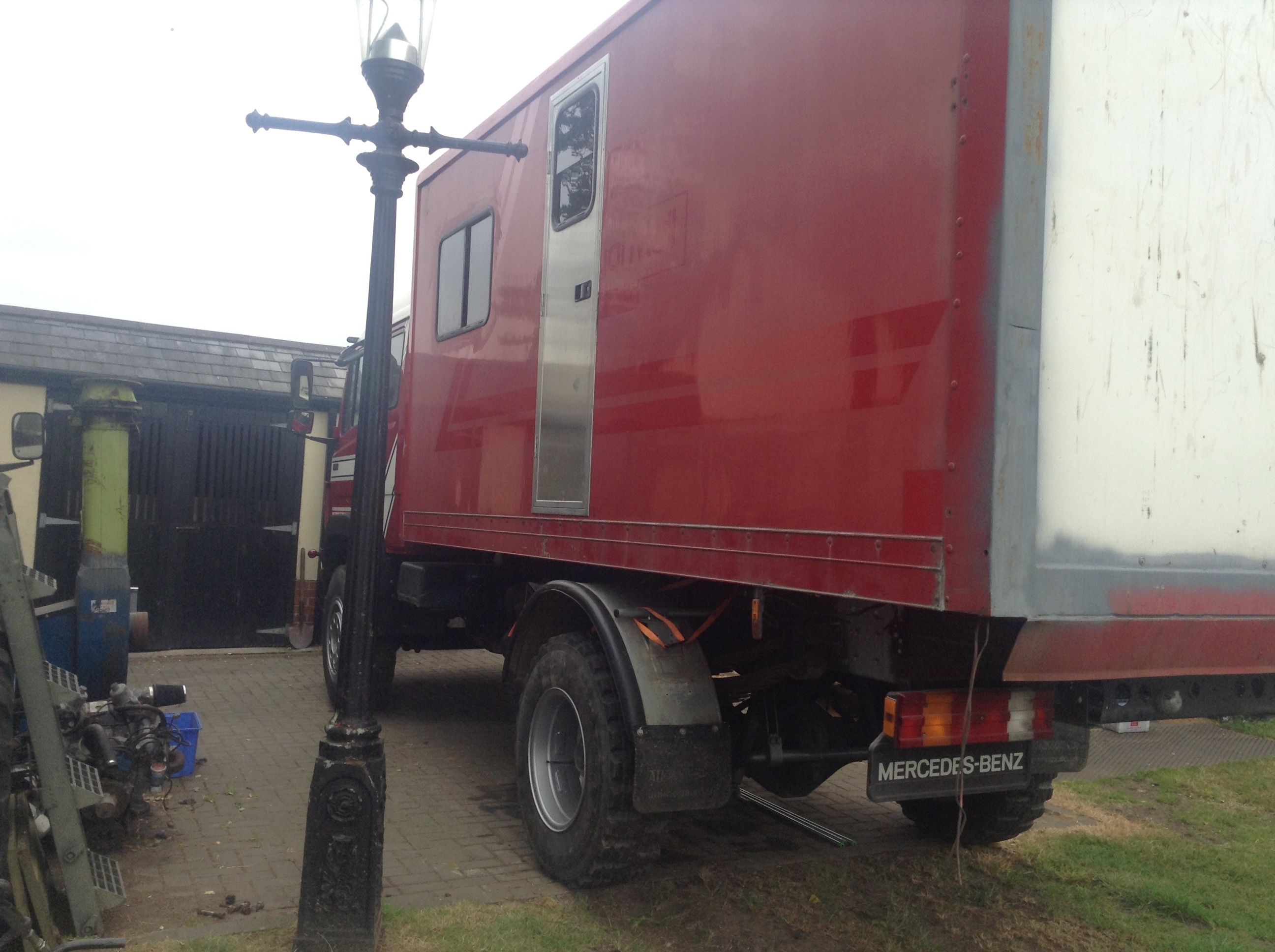

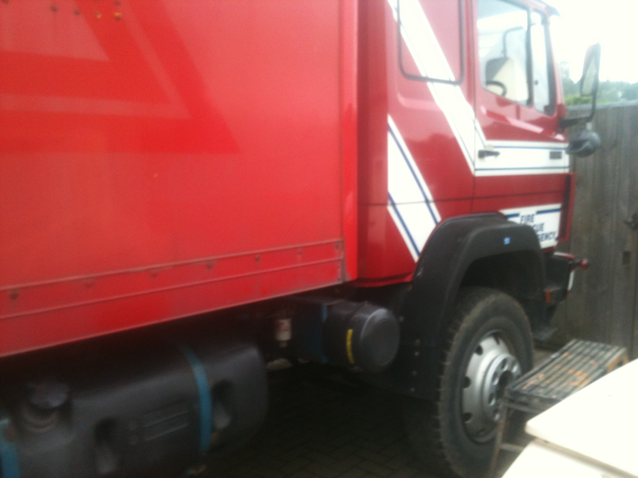

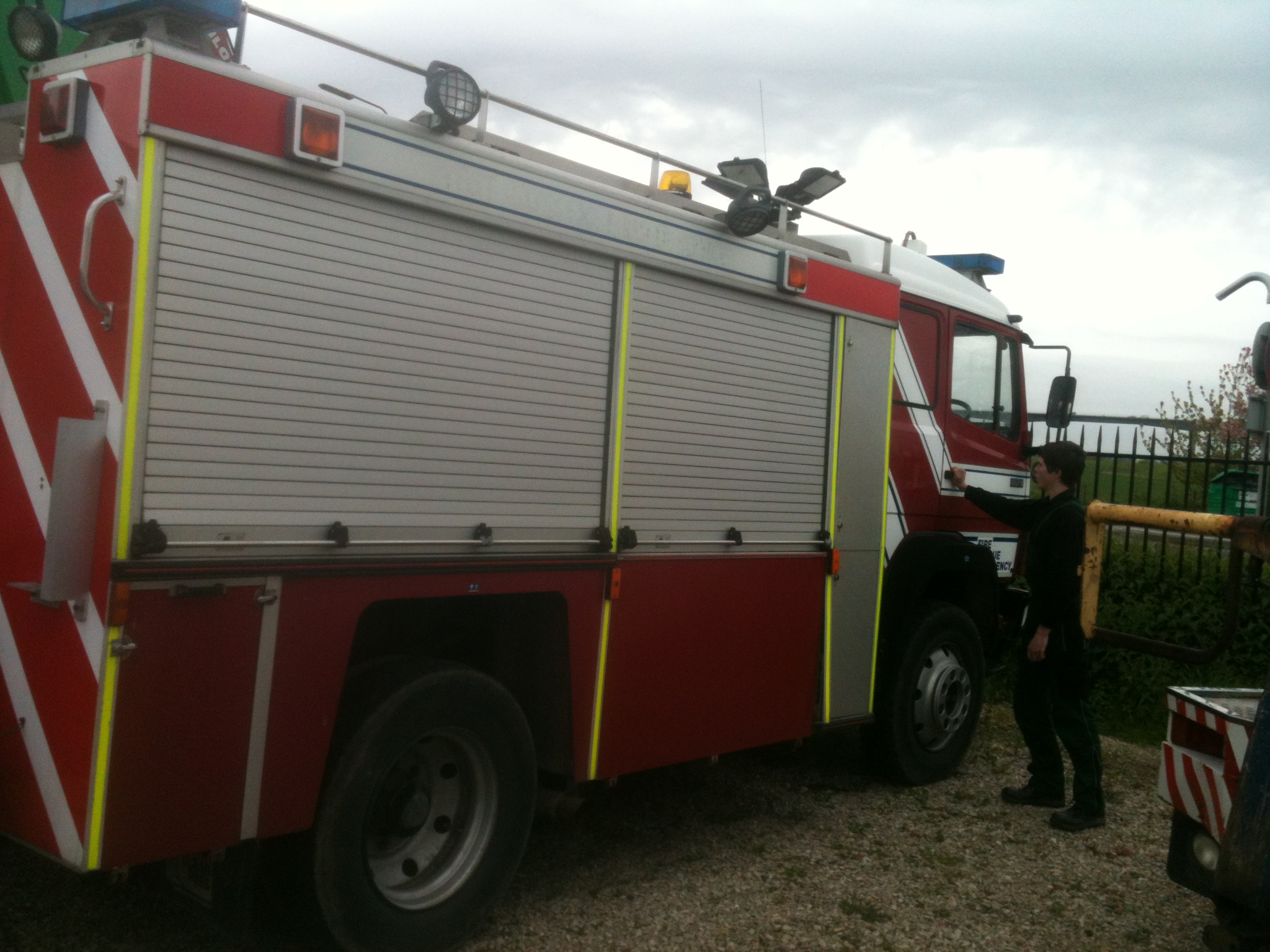

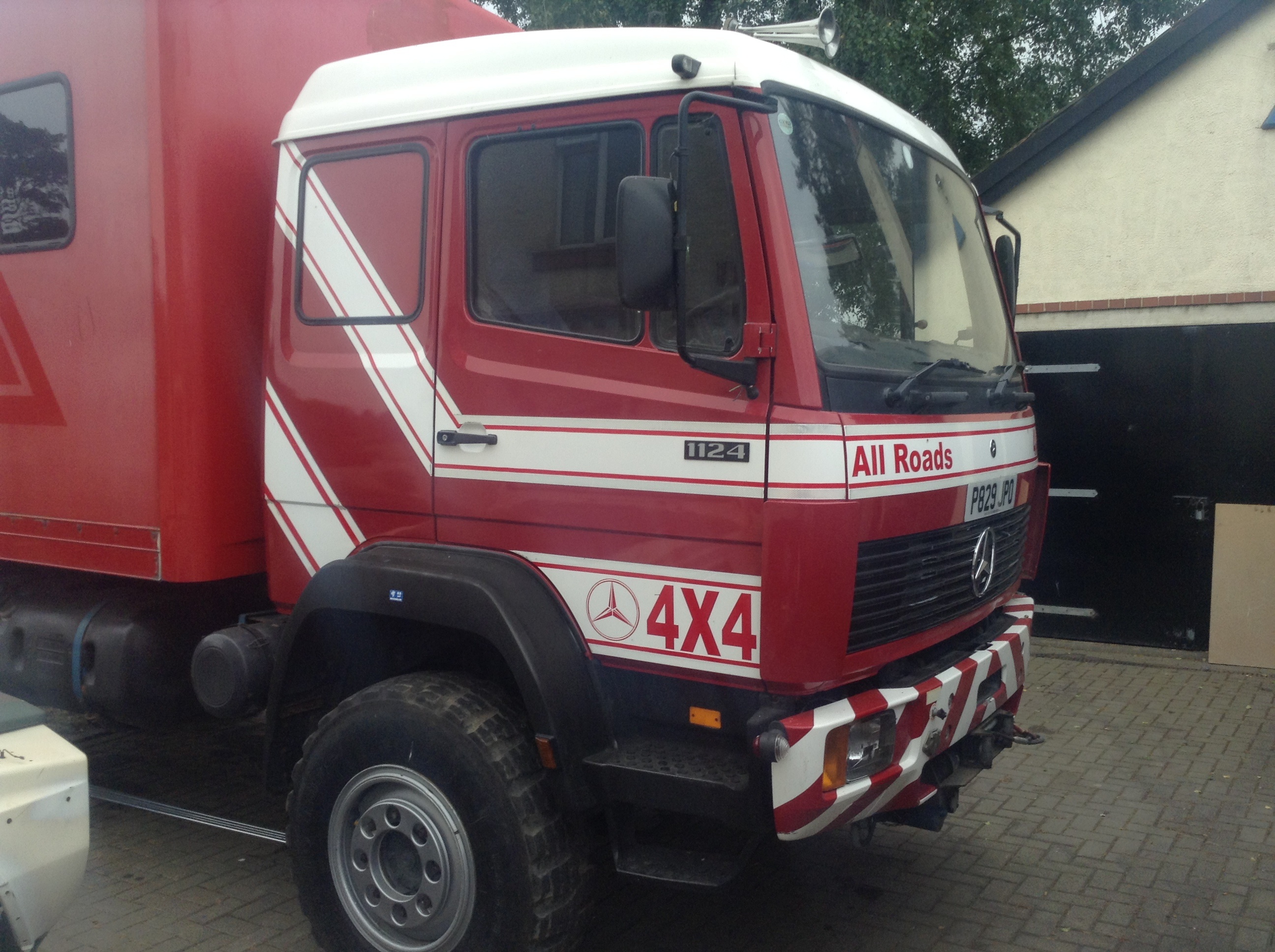

helloo I'm new here this is my first post :D Ive bought an ex fire engine 1124 AK with zf autobox with retarder. My problem is i have taken all the fire engine stuff of which weighed around four tons and my intended eventual weght is to be around 10.5 tons gross at the moment she grosses out at 13 tons and the current suspension is to heavy
see picture 2and 3

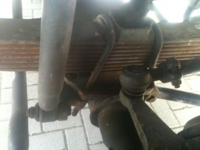

can i take some leaves out or should I change the springs for some I have found in a scrap yard that are on a 1314 that are parabolic. My thoughts are that the parabolic springs will need stronger dampers plus stronger mounts . Also why would Mercedes fit this type of spring instead of Parabolics anyway?
I hope this is clear and I will post more pictures as things progress

Hello allroads,
first off all, Mercedes used leaf-springs because the fire fighters ordered them and not parabolic springs ;) Especially for AWD-chassis the leaf springs are used until today because they are more robust than the parabolic.
Your thoughts abot the parabolic springs are right - you'll have to change mounts, springs and dampers. Maybe you will need even stronger dampers when driving offroad.
Taking out some leafs is a bit tricky. You'll weaken the sping package, leaf breaks will get more probable.
As a first task I would derust the front spings and put a little grease between the leafs - the springs will spring again. The rear springs schould consist of two separate packages. I would clean the main package and remove every second leaf of the secondary package.
Cheers

#4 Beitrag von allroads » 2012-07-25 22:15:00
Thankyou for your help and kind words The German peaple should be proud of how bi-lingual you are. I train peaple to operate Unimog / Zetros and My son Imports Heizomat boilers into the UK last year we were in Germany ten times and I'm ashamed to say Ich spreche wenig deutsch :huh:

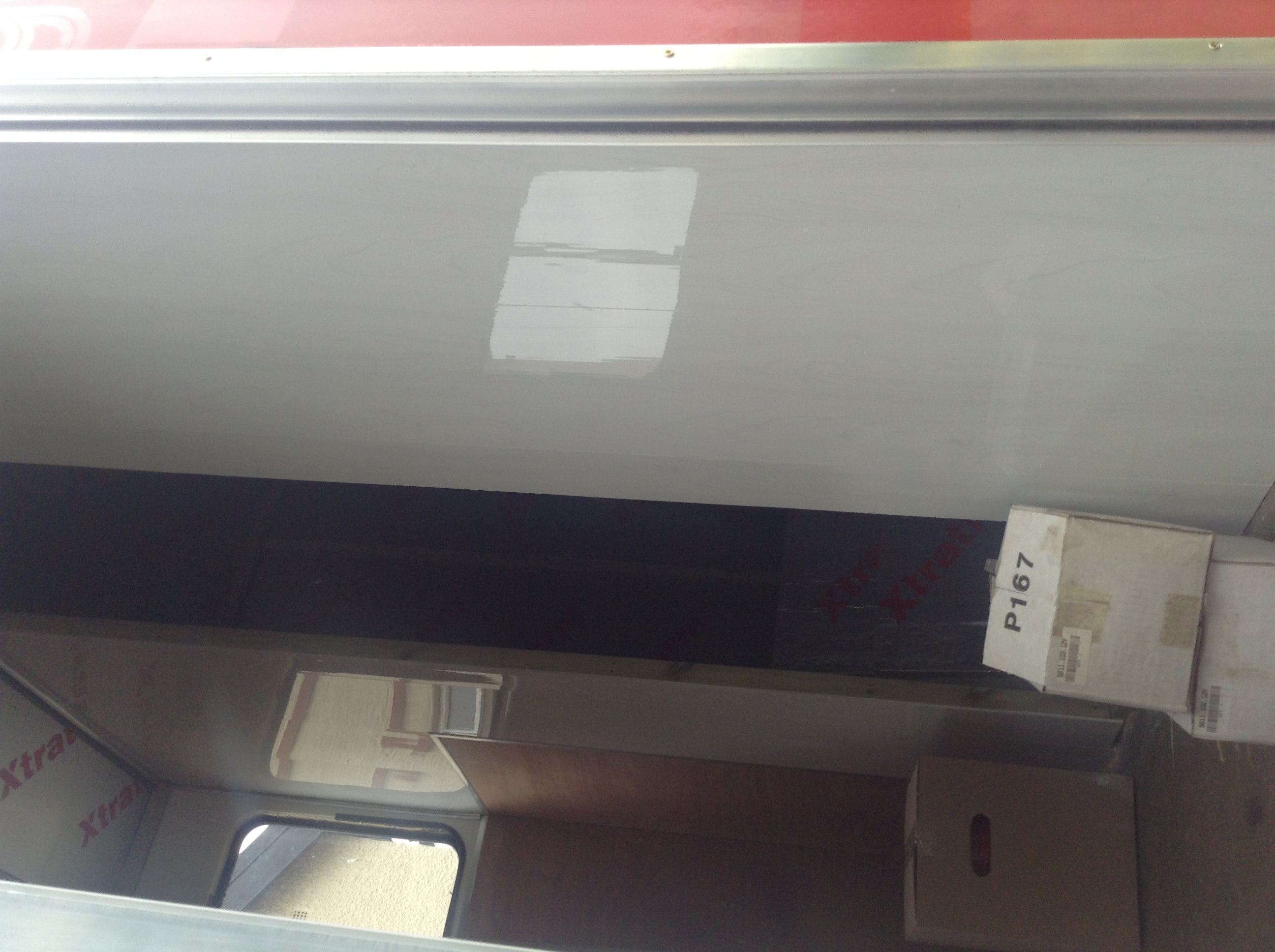

We have now fitted the body to the chassis as you can see in the photo the body is narrow this will allow us to fit two awnings to the sides. we will leaves the springs for now and clean and remove springs when she is finished i hope around 10.5 tons, at the moment she weighs 5.5 tons. Do you think I should single wheel it or leave it as she is?
Many thanks Allroads

Hello allroads,
1124: Medium chassi, decent engine - good choice first of all!
The leaf spring issue is a bit tricky with old fire fighting vehicles. This type of trucks was build to carry an almost constant load so the springs are not, or less progressive than the configurations of normal commercial cargo trucks whose load differs all the time between empty and fully loaded.
But you are lucky, at least your rear suspension is made of two independent springs, one for the empty truck and one that needs some more load to get connected to bearings at the frame so both springs are working together. It cound be worse. At your front suspension the second spring is made of rubber, but this one is more to avoid a potential catastrophe than to improve comfort. But it is two springs creating a progressive system at the front tough.
I assume that your goal is more suspension comfort. I can't solve this remote but maybe I can give you some hints in which steps you can fit the suspension better to your real vehicle weight.
- First of all don't be stupid and start to fit your suspension to a vehicle weight which you don't really know. You maybe think you can estimate your final vehicle mass sharp enough, but believe me, you would be the first one if you hit it. So first of all finish the whole truck, take it out on a test journey to find all the things that have to be improved.
- Then fill all tanks and all possible cargo and make a test drive: How much do you really have to change to fit the suspension. Consider: You really need a reliable suspension when you are far away from home. And most likely the truck is much more loaded in this situation, than it usually is at home.
Replacing the trapeziod springs by parabolic springs can result in a more progressive and therefore a strong but comfortable suspension. Every parabolic spring leaf can be considered as a independent spring. If they are mounted in a way they will get contact to the bearing one by one with increasing deflection it will result in a more progressive suspension. And this is what you want: A spring that is as strong as the original one, but more soft at low or medium deflection. The curve of the force-to-deflection ratio depends on the strength of every parabolic leaf (not imperative equal) and the deflection it needs to hit the bearing.
Also there is no friction between the parabolic leafs. This brings the need of (stronger) dampers, but it is a big feature: With a trapeziod spring there is friction between the singe leafs, more when it gets loaded, less when it gets unloaded. But friction when a spring gets loaded makes it more stiff and uncomfortabe. You want the friction to consume the energy to avoid oscillations, not to make your suspension more stiff.
Hydraulic dampers can do this: They are way more stiff on extraction then they are when pushed together. So having a suspension without inherit friction brings the benefit to be able to add hydraulic dampers which provide most friction when the suspension is unloaded.
But not all parabolic springs come in a progressive configuration. Often all leafs have direct contact to the bearing so the only benefit from the parabolic setup is (besides less weight) no inherit friction. If you use one of this springs in your truck, you should adjust the gap between the leafs in a way, that the configuration becomes progressive in the right way for your truck. Because most likely you will always find "some" parabolic springs, not "the one" that fits perfect your truck. Same for the dampers. Also you will need to change the bearings because parabolic leafs tend to be much more thick that trapezoid leafs. Normally here is no way to get them into the existing bearings.
So maybe you get a feeling for the effort it takes to create a sophisticated suspension with parabolic springs for your truck. In my opinion this change would be the last step, only to be taken when you really know how to do and configure it. And you also should know if it really is needed.
But roughly estimated you will need to decrease spring force on your rear axle:
- I would not change anything on the front axle: If you hit some obstacle with a little speed in offroad condition you will need every last newton of spring force you can get for your front axle, because it will get a heavy dynamic overload.
- First of all I would grease the existing springs and wait for the weight of the truck to be settled and then check the load on your rear axle fully loaded.
- There can be a nasty situation with the two springs at the rear axle: The suspension becomes really uncomfortable if the top spring of the two springs in the rear 'just' gets contact to the bearings. The load is far away from being enough to make both springs comfortable, but enough to activate the second spring. Unfortunately travelling applications bring a vehicle mass that tend to create exactly this situation. Trucks are build to be empty or fully loaded, "little more then half loaded" is a minor load situation that does not happens so often in a commercial use of a truck. So the customers don't pay the engineers fit the truck to this load situation.
In case you have this problem I would take out some leafs from the top spring or rather just lift the position of the bearings for the top spring. This would keep the benefit of still having the full strength of the top spring, it will just takes more deflection of the lower spring to get the top activated. Your suspension is more progressive instead of more weak.
- If this is not the case or your suspension is still to stiff, you can take out one or two leafs out from the main spring as well. But this can only be done together with moving the bearings of the top spring (or removing the top spring completely), otherwise this would make your spring more weak (because of the missing leafs) but also less progressive and almost the same stiffness, because the top spring will be activated more early.
Caution:
1: Taking out leafs is not without risk: The time to failure is limited by the amount of bending of a spring leaf. Taking out leafs will produce more overall bending in the spring, which is the goal of taking out leafs: More soft means more deflection means more bending. This is no problem within general limits. But taking out leafs also makes the bending less equal along the spring leaf: There is a set of leafs put together in a trapeziod packet with the target to get a almost equal load along the length of the top leaf. The more single leafs are put together the less wide are the steps in length between two leafs and the more equal is the load/bending along the top leaf. A small step between the length of the particular leafs will equalize the load and therefore decrease the probability that one leaf breaks.
So if you take out for instance the 3. leaf from top of a spring, the step in length from the 2. to the 4. leaf will be two times as far as before. And so will be the inequality in bending. As a result you will get a spring that maybe only survives 80% or less of the oszilation amplitude without producing micro cracks and breaking in the end. So there is a limit in unmounting leafs, you can't get the amount of deflection a more soft spring with equal, small steps between the leafs would provide.
So never ever take away two following leafs. In general the first two from topside have to remain. They normally connect the axle to the frame and therefore must not be touched. Than take out every odd leaf. It would make the load more equal if you take an angel grinder and cut the remaining leafs in a way that you get equal steps in length, but then you can't undo the change, so maybe this is not recommended unless you really know what you are doing.
2: Many trucks have a regulator for the breaking force of the rear axle. This regulator is connected to the axle and adjusts the breaking force by measuring the load by sensing the distance between the axle an the frame. So the force-to-deflection ratio of your rear spring defines the amount of force that is delivered to your rear axle. So changing the rear spring can result in a really dangerous distribution of breaking force between your front and rear axle which can cause serious accidents. And it is also a crime (for sure not only in Germany) to drive a truck with a misaligned breaking force regulator. Even tough they will not notice it until something really goes wrong and they start digging...
So you must bring the truck to a workshop where they can recalculate the configuration for your breaking force regulator and create a new rating plate (left door bottom) to make your truck legal again. It hast been a regular job these days trucks where suspended by leaf springs in stet of rubber bags with pressured air, so you likely will find one old guy who still remembers.
Hope this will give an overview.

Hi Allroads,
After I had mounted the body on my truck chassis, it behaved pretty bad on speed bumps, jumped on the road, etc. It didn't feel unsafe in any way but it was just uncomfortable and certainly didn't do any good from a mechanical/stress point of view. My suspension configuration is similar to yours.
I noticed that the top leaf spring package at the rear axle touched the brackets at the frame, taking out virtually any suspension travel. Quite understandable, because I had loaded the chassis with several tons of weight. To me it does seem that the original 'double spring package' remains a sort of big compromise (despite what others said). Yes, it can handle different loads probably better than a single spring pack but still...
What did I do to rectify it?
1- I weighted the truck: front and rear axles. It is obvious that our trucks -once finished- will have a pretty 'constant weight' contrary to normal commercial vehicles. So we can go for an optimum spring set-up rather than for a one size-fits all (not so well) arrangement;
2- With regard to the rear axle I figured out the load range (just a variation of some 500 kg to account for full/empty tanks, etc.);
3- I gave these weights to my 'spring doctor' who entered these in a computer model: outcome was that I needed two additional big leafs in the rear axle lower/bigger spring package (in your case he might have wanted to take one or two leafs out);
4- Costs mounted to some Euro 800 for leafs and labour. After the 'operation' the upper spring package didn't touch the brackets anymore.
The difference is immense! My son made the remark: "Hey dad, it's a Citroen DS now". Well, he was exaggarating but really not that much. It's an absolute joy to drive now. We've just finished a tour in Morocco and it coped extremely well with the local (sort of) roads and cross country tracks as well. I think that I would have had just a hand full of loose nuts and bolts after this trip if I would have done it with the original/factory leafs set-up.
My conclusion (and tip for you) is: don't mess around too much with the suspension, don't start changing everything but first ask a dedicated/specialised company for some good advice. I think I got a superb solution (both in terms of comfort and robustness) for little money. He should also be able to look into Felix's (very valid!) point regarding the regulator.
Good luck,

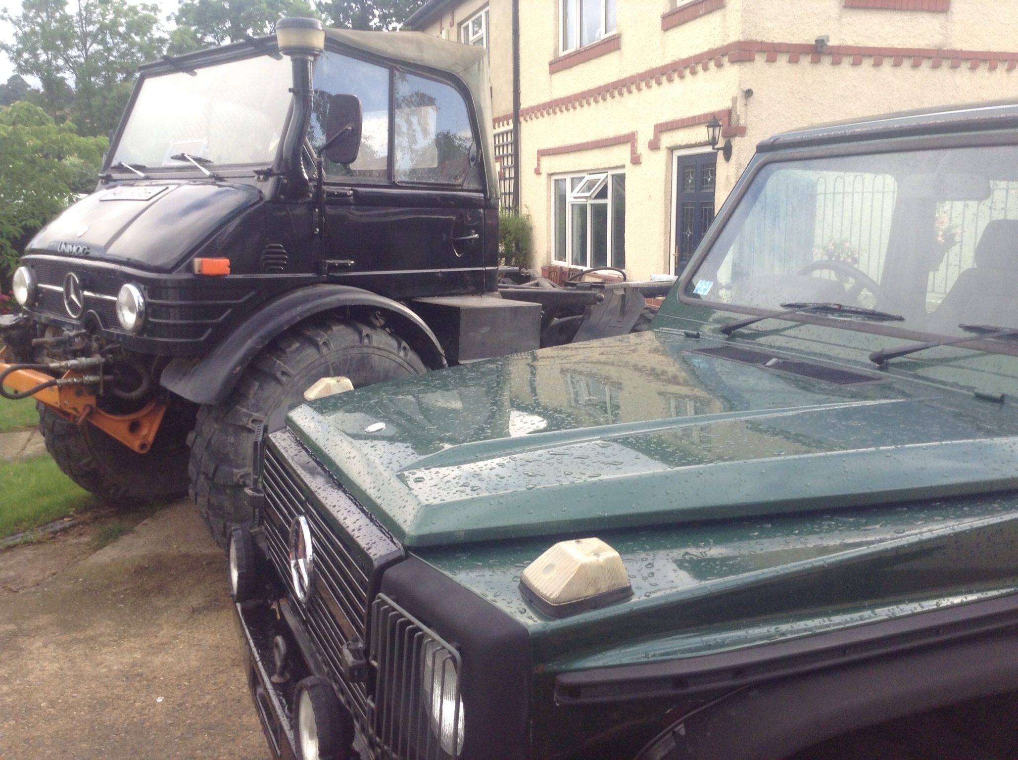

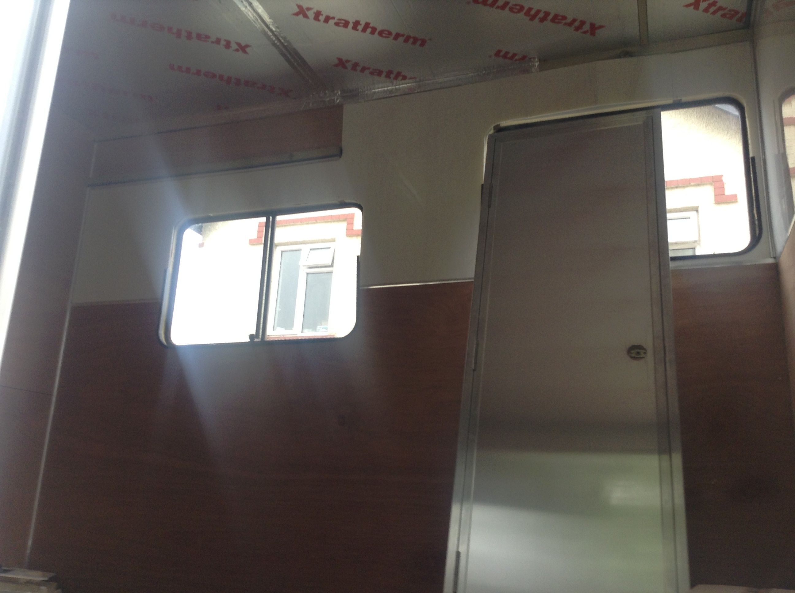

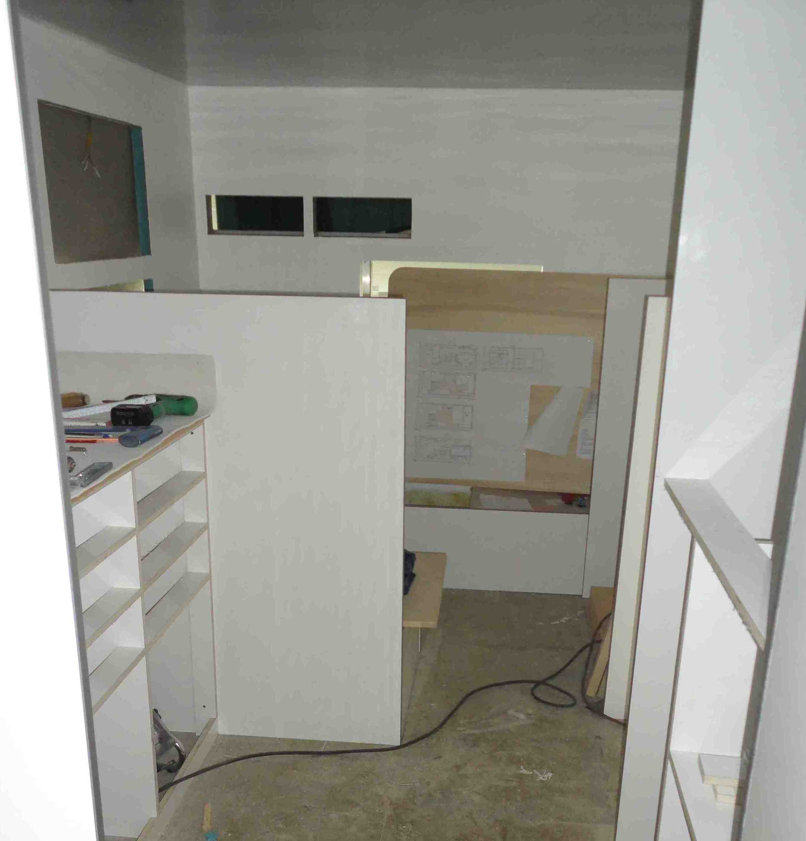

Things are moving forward new windows going in the body,started the interior fitting now all insulated with 50mm king span now struggling with how to do the Kitchin units as ordinary units to big and I don't want to make my own (I'm no carpenter :lol: ) I will post some pictures over the next few days.
It this works there should be a picture of the Unimog wheels and tires I have fitted, the tires are not good enough but I'm now trying to keep the weight below 7.5 t so my wife can drive it when finished, why are Xzl tires so expensive :( these are 12.5 I would like to fit 365/85r20 but don't think they will fit inside the arches.
I'll be back with some more pictures soon :D

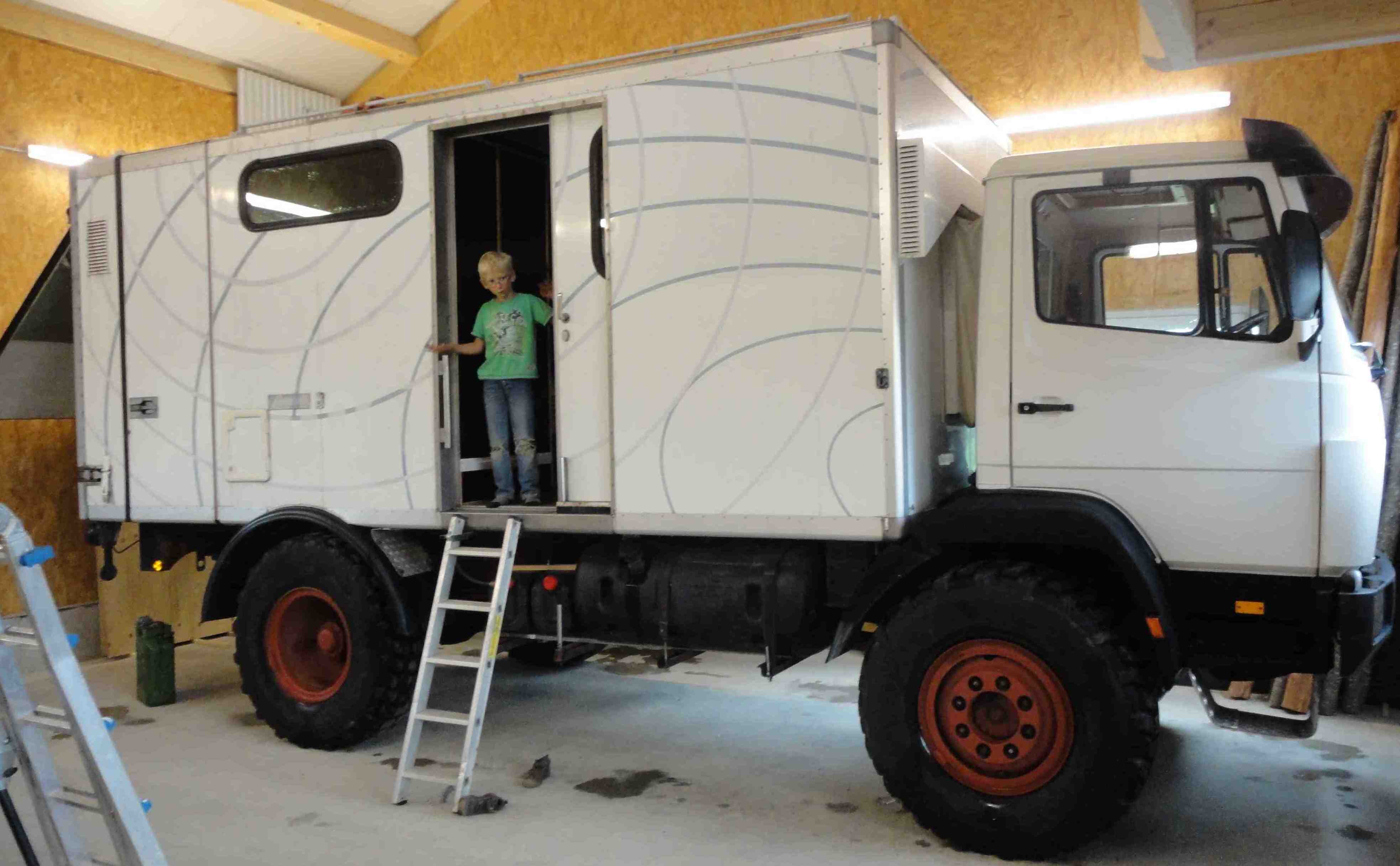

We are struggeling
Attached an image of our 1120
If you wish I could share some images of the interiors, which are currently under development.

The weight is an unknown at the moment I'm trying to keep everything light for my wife's licence and fuel economy and power to weight ratio !
Here in the UK campers don't need to follow the HGV rules so tightly no tacho no speed limiter no HGV test for the truck just small van test.
To register as camper one needs to complete the camper conversion first to a specification laid out by the government then one can apply for camper papers.

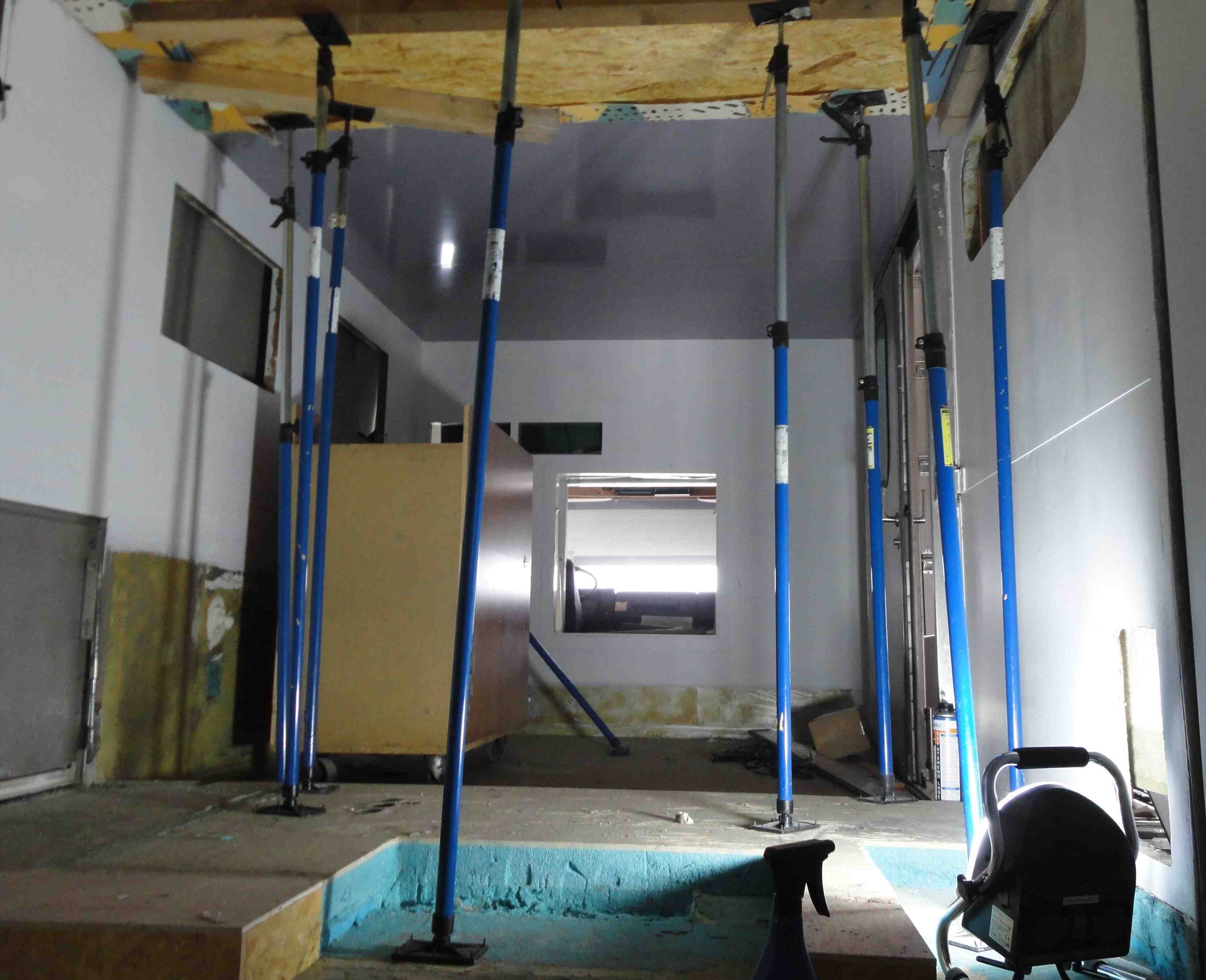

#13 Beitrag von stephank » 2013-07-21 11:42:09

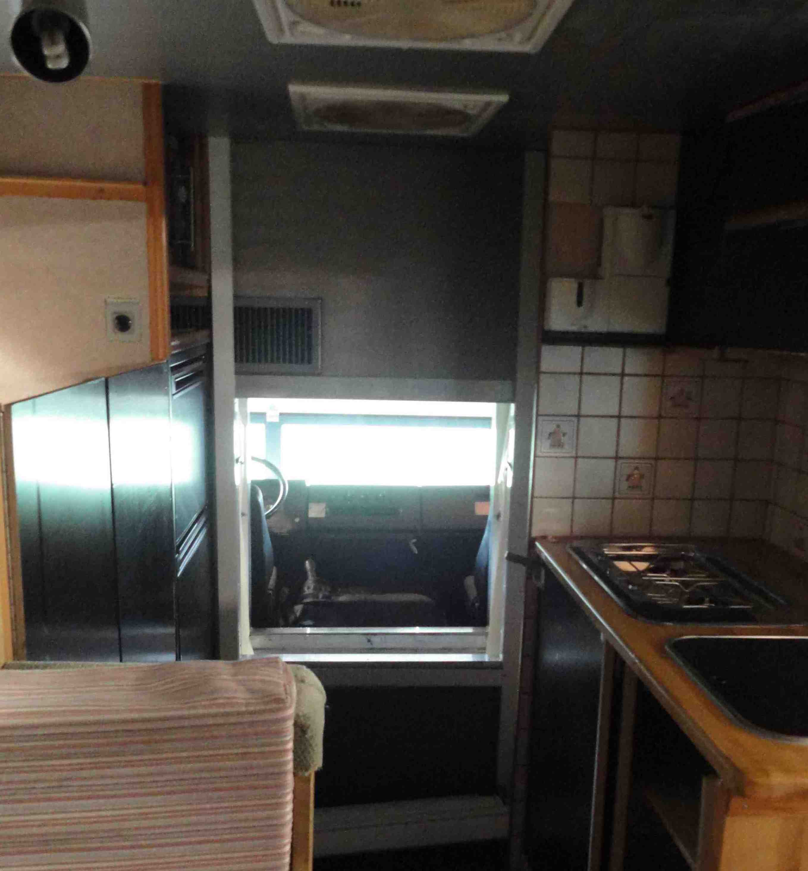

Yes, your truck is nice and certainly its doublecab is nice.
We purchased ours last year and it took less than half a day to decide that all the interiors will have to be be ripped out.
So work started beginning of the year and will hopefully be completed by the end of this year.

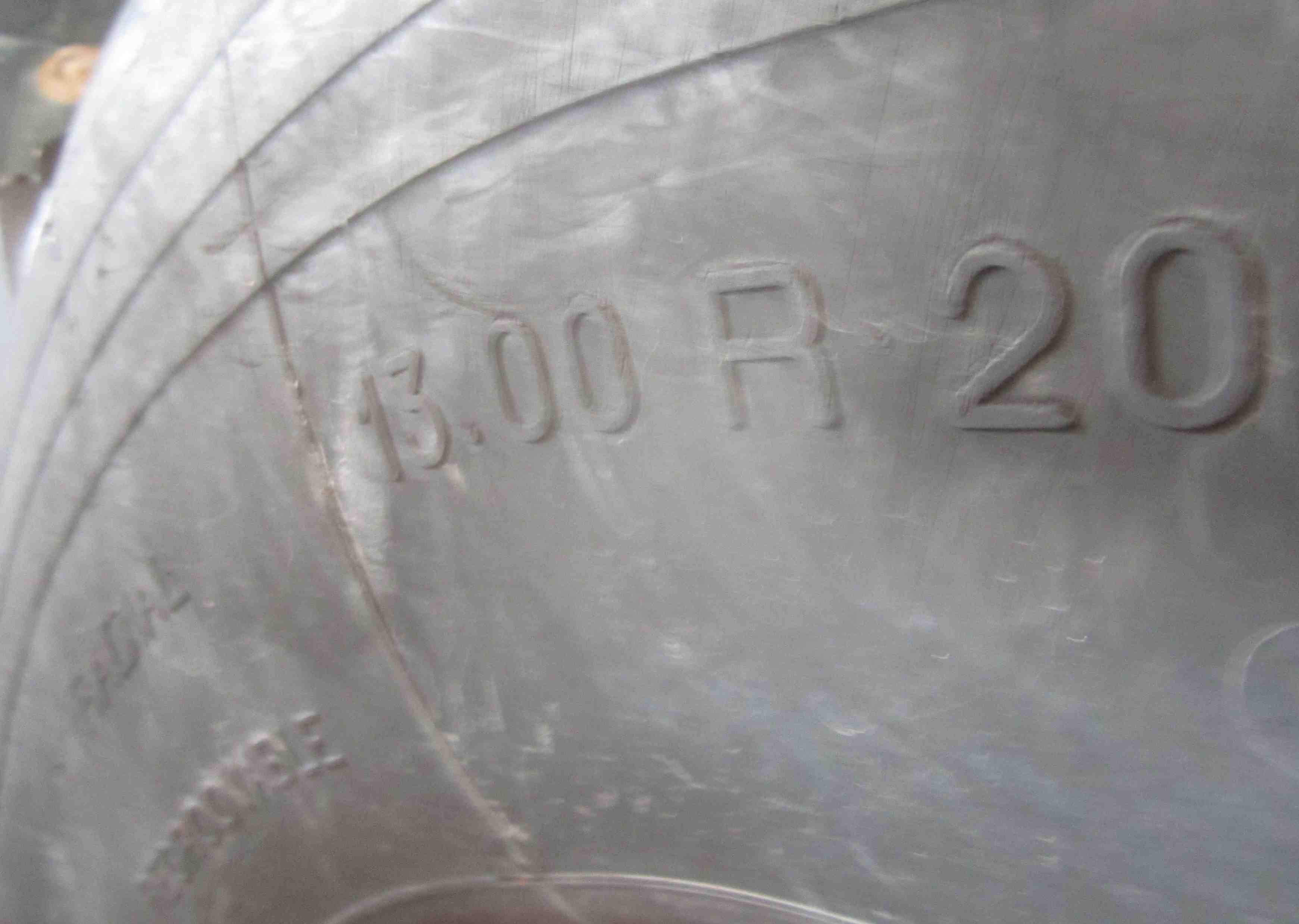

We also cannot complain about speed. With the 12-gear split box, its 200hp and the 13:00 wheels 120km/h is easy achievable.
Whereas this is not necessarily what we are looking for. But 1800rpm at 100km/h and the available torque is very comfortable.
Actually we cannot complain at all. There is hardly any rust, all is well maintained and functioning and the mileage is as low as 80k kms.
When we purchased it was already registered at 7,49t but in reality way above that. Since then we ripped out approx. 1,000kg and everything that goes in is lightweight. However when built and loaded we may (will) still be over. Lets see. We are keen to get out with it and try it.
Below are some images.

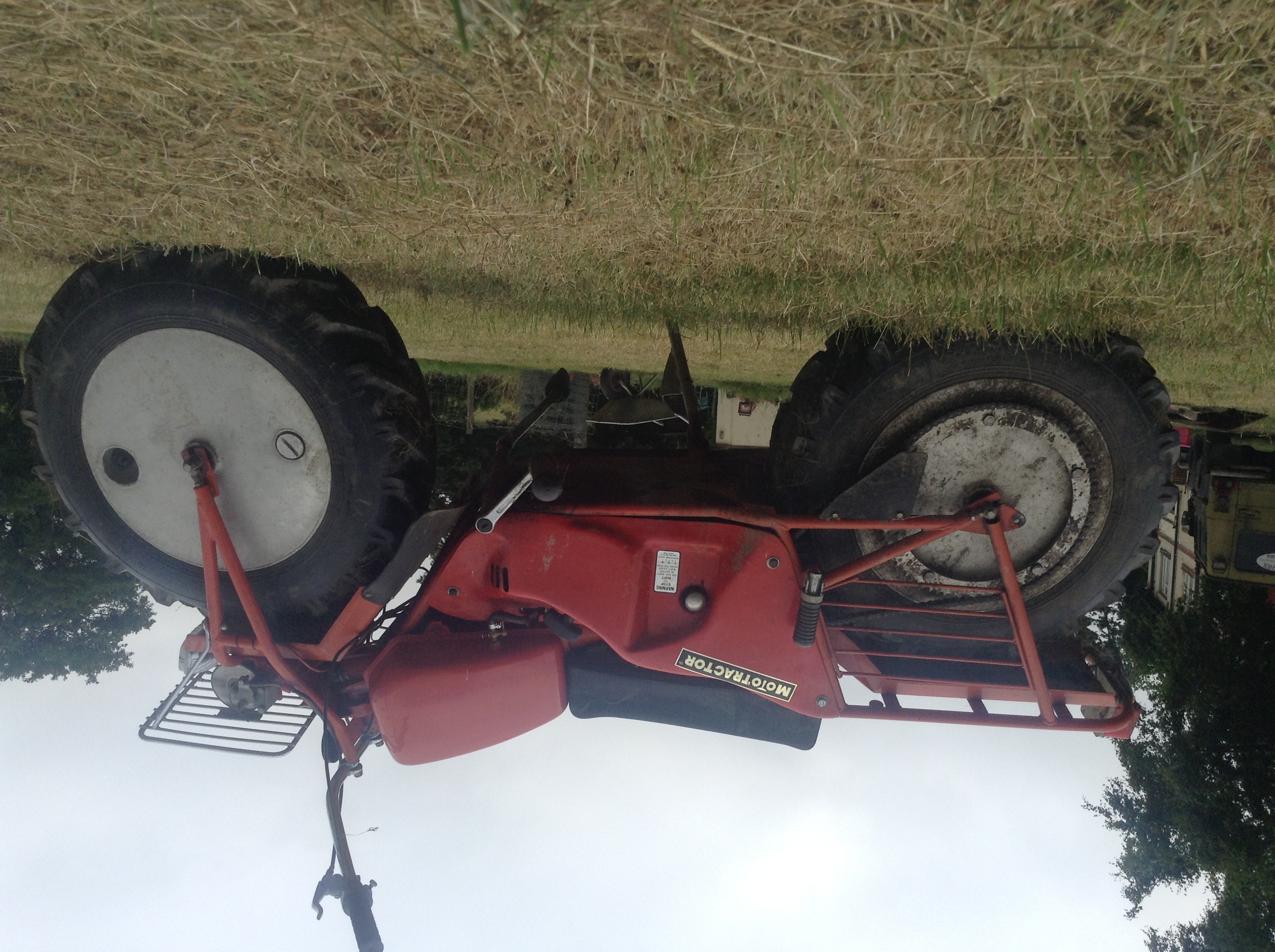

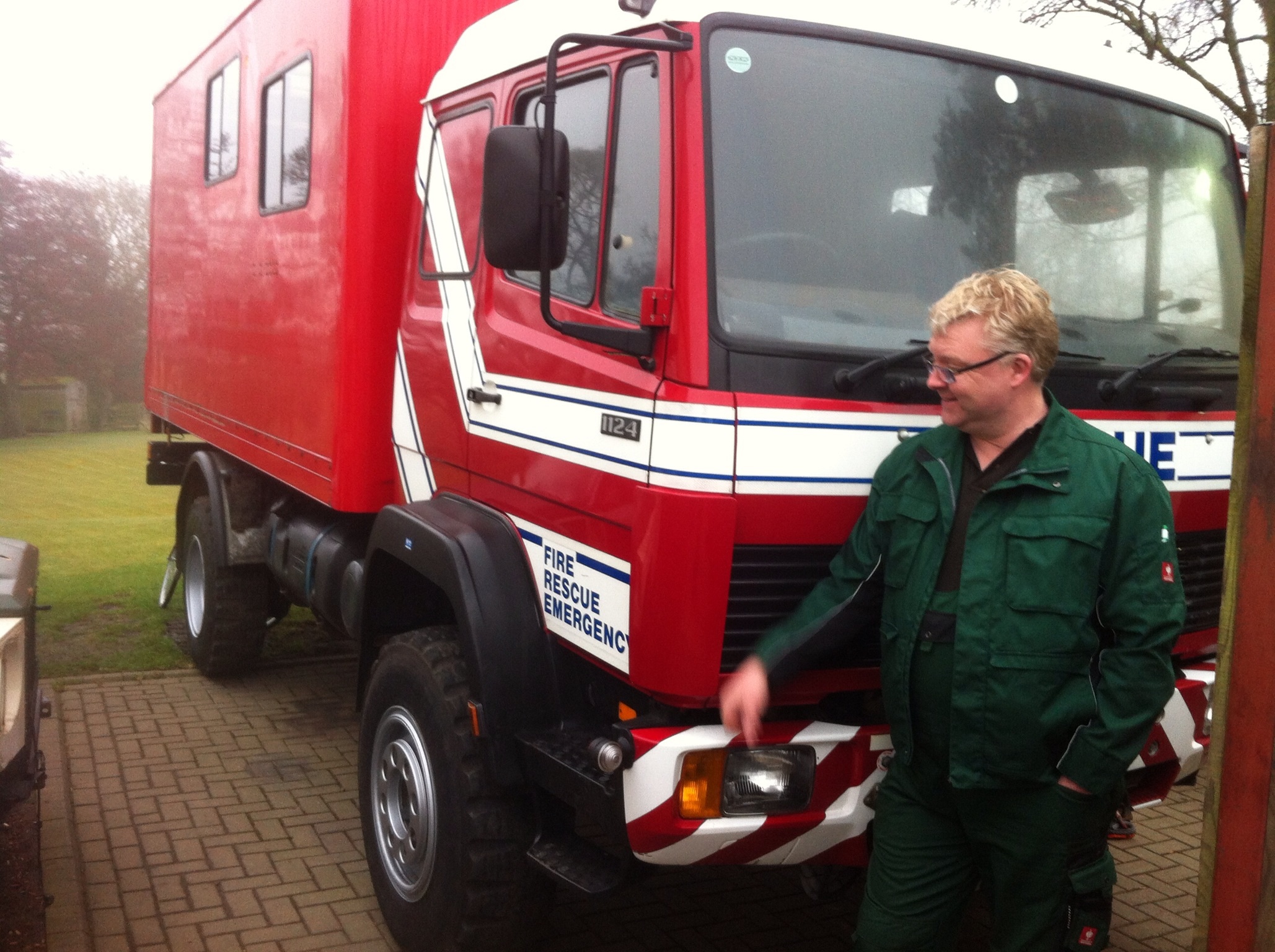

Your truck looks very nice those tyres really make it :rock: our intention is to only travel for a month at a time max and mainly stick to Europe east and west.
All my children are grown up and my wife is not one for flying I like culture and history, I drove to Moscow in 1992 and liked the people I met on the way, plus I'm not one for hot country's. I work with Unimogs and own five classic models but I'm after something with comfort reliability and a reasonable turn of speed offroad is not the main thing but the reassurance of being able to get of a wet grassy field means a lot !

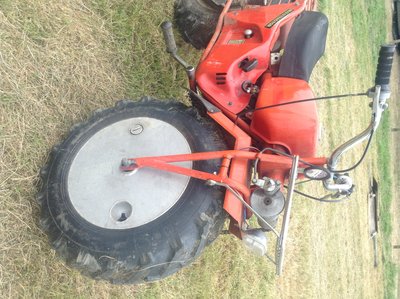

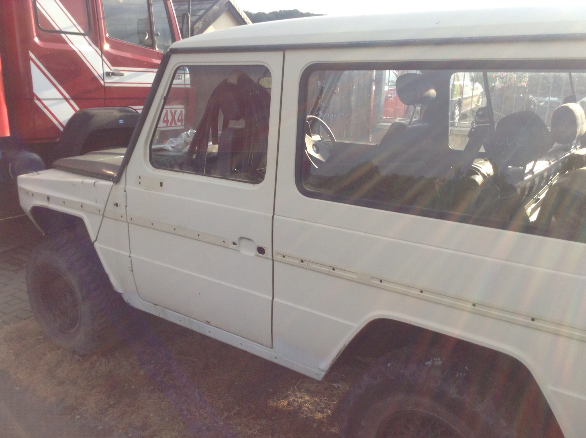

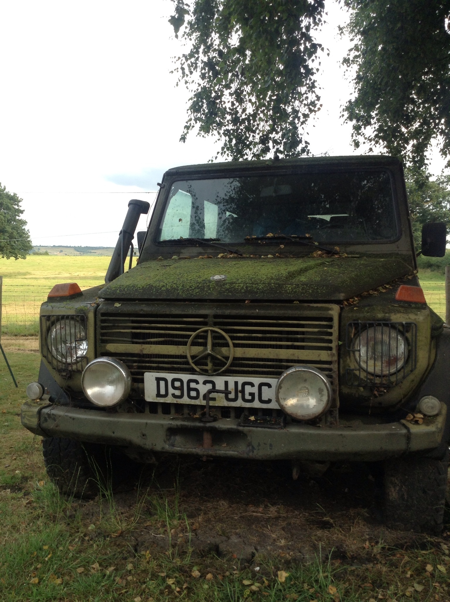

Some pictures of the build so far the rokon motorbike is 2x2 it's my lifeboat :D if you search under Rokon bob they are fascinating, I want to fit it on the front of the truck as the overhang is a bit to long at the back plus I want to put two bicycles on the rear as well as a spare wheel.
I will be fitting a Rockinger hitch on the rear as I like to offroad with G Wagen and also like to take my Unimog 411 to shows with a trailer.

Interesting bike your Rokon.
I read somewhere they came with Maico 2-stroke engines.
What about yours?

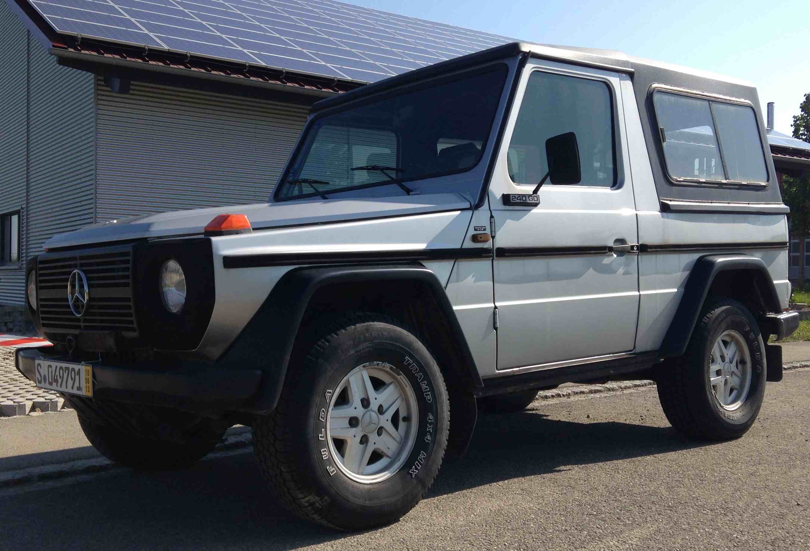

And I read that you are into G's
Show us your G!!
Below are some of our hobbies and one very actual image of our shower:

Landei hat geschrieben:
Your camper door is on the wrong side
Blimey, and the steering wheel as well!
Brilliant Photo Shop work! How did you convert all the numbers and letters?
These are new transfers but my son did a mock up on Photoshop first, picture below.
What about yours?
Yes the old Rokon is a two stroke they are an amazing bikes but no good for any distance on the road mine is road registered here in the UK but only for limited mileage.
Show us your G!!
I have two long wheelbase 460 alas one is for spares now after 1000,000 Kms the other is my wife's this is a 280 it's having a new stainless exhaust fitted at the moment. I also have a short wheelbase that I'm fitting a turbo om 617 in and would like to offroad this one maybe the Breslau rallye ! Maybe Unimog better :D

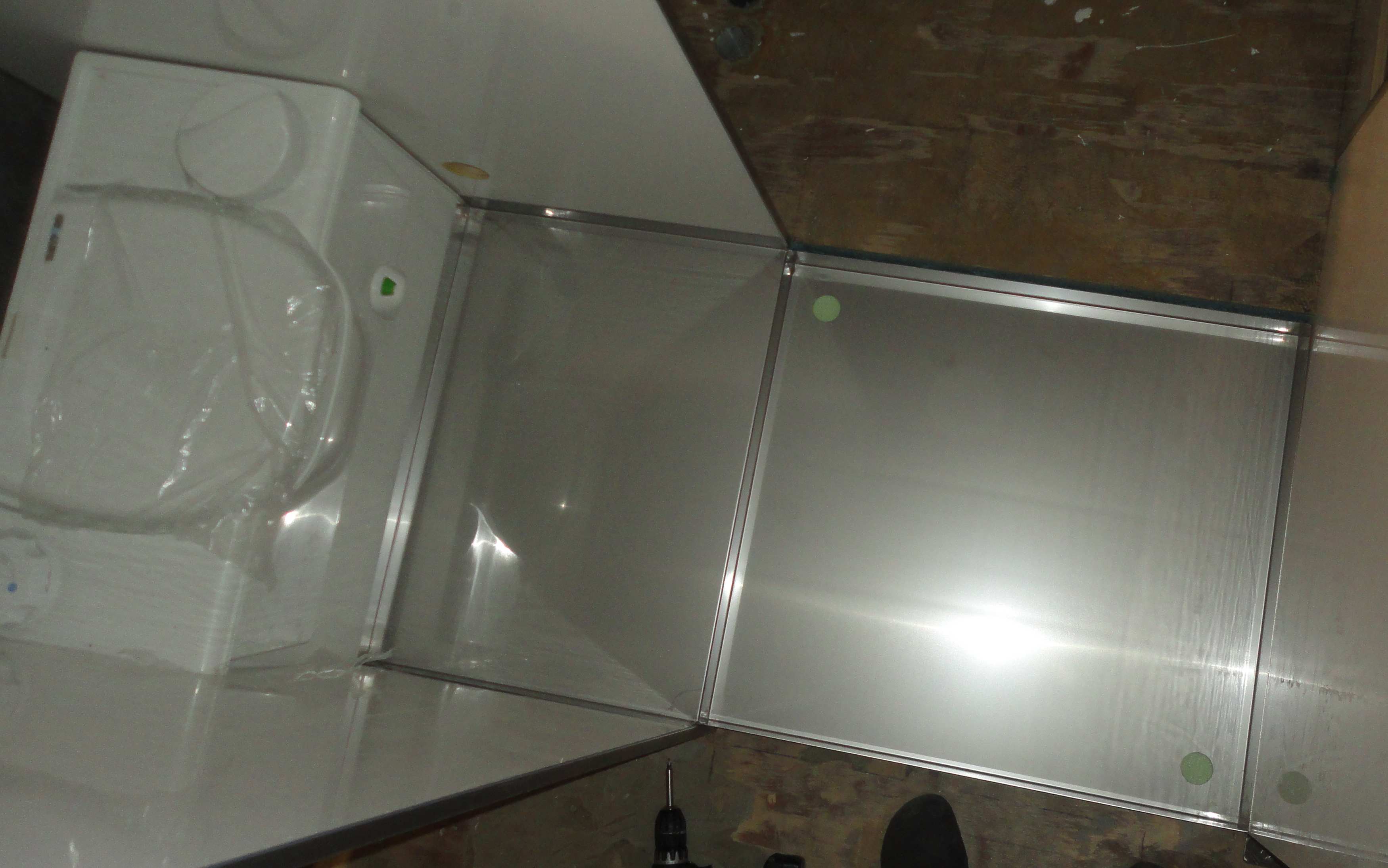

I have to many projects so one at a time
I'll post the g pictures when it's light outside that's a very nice cabrio 460 you have there ,am I right in thinking that Pinzgauer rims fit the old g rims?
I also I like your shower tray did you make it or buy this?
Regards Allroads

It is a stainless steel shower tray.
Self made by a friend of mine.
Truely a piece of art.

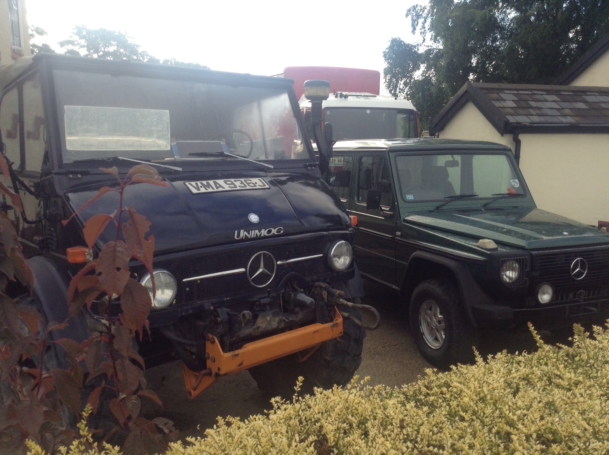

I thought about a tray like that I want to put steep sides and fit a wooden latt floor to stand on so if the truck is not level the water will go away, have you got two drains in yours ?
Here some pictures of two of my Gs the short wheelbase has now got a turbo diesel I'm going to fit it with an inter cooler it's only got 90,000 Kms from new and a very good body ready for new paint.
The green g is my old girl I did many many miles with her much offloading and I'm reluctant to let her go even with so many miles she drove lovely.
I'm going to pick my wife's g from the garage tomorrow with its new stainless exhaust I will put some pictures of that later when she is home.

The tray has two drains. Our shower is our access corridor to the rear storage with our KTM and the bikes and all other dirty stuff. So we will fit a teak grille to walk on it but also to shower on it. With two doors we will be able to either separate the toilet from the access corridor or close the entire bathroom to living space and store. Doors are just now in production.
