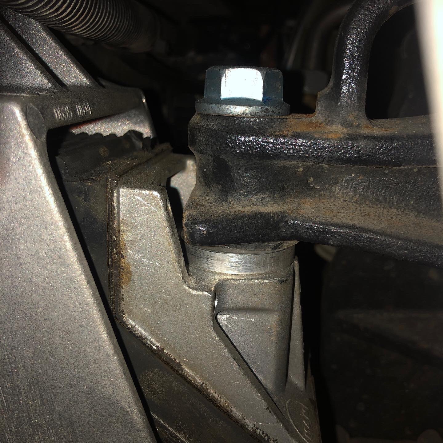

I have checked over virtually every component. The transmission mounts are good, and motor mounts are new. Nothing is under pressure when all the mount bolts are removed and all holes line up perfectly. I believe the motor is sitting where it wants to be plus it is not adjustable.

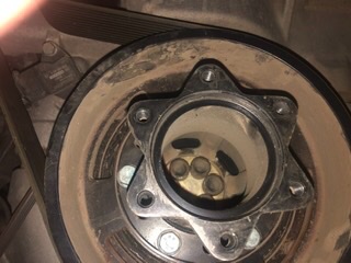

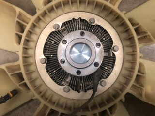

I did replace the clutch fan, cooling fan and ring shroud. I decided to comfirm these items
Were not the problem and removed them
And replaced the old items plus compared them side by side. Nothing changed, they are the same. The clutch fan is a different MAN design, but when mounted, lands in the exact same spot as the original.

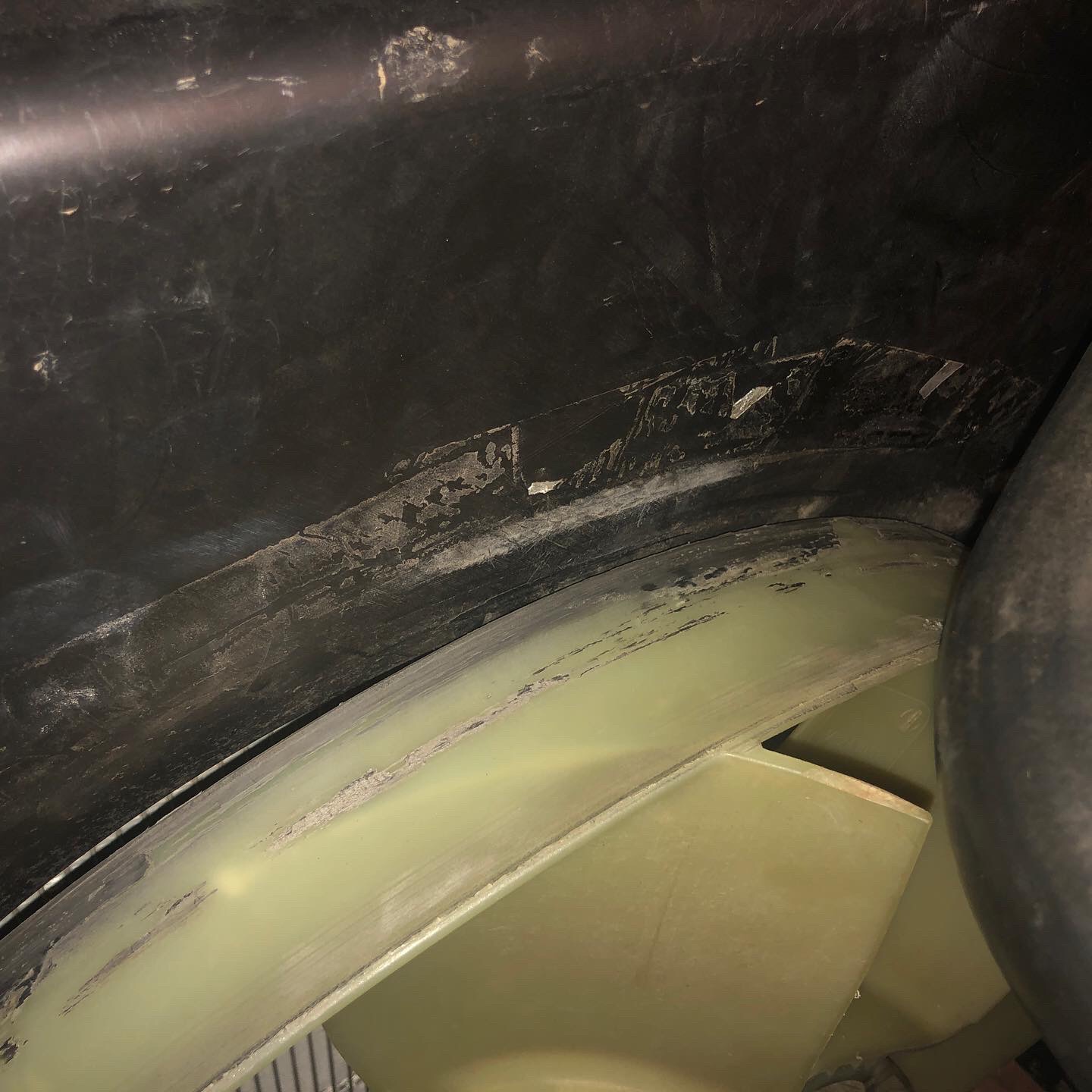

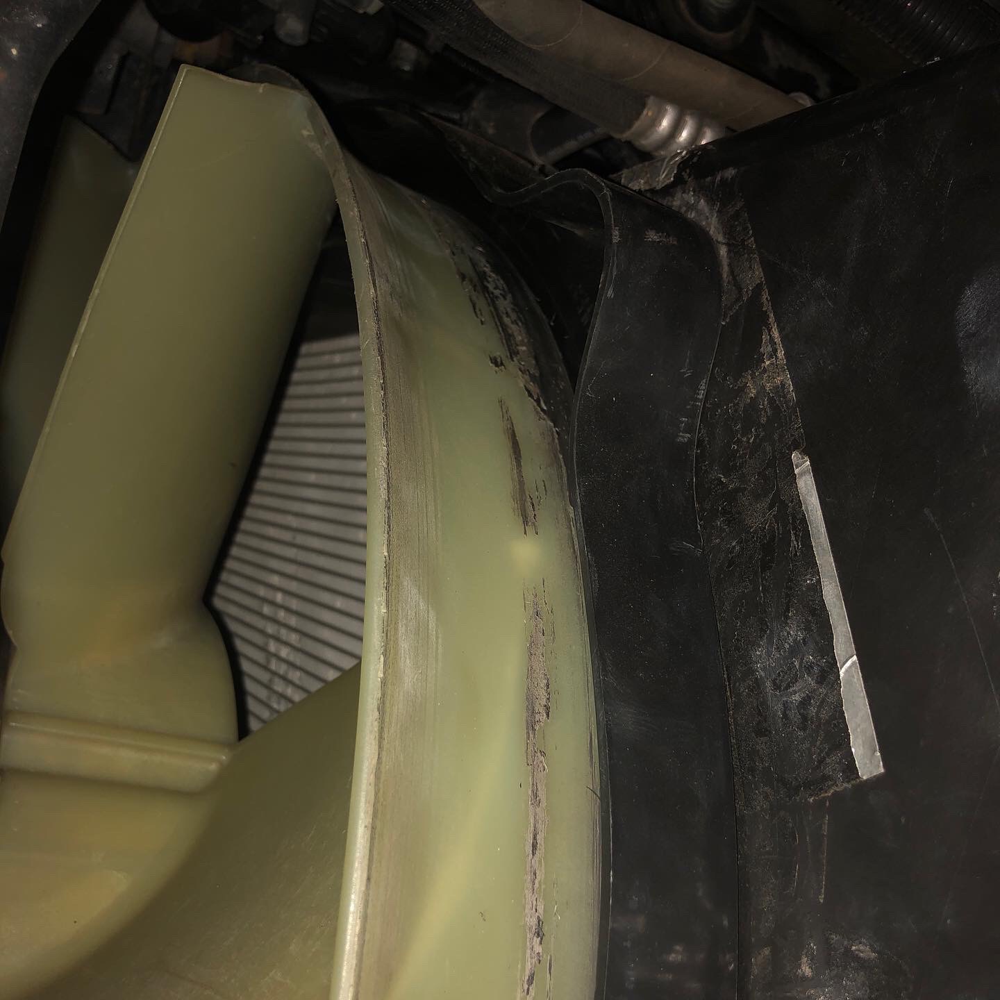

Shows fan touching at top. The ring shroud is removed at this point.
