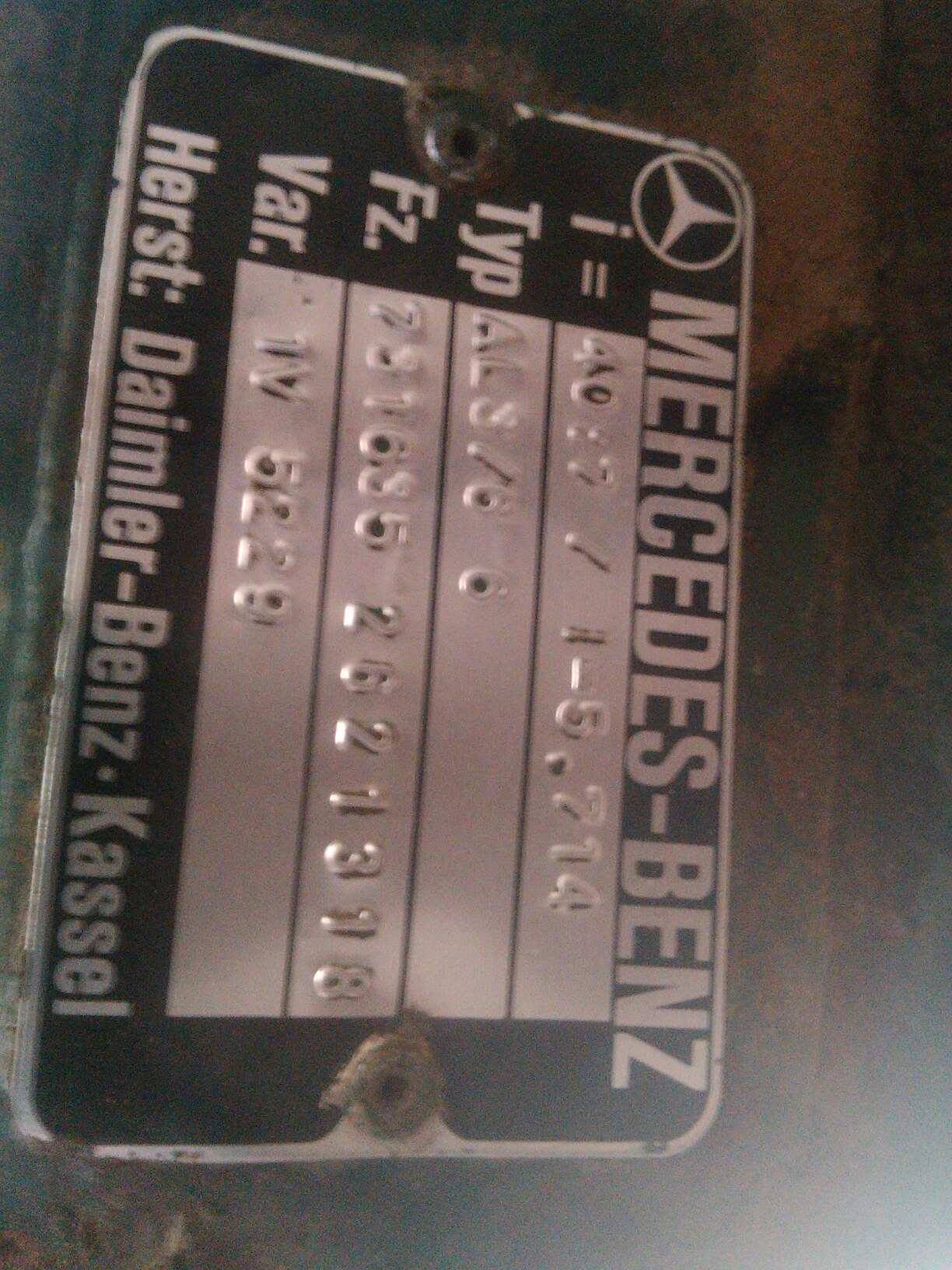

This is the axle plate.

Re: Mercedes 1017AF pressure on the front differential.
No, there is no breather/vent on this type of axle.
Yes, it is normal. Usually it does not lead to problems.

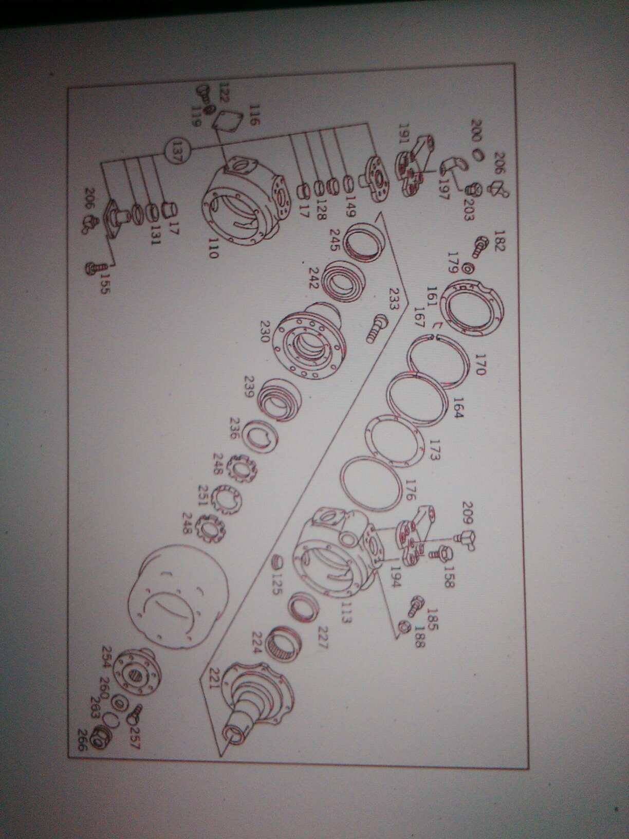

I will change the seal/joint of the sphere of the diff. Is dropping some grease from the balls.
On the photo i took from net Epc the part i need is the number 170. Correct? Or usually there is the need to change all. If yes what numbers?
[attachment=0]89269860_856668628092899_ ... ttachment]
